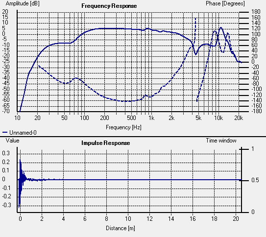

Need Help Using HolmImpulse
Being pretty new to computer loudspeaker testing (and to speaker testing in general) I have a few questions about HolmImpulse. I’ve had only mixed success with this very intriguing program so far, but I think I still need to refine my testing technique. So, please be patient, but I have a few rookie questions:
1) What is the “flip frequency” that is used to set up the Square noise (MLS) test? I’m just curious about this since the default setting (.900) seems to work. I accidentally changed this to .999 once and the test signal started to sound very peculiar! I’d like to know what I did.
2) Can anyone, in 25 words or less 🙂, explain why and when I should select either logarithmic sine sweep, chirp and/or the square noise as my signal. I have tried all three on numerous occasions, and their results are almost never the same, although they do track to a certain extent in certain frequency ranges, depending on whether I am making near field or far field measurements.
3) I am also curious if there are any guides as to which type of smoothing I should use and when to use them. It seems I can turn a very ragged response into a very smooth response, clearly one can go to far with smoothing, but I don’t have good feel (ok any) for how far is too far.
I haven’t found, yet, answers to these particular questions in Testing Loudspeakers (by Joseph D’Appolito)—great book by the way—so I am appealing to the forum for help.
I would also be interested in hearing from anyone who is using an EMU 0202 USB with HolmImpulse. HolmImpulse always crashes when I close the program and occasionally during program operation. I suspect that the problem is the 0202 since if I don’t go above 44.1 khz I avoid most crashes during operation; I also think its drivers, are generally, pretty flaky. Unfortunately, Creative’s support leaves much to be desired.

I think I might be able to answer some, but not all.
Use log sweep if you can. I.E. low noise or close. Use MLS for noisier environments or farther away. Chirp - have not figured that one out yet.....
Smoothing. Anything between 3rd and 12th is useful. 3rd give you a sort of general look at tendencies. That's handy. 6th or 12th shows you more detail, sometimes more than you can do anything about. Unless you have an almost perfect set-up, 12th is a jaggy as you want to go. I usually work in 6th, unless I'm looking for some little detail somewhere.
Can't say about the sound card. I rarely have crashes with my M-Auio USB card, but even its drivers are flaky. HOLM does not seem to care, tho. Maybe stop the audio stream before quitting?

I think logsweep allows better signal to noise ratio than MLS. 3dB crest factor vs. practical 9dB (I think I read this in ARTA manual). Logsweep is more robust when measuring non-linear systems, but impulsive noise during the sweep may ruin the measurement.

Thank you skeptic43, panomaniac and breez. Another question. I have been measuring near field response in a small, vented speaker that I have built. The nearfield response of the woofer does not show the notch, that a vented speaker should show. The impedance curve I measured with WT3 looks textbook so I can't figure out why the response shows just a small inflection at fb, not at ll what I would have expected from D' Apollito. I figure I must be doing something wrong-but can't quite figure out what. Again any suggestions would be very much appreciated.

I'm using the EMU 1212. Make certain you have the latest version of Patchmix and drivers. I had trouble too with the older revs.
Attach the measurement file.zip
Hi, can you attach the measurement as a file.zip
HOLMImpulse > File > Save Measurements
Then I can see your settings
