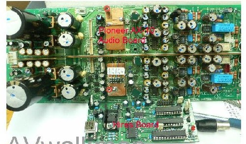

Pioneer DV-AX10 working !
My Pioneer DV-AX10 is finally working with Charly's V2 kit at 96KHz. The initial results are much better than factory DAC sound using a MSB DAC. This unit's SACD is its achilles heel, now no more ! Will post more after more extensive listening ...

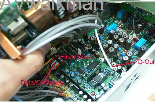

ax-10 pics
A reputable shop did this for me, they're in Hong Kong
http://www.avwalkman.com/
I'll get to the questions as I get the answers from them, the unit still have to get home in the next few days due to chinese holidays, first some photos :

Re: DSP
Chatted briefly with the shop, the V2 kit works by using the original DAC so there is no way to avoid the AX10 DSP. The AX10 has a very sophisticated buffered output so this was reused, I think this means we're not doing reclocking. The AX-10 was a very complicated design so there were considerable groping around ... esp the signals were not i2c, left right channels are separate so we have to desolder something on the PCB to accommodate this.

New SACD recordings, CD-Layer, sound great. How much better can SACD be, and what player(s) are capable of producing that quality ?
I have considered buying an Esoteric/Wadia SACD player but am still not sure of what sound I will be getting. I have listened to a couple of Marantz SACD players but the sound was inferior to a Meridian CD player!
Re AX10 and other players - is the problem in how, and in what, the disk is spun ?
Or is it the quality of the laser or laser electronics that lets the player down ?
I have a digital SACD output, SPDIF out re-clocked, from kit2 into a Meridian G91. The Meridian does its DAC thing and the sound is not superior to playing the CD layer in the Meridian!
I wish I knew exactly why.
This is the problem I am trying to solve - move on from CD; SACD and DVD-Audio are theoretically better because more information is recorded - or is it ? I have heard of so-called 24 bit recordings that actually contain 18 bits.
- Digital Source
- Hirez SACD and DVD-A digital output for Pioneer DV-575A and DV-578A (dsd to pcm)
