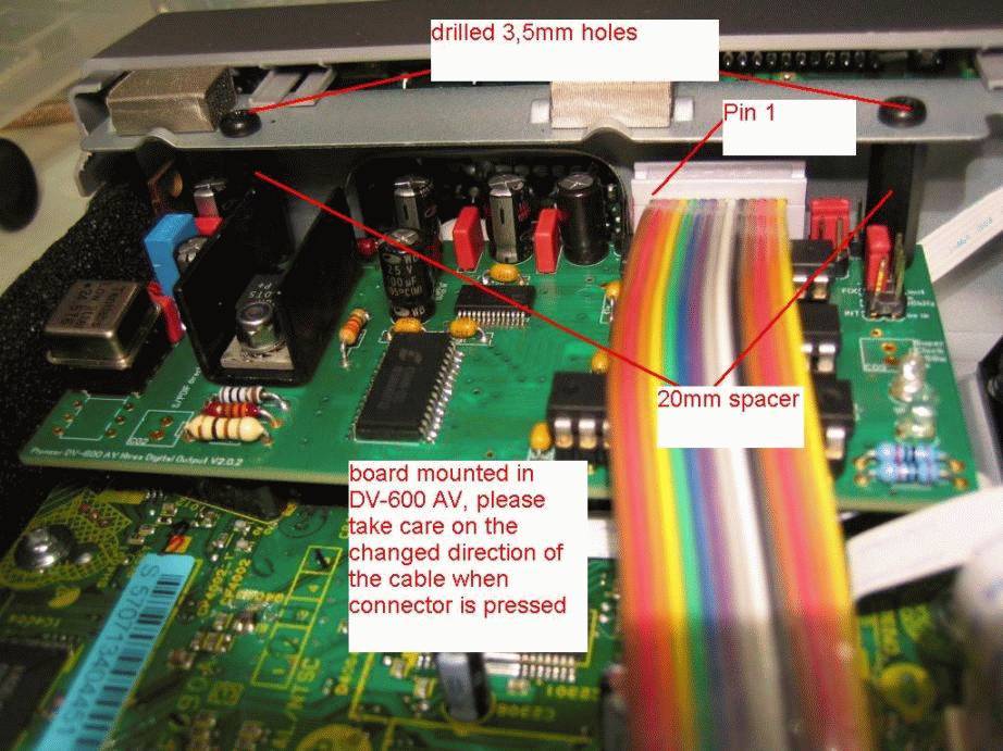

my DV-600 AV has arrived and as you know I had some problems with noise because I used the wrong chip 74HC244 instead of 74HCT244. Thanks again for your quick help.
I replaced the chip and everything is working 100%. I am using the 96KHz configuration to output the signal of CD, SACD and DVD-Audio on the S/PDIF port.
I have mounted the board in a different way, If somebody is interested here is a picture...

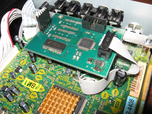

I have a simpler version running. Cirrus being so complicated, I got samples from Texas Instruments and used their DIT4096.
Connections according to attached picture. The numbers at the SCK, BCK, LRCK and DATA arrows denote pin numbers of the sterero-mode-PCM1742 (the right-most) where they go to.
If you can't read something or have other questions, please ask.
5V-power I took from the bigger capacitor (1000µF,6.3V) which is C8029. I had to get a service manual because I made a very short short which killed a transistor in the power supply...
Now it's running very fine, and sounds much better through my own DAC, which luckily switches automatically between optical and coax-input, depending on whether there is an optical signal present.
CD output doesn't work through the DIT, maybe different data format? But DVD-Audio 24/96 works
Maybe I'll post a foto later...
Edit: I have a Pioneer DV-585A.
