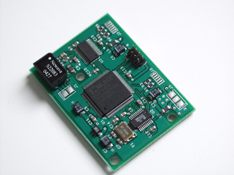

digital out stream
I would like to clarify what the Pioneer and Kit2 board do with the digital stream.
SACD disk is read: is this a 1-bit stream ?
The Pioneer then converts it to PCM. How many bits ? Is it at 88.2KHz ?
Kit2 then converts this to 96KHz stream. How many bits ?

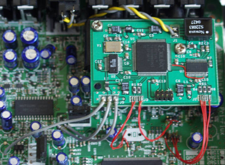

Tent Labs XO connection
I got your kit yesterday - wonderful ! The PCB is very high quality. Thanks !
I also got all the other components quite easily. I'm using OSCON electrolytics and I found a very low noise 3.3v regulator too so I'm really hoping for an almost jitter free output.
I have soldered on the two surface mount chips ok - not easy but with a hot air soldering gun and very fine solder I think I have done ok.
I'm going to wire up a couple of DPDT switches to the jumpers so I can switch between fixed 96Khz output and original source frequencies just by flicking both switches on the back of the unit.
I need your help with one thing - I got a Tent Labs 24.576 oscillator for it but I don't know the pin connections to match to the board. Your board has a rectangle oscillator, but the Tent Labs is square so it can fit in the DIL socket in many different ways... can you help me identify which pin goes into which socket location ? I have looked through this post and your website but I can't find any information for this.
Many thanks,
Tom
Many thanks,
Tom

Kit doesn't work
No digital output. No reply from Charly. Website unavailable.
Obviously I've made a mistake somewhere so I'll triple check but I really could do with some tips about how to test the circuit to find a fault.... please ANYONE - HELP !!!
It lives !
I have no idea what was up with it, but I left it switched on for a while and it kicked into life ! 😎
It produces a nasty output pop when the player is turned on but otherwise it's working perfectly - upsampling CD player, full resolution SACD and DVDA.
I'm so happy ... 😀 ... isn't DIY just FANTASTIC !!!
