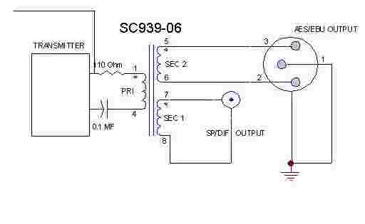

Connection to professional equipment
Charly!
I have recive your Kit yesterday, thank you it si great!😀
I would like to connect your board to the profesional digital monitors (Dynaudio Air in my case). The main distinctions from consumer format are -
1. AES/EBU (AES3) digtal interface instead of S/PIDF.
2. Presence of the Word Clock synchronization.
It seems to me that it is possible to change your scheme to use the transformer after the CS8406 (TXN pin 25 connected with the 110 Ohm matching resistor and with the MUX GAL16V8 pin 14, TXP pin 26 connected with the transformer through the capacitor 0,1 mF), see the picture.
To obtain the Word Clock - you need to divide your XO DIY from Tentlabs clock frequency on the bit resolution (16,20 or 24), is it possible?
It seems to me that this changes can essentially improve the quality of the sound.
Andrey

Mistake
I have read the IEC 60958-3 and IEC 60958-4 standarts. So I see there is a mistake in my phrase:
"To obtain the Word Clock - you need to divide your XO DIY from Tentlabs clock frequency on the bit resolution (16,20 or 24)."
According this standarts the Word is always the same 32 bits. See http://www.hardwarebook.info/S/PDIF.
I am sorry for mistake!
Andrey

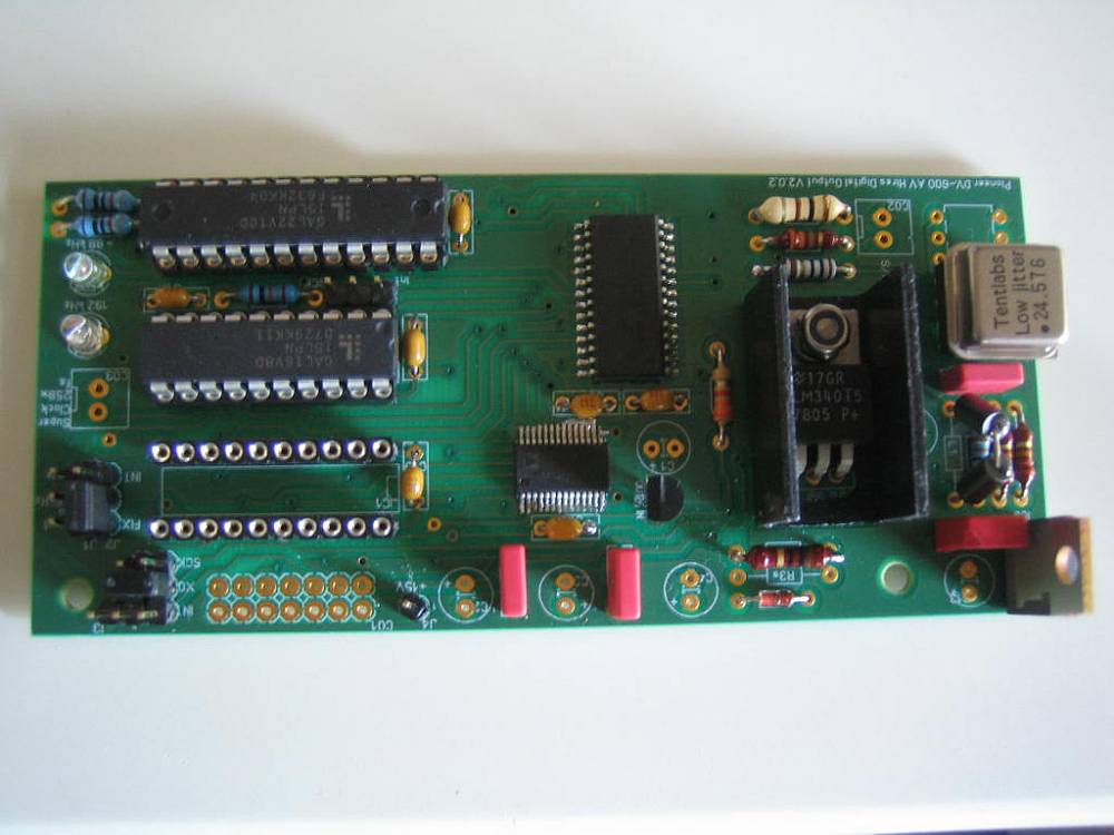

Hi Charly,
thanks for the quick delivery. The board has a real good quality. I have attached a picture of the unfinished board. I used some parts that I had at home . As you can see I have used some foil capacitors instead of ceramic. If you think this is critical (ESR) I will change them. It was not easy to solder the AD1896 but I think finaly I made it. Is there a possibility to test anything before I order the DVD player?
Vic
Vic
Vic,
without player seems to be difficult to test.
If you like to be sure you can send it to me ans I can insert it in my unit
Charly
Charly
