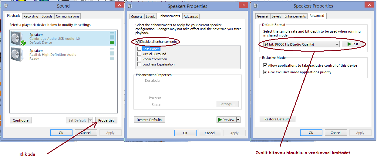

Good. Just make sure that your PC really sends 24bit data to your PC. If it is Win/WDM, 96/24 must be set in the control panel (as attached). Or, Foobar works well with the wasapi plug-in. Or use ASIO.
