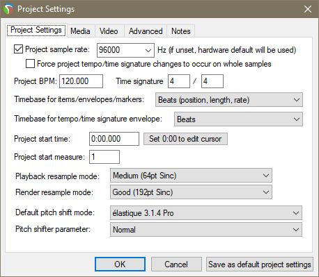

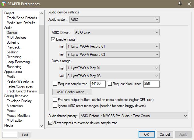

Thought I might offer a hint that I found helpful for comparing the files. I used Reaper, as shown in the images below. File/Project menu is set to force 96kHz at the sound card. Options/Preferences menu is set for ASIO, at least in this example. The time scale at the top of the page is set by right clicking up there to see the menu to select the scale display as shown below in one of the images.

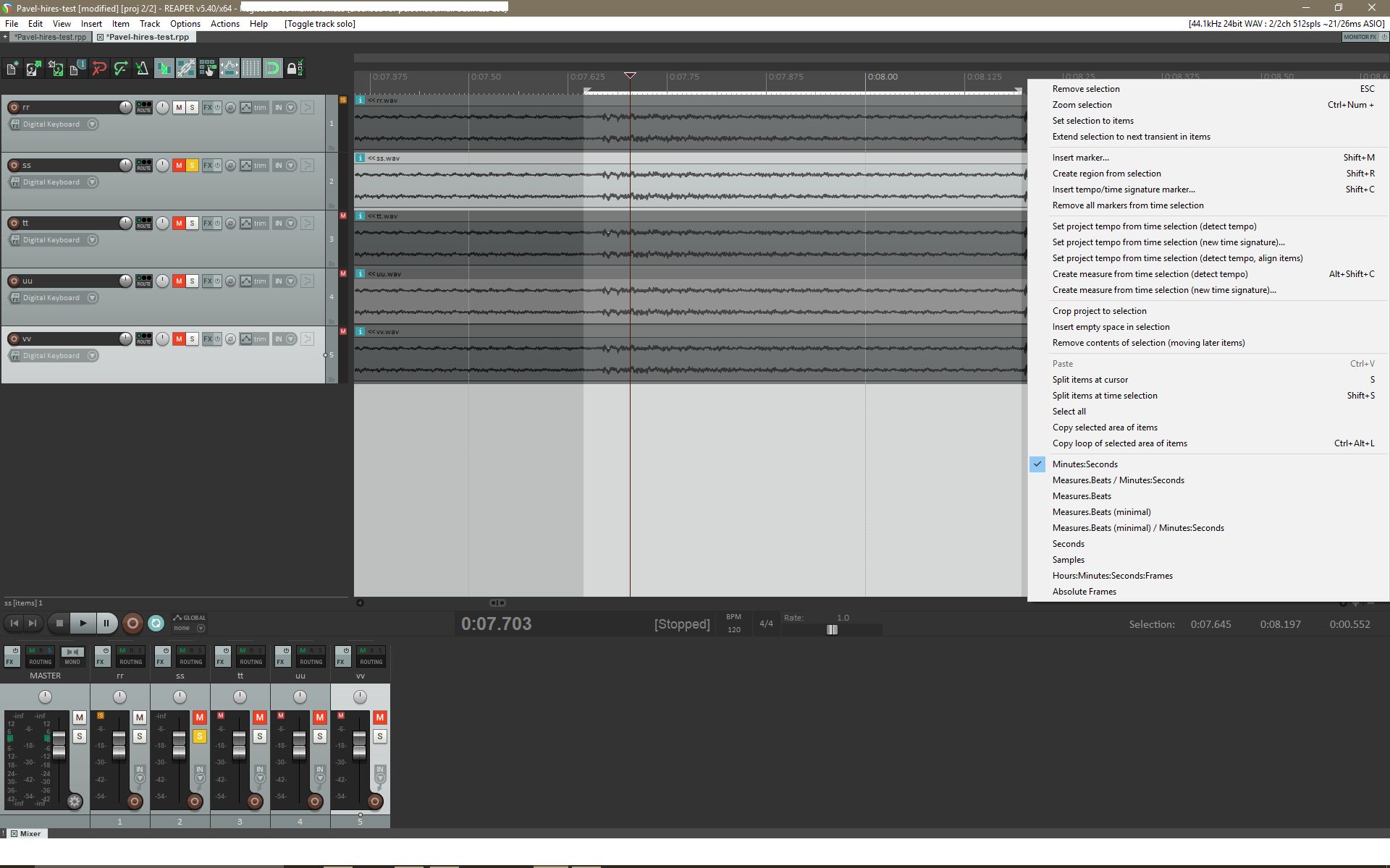

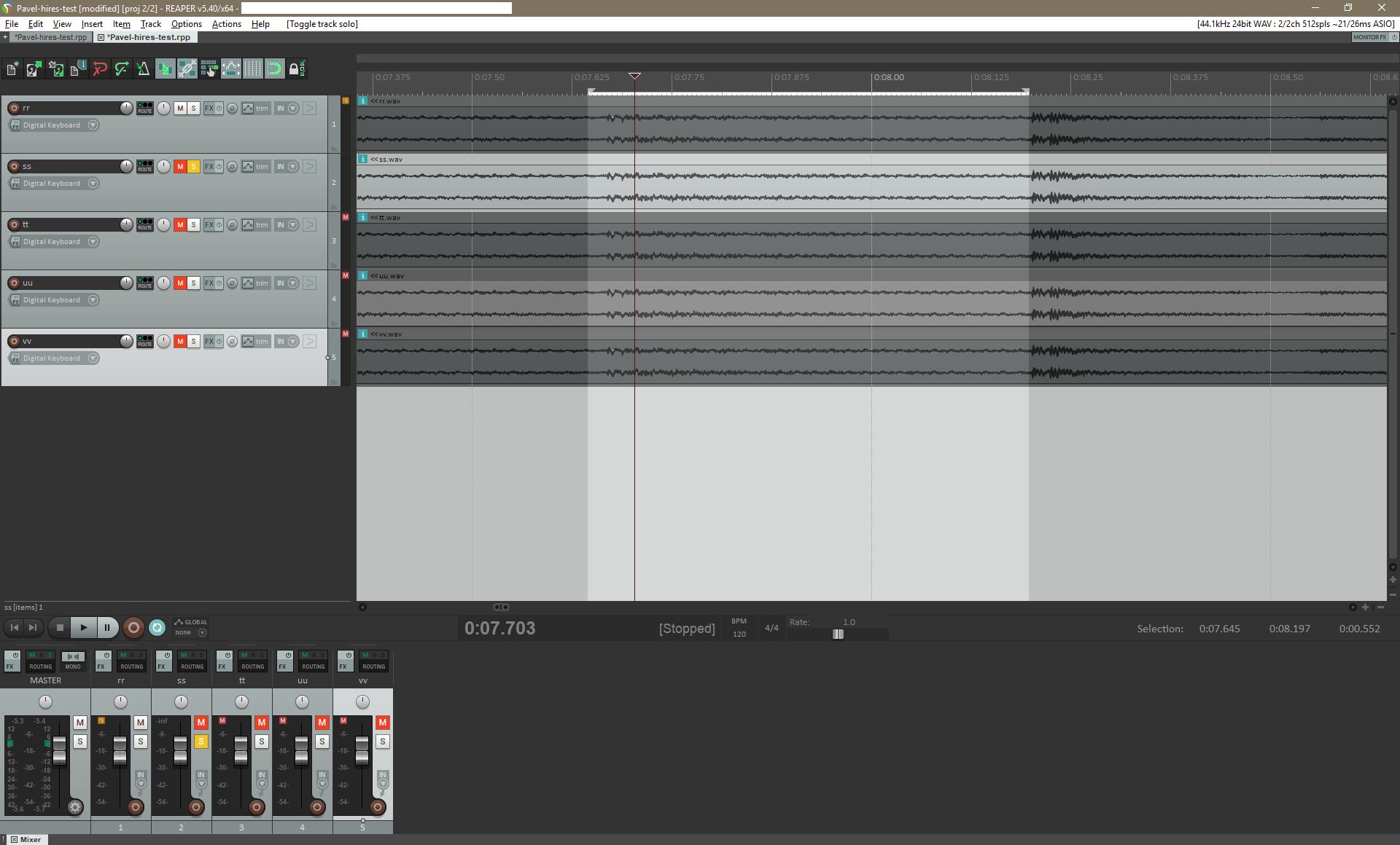

In addition a region has been selected for looping, small adjustments to the end points can be made by holding the shift key and dragging the little triangles at the upper corners of the region. In the images, the region is very short, focusing on a single cymbal hit. The loop button at the right of the play and stop buttons is engaged to allow looping of the region.
As can be seen, all the tracks but one are muted, the red "M" buttons are lit. One track is also soloed, with the yellow "S" button lit. Solo overrides mute, so a soloed track will play even if muted. By un-muting one track, it can be compared to any other track by soloing the other track. Doing so will mute the un-muted track and only any soloed tracks will play. By this means one click of a solo button can be used to instantly switch between two tracks.

EDIT: By the way, I strongly recommend listening to the cymbal hit I have outlined in a region in Reaper. It is very revealing in that in some of the files it sounds a little more forward and sparkly, which I assume is from harmonic distortion.
