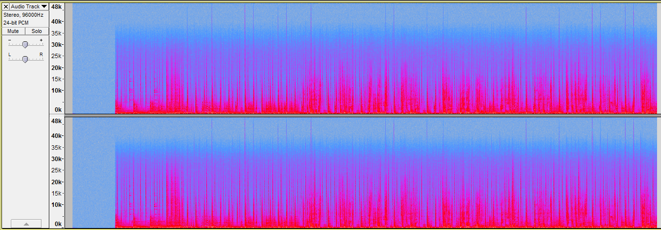

I am posting a new opamp test, this time in 96kHz/24bit resolution. The music samples may be downloaded from
http://pmacura.cz/test_hires.zip
The file is quite big, about 160MB, as a result of higher resolution format.
The samples have a lot of information above the audio band, as you can see from the attached spectrogram. It is a true hires, not the file create by ultrasonic noise addition, as is sometimes quite usual.
The link level was now 2Vrms = 0dBFS.

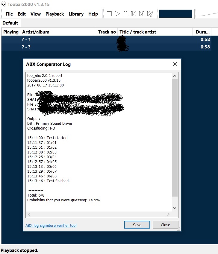

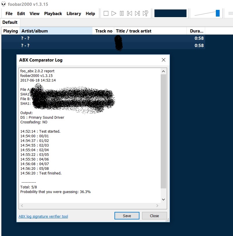

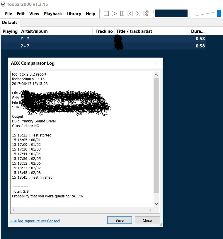

Not doing very well here. The one I don't like seems to vary. The intro is good, vocals less so. I'm going to stick with that as the 1458 at the moment.
I've blanked out the tracks to keep the files that I'm choosing anonymous.
Maybe I should stock up on 741's and 1458's. After all, if you can't tell the difference then using the lowest cost device to achieve the desired result is called 'engineering' ;)
Who said that :eek:
