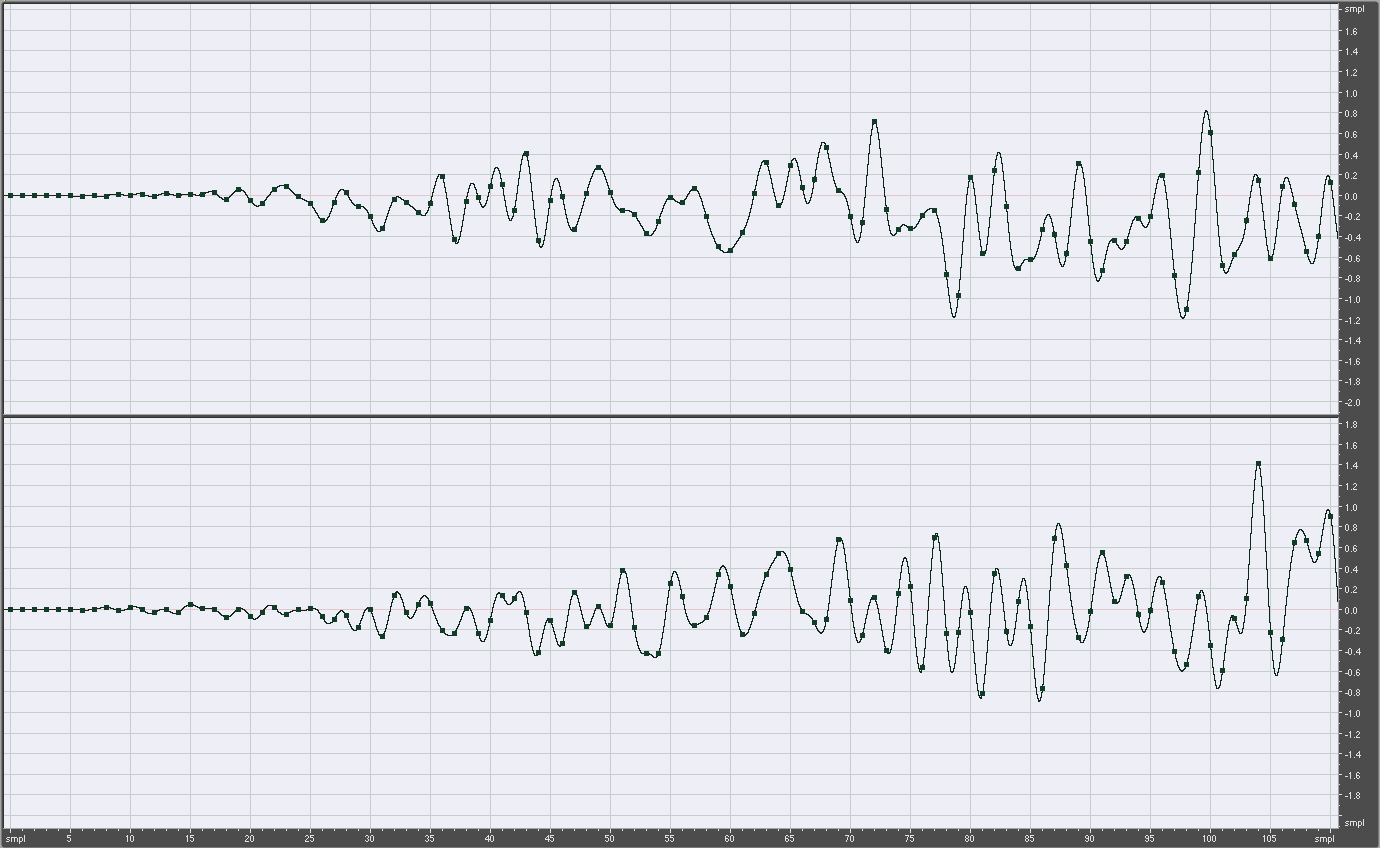

I would like to add that cheating based on file data is IMO impossible in this test. I am posting the direct difference between samples at the beginning of the "best" and "worst" files, when the signal starts from "silence". One can see that the difference between the files is sub-LSB. The Y axis in the plot is in 16-bit LSB. So everything below value "1" is higher resolution of 24-bit data. There is, of course, some small time difference between the files, in microseconds, that results in amplitude differences of samples with higher amplitude. This would be minimized by diffmaker method, but I am showing direct subtraction now. One can see that remaining "difference" in noise is in any case inaudible.

Yes, human brains can detect signals below noise floor, but 10 - 20dB below noise floor would be a limit.
This -140dB audiophile story is definitely exaggerated. I can also hear -120dB from Philips test SACD disc. But -120dB re what?? Only in case that I turn volume full right. But it would not be possible to listen to the music at such high volume/gain. Look, let's say you/me listen at maximum of 110dB SPL. Hearing threshold would be 0dB SPL when surrounding is absolutely quiet. So it would be absolutely impossible to hear -140dB tone, which would make -30dB SPL. Utter nonsense, one of the many audiophile nonsenses.

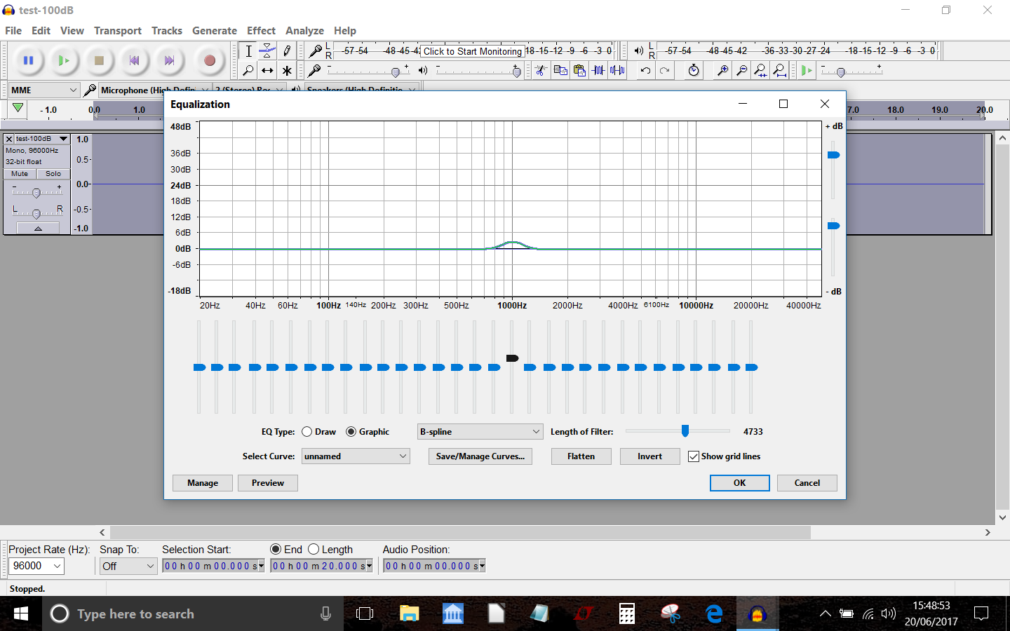

Nothing directly (on laptop) but I can extract a clean sounding 1kHz tone from it and make that very audible.
Yes, after manipulation with the file (digital amplification). How about the second file (-100dB), I recently edited my post and added it.
Not reliably. I almost think I can when using my headphone amp but it is tenuous, and if I do this (image) then I can say 100% yes.
Can't hear either one on my laptop. I will try later on my main system.
On your system, with DAC and amplifier, you should (must) hear at least the -100dB tone at maximum volume. In case you have really low noise system and high gain, you will hear even the -120dB tone.
But, this has nothing to do with usable dynamics during normal listening. That's why I posted the two low level tones. I hope Bob Katz did not want to say he heard generated -140dB tone re anything. Don't you have a link to his claim? He seemed to me to be pretty wise and experienced guy.

What happens if you try this with the -120 dB tone?Not reliably. I almost think I can when using my headphone amp but it is tenuous, and if I do this (image) then I can say 100% yes.
