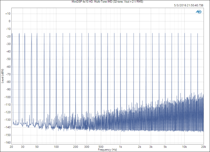

Fairy nuff. When I finally get the miniDSP hooked up I'm aiming for 0dBFS to be a gnatfart from clipping. I spent too many years only being able to use the first 90 degrees of the volume pot to want gain after my DAC.
I should run this test when I get time to prove to myself I don't need an external ADC to the miniDSP as a priority https://www.neurochrome.com/minidsp-4x10-hd/ . As I have said before, I wish more people did (or could do) the multitone test as to me at least it gives a great ready reckoner. for analog in and out all the hash is in the room noise at my normal listening levels 🙂

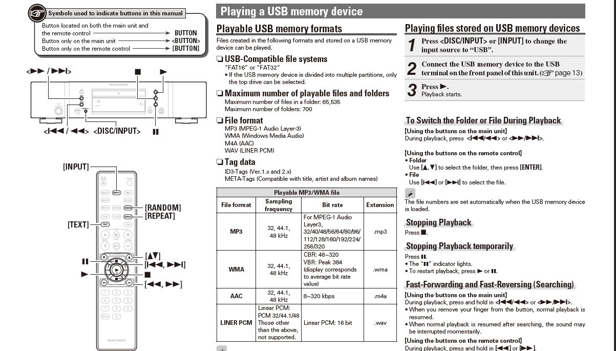

A new day and a new line of attack. I realise (more so in these tests than in any other previous ones) that my laptop playback is not up to the mark for differentiating these and unfortunately my main system source (Marantz Pearl-Lite SA-CD) will not play the files (on a USB stick) in their native form.
I've converted all to MP3/320kbs so as to use the DAC in the Marantz. I'm now hearing things that were totally masked via the laptop playback and Foobar tests. The kind of signature I would have attributed to the 1458 I feel I can now detect. There is another one with seemingly similar traits in there as well.
Is it real 🙂 or an artefact of the MP3 conversion. I think its real because its not subtle and buried in the depths. There is one line of the vocals that really seemed to show this up.

Understood. My current DAC uses the hated 4558s so I would not consider it up to this task, but it has made me think.Sorry for the slight off topic drift, but I feel the outcome of this test is important in the sense of reminding people where to focus funds. I could for example budget for the nice TI ADC EVM wayne recommends and a couple of dacmagics OR I could upgrade my speakers and have £400 left over for music. As the hash on the miniDSP is generally 90-100dB down, I think the latter is a better use of my money 🙂

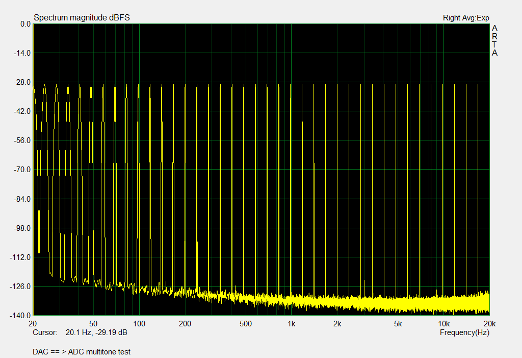

Bill, IME this test is very easy to pass for a good system and frankly I request for the bottom to be clean. Otherwise it smears the signal.
Pavel, that is a different result you show to the one I posted. That is DAC to ADC. Mine was ADC in DAC out (the worst case with miniDSP and in my case will only be used for vinyl where the noise floor of the ADC will be swamped).

please let me note that the "hash" as you said will integrate through the audio band, similarly as noise. So one cannot only look at the difference in amplitude of the single frequency vs. multitone level.
Mooly, Can your SA-CD player read audio DVDs? If so, there are quite low cost USB-2 DVD burners that would probably work with your computer. That would potentially give you hi-res capability.

Pavel: Not sure I understand your use of 'integrate' there. I wasn't looking at the single tone test wrt the miniDSP, just that, with a real world signal and my real world listening levels, that noise is below the room noise floor and therefore not a priority to address, vs say getting a better power response from my speakers which has a real impact on the stereo illusion.
Just to add, I get 'Header Error' when I tried. I'll perhaps have another go at some point although the MP3 version seemed to give me what I wanted.

Looks like it can play AAC. So far as I am aware, it is a slightly more accurate format than MP3.
