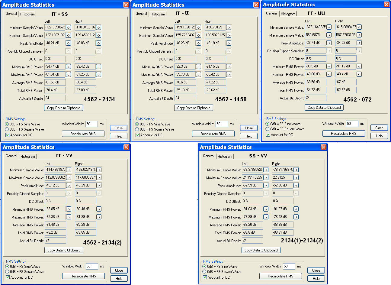

Diff Maker results on opamp files and a small correction to image in
http://www.diyaudio.com/forums/ever...-24-listening-test-opamps-30.html#post5119089
I have made more diff maker files and I would also like to make one correction in my post here above, for rr - tt I posted, by mistake, a result of direct file subtraction and not the one of the Diff Maker SW.
So, here are the results of the Diff Maker for:
rr - ss (4562 - 2134/1)
rr - tt (4562 - 1458)
rr - uu (4562 - 072)
rr - vv (4562 - 2134/2)
ss - vv (2134/1 - 2134/2)
I have chosen the rr (4562) as a reference, because it is the lowest noise, lowest distortion and fastest opamp in this test.
From the attached image we can see that smallest differences are
of course between 2134/1 and 2134/2 as expected,
then between 4562 and 2134/1 and also 4562 and 2134/2,
then between 4562 and 1458,
and the biggest difference is between 4562 and 072.
This may be the reason why TL072 got the most votes, it probably sounded a little bit "different", though we have no ABX proof.
All the differences are very low in level and thus most probably undetectable in the ABX test.
