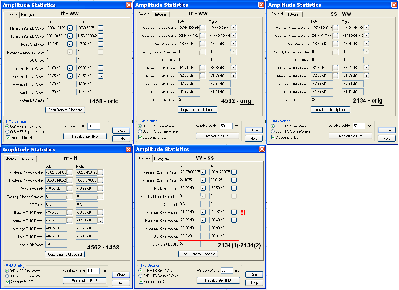

Did you run any diff maker tests on these, and if so did thay show any differences on this latest test ?
Yes, I did. I did both direct subtractions and diff maker extractions. Direct subtraction may be tricky because time differences between the files are from 4us to 17us. So I am posting the statistics from diff maker files.
In the first row there are opamps vs. original file. You can see that statistical differences are very similar for all opamps (072 not shown but no difference).
In the second row there are opamps vs. opamps. You can see that 4562-1458 is a little bit below the opamp-original, but not very much. The last image is 2134 1st take - 2134 2nd take. This is a very important result and it shows very good repeatability of recordings. Though the timing, time difference between the samples was about 4us between 1st and 2nd take files, the average RMS difference is about -90dB. No one will hear -90dB signal of any kind below the basic signal.
A comparison with the previous test would not be precise. In the first test, I did run DAC and ADC in the same audio device. The advantage was synchronous timing, disadvantage worse DAC in that test. In this test, DAC and ADC were separated instruments, higher output level (2Vrms), better DAC, but asynchronous sampling. However, repeatability is very good as you can see from ss-vv.
Thanks for the diff maker files. I've never studied those before (as in used the program).
Hmmm ! I can see they are all close, and as you say particularly so for the 2134vs 2134 and yet I have doubts
These are taken over the whole length of the track I am assuming. So an average ? If so then a lot could be happening at the miniscule level that may not register.
Or have I not grasped the idea correctly ?

Yes, it is a 50ms window average through the whole track. But the images are not from Diff Maker. Diff Maker was just used to prepare the difference files. The evaluation windows are from another software, similar to Cool Edit 2000. But you can also see the instantaneous maximum deviations in those window images.

PMA, do you have any data of the da ad loop minus opamp? I have a feeling that the diffmaker result is just showing the ad da vs original file.
No, but I have results of opampX - opampY which is more or less the same. You can see 4562 - 1458 and 2134(1) - 2134(2).
The most important in original vs. ad da chain comparison is a capacitive coupling and LF roll off resulting in a small phase shift at LF.
