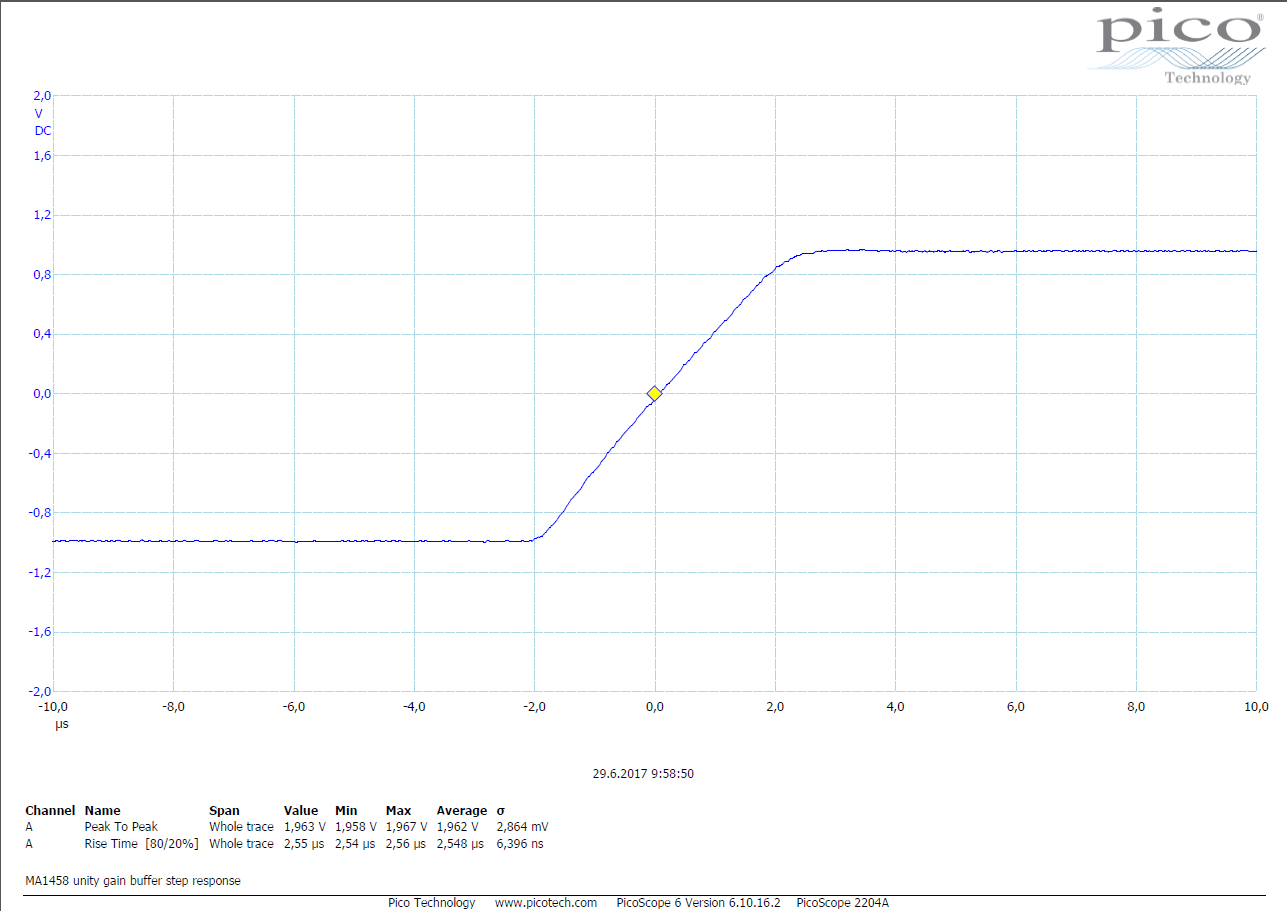

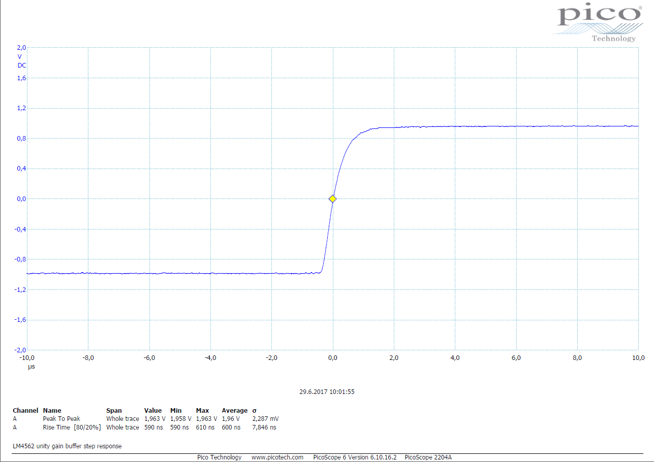

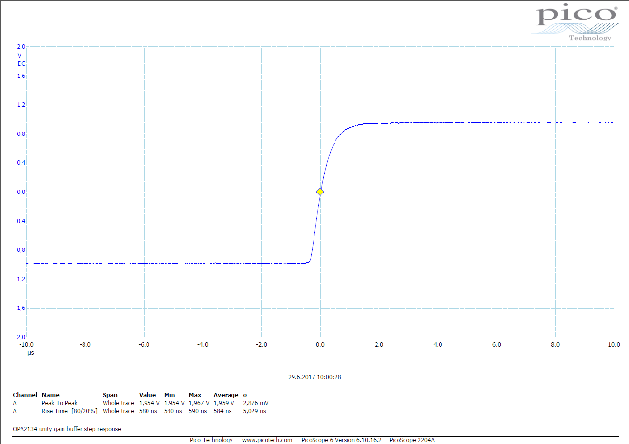

I have just measured and saved step responses of all 4 parts in the test circuit. Briefly:
- 4562 and 2134 follow exponential response of the preceding RC stages,
- 072 is seemingly fastes, but it is not, the part itself has overshoot and the result we can see is part's response convolved with the preceding RC filter stages,
- 1458 is slewing and it shows typical slew rate of 0.5V/us. Still enough :D
So, nothing new. Just to add that the TL072 always has some stability issues and it has to be considered in the design stage. Especially it does not like capacitive loading. We have a series resistor here at the output.

Squarewave result doesn't throw any real surprises. And thanks for doing this :)
I guess what we can take away from all of this is that for a line level buffer implemented correctly, the 1458 has been proved adequate even when using extended bandwidth material.
Makes you think.
Squarewave testing the 1458... anything over 10kHz and a couple of volts will look grim compared to all the others.
But it is totally unimportant. You have no 10kHz squares in any music signal, especially not in your mp3 transfers ;) (sorry that I am poisonous)
Even 96/24 has nothing more than 4th harmonic of the 10kHz square. And "slew rate" of 40kHz/2Vrms sine would be 0.7Vus, but music signal will never contain 40kHz at full amplitude. The maximum expectable dv/dt of the 2Vrms music signal would be no more than 0.1V/us.
