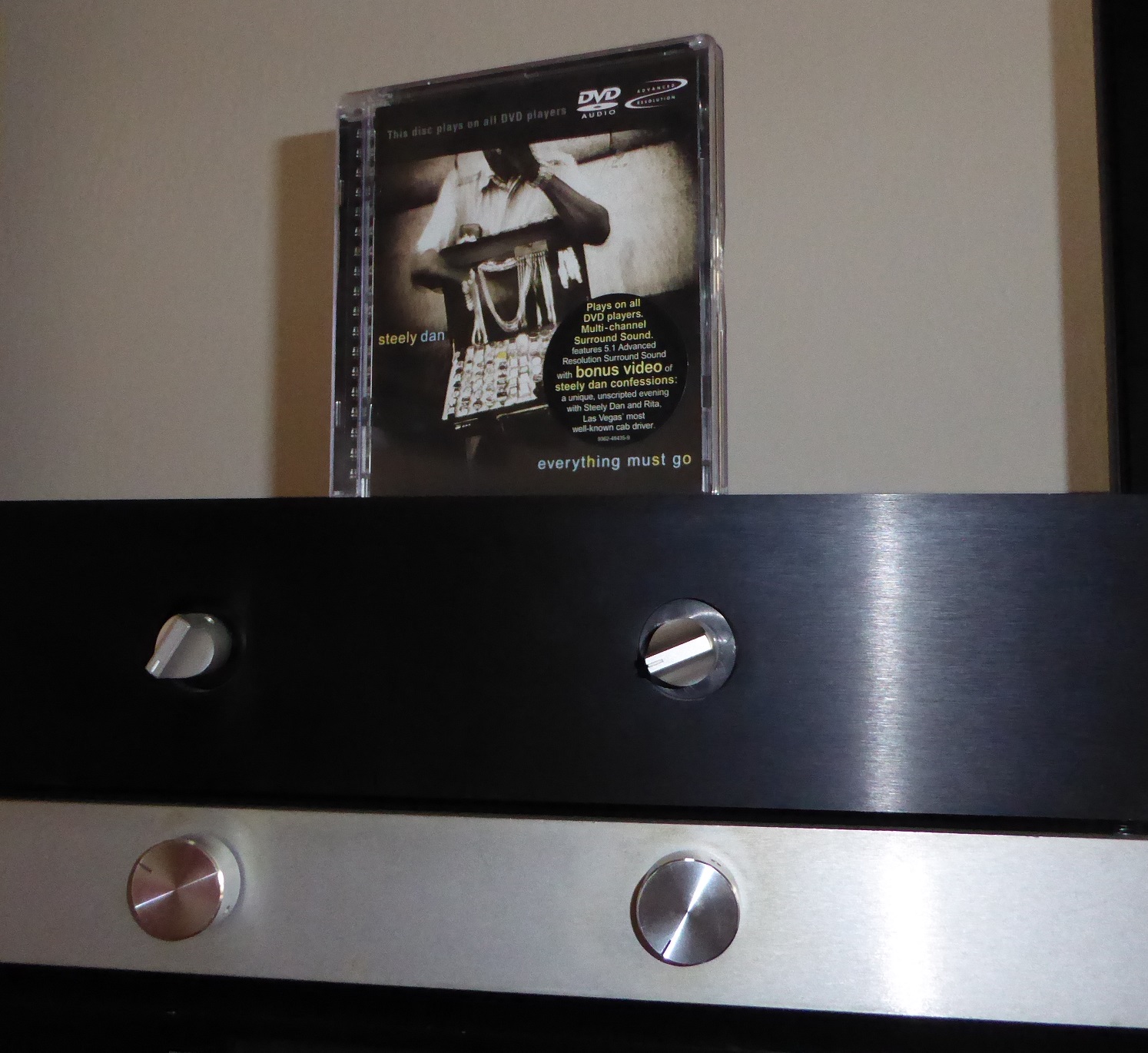

Mark, interesting observations. The "ww" file is the original file, source file. Music was correctly identified by Joseph K.
Joseph K, yes I have the disc. I bought it in 2004.
Okay, I accept that it is the disk. Thank you. They issued a somewhat distorted sounding release then. Not unusual, especially for rock and pop. That's part of what I wanted to know.

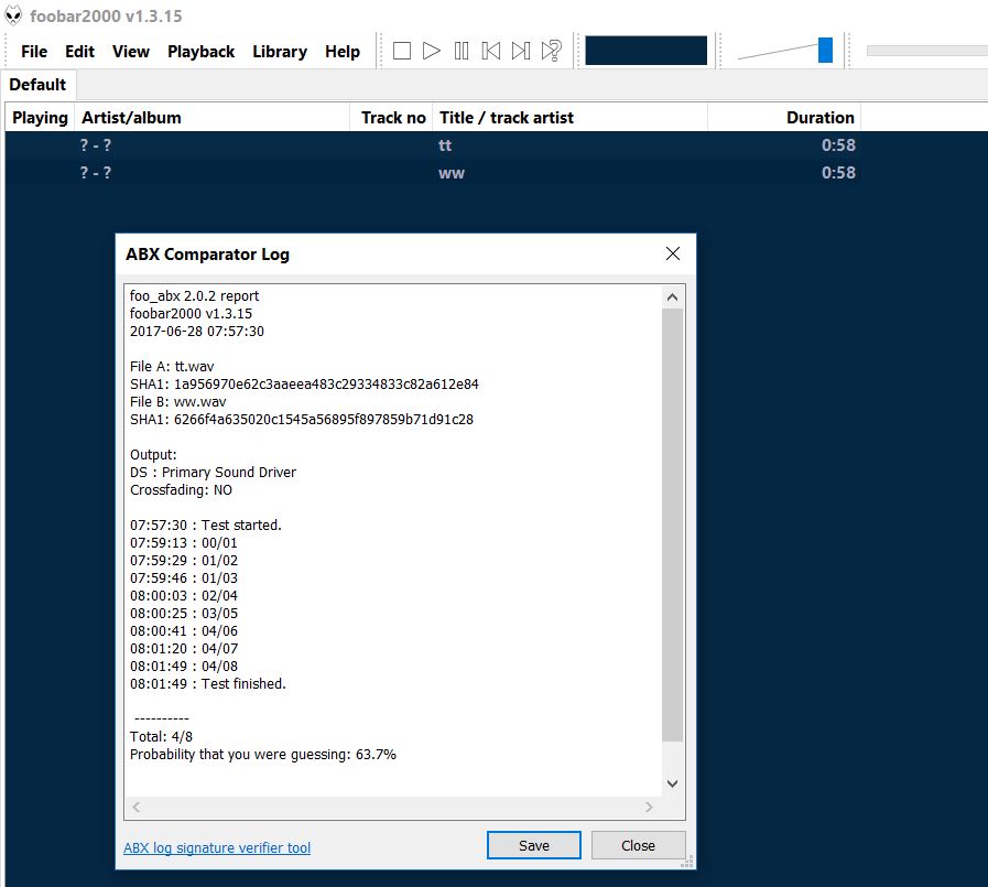

Well......
I'm trying all again but this time around as 48k WAV as you suggested earlier. The first thing is that the defining difference I said I heard between the OPA2134 and all others doesn't seem to be so definable now.
When I listened to the MP3 version I was so so sure on that difference and mentioned it to yourself that I thought ss and vv were the worst. I can't just pick up on that now. Odd.
I've even gone back to the MP3 version and again, I'm not hearing that in the same way.
As to ww. Well on both MP3 and WAV I like to think I hear a difference between it and the 1458. Specifically on the cymbol hit in the right channel on the vocal opening line 'attention all shoppers and on the word shoppers.
I'm going to do one single Foobar run of ww versus tt and see what happens.
Well......
Karl, it may be the result of the lossy Lame mp3 encoder. The files do not have exactly same sample timing (DAC and ADC were independent this time and relative shifts between the files up to 1 sample period do exist, 1 sample is 10.4us) so the lame result is questionable.
In my experience, the worse the system (both HW and data), the bigger sound difference between various almost same files. Same with those opamps under test. Put them into the noisy unshielded environment and you may get provable differences.

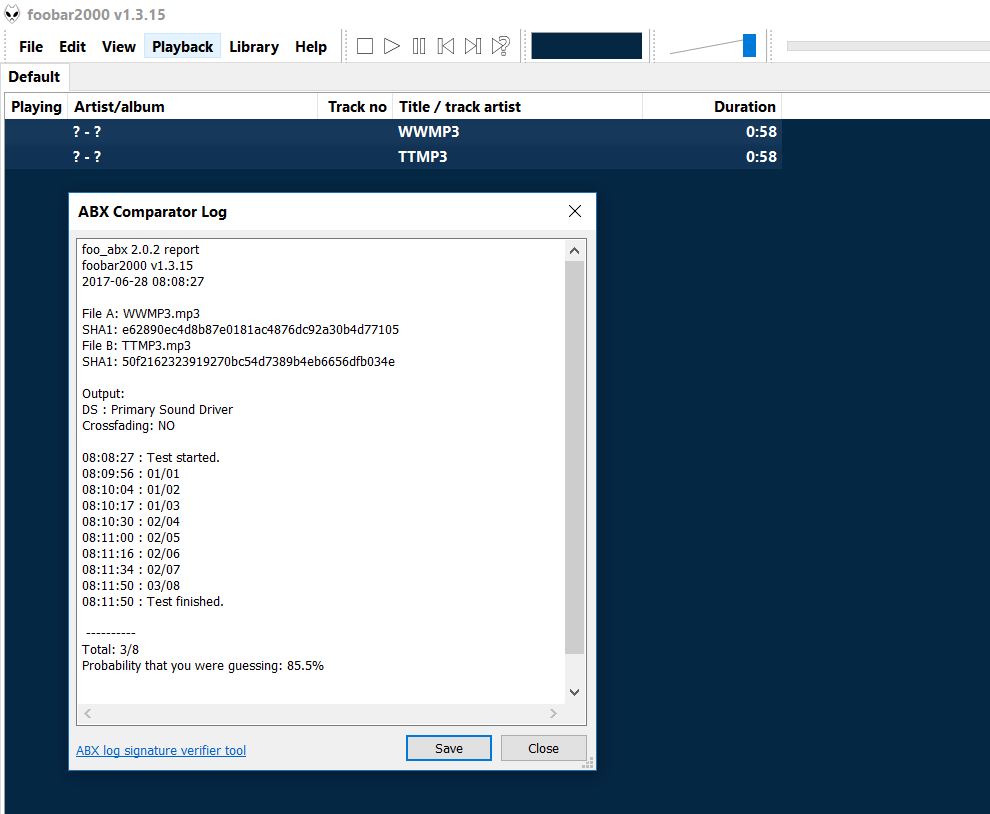

What are we to do ? Take up golf perhaps![]()
It only gets worse. MP3 version.
Better message then if you got 10/10 from mp3 😀😀
Message 1: - opamps do not make a difference in case that they work within their specs limits and when they do not add excessive noise and distortion (1458 would do it for gain 100x, but not for gain 1x), and also they must be shielded from external EMI and RC filtered at the input.
Message 2: - D/A -- A/D 24/bit chain does not necessarily adds "coloration" to the original sound file. At least we have no provable result or supported claim.
