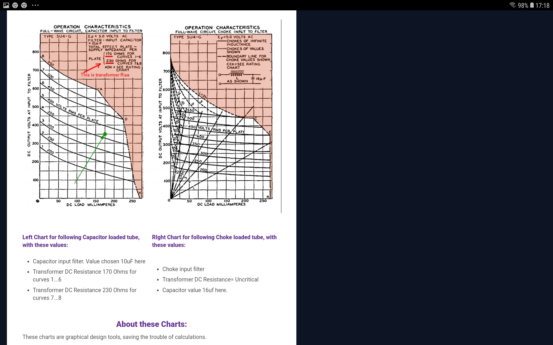

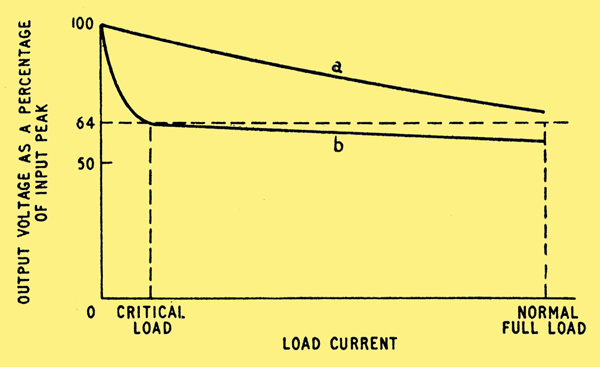

Hope this works. Here we have 50 cps so i calculate a bit easier.
Suppose you have 14 volts dc on the first cap.
Our friend Helmut will need 14/0,014H =1A minimum current before the supply starts working as a choke input. Usually this is done by installing a resistor across the first capacitor that will take care that there will always be this minimum current running before even connecting the amp itself.
Usually the current taken by the resistor should be much smaller than the one used by the circuit itself.
IF the current is not enough the supply will work as a capacitor input. In the yellow attachment you see the so called critical load that is the part of the load that needs to be take care of by the resistor. You can see after this minimum current a change of current will not affect the dc output as much.
The bigger the mH the lower current you need to waste by the resistor.
Nilton, my Brazilian pal, uses 700mH so he only needs to send 20 mA going down the resistor. So i think for a stereo le monstre amp you will need at least a 200mH 2A choke if you wanna go for a choke input one. The lundahl can be used for choke input , not all chokes can, some will buzz with 1,8 A even if they are specified for 3A.
The other attachment you see the specs of a rectifier tube. Here you also can see you need a certain inductance for the supply to work as a choke input. You can also see that with choke input the supply can deliver more current because the choke will cause a constant flow of current no charging pulses.

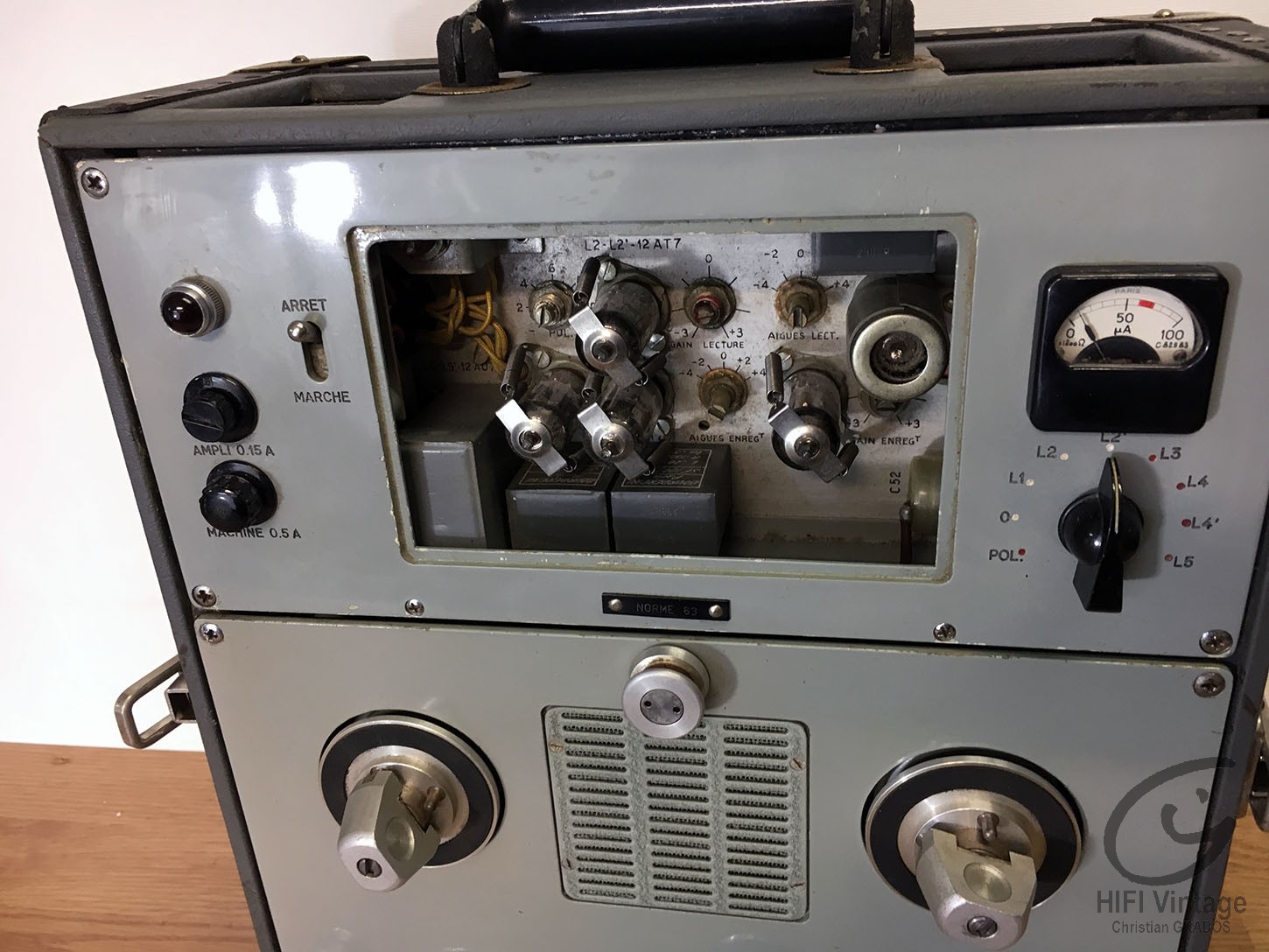

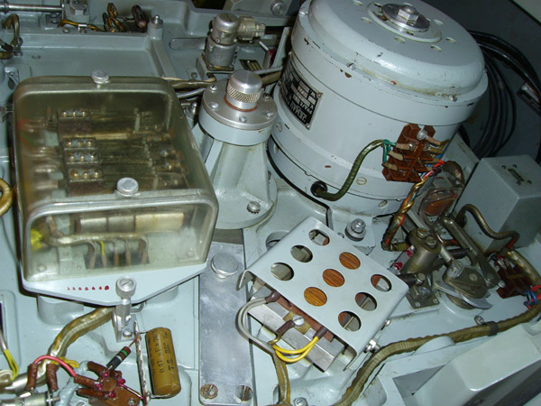

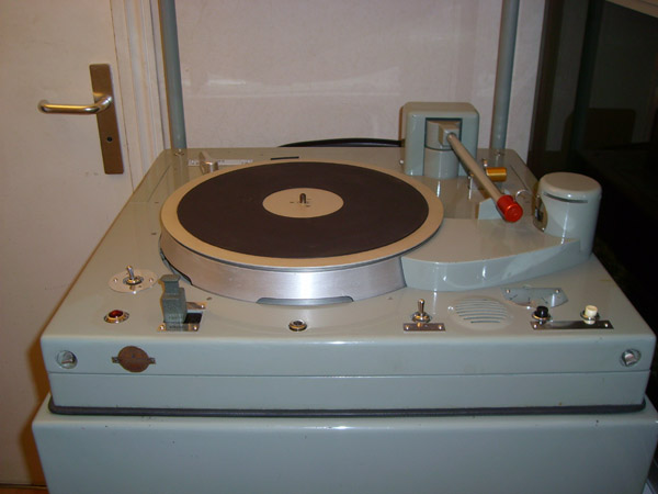

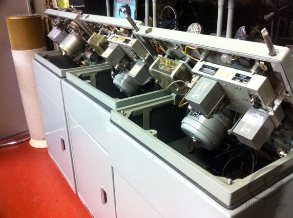

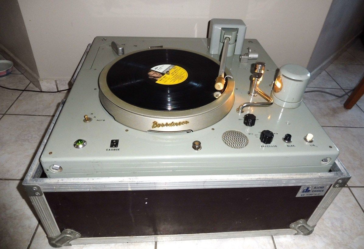

Hello,
These are French turntables made by Bourdereau for the national broadcasting services in the sixties.
Back then there were a few French companies that made all the gear used in French studios. Bourdereau was famous for turntables and tape recorders.
You can see a studio version.
And the one they called portable.
They are extremely hard to find. They are made to last as you can see!
I just posted the pictures because some decades ago i came across 100mH chokes made by this company. Helmut, a respected member here, being influenced by the audiophiles in Paris might like these to be used in his Hiraga.
It is just wonderful gear to look at, i think very stylish, like a Citroen traction avant.
Greetings, Eduard

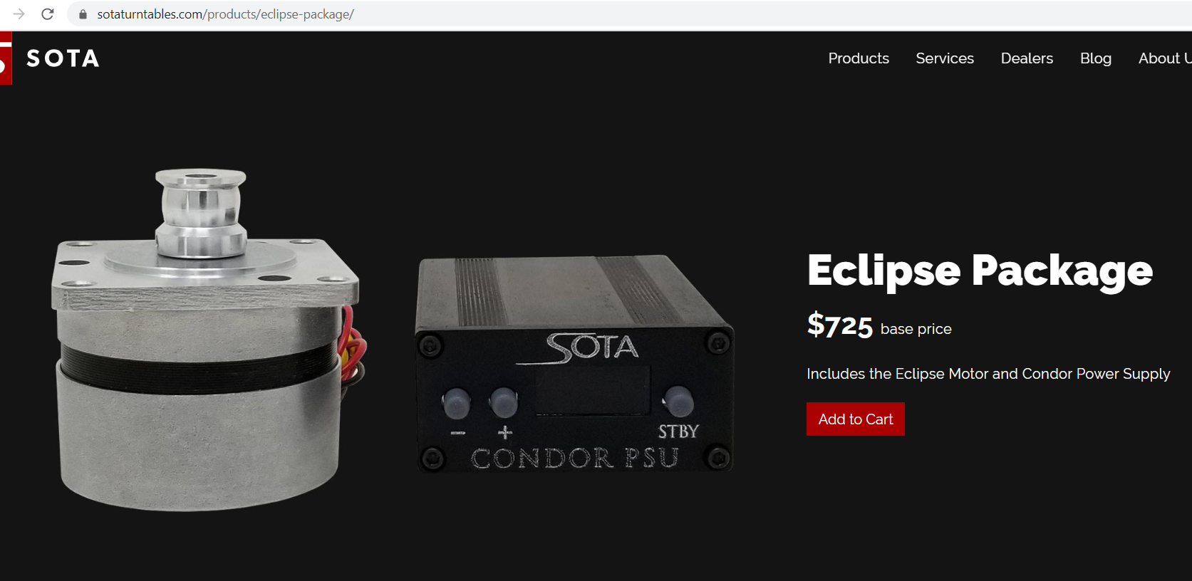

Hello,
I needed a 24 volts dc supply capable of giving 500 mA continuously to power up a controller that will feed a BLDC motor for my turntable.
Most of the work needed to be done to make the motor run properly is done by the controller.
The power supply that the Americain company shipped to me was a 120 volts 60 hertz/cps one not one i can use here. It was a so called wallwart.
Usually these things are not made to last AND they are notorious for polluting nearby gear. SO i decided to make myself a better solution .
I reread some info that supported my ideas.
Greetings, eduard

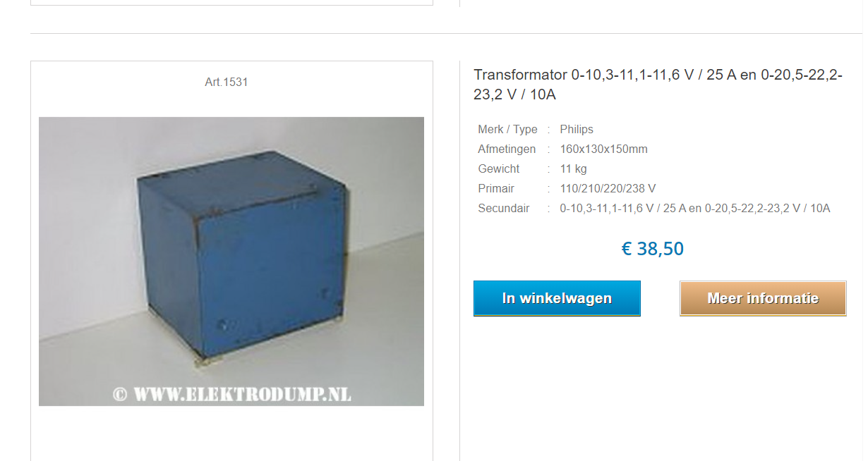

Hello,
Maily for those in Europe i am giving the specs of the transformer i am using in a single rail power supply with choke input.
If you are willing to build an amp that also lloks like a Monster you could use two of these transformers. It has a static screen and was probably build to use in some kind of laboratory gear.
It indicates Philips Made in Holland probably made 40/50 years ago with cost no object '' viewpoint ''
Having two separate different secundairies it can be used for a Le Monstre with LCRC or CLC . Also possible to make a CLC supply for the 20/30 watt Hiraga
Greetings, Eduard

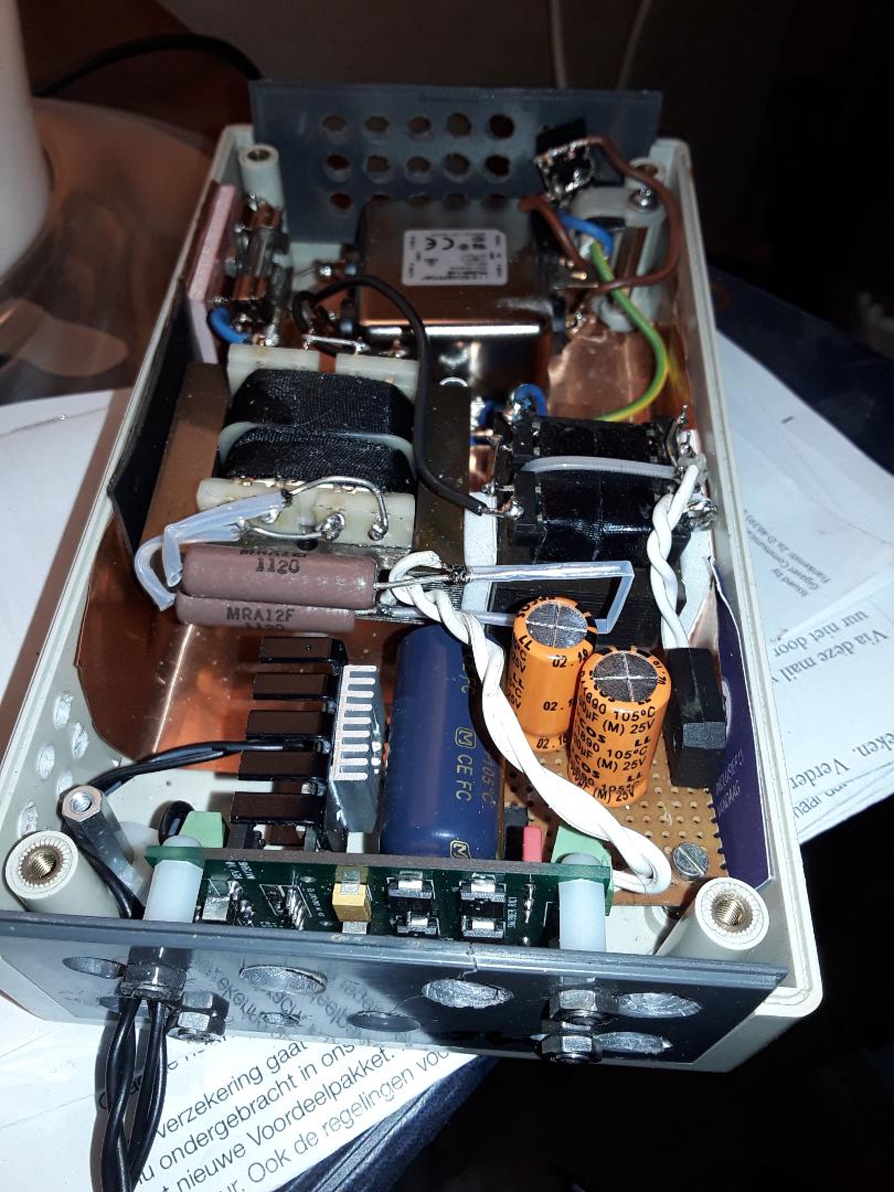

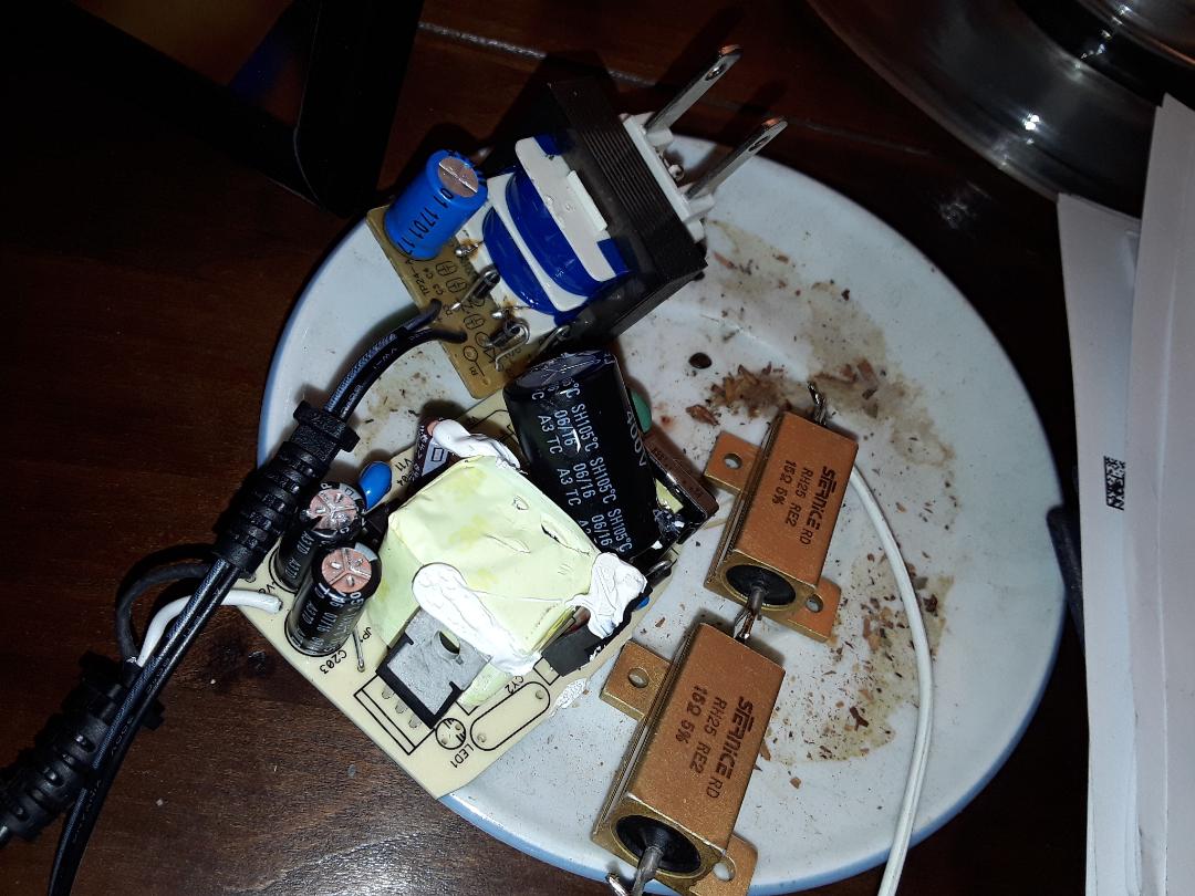

Hello,
I just finished a replacement in one box instead of the two wallwarts that came with my new turntable motor. Because one of them was 120 volts 60 cps only and both had 6 feet output cables while i just need less than one feet and because two big lumps on my power outlet take to much space.
So i made a CRC 9 volt( R to create as little voltage drop) for the very basic 9 volt supply ( just used to feed the speed sensor).
An a better supply ( TPS7A4700 Ultra Low Noise Low Drop Out Voltage Regulator) instead of the flimsy SMPS supply as can be seen in the picture.
Both supplies i used with a split bobbin transformer.
A lot of these Chinese made supplies are using low quality parts allover. Even the copper wire is already tarnished compared to cables i have in stock for decades.
Greetings, Eduard
