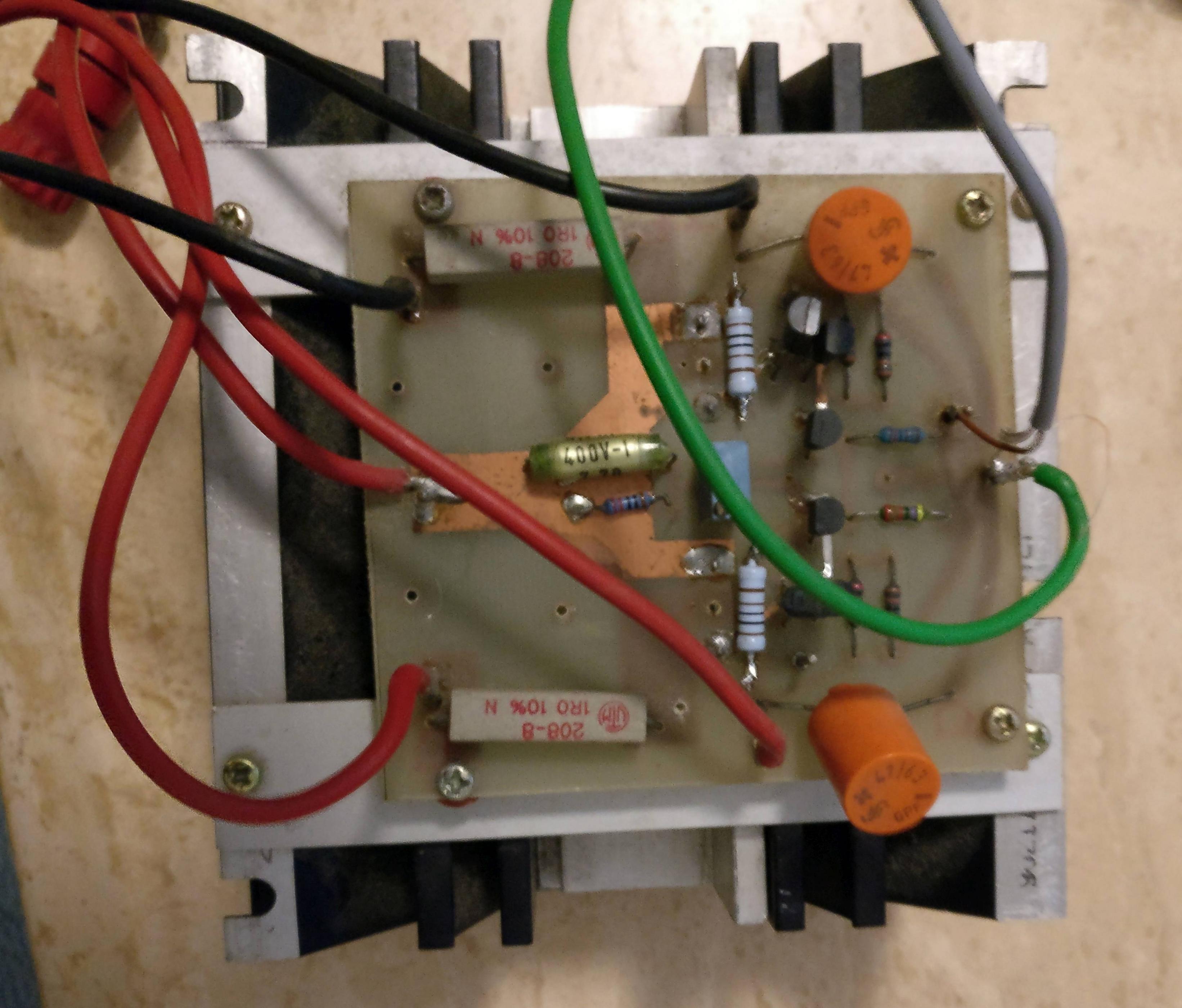

Strange situation with my Monstre, dc offset was drifting over 0.6 volts over the warm up period, and I was not able to adjust it to bring it down. I swapped the two fets and the problem was removed. Luckilyl I had some 2sj72/2sk147 pairs lying around from an old Krell KMA200, these work a treat and seem to be delivering more body over the k74/k170 (modern) combination that was in there before.

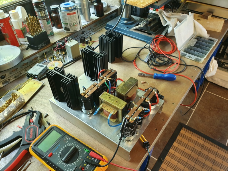

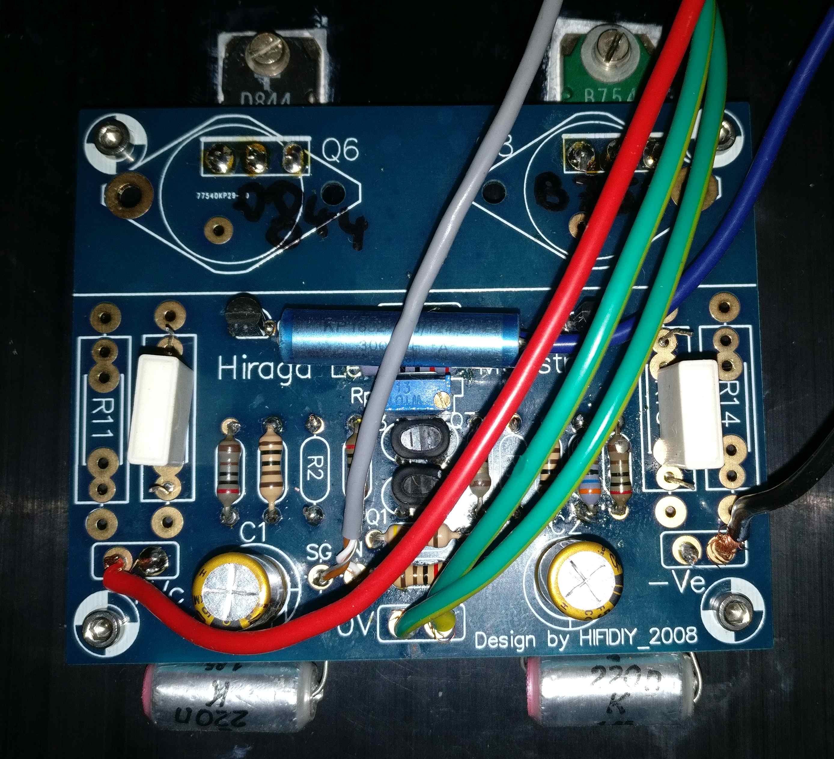

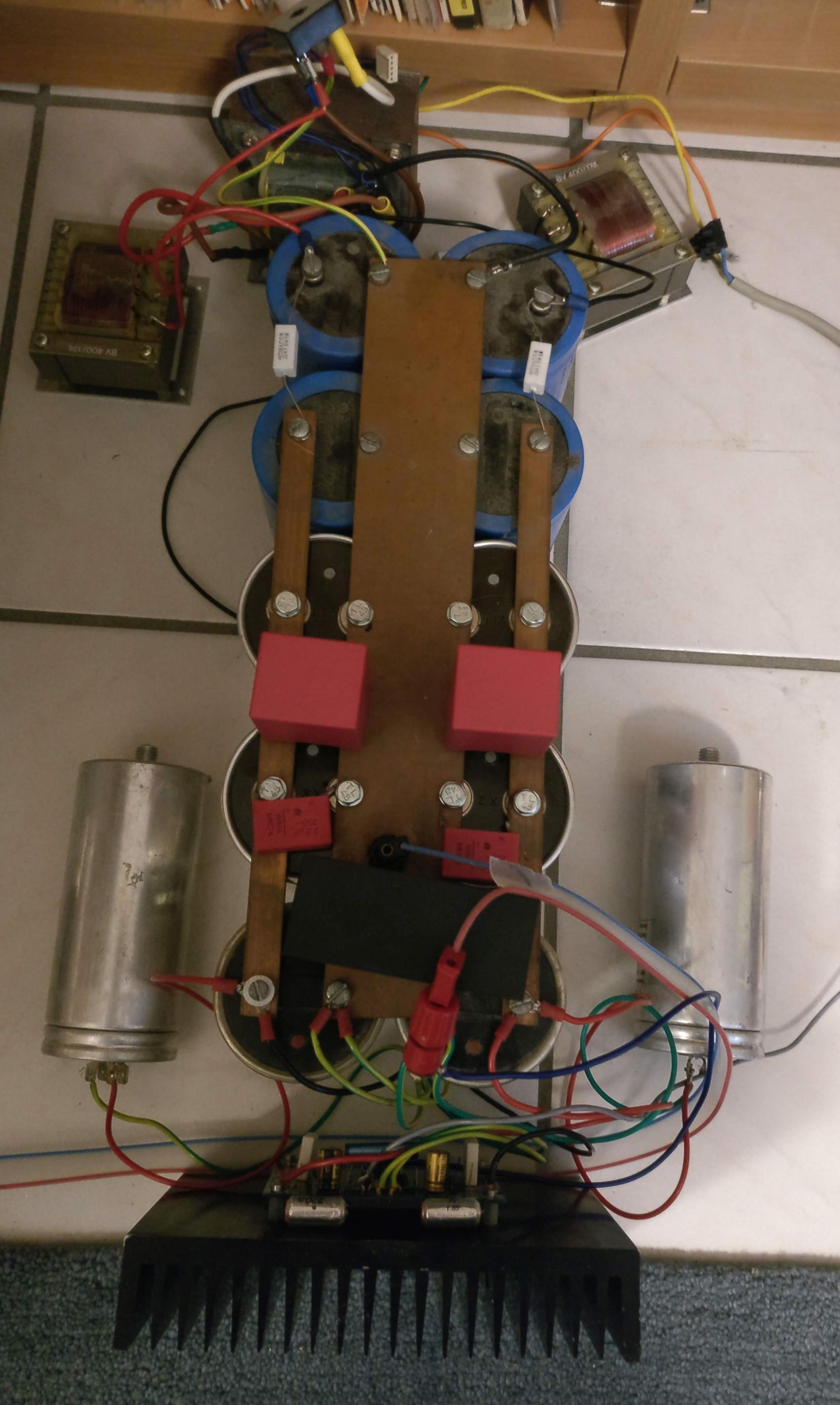

Monster LCRC
Hello,
a little story about a Monster and chokes.

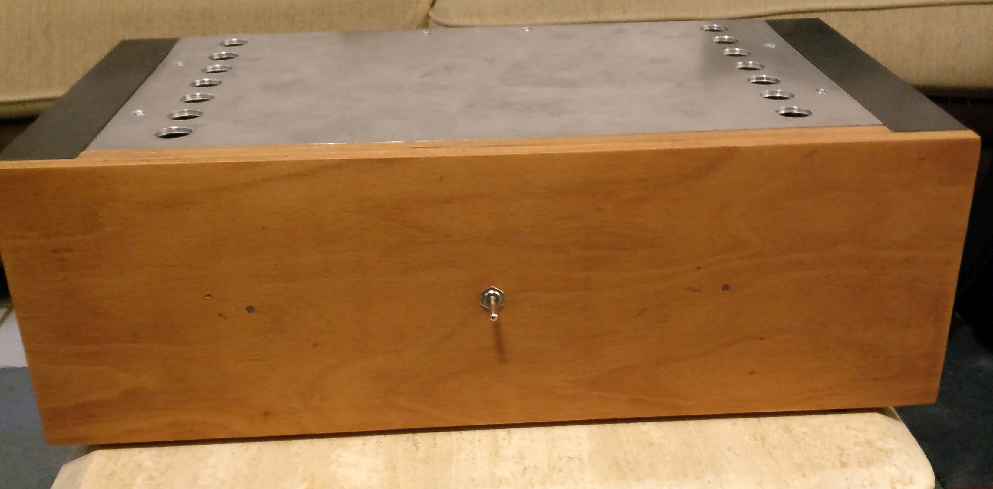

I build my first Monster in the mid nineties, used it for a time and then put it aside. In this time all the transistors where available, so I have a good stock. The power transistors are still available.
Only the Fets 2sk170/2SJ74 where a compromise, Hiraga used grade Y (IDss 2 - 3.5 mA) I was only able to buy grade GR (IDss 3 - 6.5 mA). So the 1k resistor has to be adjusted, IDss 3.5 corresponds to about 820R a current of 600mA.
Last year I decided to build the Monster new with good parts, especially Shinko Tantal resistors. I was not able to source all resistors, so I added some Audio Notes tantals.

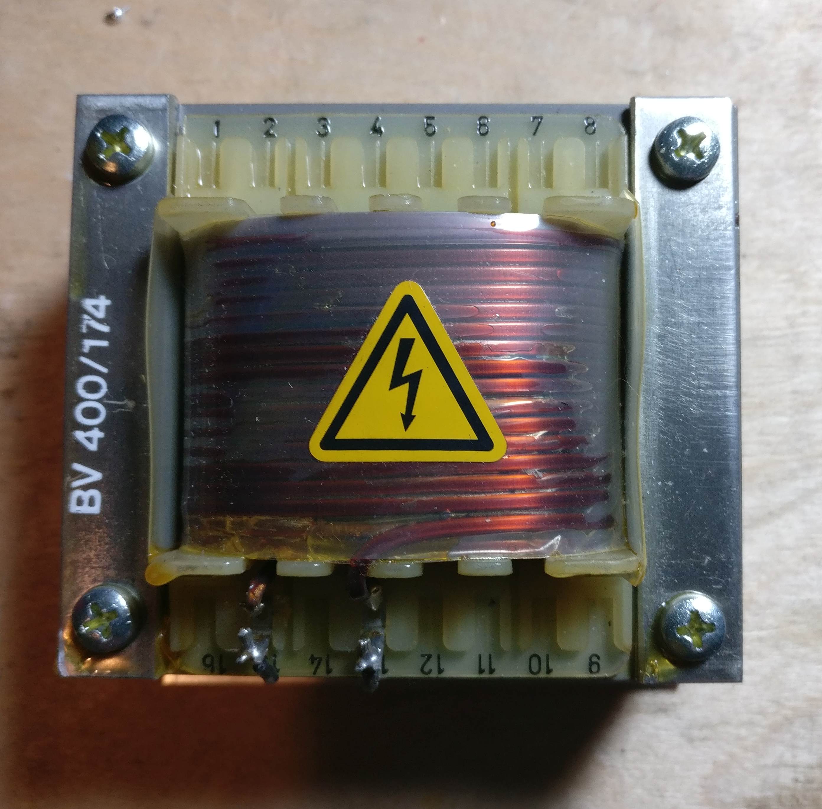

The last evolution was to try chokes. I own some of them, so I first tried the choke shown in the pictures, 0,200 H at the place of the R in CRC. The sound worsens, the stage decreases. may be the current was too high and the core saturated.
Second approach, LCRC configuration, L has only 14 mH but high current potential. R is 0.5R.
The soundstage is back again deep and broad, if there was a slight graininess its cleaner now, only listenable during comparing. I hate hot sibilants and I had some, even better now. This version will stay till I find a better one. Next for me is to try stabilized supply.

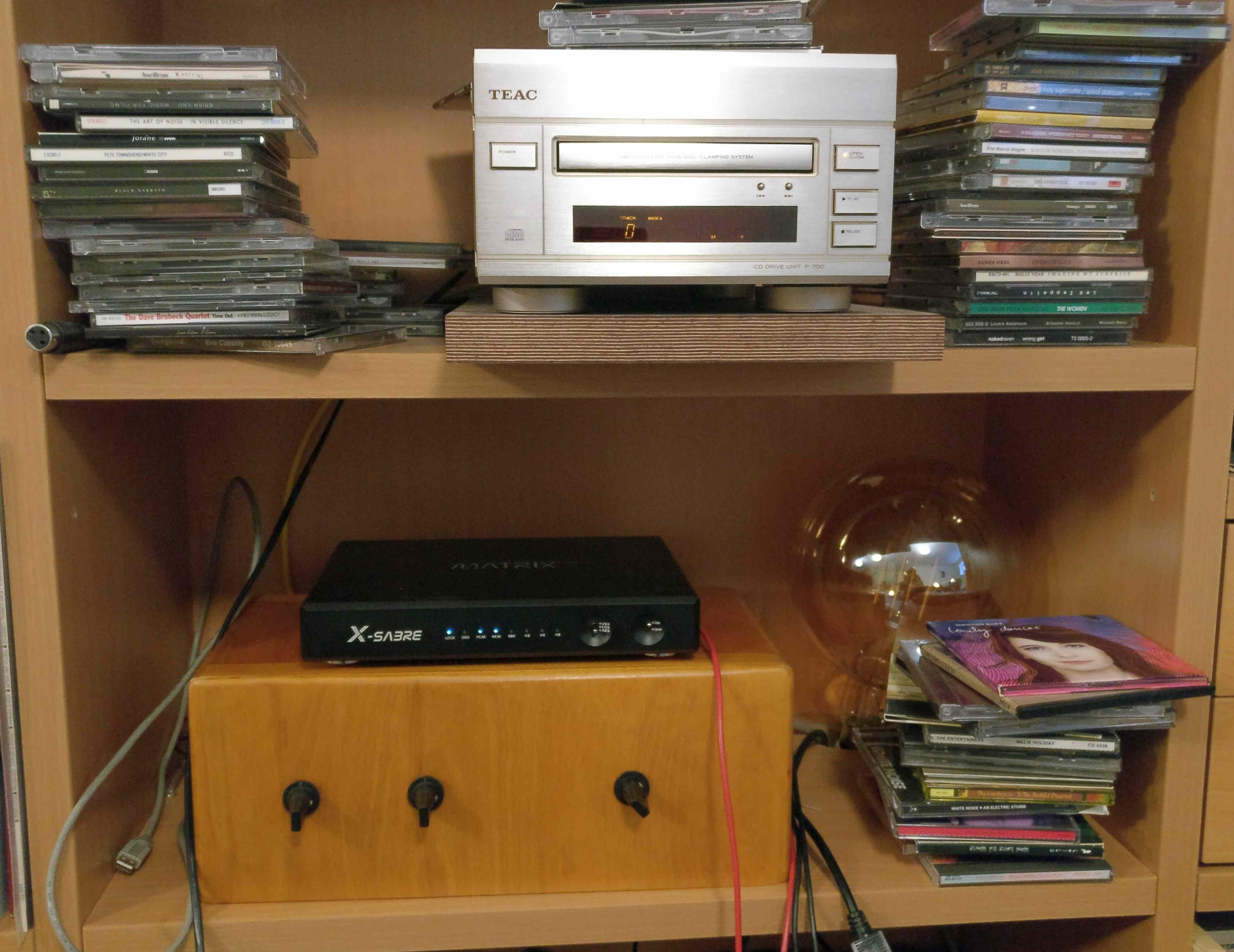

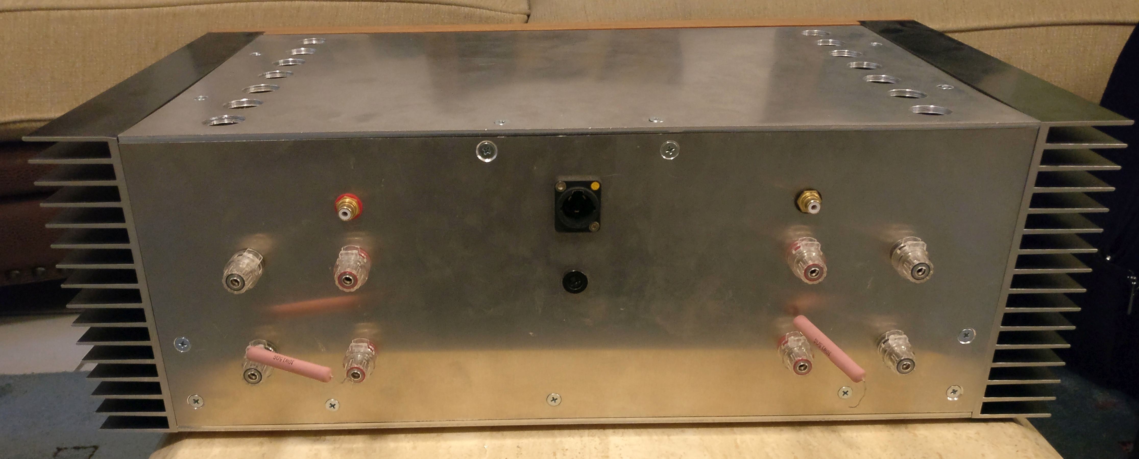

The other pictures: my Monster is still waiting for encasing, it's still a construction area. I build my casings by myself, more flexibility. For example a picture of my Pass F2J.

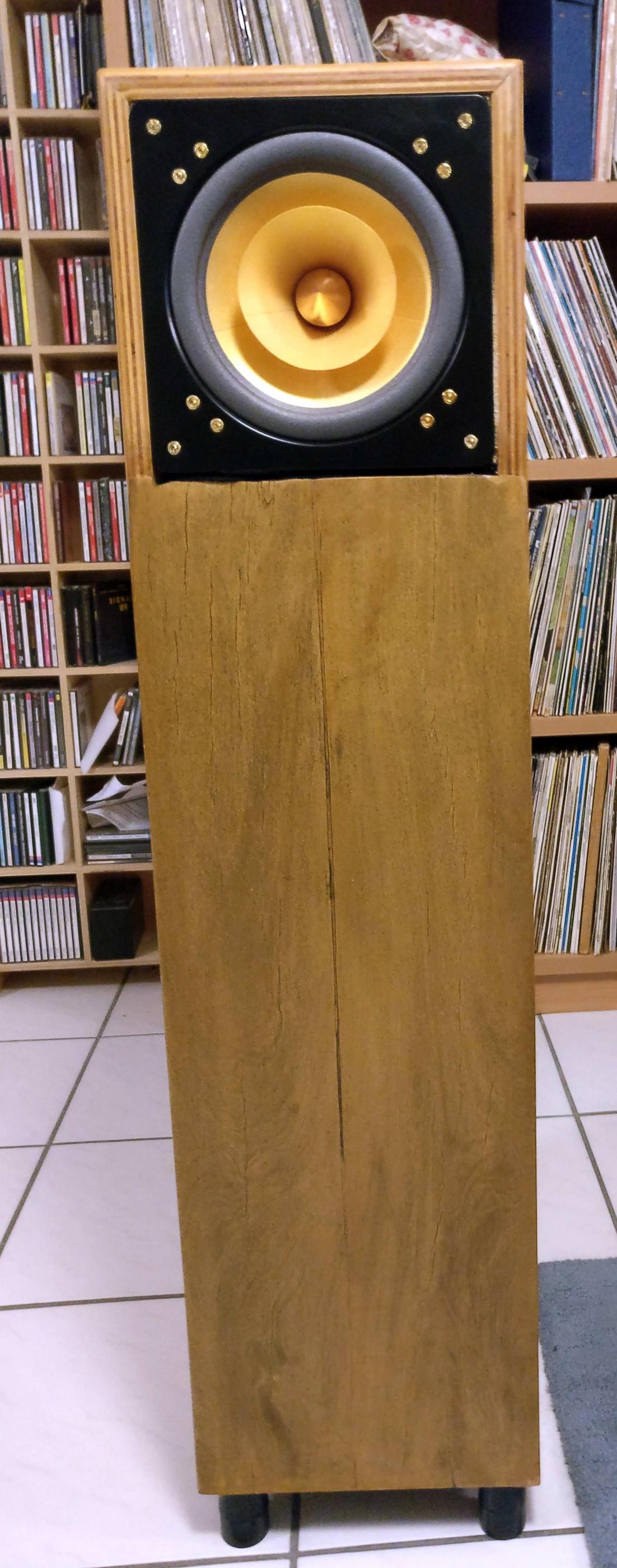

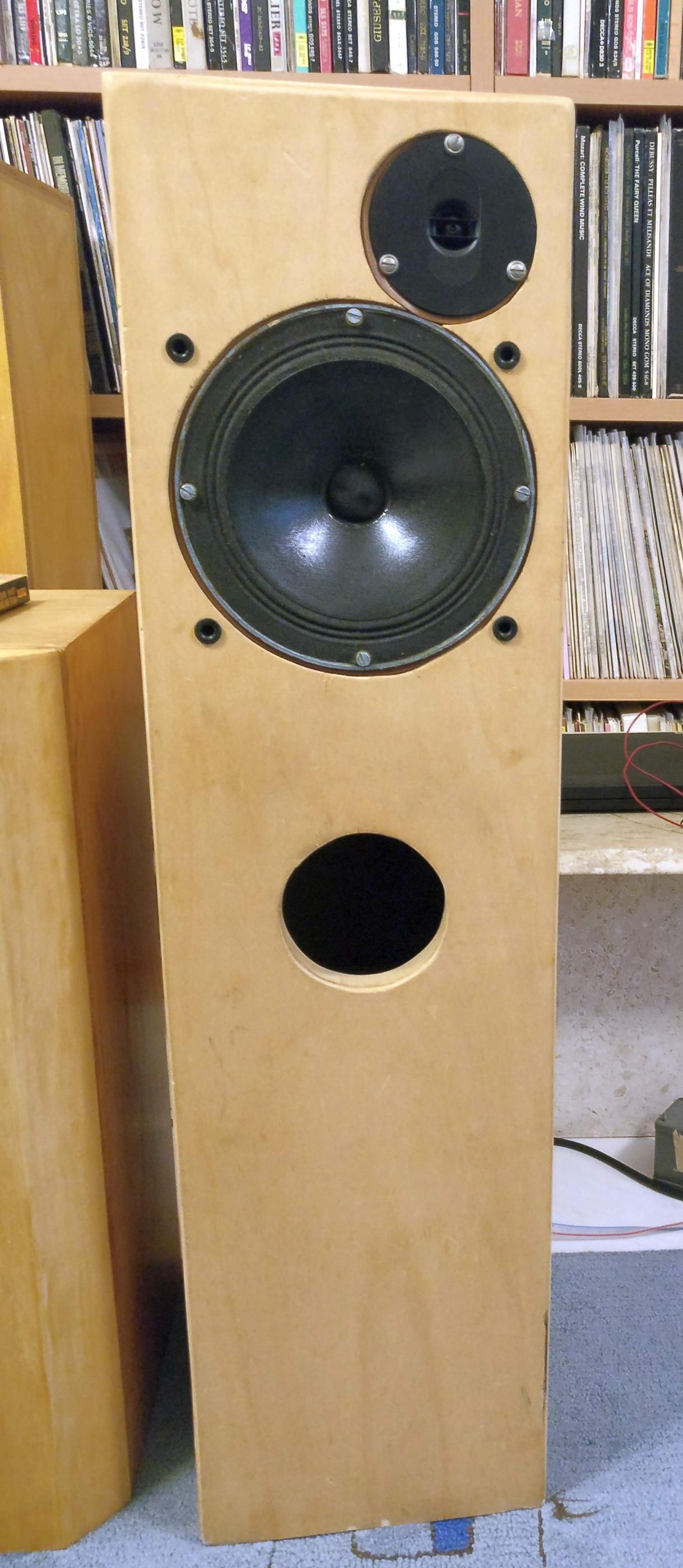

Speakers: some, most of the time Hifi World speaker 1993, Richard Allen Woofer and Audax tweeter. Also Cube Audio Magus and Sonidos fullrange.
Pre: Stevens and Billington TX102III Silver-
Source: TEAC VRDS P700 / Matrix X-Sabre, Platine Verdier, Pass Ono Clone.
Some CD's, more records.
