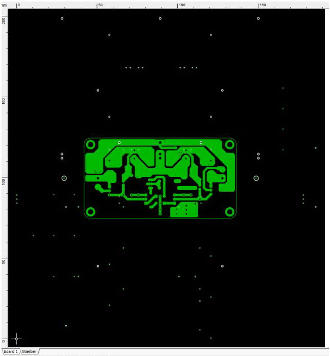

Hello Prasi,
I tried to import the Gerber files in Sprint Layout, but I get the drill holes spread over a large area outside the board itself. See the attached image (here, I have imported just the bottom copper and drill data files).

Hello Evangelos,
There are some settings with sprint layout while importing drill layer ... do explore those options, it solves the problem of inches and mm drill layer coordinates of gerbers in sprint layout. I have done this many times before, but now I no longer have sprint!...so i wont be of much help here...

Thanks, Prasi,
I played a lot with the parameters of drill data and, finally, I managed to sort this out. In particular, "Unit" has to be in mm and I had to try a bunch of combinations in "Numeric format" to get a proper board.

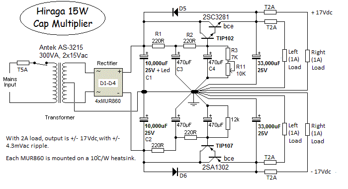

My amp is not the typical 8W, I used higher rails (+/- 17Vdc) w bias (1A) to get about 15W / ch. I have attached the schematic, notice the big cap following the Cap-Mx.
Have fun

Nicely done Eric, yes the huge cap after cap-mx should help a lot.
regards
Prasi

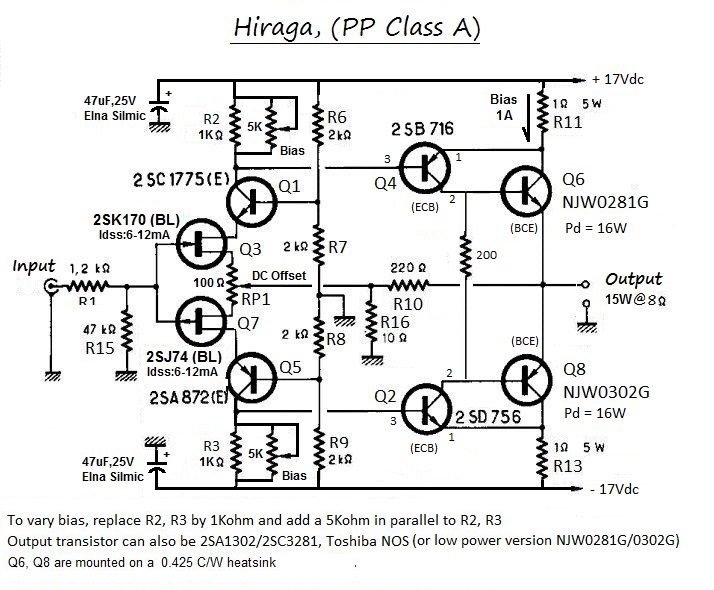

Nice done! I see a 200R resistor between the collectors of the drivers. Is it your mode?
I can't see this in the original schematic.
I have used, 2sk246,j103 for input, all other bc550, 560,TIP35,TIP36 as output.
2SK246,J103,2SC1845,A992,MJL3281,1302.
2SK246,J103,2SC1845,A992,MJW0281, MJW0302 all combination works well.

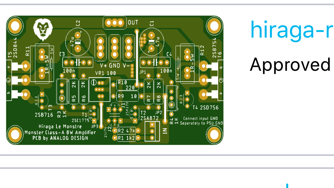

Do you have any pcb for TO-3 output transistor?
I have some 21193 metal can from a great donation!
Do you have any pcb for the 30w version?😎
