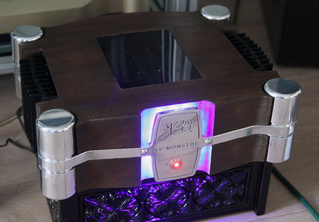

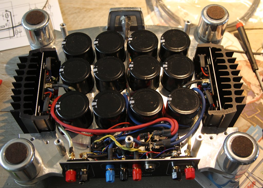

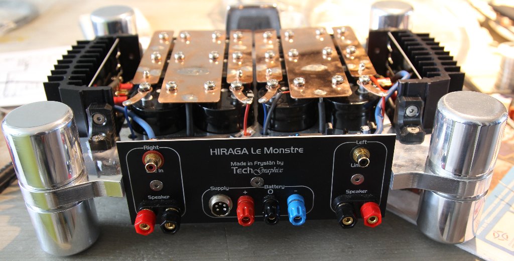

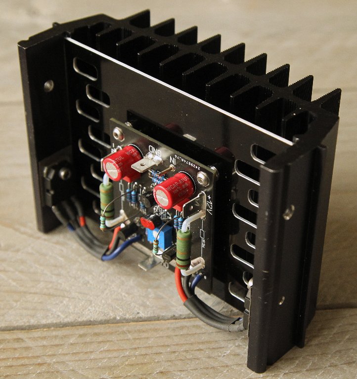

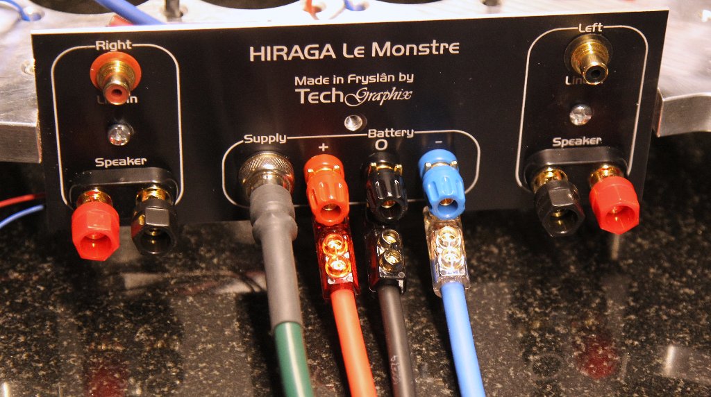

I almost finished my own little monster after years of delay.

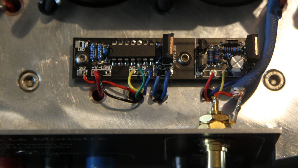

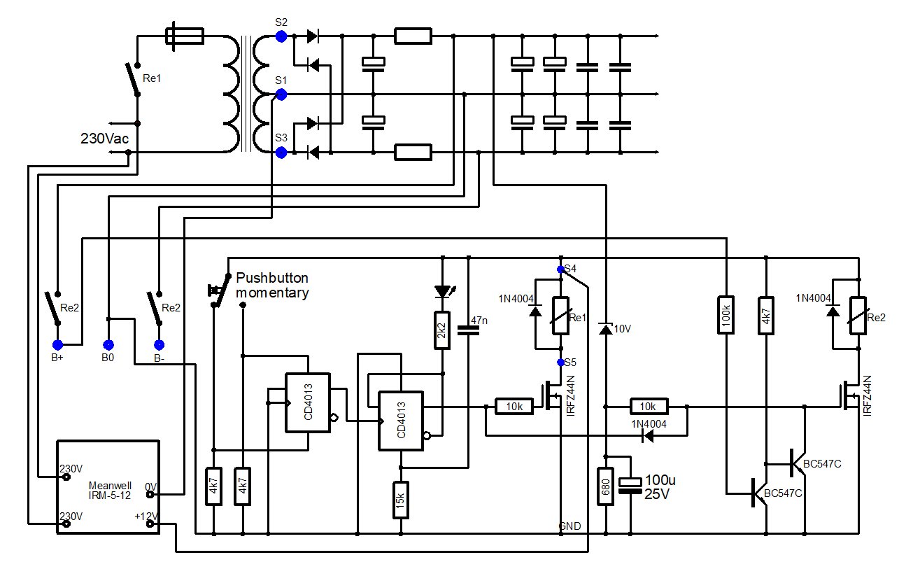

I designed a very tiny switch on/off circuit which also controls the batteries to switch on when the voltage over the second part of capacitors rises above 13,2 V and only when the batteries are connected
The pink on the photo is actual clear blue to the human eye: a number of blue LEDs embedded in the frontpanel will give it a blue "ambilight" when on..

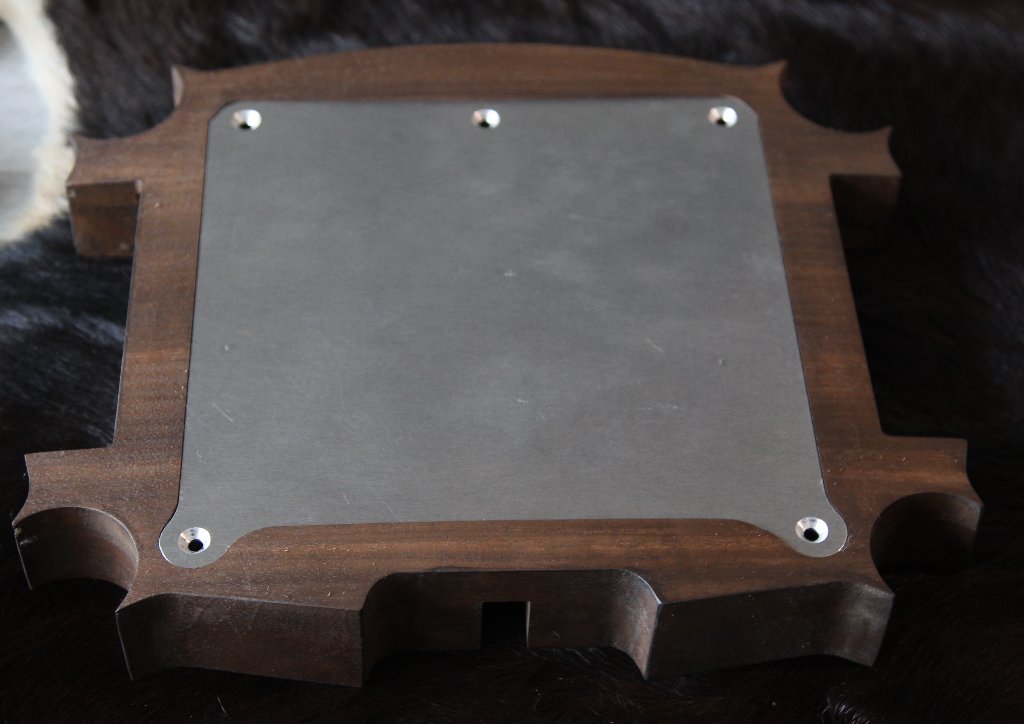

The wooden covers, on and below the 15mm thick aluminium middleframe will be made from American Black walnut..

WOW! That is beautiful. Quite a remarkable build, congrats!

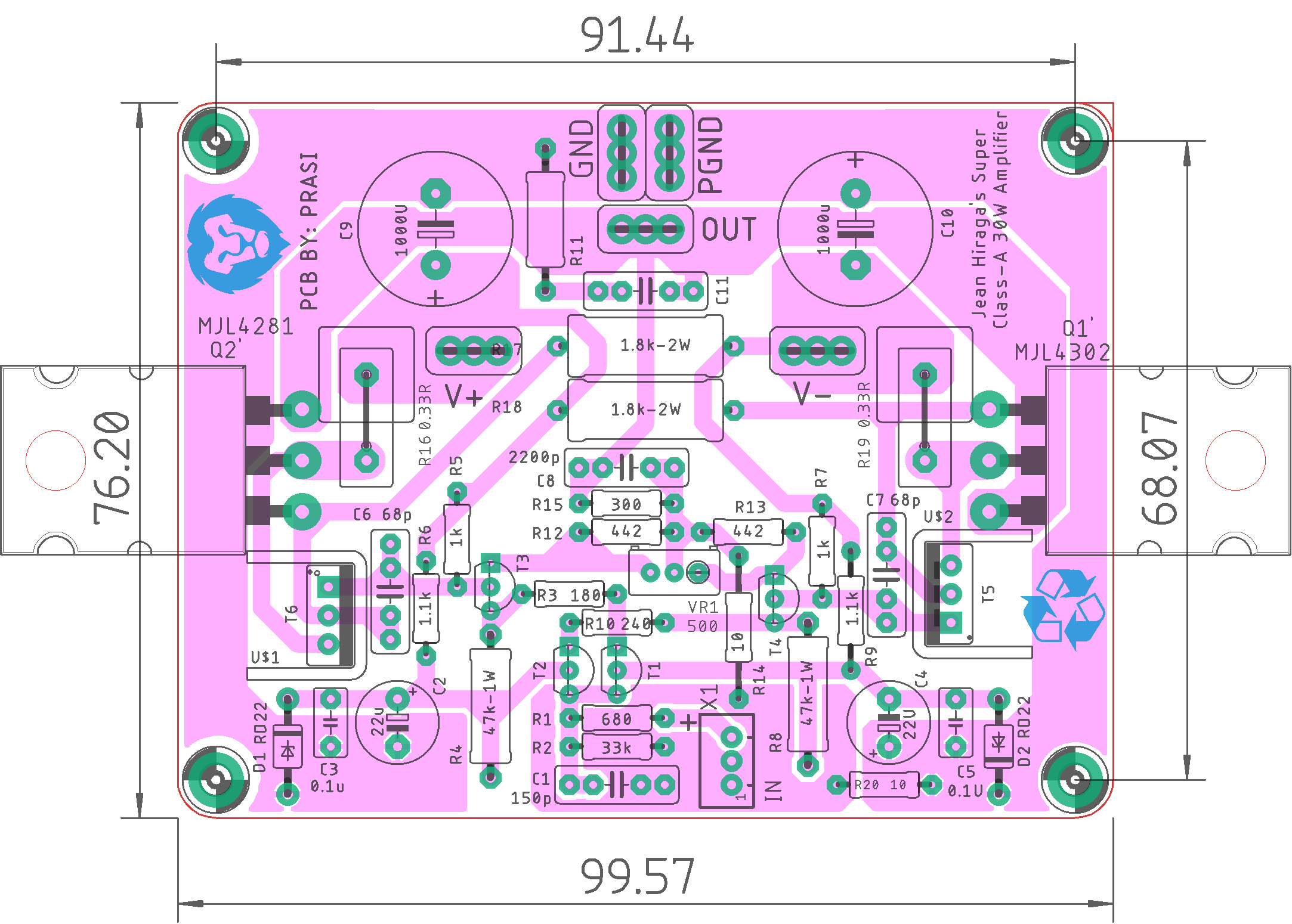

Hey Prasi, can you position the transistors so that the board can be mounted horizontally on a vertical heat sink.

@ SanjeevM, I am already working on the layout and here it is almost final. I have provided zobel option and input ground lift.😀. Even TO-3 devices can be mounted via short wires on aluminium angle on the same vertical heat sink of 3" length.

here are the pdfs and gerbers.

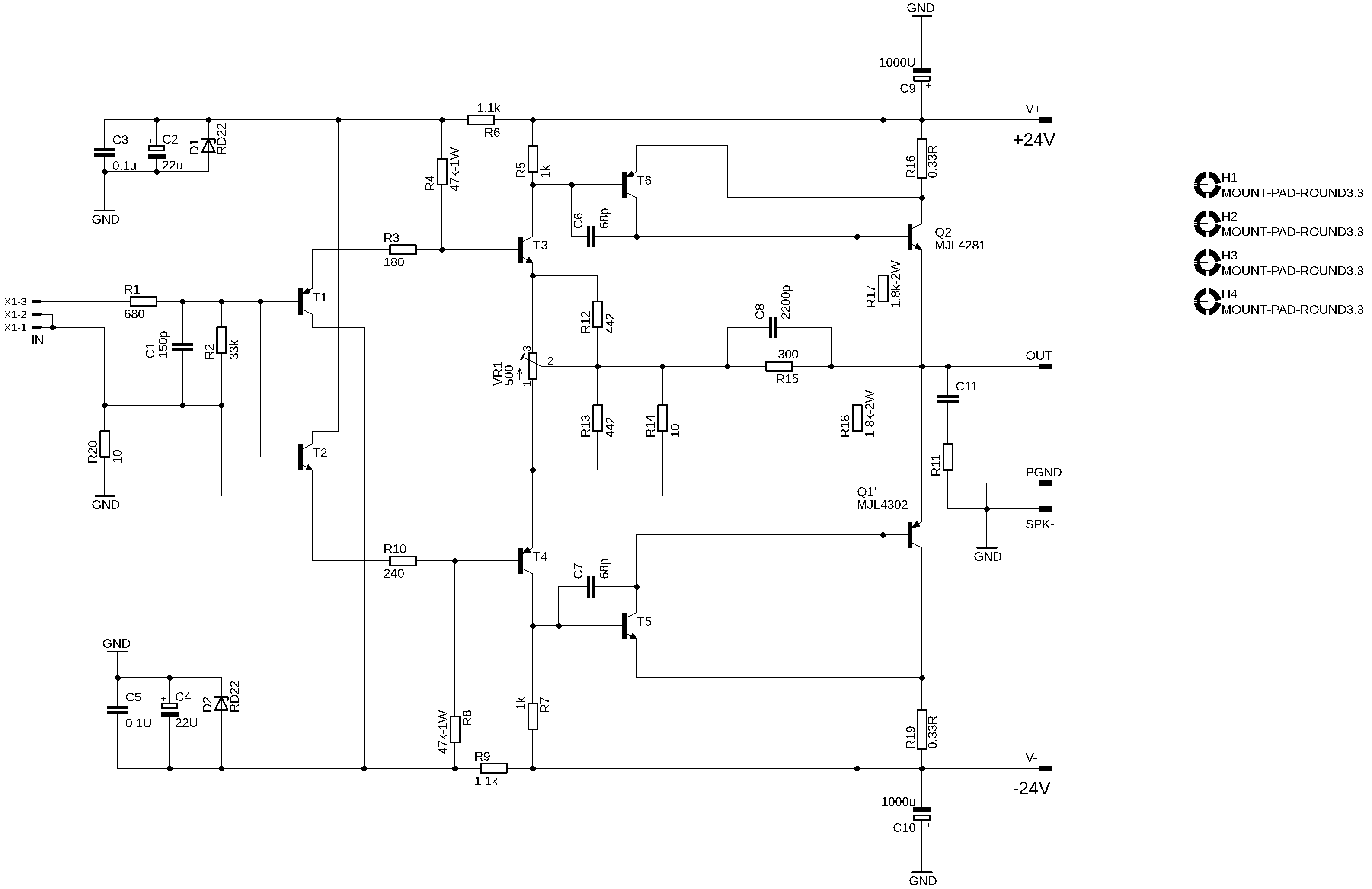

After a short listening i must share my finding.
What is the used transistors.
J1=2sk246
J2=J103
T1=bc550c
T2=bc560c
T3=2sa1837
T4=2sc4793
T5=MJL3281A
T6=MJL1302A
R3=2k2//1k multi turn
R4=2k2//1k multi turn
I have test other transistor combination BUT stay away from high voltage transistors as ksa992, ksc1845 for the ccs, T1, T2.
I spend all the day trying to understand why one chanel playing so different, no bass. 😕
Now i know... T1, T2 bc550, 560.

Hi Prasi,
MOVE + CTRL and MM scale so you can avoid x,xx millimeter.
Or simply select in info modus edit the value in full millimeters.
JP
JP

Hello JP,
Thanks for the suggestion. However I still like to work in mils and fractions of inches (e.g. my grids are always at 0.254 mm or 10 mils.) As eagle's many packages are in inches and their fractions.
regards
Prasi

almost finished.. Unfortunately, the big mill broke some parts from the lower cover so I have to redo that..
And again.. the pink light is actually just blue.
Kees

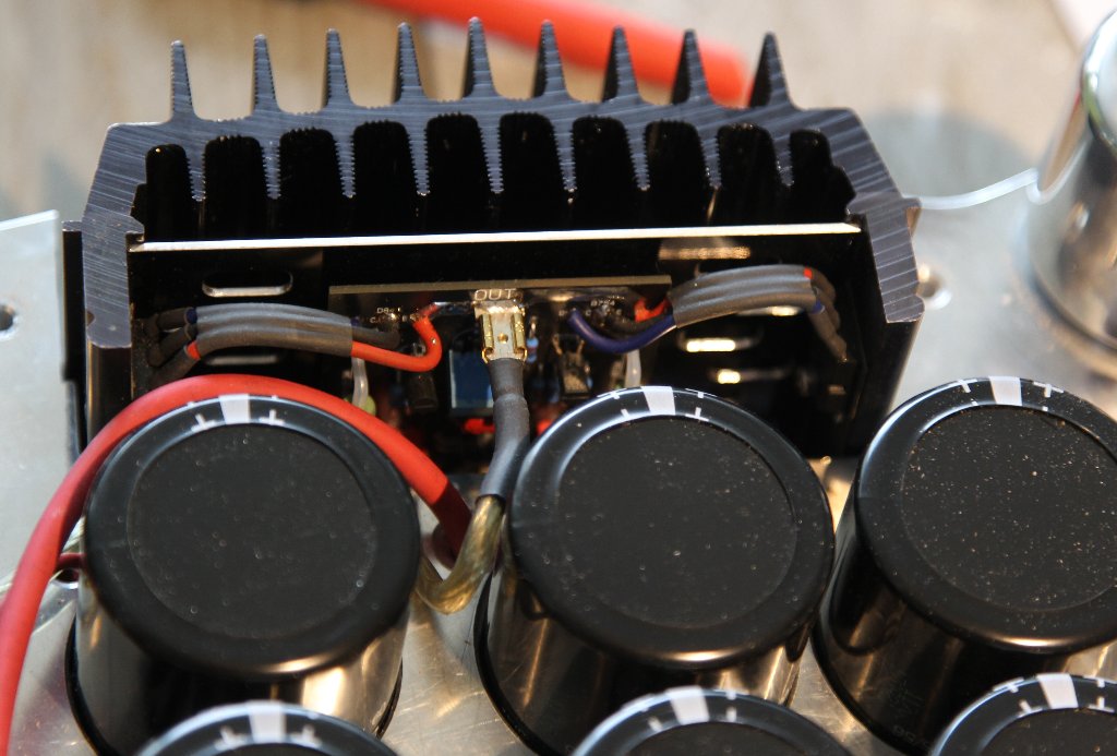

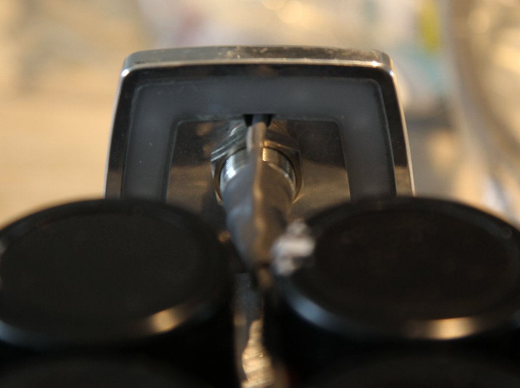

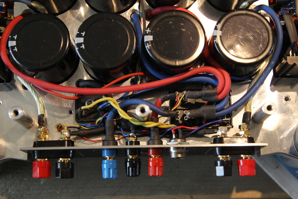

It's finished a few weeks already and plays every day, all day.. i'd like to share another few photo's from the inside and the diagram of the push-on-push-off circuit and delayed Battery switch-on (which only works when the batteries are connected..
Kees

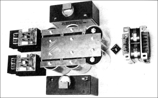

Hi all, I have a minor issue with my Le Monstre that I bought second hand from Netherlands some 10 years ago.
It has the original output stage with 2sd844 and 2sb754 but..... the power supply is defenitely not original, not even resembling the original power supply. Well, maybe the transformer is ok but the rest is a mix of caps from different eras and not even close to 300 000uF in total. I want to change this now cause I want to hear what the amp can do with proper feeding.
My idea is to use the medium stage power supply according to the shown picture (taken from the original article in le Audiophile) but I need help implementing the batteries.
When you build the big power supply it is clear that you implement car batteries which connect when the main is disconnected via a fourway switch but when you implement this smaller power stage (still going to have 2 x 12V 12Ah batteries and 2 x supercapas 0.47 F) there is no clear picture how to implement these batteries.there is no schematics for this stage.
Can I get some help scetching this implementation I would be very greatful cause I am not shure if the batteries should be switched into use or used parallell with the caps without any switch and if so.... will they serve as superbig caps or will they have to be charged separately and then connected via a switch.
I really want this to be close to the original while the output stage is still original cause it will come a day when I have to rebuild the whole amp and it will never be the same again.
Please, need the help since I am not able myself, I just know how to duplicate the schematics via physical work onto a pcb, not how to do the schematics themselves.
Sorry, forgot to say that I intend to use two separate feeds (mono) so in total 12 x 68000 uF plus the supercapas.
