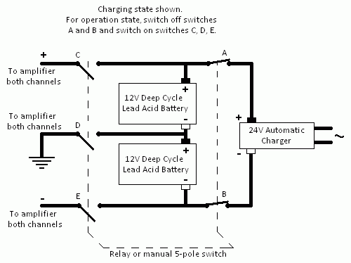

That is what I was thought, to try the amplifier with batteries only first, as two 80AH batteries will last more. It is also a bit cheaper than aqcuiring these big caps.
I think the biggest problem with batteries is the voltage variations as the battery discharges, which will affect the bias setting, so one should continuously set the bias or should use the battery for less time before it descharges completely and have a voltage drop. Of course in such configurations only deep cycle batteries should be used.
Also voltage and amp meters must be used to contonuously monitor the voltage and the amp drawn. Since the PSU will be in another box changing the configurations won't be a problem.
I will let you know about the results, but I feel that appart from the time restriction factor of the batteries it won't dissapoint, as it is clean and straight forward. Anyway five hours a day continuously is very fine to me 🙂

One last thing, I am thinking of replacing the bias resistor on the base of the drivers with another trimmer, to easily adjust the bias for voltage differences in the battery, when discharged. I am not sure about the sound effect so this is a thought yet. but if I decide this I have to adapt the pcb accordingly.
I just thought a possible configuration for the PSU section.
good idea...
looks like some more monsters are on the way 🙂
