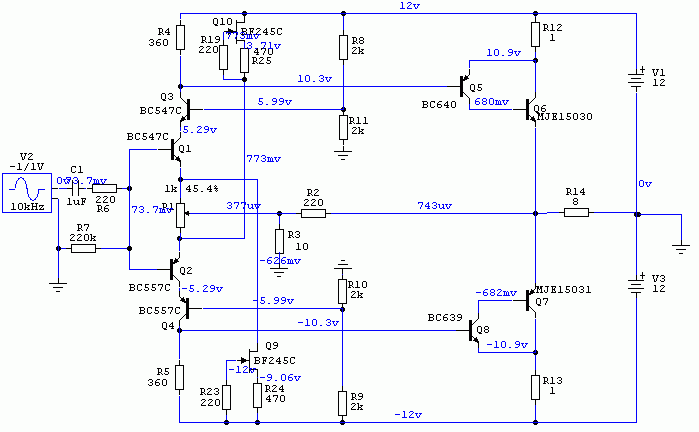

thanks a lot for the schematic! in fact i had in mind to replace the fets by a bc5xx in darlington.
ericfe1975 said:thanks a lot for the schematic! in fact i had in mind to replace the fets by a bc5xx in darlington.
Why would you need a darlington here?
ericfe1975 said:the bf245 is a FET 🙁 the idea was a monstre with no FET at all ...
BF245C acts here as a constant current source (CCS) - you can use any 6mA CCS or just use 1K8-2K2 resistor instead of CCS

Actually, if you want to make a Le monstre without fets, it's basically becoming a Hiraga 20w, all bipolar :
http://www.tcaas.btinternet.co.uk/hiraga2.htm
and here on diyaudio:
http://www.diyaudio.com/forums/show...&perpage=25&highlight=hiraga+20w&pagenumber=1
But the sound is believed to be different, more precise but less transparent from Hiraga himself opinion.
But once again, nothing wrong with fets and you get a nice quadratic curve from them, not a nasty exponential!

Yes i have noticed that a monster without jfet is like a "la classe classe A hiraga " 🙂 .
Well as Mr pass said, after all those years of progress for sure the monster can take some benefits.
the point is not "improving" the monster, here the point is trying a le monstre without jfet and hear it.
I do not belive that someone serious may have the arrogance to say " you know what? i am going to improve one of the best design in a class audio simply removing the fets"
and certainly this is not my case. I am not saying either that jfet sound bad. not at all!!! every jfeted amp i've heard sound very clear and warm.
thx for the schematic, i just got a good one in my own work, fully implemented thanks to the clarty of my ideas ( 😉 lumba )
