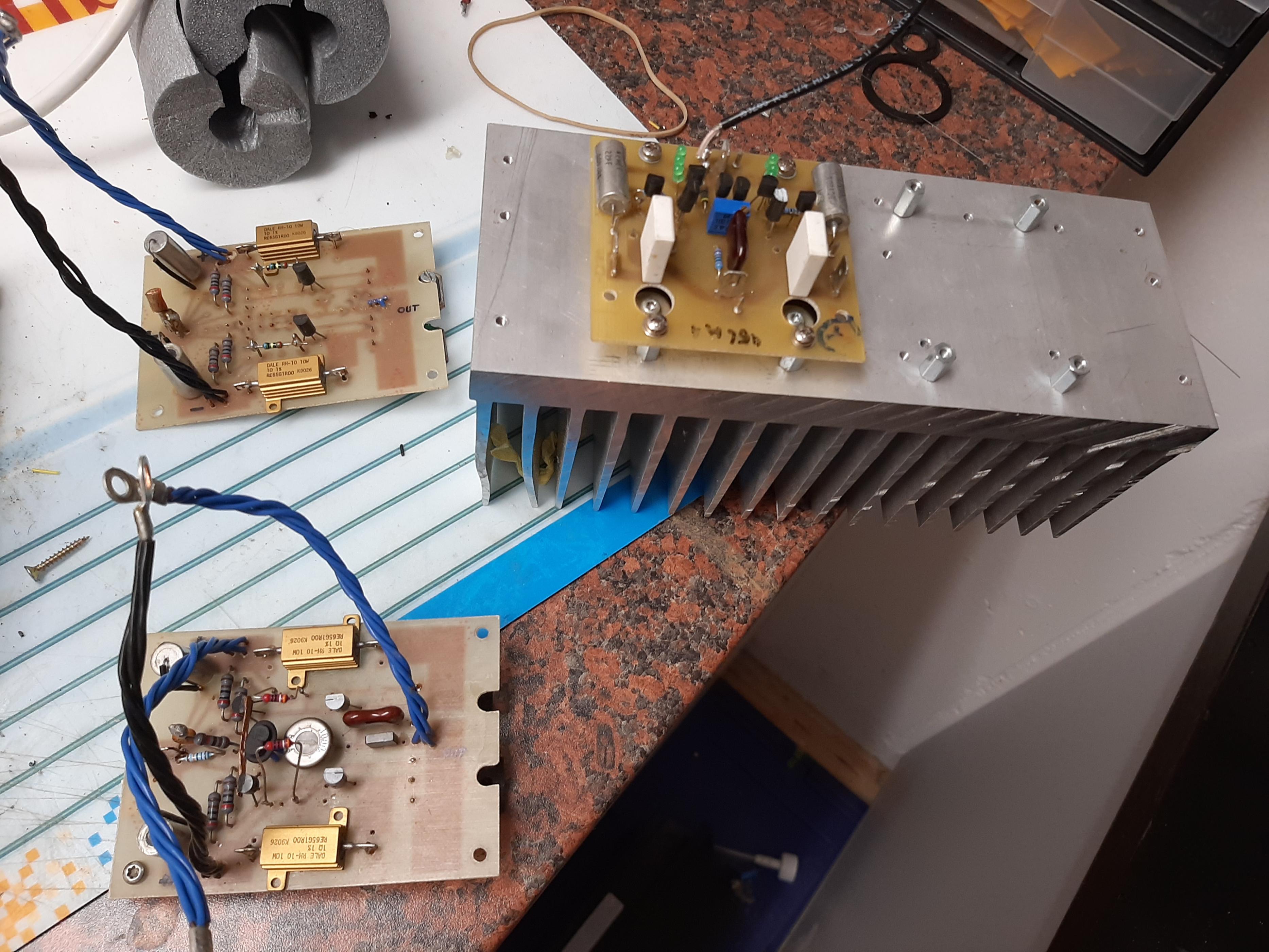

Just another topic with 8W Monster. I hesitate to put my 2 Monsters into encasings because they will be very large and heavy. So I tried, just for fun, to use SMP's. Each chanal 2x14V/5A (put me back 20 Euro for all of them). Surprisingly it sounds really good, the music losts a little bit of weight in the bottom but is clearer. For me the most importat things: the amplifiers are still dead silent (speaker 8Ohm, 94 dB/Wm), I use a little filter, and the palpability is still the same like befor with more than 3 F of capacitors each chanal. Now its going to be very cheap to have a extremly good sounding amplifier.
The PCB's are from Jims Audio, all fets and transistors are original, resistors Tantal film, 0.6 A quiescent current.
We tried Smps from Meanwell. The charming of the voices was gone. My Monster PSU is 470000uF with 35 year old Frako caps.
Recently I ve did excessive damping of the amp case with car matts. Even the caps were placed on matts. Was surprised of the details of music that came out, and never heard before.
Currently I use the original 8w design and use the original output transistors which were pulls from old devices.
There is a substantial sonic difference between the originals and todays "equivalents"
How do you describe the sound difference? Which one is better? I'm using a modern output transistor of the same code with the original. It was from 20 years ago, Panasonic brand.

There is much more depth and clarity, almost an airiness or transparency in the music that was not there with the transistors that came with the Jims Audio Hiraga kit - The bottom end seems lower and cleaner too.
I use it with a Salas DCG3 pre and a pair of Altec 604-8G's in 9cu ft cabs, and the combo is absolutely amazing, full credit to Salas and Teabag for the GB's.
A few years ago I asked Jims Audio if he could get the original transistors and after some months he got 20 and traced them all to make up two pairs, and thats what I am using now.
He also has it as an item on his ebay listing and quite cheap, it was a very worthwhile upgrade.

If measured I'd suspect you'd find clear difference in 3 characteristics namely :There is much more depth and clarity, almost an airiness or transparency in the music that was not there with the transistors that ...
1. output impedance
2. harmonic spectrum
3. phase of 2nd harmonic
Most of which can be fine tuned using 3 potentiometers P1-P3 described by Nelson Pass in his F5 Turbo article and ratio of the feedback resistors. Not easy, mind you, but doable.
Wasn't there a Carver guy that "tuned" amps to imitate the characteristics of some of the big names. He probably did it the way you outlined above.
I think throwing in another two pairs of trannys is simpler and closer to the original designers intention, plus less items/paths to go wrong.

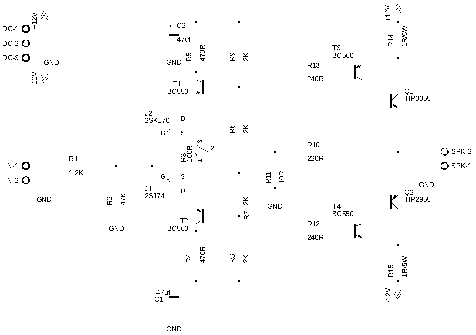

Everyone talking about a le monstre with a completely different circuit and transistors is also off topic because it will be different amp. Could be good.

Thanks Aubmar. I will try to design my own version soon (using modern transistor).
Have a look here, it is well worth 16 bucks - you can use the modern equivalent to get it up and running, and it will be a simple switch to change them later and you can hear the differences for yourself.
There is the matter of Y grade K170/J74 pair that new builders need. Klaus Scherm solution won't produce the same sonic signature. 🙂... I think throwing in another two pairs of trannys is simpler and closer to the original designers intention, plus less items/paths to go wrong....
Yes, currently I'm using something similar from Panasonic. But I have never used the original small package transistors.
When I change the output transistor, everything else will change too. It's not going to be Le Monstre anymore. But I think the most critical one or the limitation will be the driver. I have almost complete collection of Sanyo video transistors to choose from.
