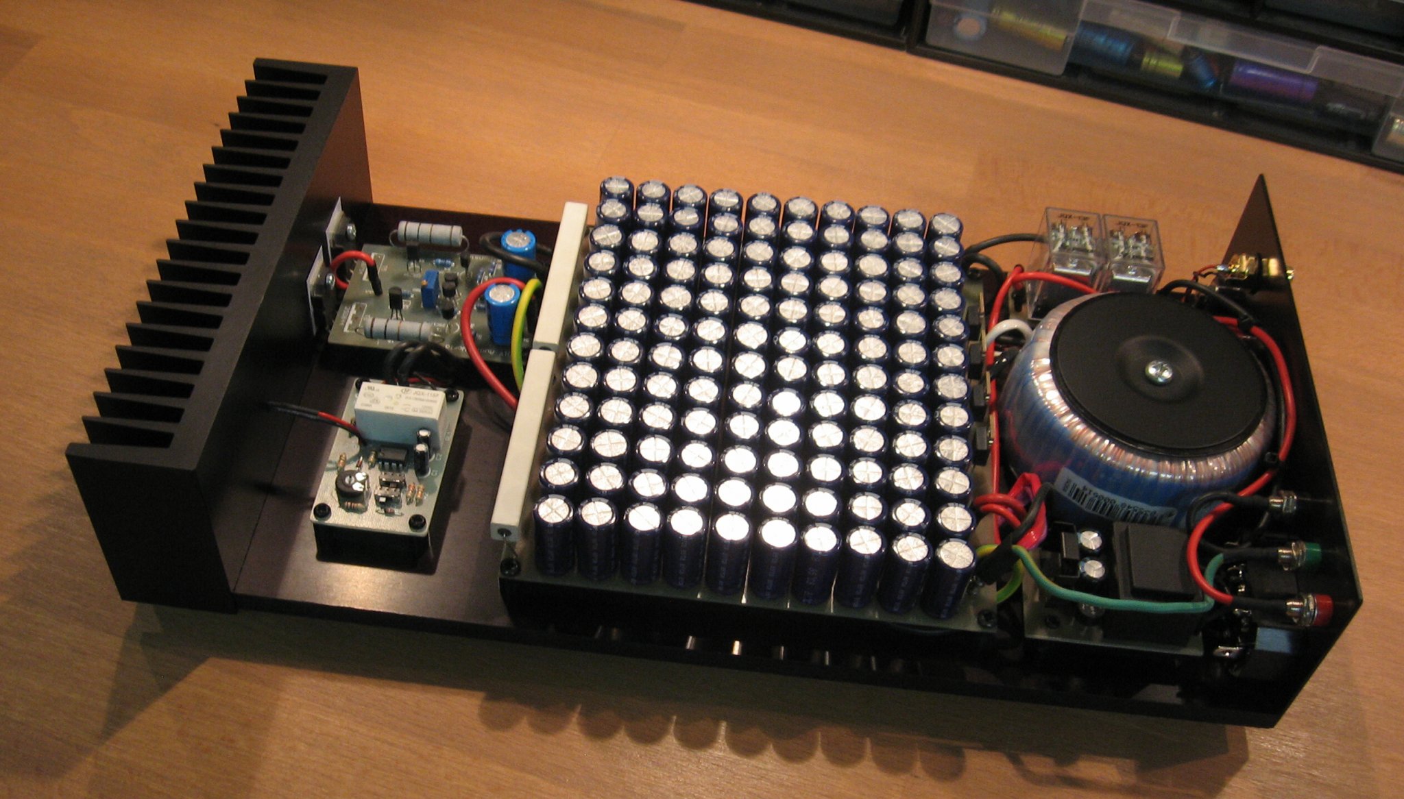

As I just stumbled over this thread: It is remarkable that people are still building this great amp after so many years! My first one was an order by some friends who needed a presentable build for an exhibition in 1984. It still lives and is operational ...

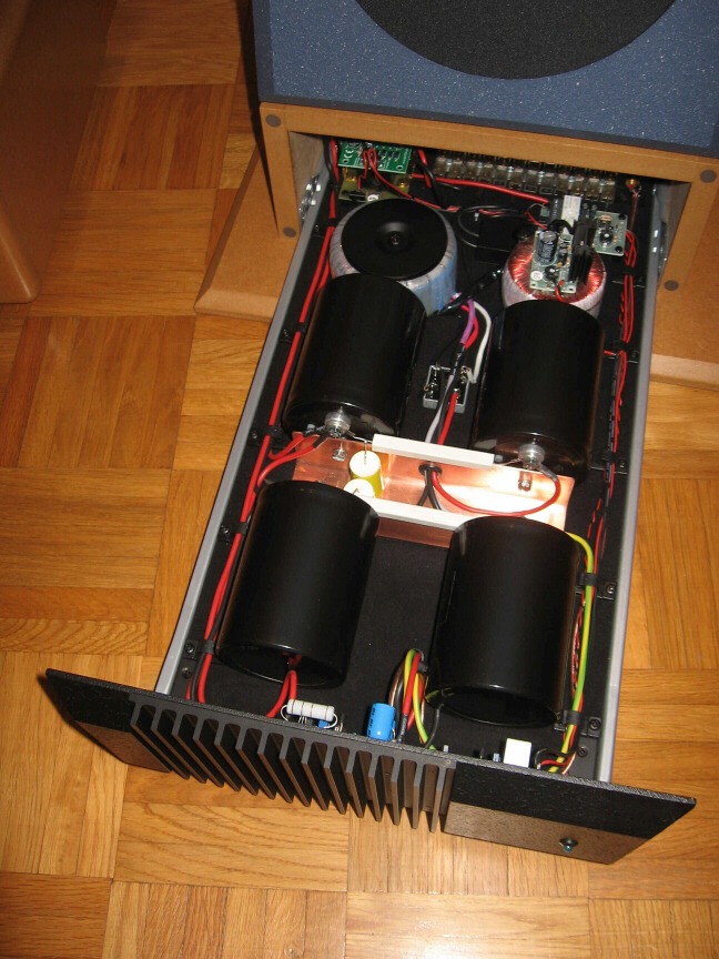

After quite some time a pair with a somewhat reduced CRC supply ended as „drawer"-amp in a high efficiency speaker setup.
A stand-alone mono version ist also still in use, incorporating a budget CRC supply with a total of 120 caps with 4,700µF each.
Each of these amps uses the original PCBs and Transistors, each is still a real pleasure to listen to!

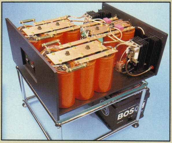

I do remember that with the MC preamplifier Hiraga designed there was an extra resistor to kind of balance the current being drawn by the positive and the negative side of the circuit. This was also a supply that used batteries.
Sure there was a Cosmos trim potentiometer to set the DC close to zero.. But i think that if both sides dont draw identical current or if there some kind of difference between the batteries during discharge DC will change.

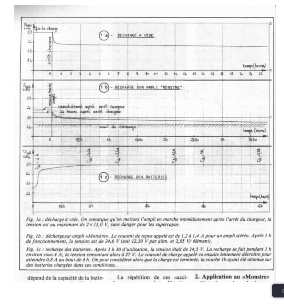

I remember reading the effect of using car batteries was big. It was described in NR36 L'Audiophile published autumn 1986. Back then they used a set of 40 or 45AH car batteries.
Especially the last decade battery technology has changed a lot and there has been the introduction of supercaps with more F and higher voltages. If you dont go for the designs using lots of current it is possible to construct something that can work for a few hours before charging again.
There is a supercap circuit available that can be used in several ways and does nor require long charges in between listening sessions and can even be used while being charged. Look for Iancanada here on this site.

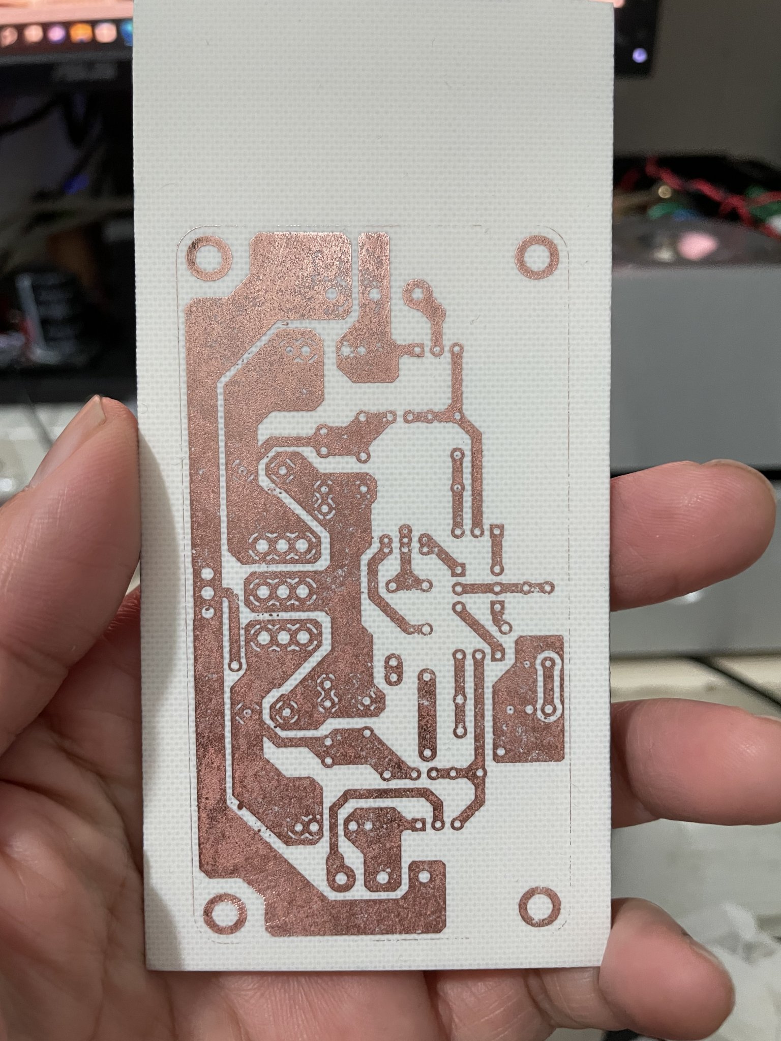

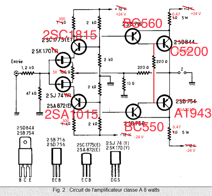

Hi all hiraga mamber
please help to correct the value of the schematic resistor and transformer that I use 18-0-18 after rectified at 25v. Or can i use the schema and value with this component?…
is there any other good scenario for the component i have :
SK170-J47
2SA1015-2SC1815
BC550B-BC560B
2SC5200-2SA1943
Best regards

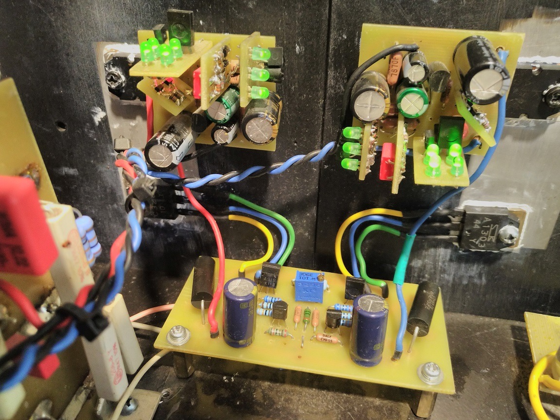

I recently brought Le Monstre back to life, replacing Hiraga’s 20W A class amp.
The difference from last year is in the regulators, they are quite modified as you can see from the picture, they have been improved with new current sources and low-noise references with the help of Mr. Walt Jung.
So far I have preferred Hiraga 20W A class amp but when I turned on Le Monstre with the new regulators I was left in shock.
Now Le Monstre is much much better in every way, in bass, middle, treble, dynamics, space ... it sounds really good.
Now I understand Hiraga's obsession with large capacitors and accumulators in the power supply, because this amplifier requires really good power to show what it can do.
The supply voltage is +/- 19V and the quiescent current is 1.5A, it is still better at 2A, but due to the summer I set it to 1.5A, as soon as it cools down it goes back to 2A 🙂

Actually... Looks like you are using the 2 transistor GLED cell for the reg reference? Does this give audible benefits over just feeding the led string into the RC filter/opamp input? I would have thought the transistors redundant here (and detrimental for noise, even if only slightly) so it's interesting if the sonics say otherwise.

On the contrary, in this version of GLED431 transistors play an essential role in the operation of the reference, they are selected to obtain the lowest possible noise and impedance which are much lower if we compare with LM329. There are two improved GLED431 versions in this regulator(s), for 6.8V and 9V.
Normally this low noise ref affects on performance of the regulator and the final impact on the sound.

Great stuff Igor; I was just about to ask if you preferred the JLH these days but I think you answered my question!
I haven't tried JLH with these regulators yet and for JLH itself I'm thinking of making another small upgrade with the new CCS. After that, it might be his turn so I can say more about the sound, for now Le Monstre still surprises me with a great sound.
