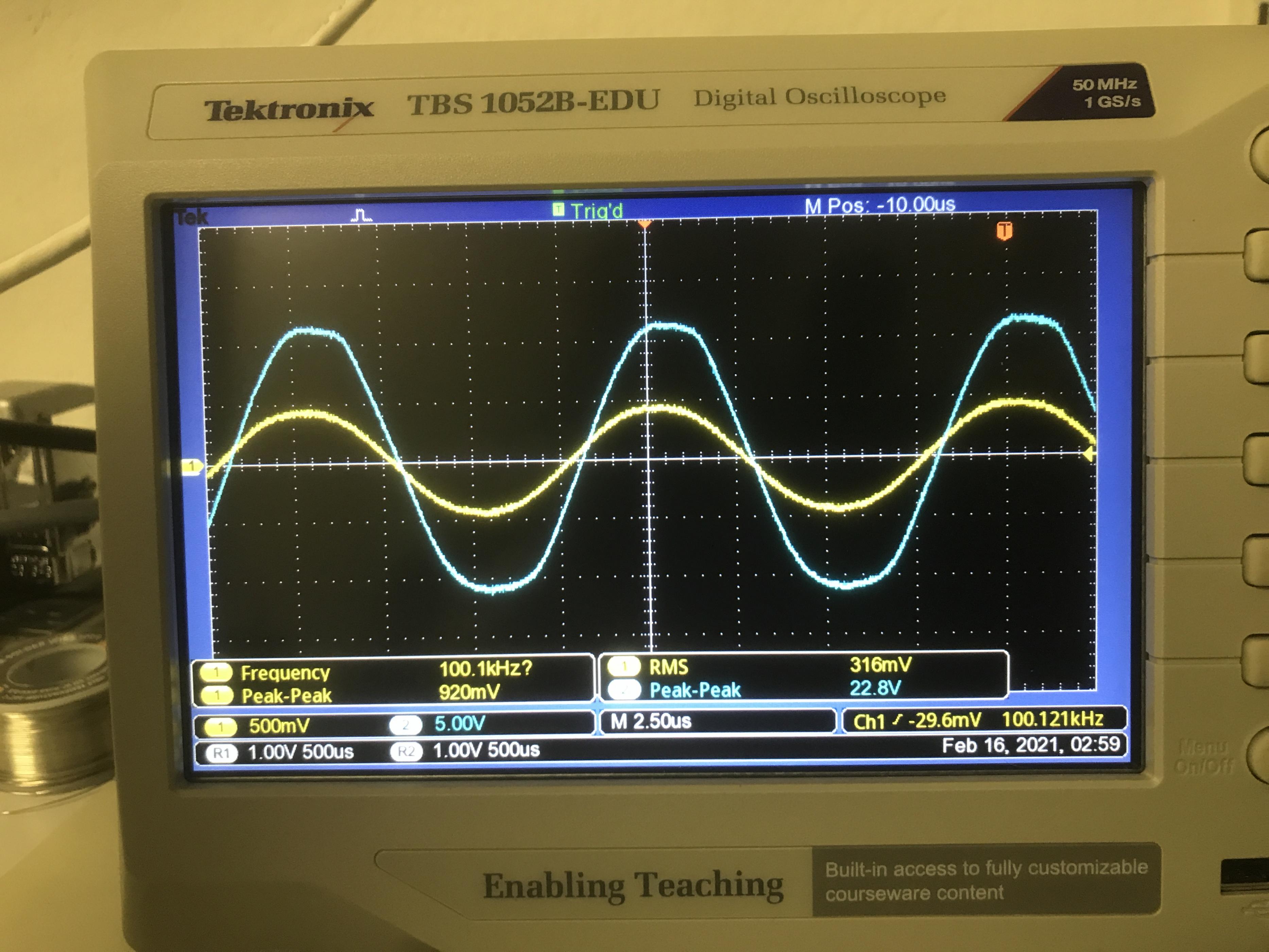

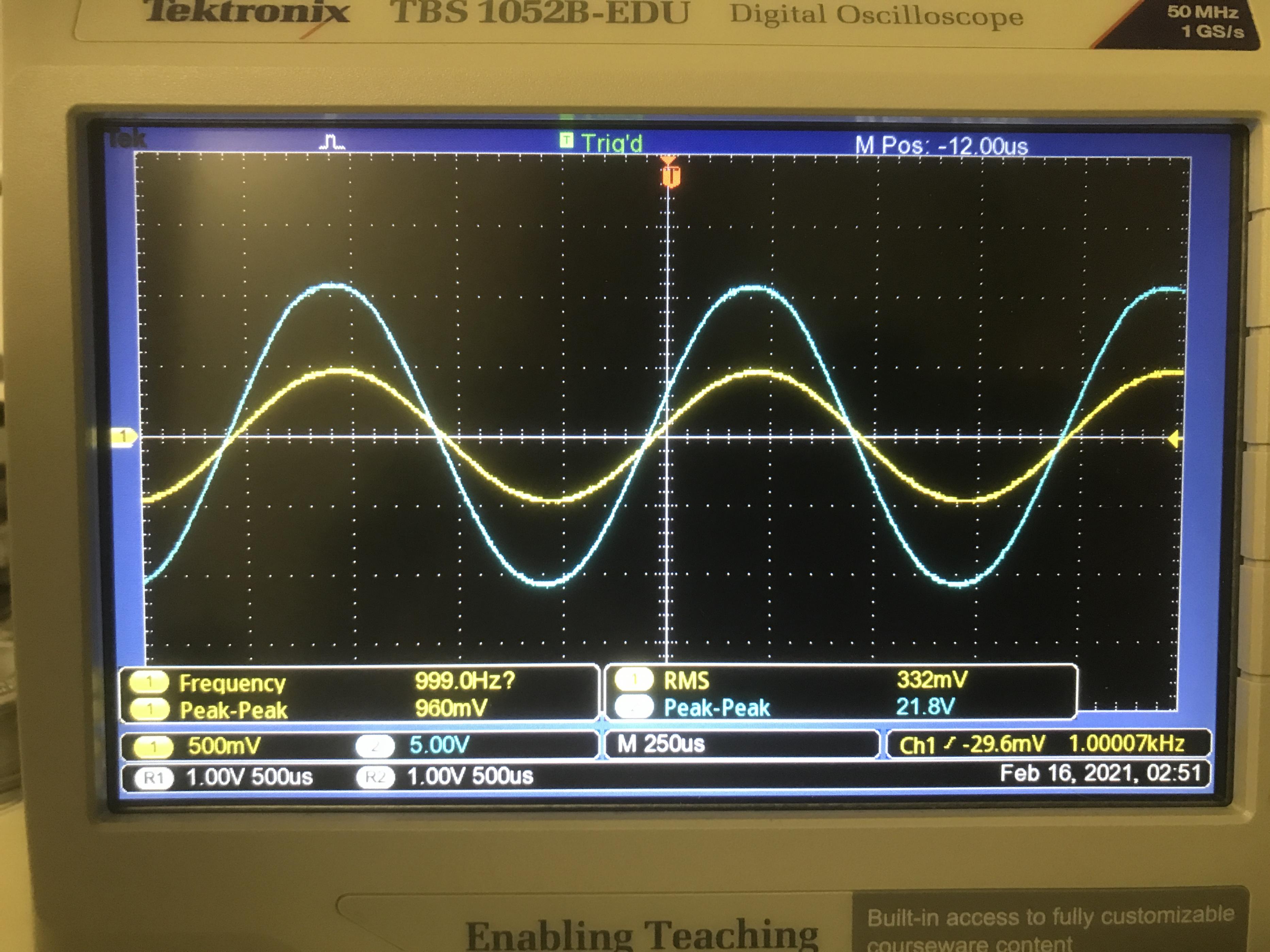

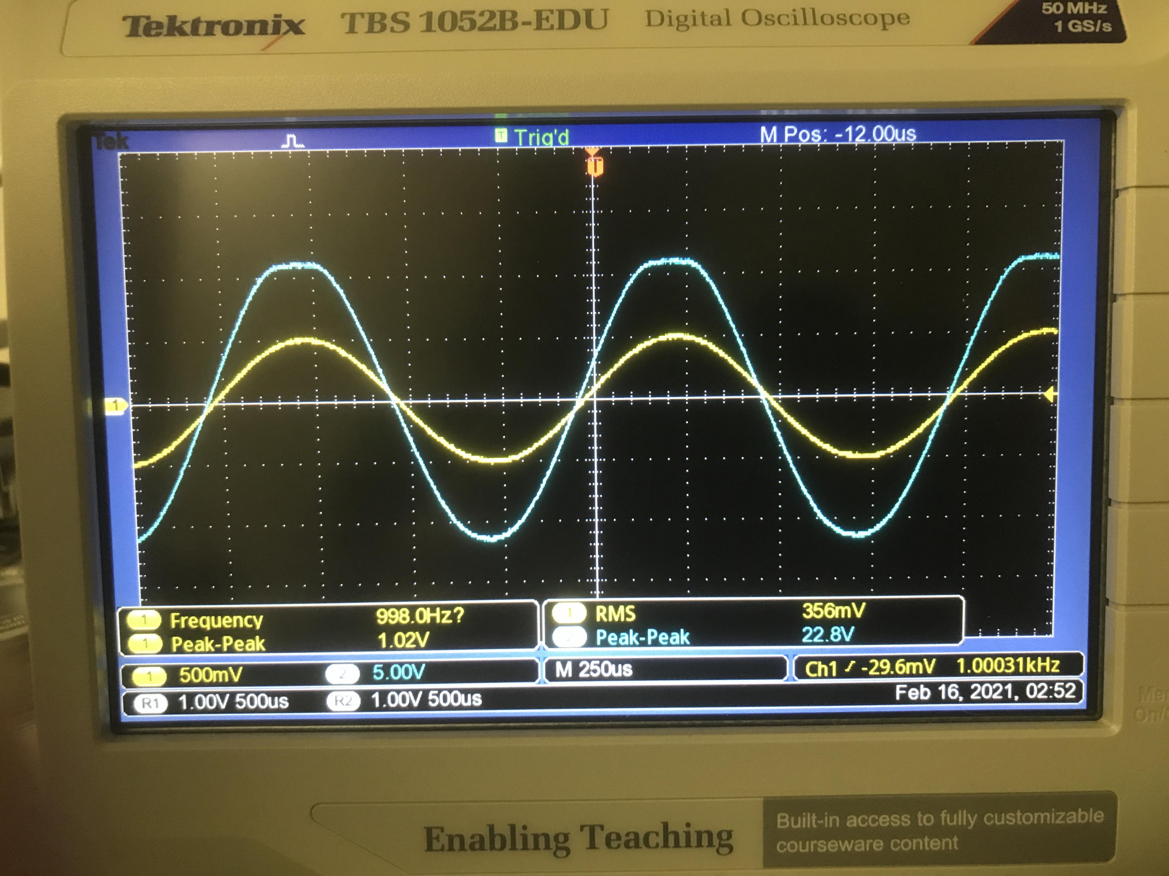

Today I measured the test amplifier board and I am really impressed.
You could feed it with (1KHz) 960-980mV p-p before you overdrive it and the positive wave starts clipping slightly before the negative wave.
The output is 21,8-22.0V p-p.
You can see the clipping when I feed it with 1,02V p-p.
The last picture is the full power at 100KHz, almost 22,8V p-p before clipping.
In this picture I used 26V to power the amplifier (like the batteries I will use).
At 100KHz the current in the power stage was 900mA.
The current consumption started to rise at 50KHz and driven it at 100KHz for some time the heatsink got quite warm.
In the last picture I removed the 470pF capacitor I had installed in parallell with R12 (220ohm feedback resistor).
Caused some phaseshift and I will not use it in my design.
The amplifier was stable during all tests and behaved as it should.
No ringing and the FFT analyse was ok.
My tone generator is antique and is really bad, I can not draw too much conclusions from the FFT analyse at this point.

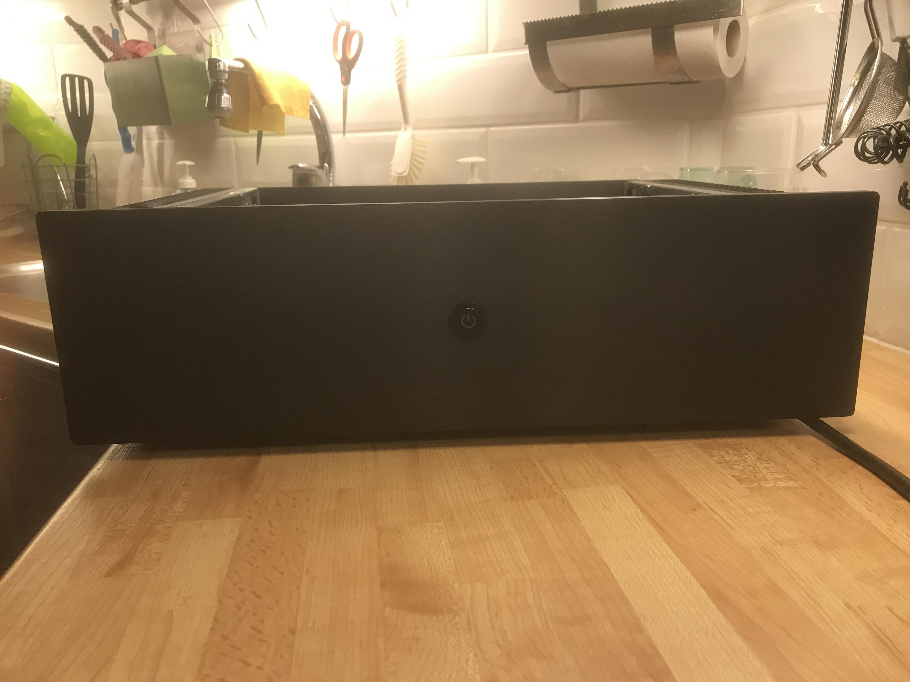

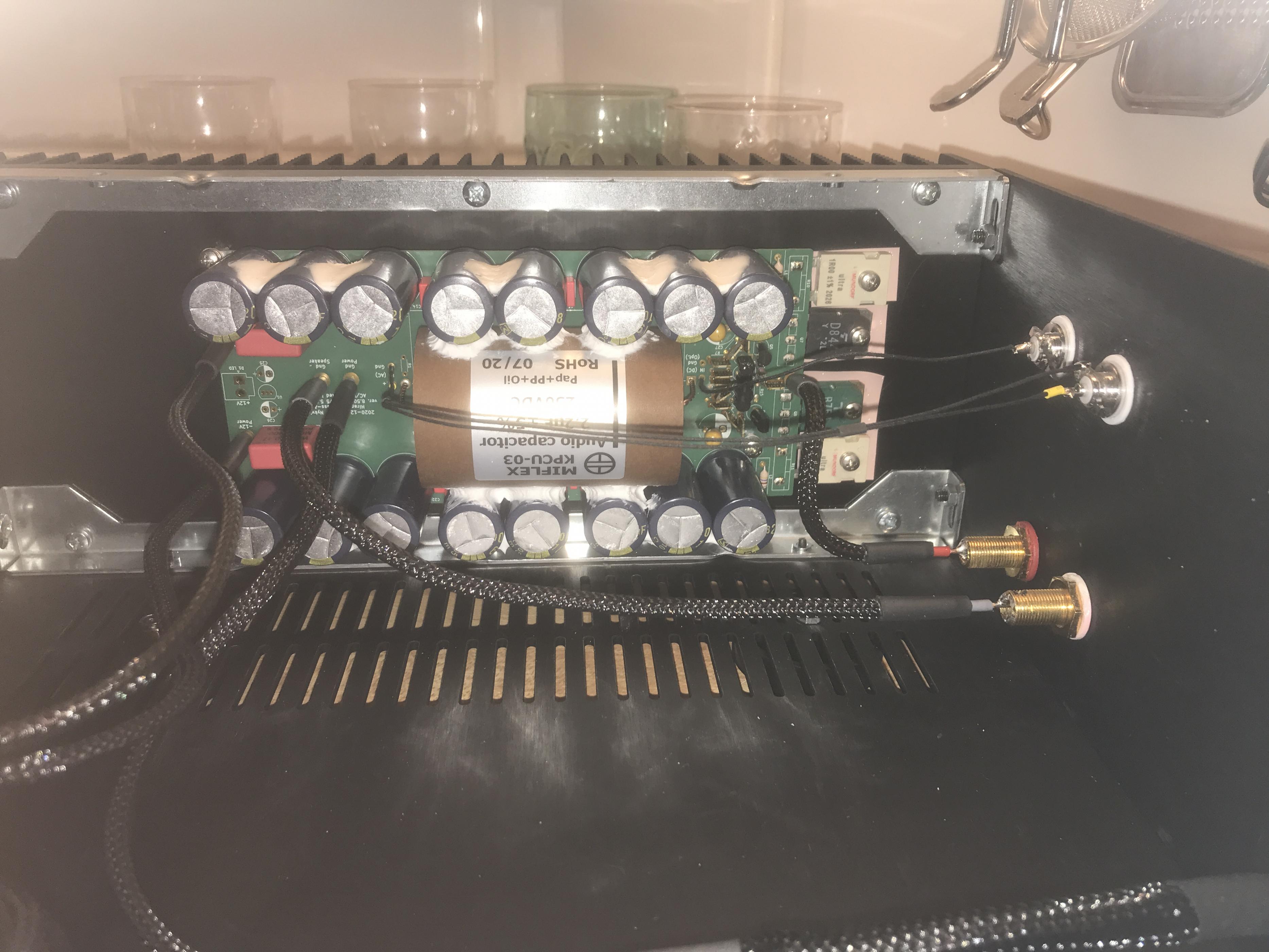

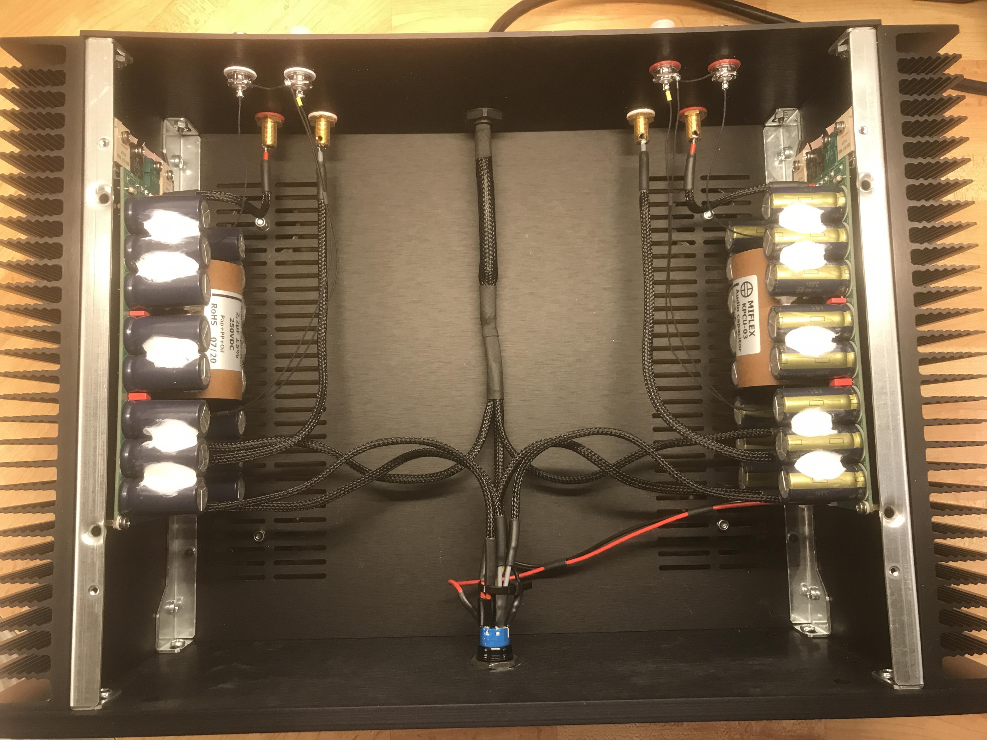

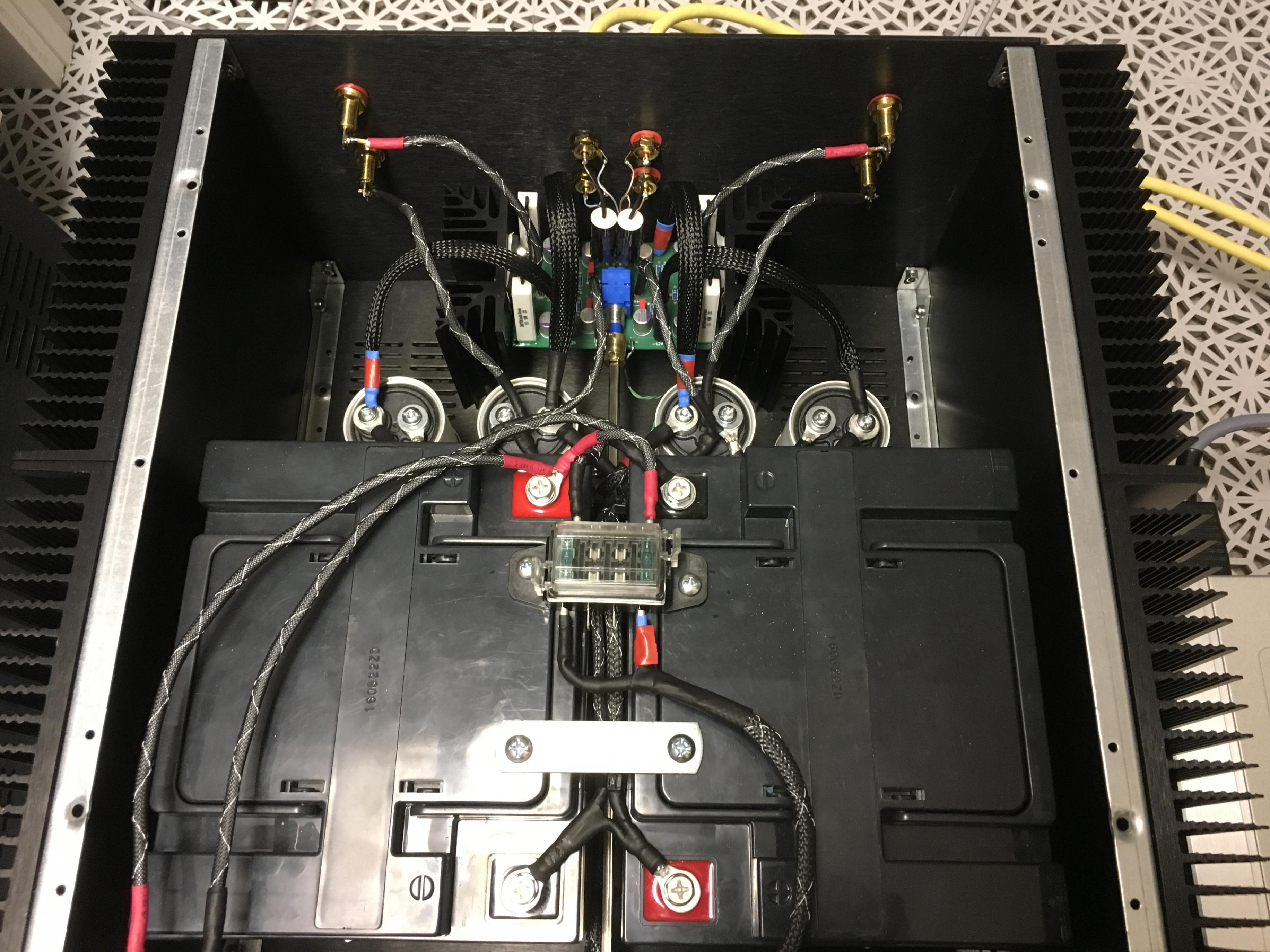

Added 2 pics of my current Hiraga amplifier I built 2017.
It is a dual mono pcb with volume control and 2x45Ah battery inside the chassi. Capacitors is 4 x 47.000uF Rifa PEH169.
It is build with TIP2955/3055 and BC550/560 and 2SK246/2SJ103 (Y).
Will be nice to compare them soon.

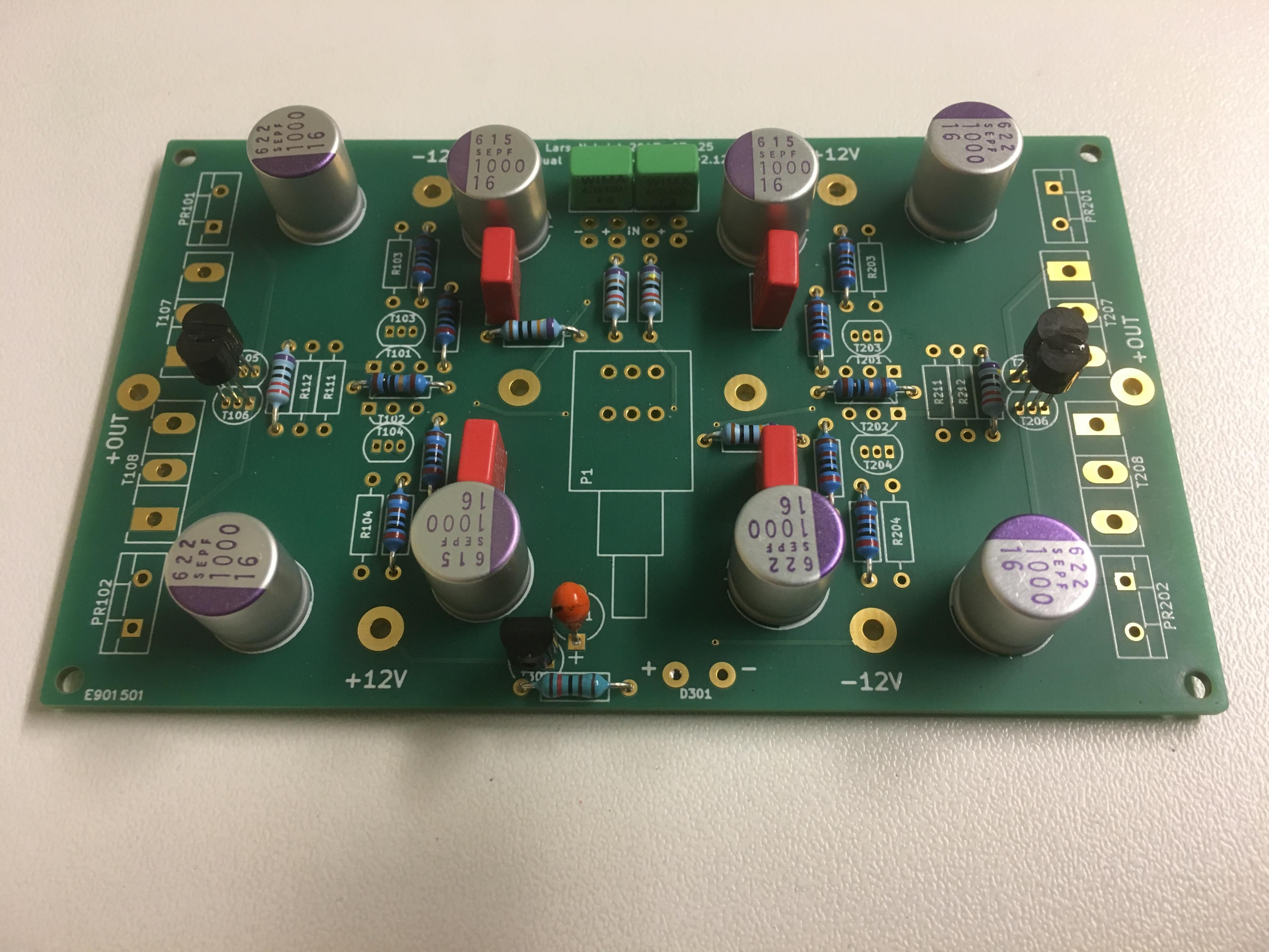

I have now verified the PCB as you can see in my post.
Still interested in the PCB?
I can send you the Kicad files if you want to redesign something or the Gerber.
Remember it is designed for 5.08mm TX-2575 resistors but you can always use ordinary metal film types and bend one leg (stand up).
Did this on the test PCB I measured.

Do you have a pic of the assembled board?

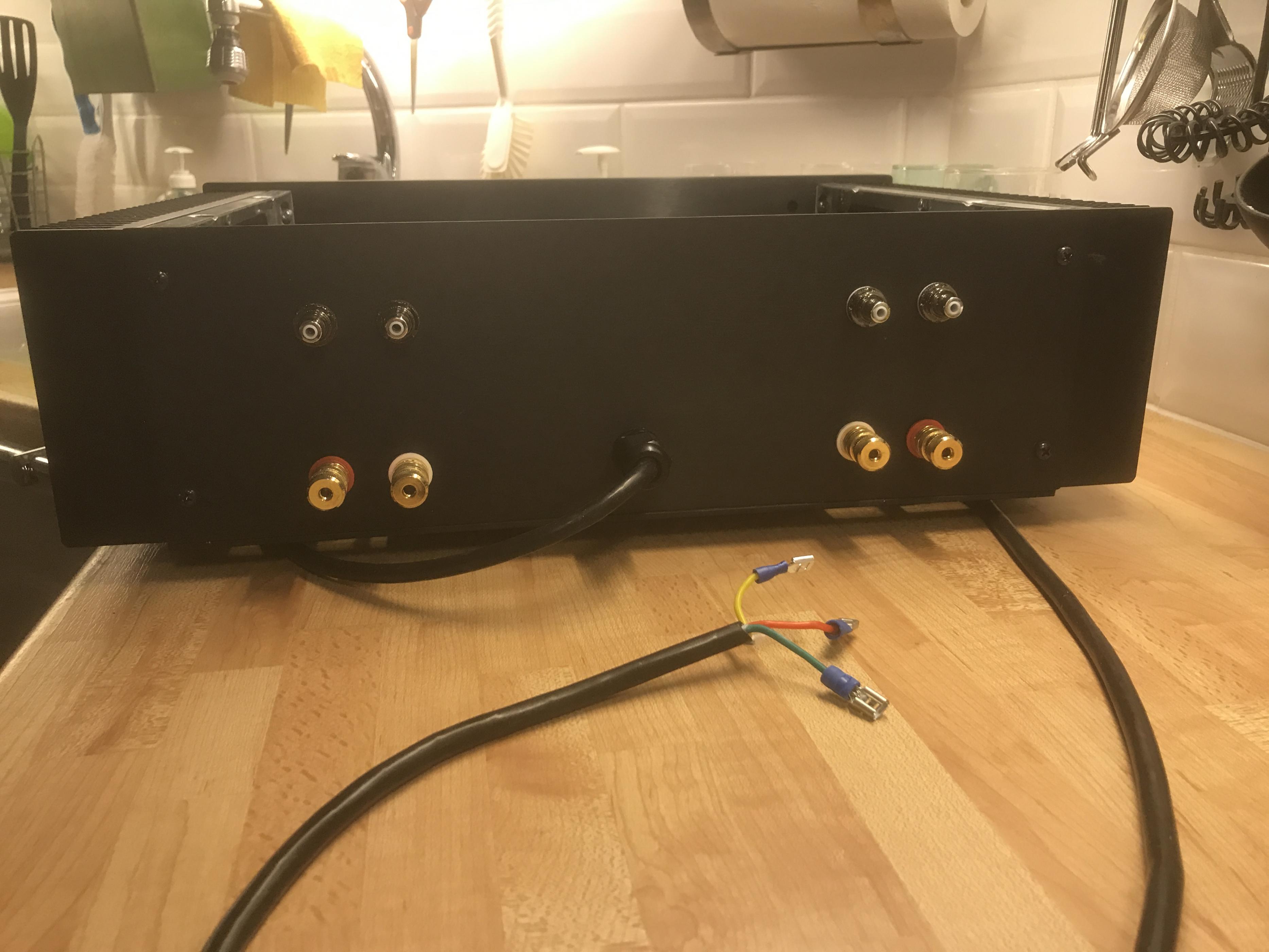

Here is some pictures of the assembled amplifier.
The 4 input transistors/jfets are glued together to get thermal stability.
Almost impossible to see on the picture.
The innermost RCA input is AC coupled and the outer RCA is DC coupled.
Ground is only connected to the AC input otherwise you get a ground loop.
Connect ground together at the RCA inputs.
Speaker output ground is connected from the central ground plane at each channel where input ground from the batteries is connected.
