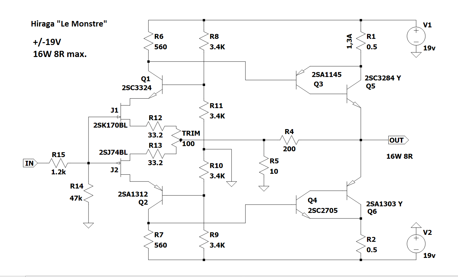

So the options are:I already have GR grade jfets but want the 1,3 mA Y-grade one´s.
- redesign
- parallel current sinks (or sources from the plus proper)
- bjt input
- give up (no Y's)
- invent eq's (dropmeanote, @xtrm high cost possible)
I thought I did an edit, but a post appeared...
I have a BL grade(operate at 2.3mA.) and I changed the values of the resistors to stay as close as possible to the original operating points. I didn't find Y grade anywhere.

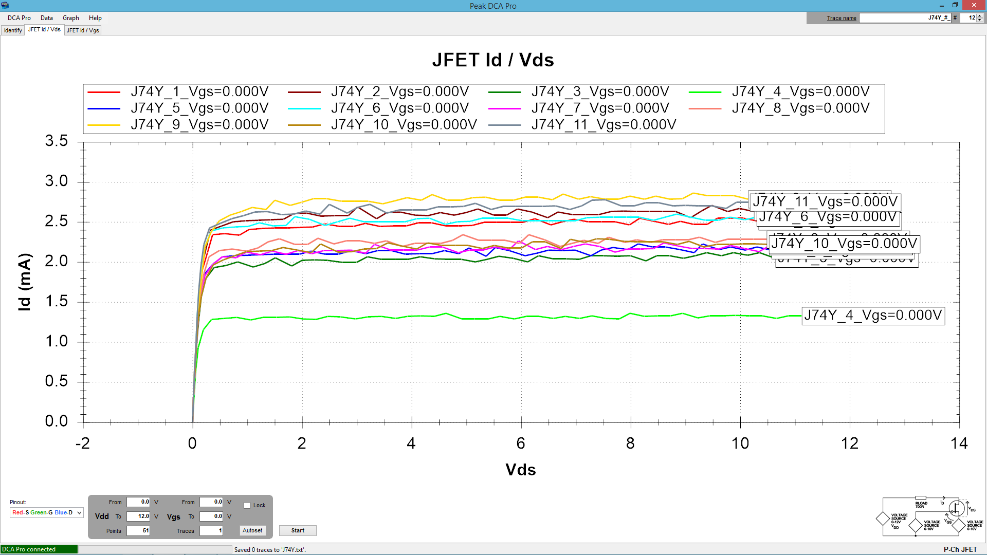

Found a site to maybe buy Y-grade jfets.
A supplier from the Digikey site.
Utsource is distributor of 2SJ74Y , buy 2SJ74Y , in stock, new&original with lower price, offer image datasheet|pdf
Utsource is distributor of 2SK170Y , buy 2SK170Y , in stock, new&original with lower price, offer image datasheet|pdf
Waiting for a respons on monday on those.
Something I missed or beeing fooled you think?

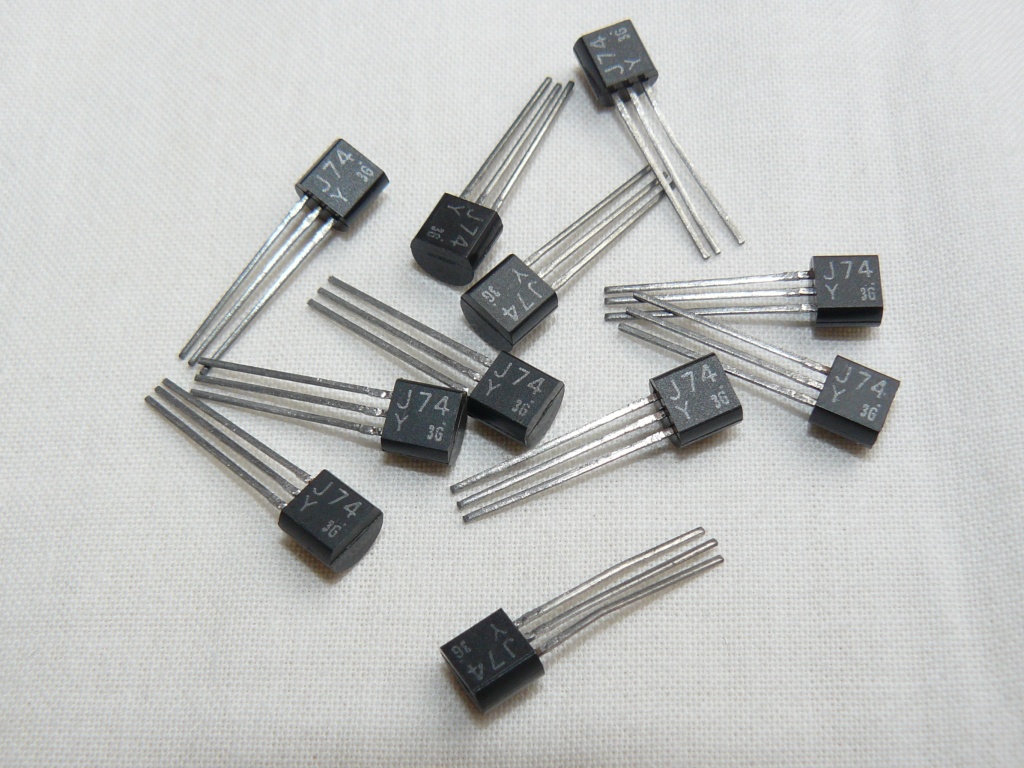

RE Utsource: I've seen their name mentioned in several threads about fake components here, so I personally would not trust them. On the other hand, most people don't even know a Y grade of J74 / K170 existed - the internets are full of counterfeit GR, BL & V parts, but I've never seen a single J74Y or K170Y listed on eBay and such. People don't know about them = no demand = no fakes. Hence, there might be a minuscule chance Utsource have the real deal... but I somehow doubt it.

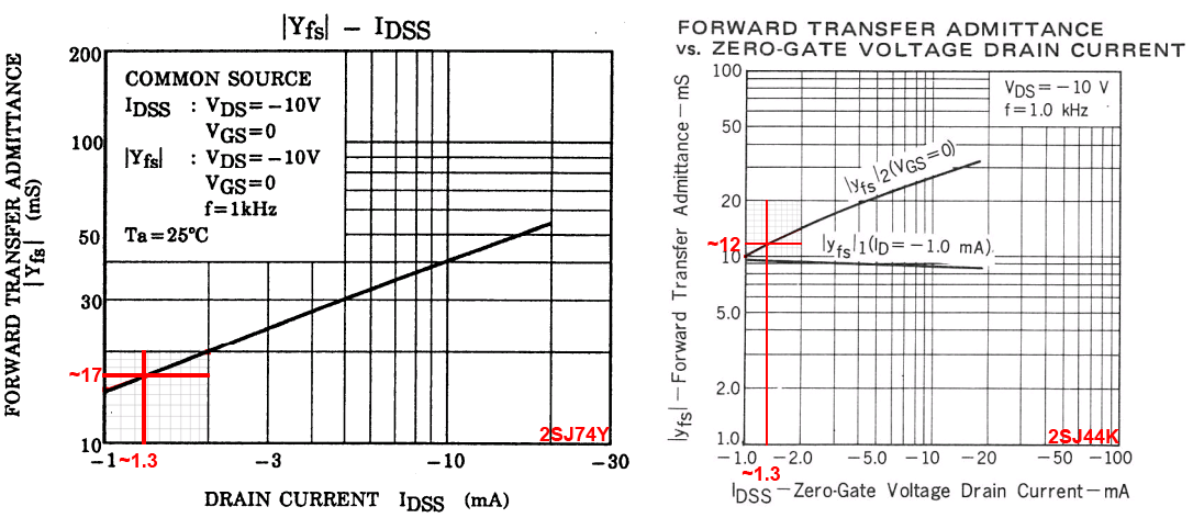

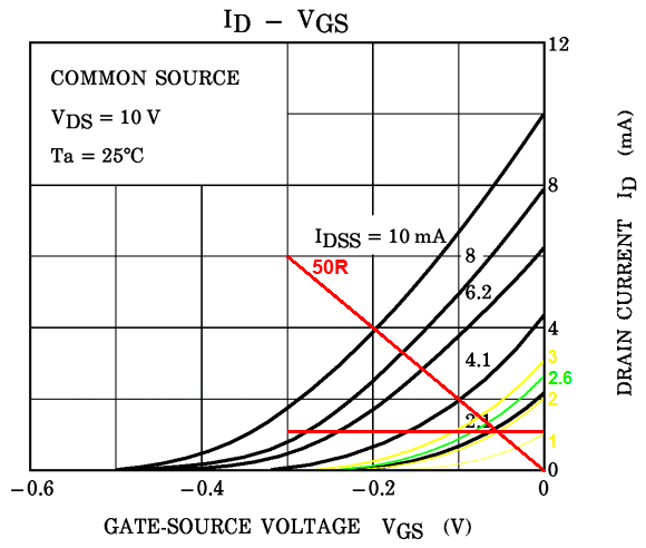

BTW, where does the 1.3mA figure come from? (Post #1181, perhaps?)I already have GR grade jfets but want the 1,3 mA Y-grade one´s.
Unless I'm mistaken (and I quite often am ), the 1.3mA is not the IDSS of the JFET itself, but rather the ID an average Y grade JFET (IDSS ~2mA) would pass when degenerated by 50R (1/2 of the 100R trimmer). Which would mean that a JFET from the very bottom of the GR grade range (IDSS ~2.6mA) should get you pretty close to the target.
A trusted seller of the Toshiba JFETs and a member of this board, alweit, used to be able to supply the lowest possible IDSS GR grade parts specifically for Le Monstre builds in the past - not sure if he still has some available, but there's no harm in asking...
- Hiraga "Le Monstre"
