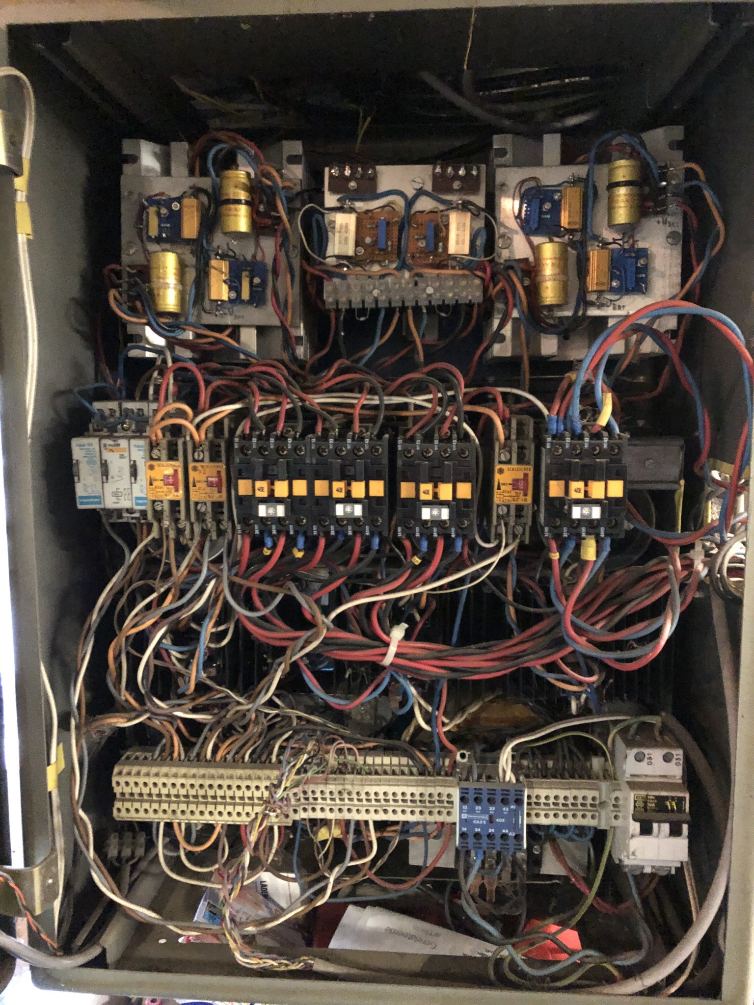

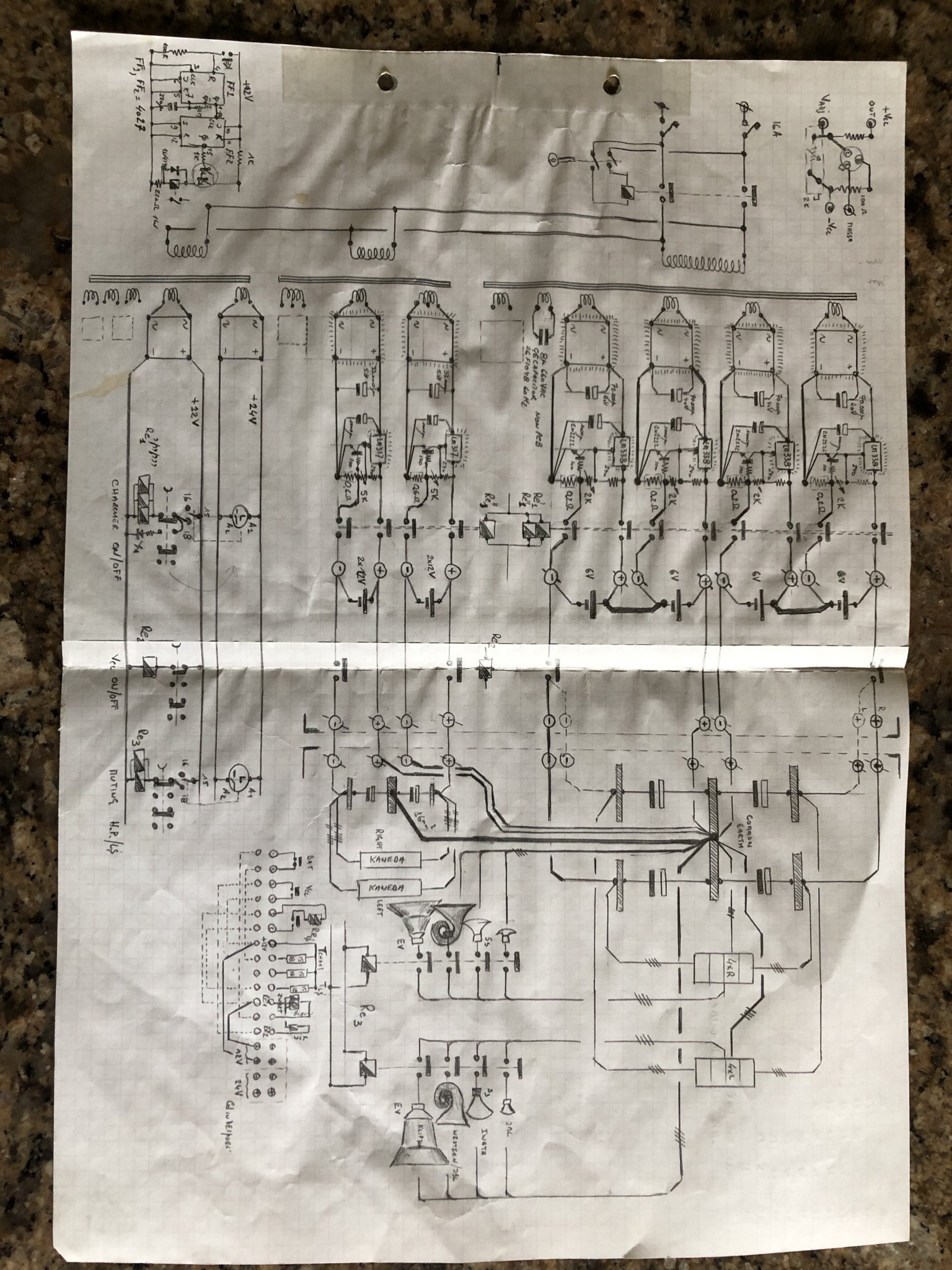

Aan Patric.
FYI, & a little out of topic, I give you my minute schema ('83)
No chi-chi-ni-tra-la-la.
Attention, put the bat. (accu's) outside de building ... in open nature.
I hope that you find your correct PSU
Alles, Salukes.
Karel
