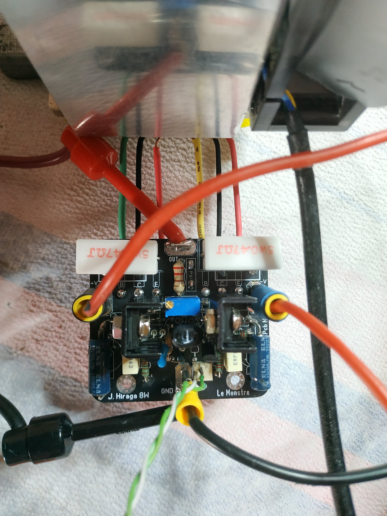

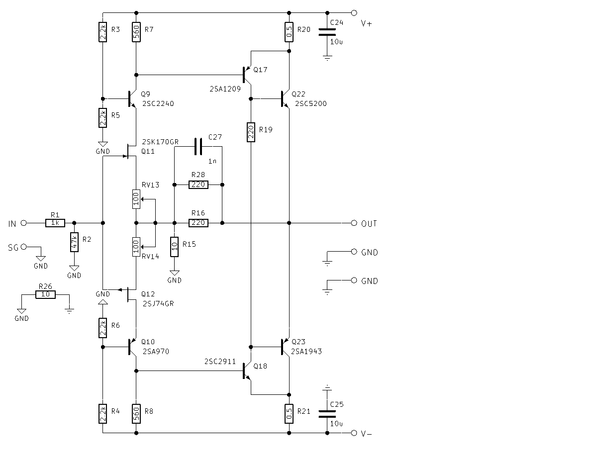

1.2V is a reference value.
You might have to retrim once you have soldered the power devices and let them warm up on the heatsink.
In our final build, the bias current starts at 0.5A, and ends more than 0.8A after 45 minutes.
You can easily measure the bias current as DC voltage across the 1R power resistors.
How much it fits depends on the size of heatsink, and what insulator you use.
So my values are also for reference only.
As you have installed trimpots on the bypass current source, you can easily adjust both bias and output DC with them.
Once you are happy with the final adjustments, replace them with fixed resistors.
Build the speaker protection before connecting to speakers.

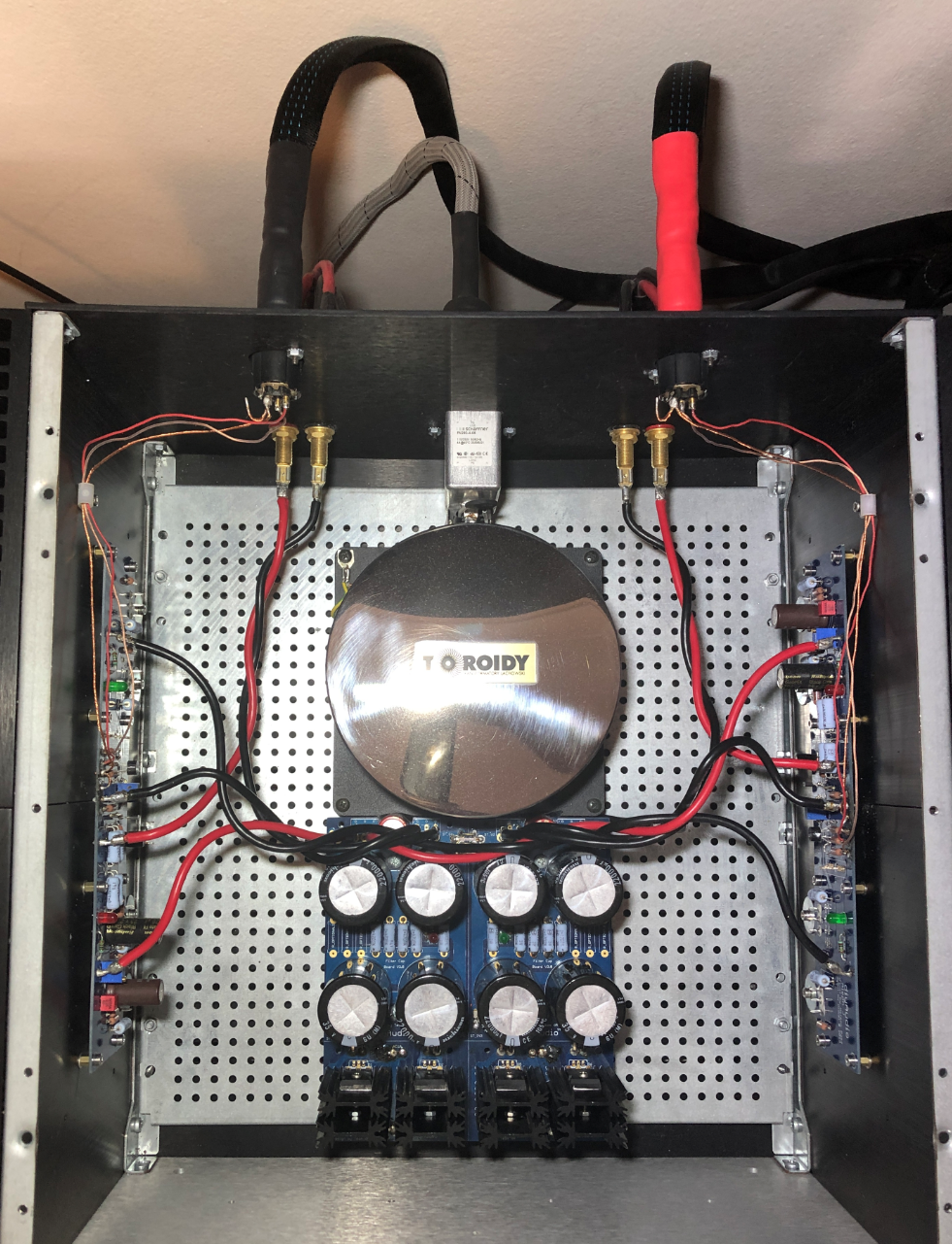

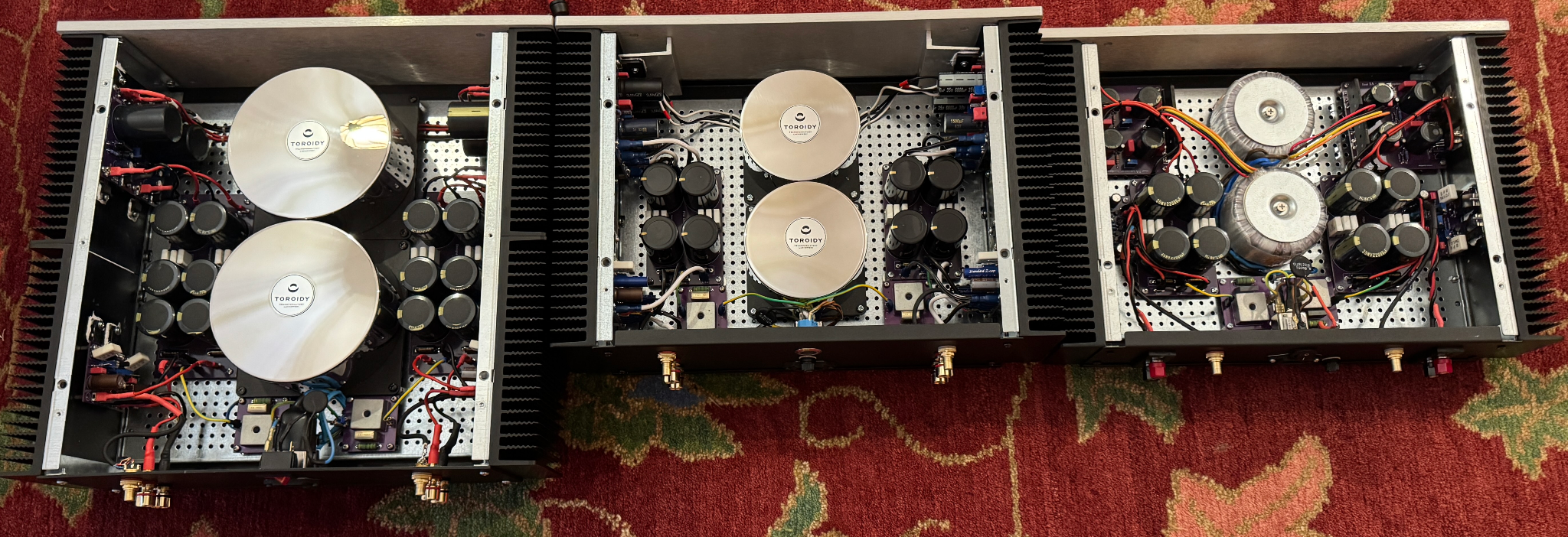

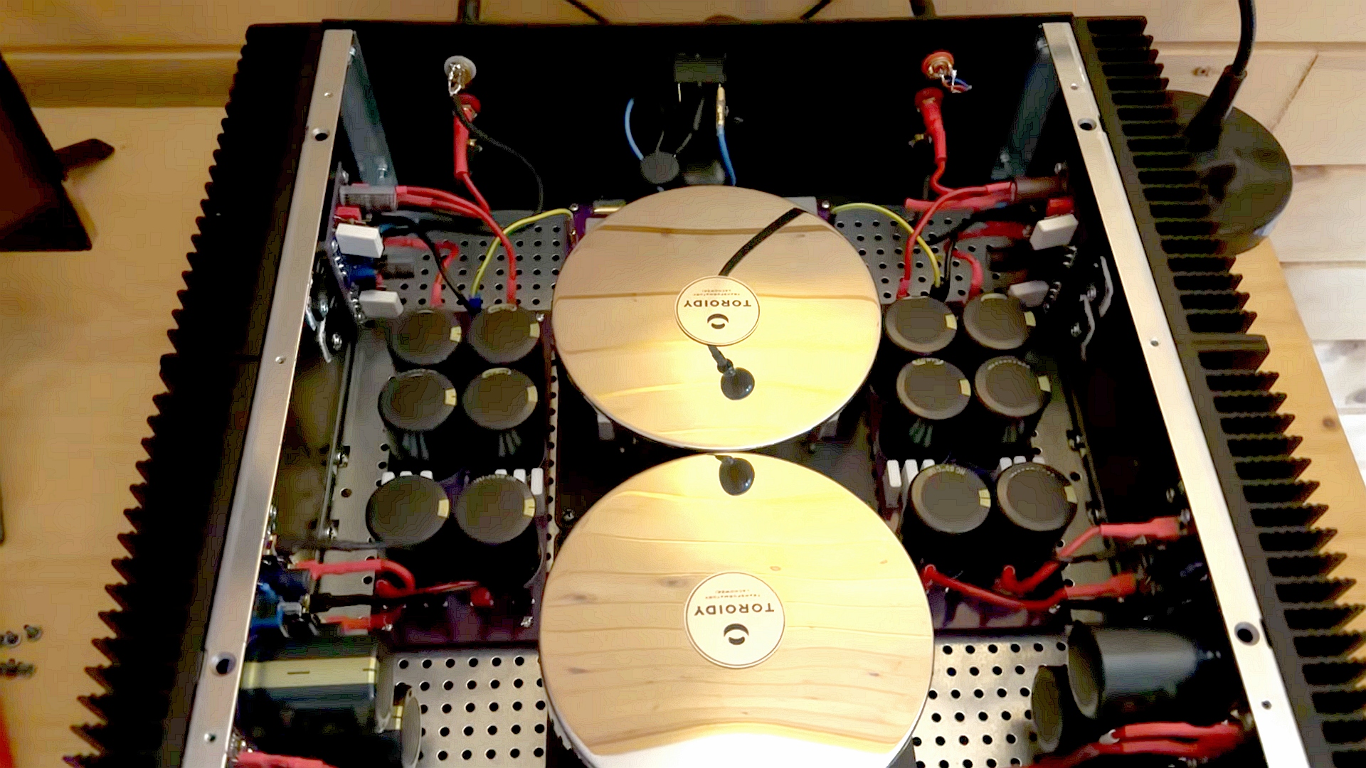

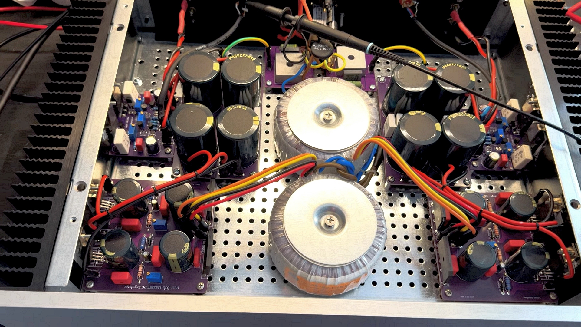

I honestly tell you that I didn't expect my work to be seen by so many people. Anyway, I'm glad that I managed to contribute with examples worthy of consideration in this field. Examples that others can take inspiration from. And please, feel free to do so. If you like something from what I did,...borrow.
The two examples of the Hiraga amplifier presented by our colleague in the above posts are built by me. In the meantime, the third one has appeared. In the attached picture I want to present all three of them next to each other.

I followed your layout for version 4R.
The only difference is I have gain resistors 220Ω and 20 Ω
+/-22V
1.4A bias .Very very stable.
Would you like to recommend something?

""The open loop gain, just like the Pass F5, is load dependent. With 4R load, this is halved compared to
8R. To compensate for this, one could reduce the gain by increasing the 10R feedback resistor to
20R. The output impedance is still something in the order of 0.7R. So the speaker should have
relatively flat impedance over the audio band.""
I change the resistor gain also in my Αlpha Nirvana 39 Ver 4R from 820Ω to 1.8Κ everything goes better.

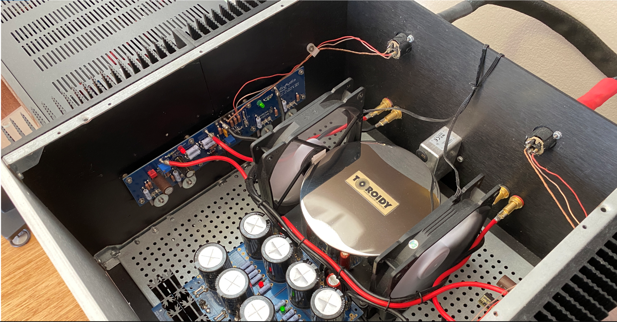

Looking to build a Hiraga LM, the 8w version as my speakers have over 9xdB SPL
Trying to make a frankenstein version as I want to use CPU coolers for the 4 transistors and SMPS power supply
Does anyone used SMPS or CPU coolers for it?
Also what's the best voltage to run it ( the 8w version?) as I read various materials going from +/-12V to +/-15V
As far as I understood the 8W version needs arround 60W of power per chanel - why everyone goes for such big transformers? Just a reserve?
Thank you!
In this thread, we tried to follow the original as much as possible, given today's circumstances.
We have explained in detail the changes we made, and what consequences they might have, in measurements and listening.
For many other variations of the LM, the original thread is probably more interesting for you :
www.diyaudio.com/community/threads/hiraga-le-monstre.5462/page-123#post-7973070
