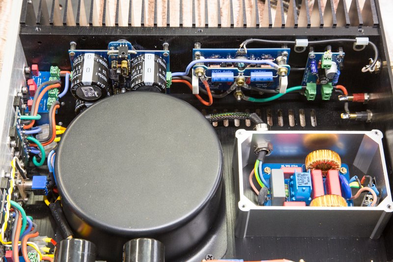

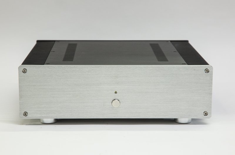

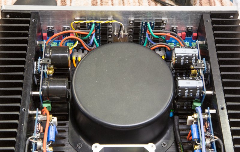

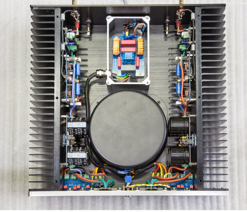

I finally got to complete my Le Monstre 2024 build this afternoon. Some pics are shown here - but basically, there is a line filter with ICL first, then switch, transformer, rectifiers are mounted on the front panel, then the 7815 pre-regulators followed by the main PSU and the amp boards. Lastly, the speaker protection modules.

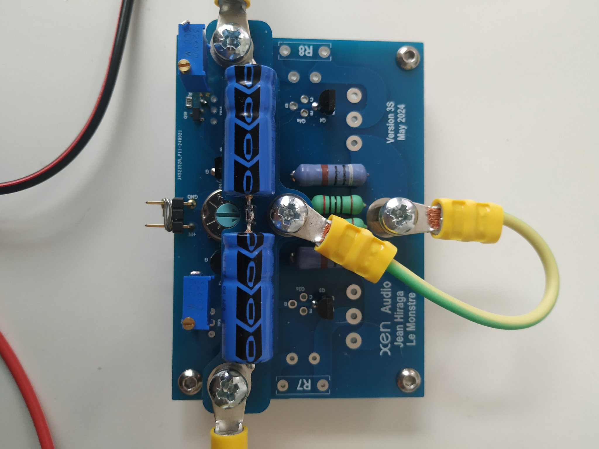

I've just soldered the SSPs and was wondering which value to use for Rrs ?
I myself would not use Rrs.
If the protection would trigger, I would want to switch off, disconnect speakers, and measure the amp to locate the fault first.
After all that, it would have discharged by itself.
If not, just short the two solder pads with a 1k leaded resistor.
But if you do want auto reset, then use 1M.

Nice pictures. 😊

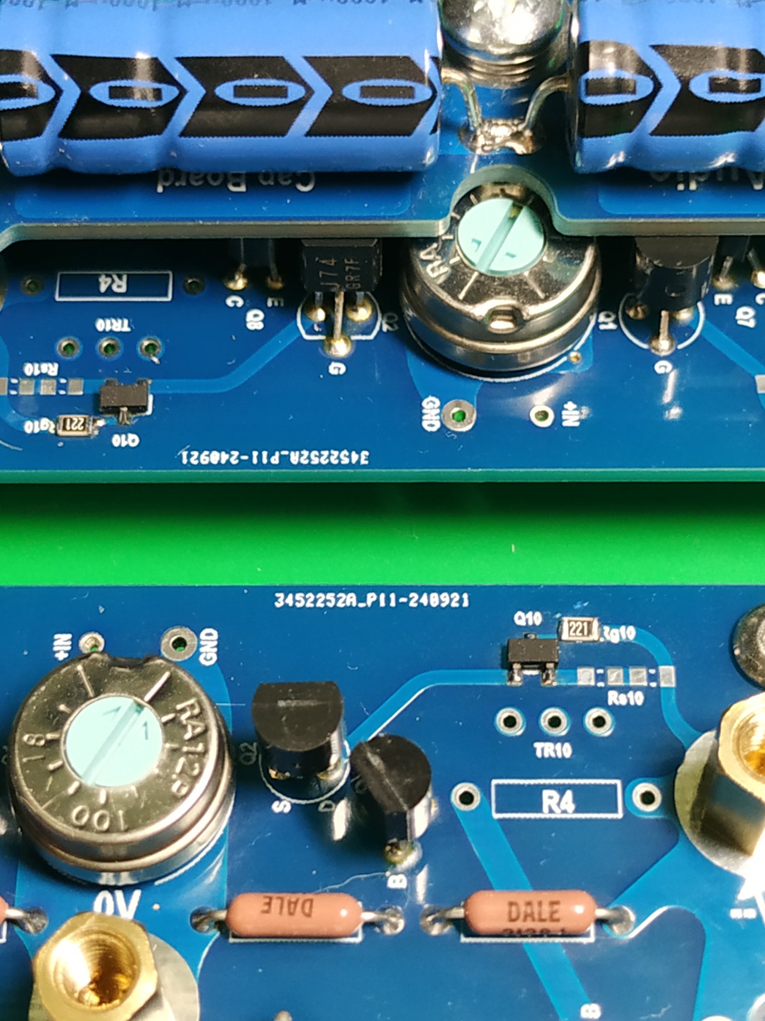

Is the pin out of the transistors the same as in the first post (photo)? Is the pin out of Q3 JILIN SINO ss8550 different to the On Semi version?
Just asking as the orientation of the transistors in the photo don’t line up with the markings on the PCB and data sheets. Did you use different transistors or am I missing something?
Hi @freebee - apologies for the slow response - I somehow missed your first comment in #294 above. There were a few different transistors trialled for Q3/4 before selecting SS8050/8550 so the photos likely are from one of those test builds.
SS8050 and SS8550 have the pin out E-B-C - so when inserting them in the board make sure to respect the silkscreen on the board for Q3/4. You can always trace the tracks on the board as well to check against the schematic over in the group buy thread. Provision was made for paralleling Q3 or Q4, so you can use either position Q3 or Q3a etc as suits.

Regarding Q2, 2J74, what is the actual pin out? The pin out in the data sheet appears different (reversed) than the PCB markings. Maybe it’s the picture on the data sheet that’s confusing me as it shows the flat side at the top.
Any idea what the correct orientation is?
