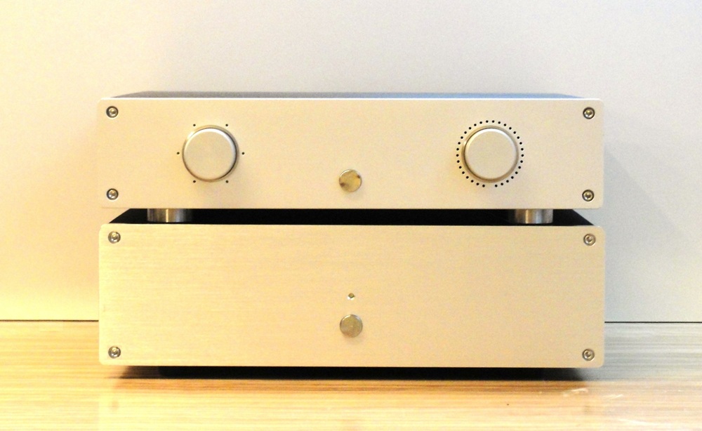

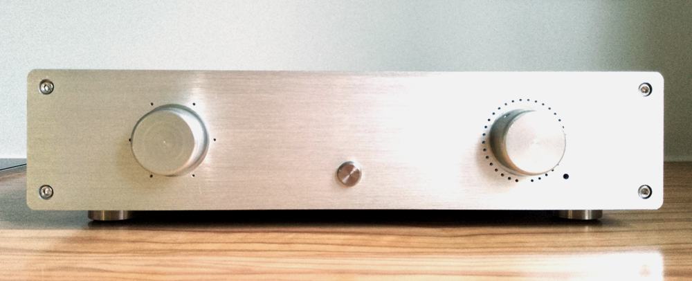

Family photo.
We like very much how they turn out. 😊
Patrick

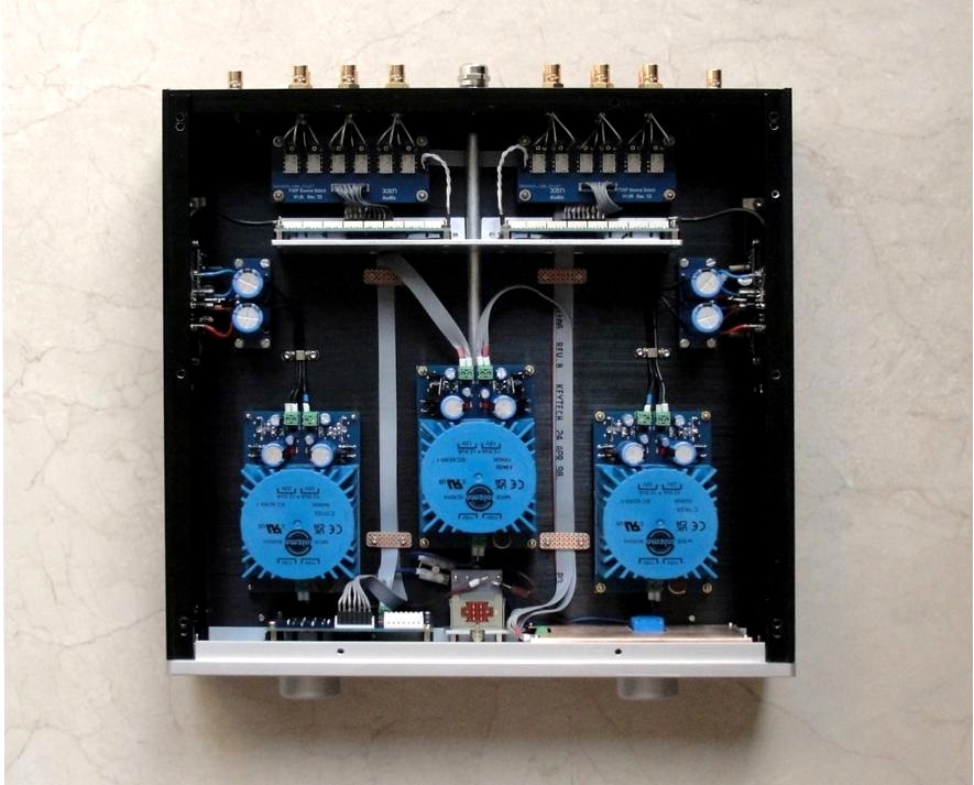

Remarkable cleanliness both in terms of the layout, implementation and design.
bravo!
bravo!
Fran already said he wants them both.
So they will go to him for measurements and listening.
We shall then publish all the details in a separate thread.

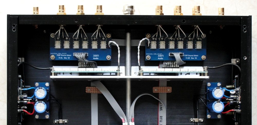

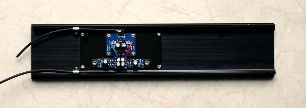

Below is a picture of the preamp (buffer) module, including local discrete regulators.
Patrick

How to DIY that front panel in post #264 ?
We got a special PCB made which is essentially a drilling fixture.
This allows you to position the PCB mounting holes and all the LED holes relative to the centre of the knobs.
We then drill through the panel first with 1.5mm as pilot drill.
Then drill out to size for the LEDs and the standoffs.
You can do it with am electric hand drill, with a bit of care.
Of course it helps a great deal to have a drill stand.
So anyone with a bit of DIY skill can do.
No CNC required.
Patrick

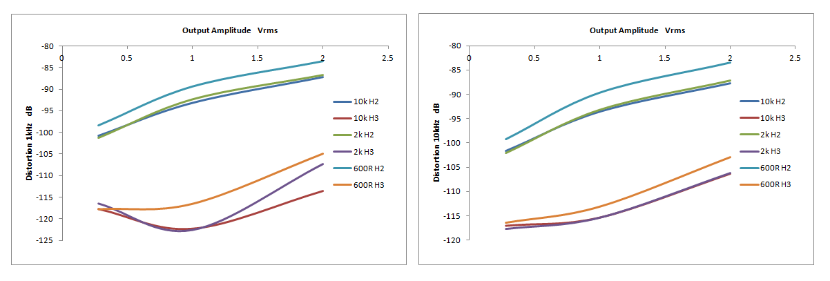

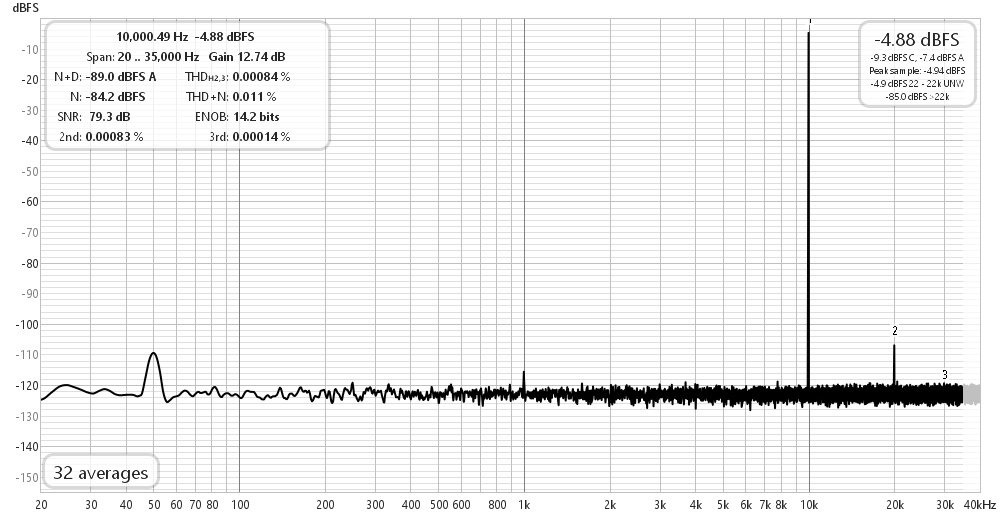

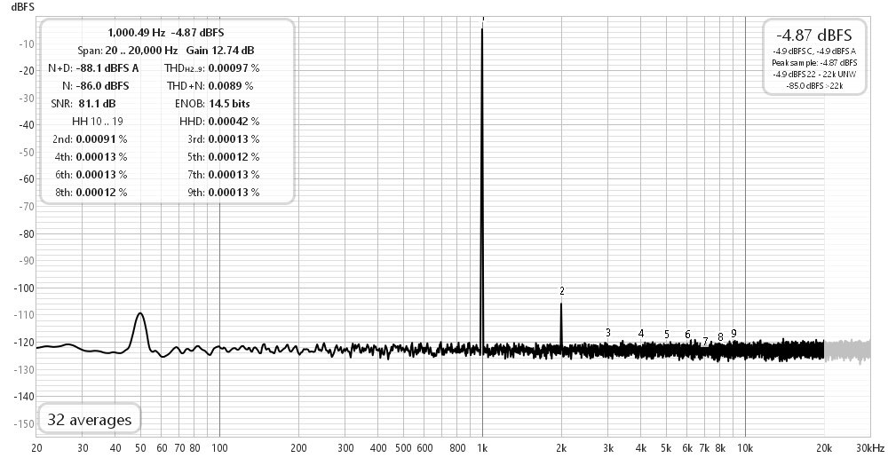

Referring to Post #267, some progress with the distortion measurements.
Note that the Le Monstre only requires 0.3Vrms input and has 48k input impedance.
Figures show 2nd and 3rd harmonics of the preamp at 1kHz and 10kHz, with different amplitudes.
Distortion is practically identical between 2k and 10k load, and between 1kHz and 10kHz.
And about 3 to 5dB higher at 600R load.
3rd harmonics at 1kHz below 1Vrms are noise limited.
This version is with Onsemi JFETs and BJTs.
There are plans to test further versions with Toshiba devices, both through hole and SMD.
Some more work needs doing before ready for listening auditions together with the Le Monstre 2024.
Patrick
