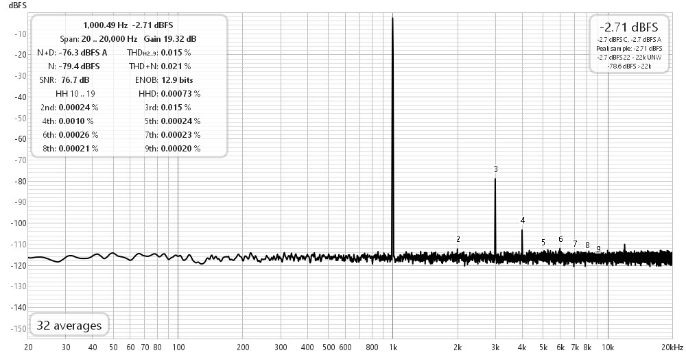

This is what the distortion spectrum looks like when everything is well matched at operating conditions :
https://www.diyaudio.com/community/threads/hiraga-le-monstre-2024.413301/post-7698384
20dB lower even harmonics.
Patrick

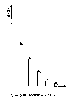

I simply wanted to remind you that in France audiophiles highlighted the search for a linear harmonic distortion where H2 was greater than H3.
I'm not good enough with electronics to offer a solution. 😕
Then one should be building single ended circuits and not push-pull or balanced.
The latter cancels even harmonics by design, to a greater or less extent.
Patrick

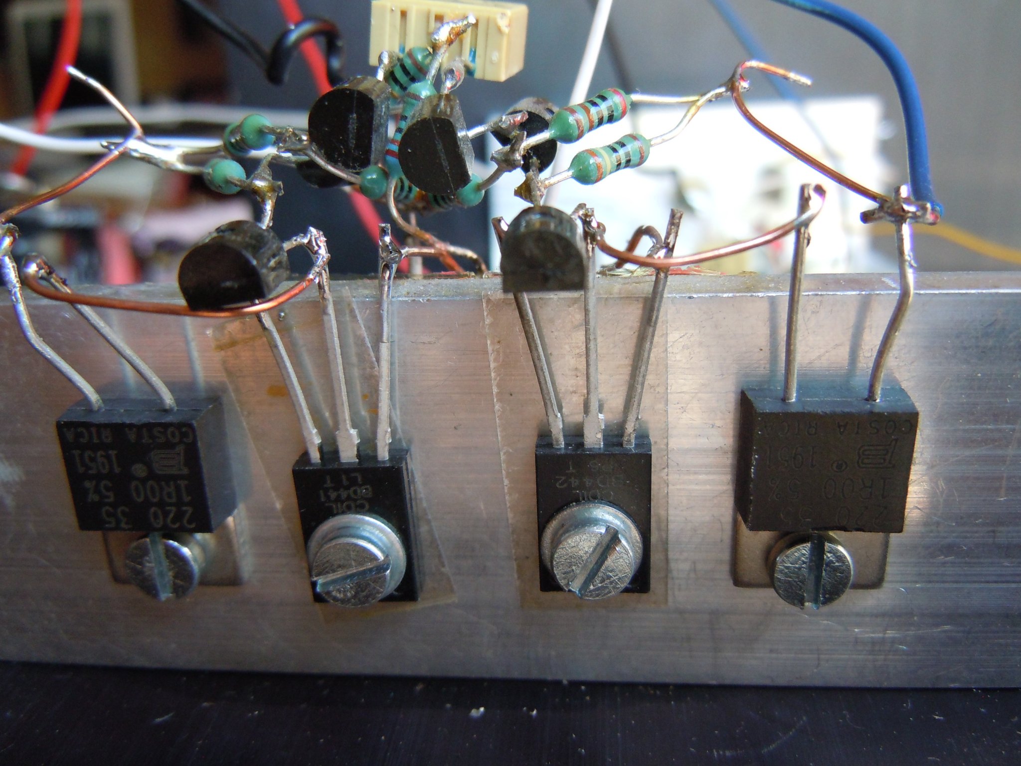

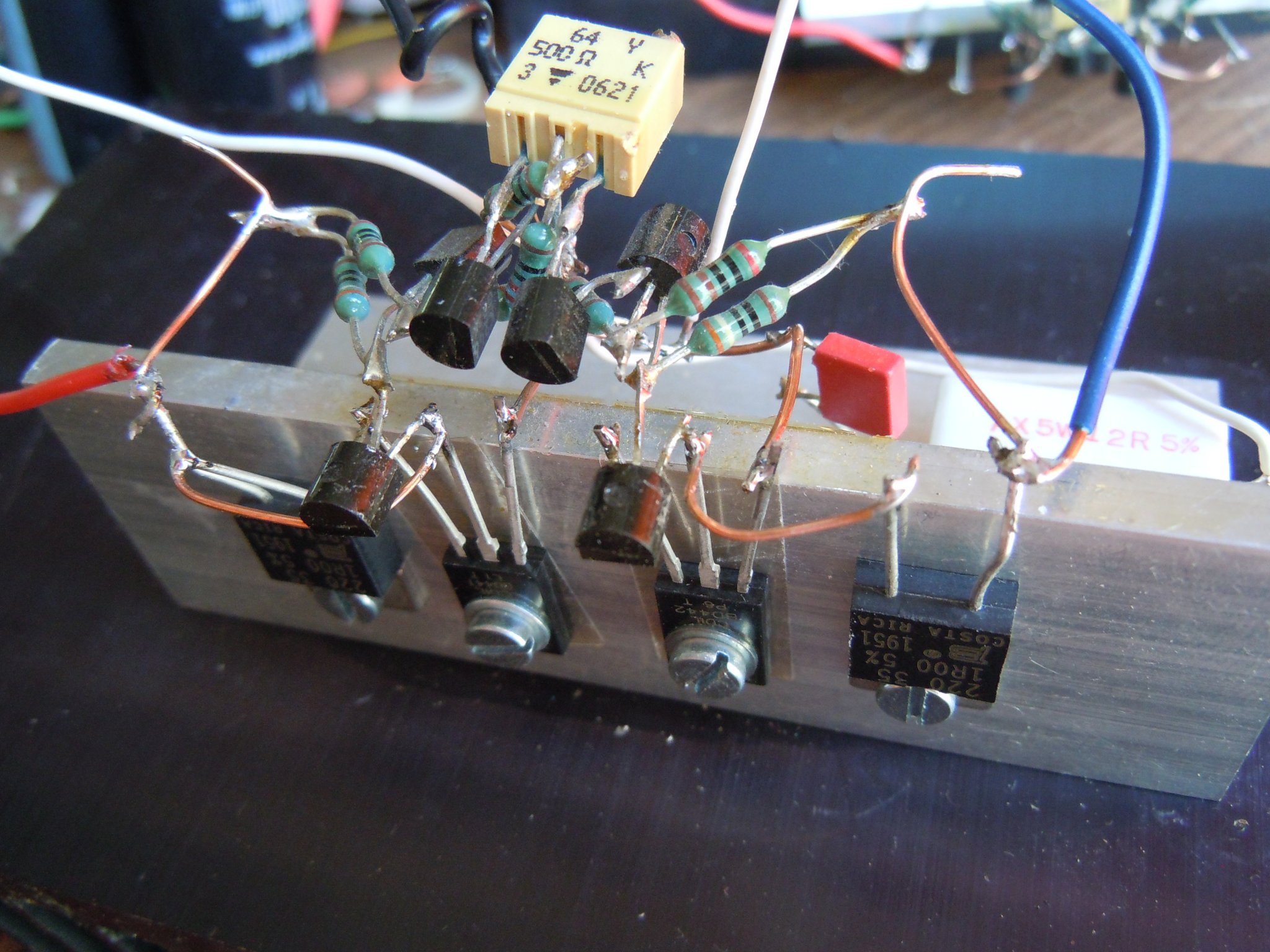

I replaced the output pair TIP3055/TIP2955 in TO-247 housings (#78) with a pair of BD441/BD442 in TO-126 housings. Quick and provisional. These are also some of the best power transistors in terms of sound, and completely sufficient for a Le Monstre with 12 watts/transistor. What can I say: finally a black, shiny, clear, focused, clear cut contours in 3D stage, and finally voices are understandable and the bass has power and blackness and punch; very musical, a unified orchestra. The big ones can't keep up: just a tempo-less, sluggish, colorless, contourless image. I have also run the small ones at 2 x 18 volts, but I didn't like the sound any better. The small trannies can also cope with this power.
I installed TO-220 power resistors. These also sound much cleaner than any wire on sand in cement type. But smaller TO-126s would go one step further in terms of cleanliness and clarity.
In my Monstre, the 2nd and 3rd stages of the circuit run with identical complementary transistors. Here BC550/BC560. The advantage is that the sound is not modulated by 2 x 4, i.e. 8 different parts, i.e. 8 sound characters, but only 2 x 3. This may benefit the homogeneity.

Better not mounting the Sziklai parts together on the same heat sink, that can invoke a thermal runoff.A pcb is not necessary for this small setup
Have the drivers hanging on the leads and with separate small (U-shaped) heat sinks.

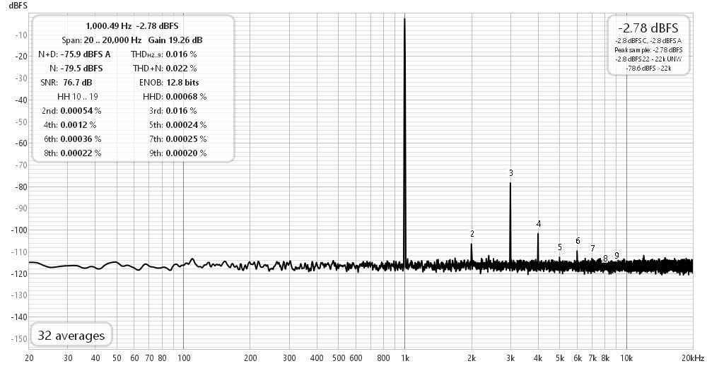

Because we want to be sure, we went back to remeasure both channels of the Le Monstre Deluxe again.
Not only are the measurements repeatable, but both channels are very closely matched.
And very low even harmonics. 🙂
Patrick
