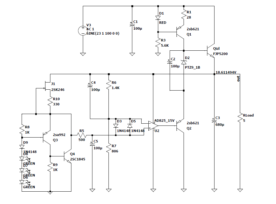

Does anyone else see a resemblance to the F5? Le Monstre has cascoded jfets on the input and BJT output but the basic topology is the same.
Edit: oh wait, the outputs are followers. Never mind.

I tested quite a number of driver transistors at a supply voltage of +/-19V (that's the output voltage of my modified Walt's Improved_PN_Regs) and a current of 1.7A (I would increase that if the heatsinks allow, the optimum is 1.9-2A) some three years ago . However, the output transistor is also important, which must have as little base current as possible. Then we can use transistors that are intended for VAS and they are an excellent choice, 2SC3503/2SA1381 or similar are suitable even at +/-19V supply voltage. Currently, I have 2SC1940K/2SA915K (better then 2SC3503/2SA1381) in that position and the output transistors are 2SC3284Y/2SA1303Y.

What would be the main difference in performance or in sound if I use Toshiba TTC004b/TTA004b and 2SC5200/2SA1943? For CCS I use J-Fet CPH3910 with ADR510 for the 5V version until I get new WJ 1V reference. For higher voltages I use 6.8V GLED431.I tested quite a number of driver transistors at a supply voltage of +/-19V (that's the output voltage of my modified Walt's Improved_PN_Regs) and a current of 1.7A (I would increase that if the heatsinks allow, the optimum is 1.9-2A) some three years ago . However, the output transistor is also important, which must have as little base current as possible. Then we can use transistors that are intended for VAS and they are an excellent choice, 2SC3503/2SA1381 or similar are suitable even at +/-19V supply voltage. Currently, I have 2SC1940K/2SA915K (better then 2SC3503/2SA1381) in that position and the output transistors are 2SC3284Y/2SA1303Y.
Are there more easily available parts in Mouser or DK with some better parts then Toshibas and the CPH3910 J-Fet?
Just to clarify that the regulator we are using are not the one shown in post #53.
That circuit belongs to Mr. Grunf.

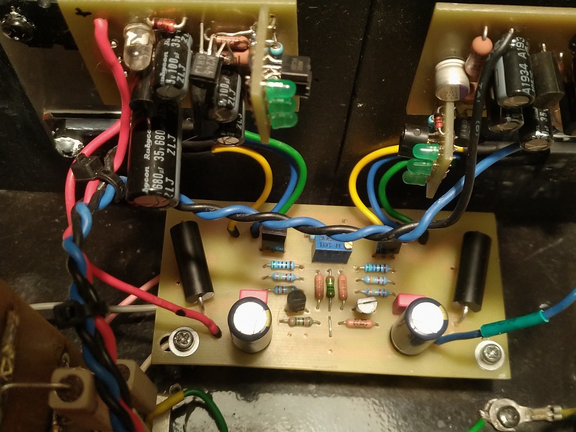

Hi all,
I'm the lucky guy getting the chance to work on the Le Monstre adaptation for 2024 and I have just had my first chance with some friends with educated ears to have a listen to one of the Le Monstre versions mentioned by EUVL in the first post/PDF. The version available was the Le Monstre 12V, with modern semis. This was no more than a first listen, more structured listening will take place as other versions are completed, chassis prepared etc. The setup was also hardly fair to the amp - I was using my 01a DHT preamp for the task, and the speakers are my stacked quad 57s, certainly not the easiest load for an amp with higher level output impedance. But past experience tells me that the electrostatics are not as tough a drive as the specs might say. The Le Monstre was powered from a lab supply set at +/- 12V, feeding 150kuF caps and then with 1000uF decoupling on the amp boards. So I think all you can say from this is that it was a taster of initial impressions of an amp under development - the other amps heard during the evening were a J2, and later my own build of the F5Pi (https://www.diyaudio.com/community/...rfectly-integrated.406024/page-6#post-7657850)
The comments from the panel here were very complimentary towards the amp - they were very impressed with the sound. In particular, the soundstage was mentioned, and that bass seemed tighter than with the J2. They were amazed that the low output power could produce such a robust sound, and we were listening reasonably loud - I did not measure SPL, but you would have to speak up quite noticeably to talk to each other, so probably as loud as I think most people would listen. I want to note that the panel are all dedicated/seasoned listeners with excellent audio systems, and so are well used to listening to excellent sound. They are also quite brutal in their comments, no punches are pulled 😛.
So what does this rambling post actually contribute here? I think it serves to give a brief glimpse of this adaptation, it certainly encourages the further work, testing, building and development of the versions mentioned in the PDF, and that it is highly likely that the investment of time and money will be well worth it.
