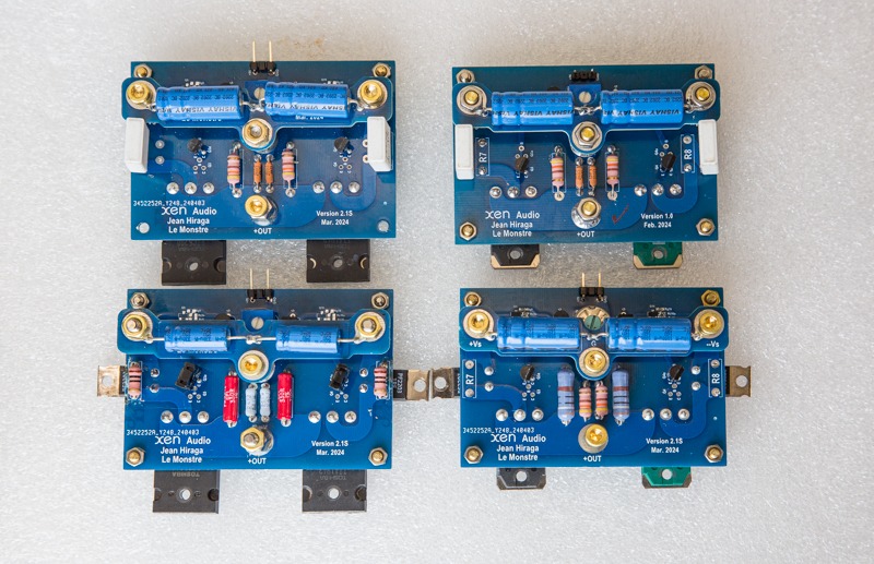

I don't know if the question has been raised but do you intend to sell some? PCB or finished product.
For PCBs, you can use the Gerber in post #12, not ?
https://www.diyaudio.com/community/threads/hiraga-le-monstre-2024.413301/post-7696593
For JFETs, I was told that someone in Slovakia might have 100's of Y-grade.
So no need to ask us, as we only have GR grade.
And you can get GR grade on eBay.
For other transistors, depending on test results, either they can be bought from Mouser, or from eBay (for the originals).
But if you want to use what we have, when we have finished all the testing and listening, and if there is sufficient interest, we'll make a package available, like the F5Pi.
How exactly it might look like, we don't know yet.
Depends on which version comes out as winner.
Maybe there's no clear winner afterall.
Patrick
