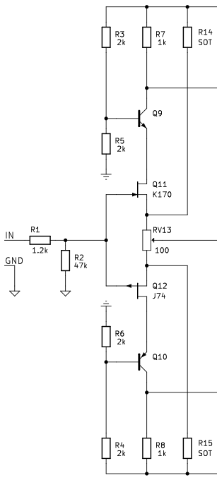

One CCS (or simpler: A resistor) is connected between TP1 and TP2, and the other between TP3 and TP4. It has been explained before.
Resistors connected to TP1/TP2 and TP3/TP4 will reduce the input stage gain and hence GNFB, wich is a very bad idea
since this amp has already low OLG, it will just increase the distorsion.
If CCS are connected instead this will change nothing to the amp OLG and is also useless as it wont improve anything,
you ll just get the input fets that will drain uselessly more current, overall that s a cosmetic variation that make people
Are you sure ?
Not according to Spice, which shows essentially the same OLG.
Of course CCS marginally better.
But at least we are back to technical discussions. 🙂

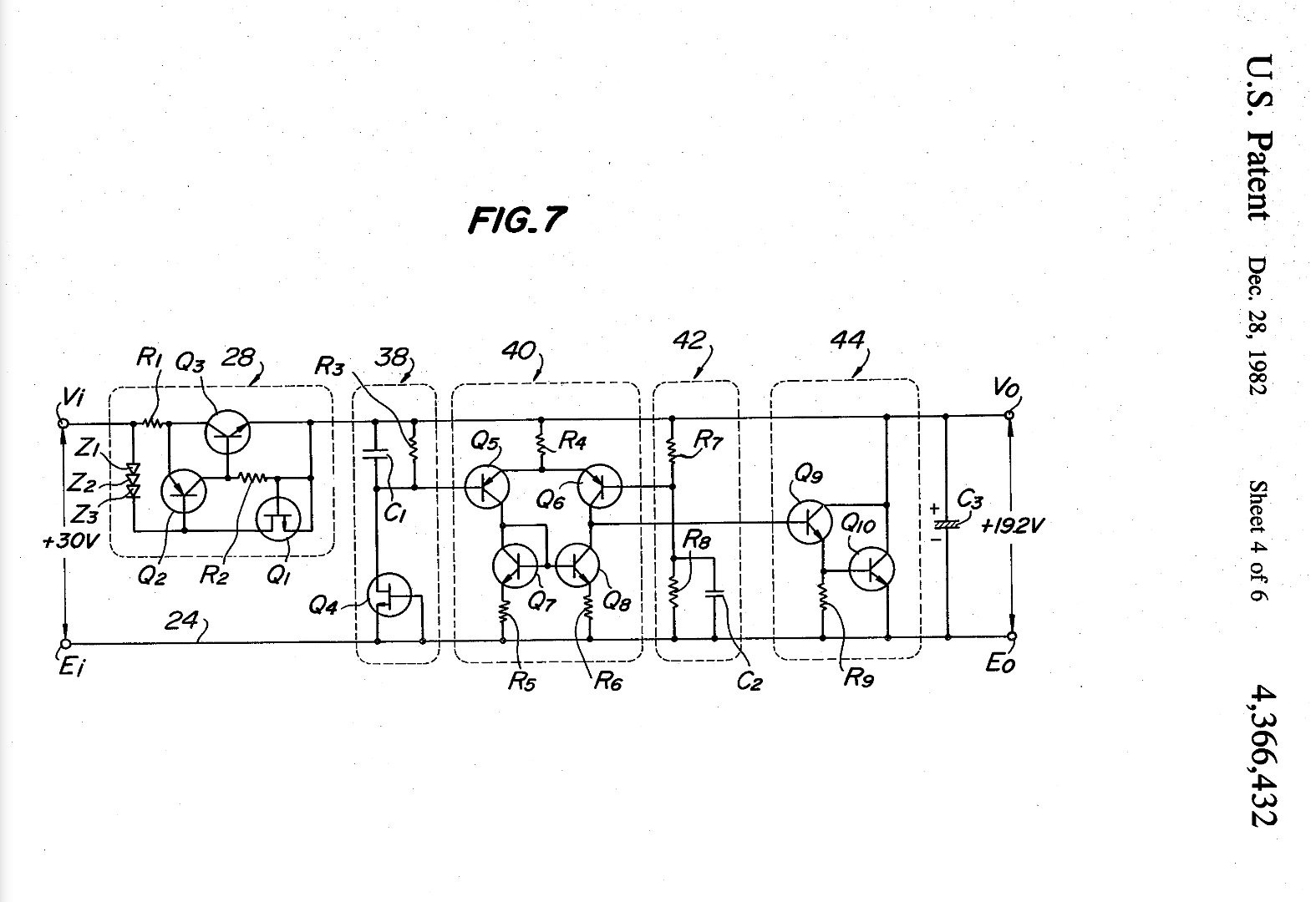

Speaking of Stax (sorry OT)...look what this is, a shunt regulator structure that we are still using today, and Stax filed and gotten a patent for it in 1981 and 1982, respectively. 😀
https://patents.google.com/patent/US4366432A/en

Hello,
The ccs is shunting the cascoded drainresistor so the drainresistor is sensitiver to current changes. This makes the loopamplification higher.
Bypass Current Source vs Resistor
With my very limited understanding of electronics, this is how I interpret Knut's suggestion of using a simple resistor in lieu of the bypass CCS.
It was stated that using a resistor will reduce the frontend gain, which is of course true.
The question is, by how much.
In the original Hirage circuit, with 0.6A output stage bias, target voltage across the 1k drain resistor is ~1.2V.
That means its current should be 1.2mA.
This is of course the same current through the JFETs and the cascode BJTs, as well as the 100R trimpot.
Datasheet of 2SK170 indicates that the transconductance at 1.2mA is ~16mS, or an equivalent resistance of 60R.
Assume also the trimpot is at its mid position, i.e. 50R for each half.
The input stage gain is 1K/(60+59) = ~9.
In our example of GR grade JFETs, with 50R at its source, the drain current is ~2.3mA.
Since we only want to allow 1.2mA to flow through the 1k resistor, we need to bypass 1.1mA.
Because TP2 is at the base of the cascode transistor, voltage across TP1_TP2 is ~6.6V.
We can either connect a current source of 1.1mA across TP1_TP2, or a resistor of ~6k.
The above is of course all DC.
Suppose we now apply a small AC signal to cause the JFET to swing 0.1mA.
In the original circuit, and in case of an ideal current source, all of that current wing can only go through the 1k drain resistor.
So the input stage gain is, as stated above, ~9.
But the cascode transistor also has a small emitter resistance, approximately 20R at 1.2mA.
In case of a 0.1mA ac current, TP2 will change from its DC value by 2mV.
Which means that the current through the proposed bypass resistor will also change by 0.33µA.
This has to be subtracted from the current through the 1k resistor, which now only swings 0.0997mA instead of 0.1mA.
That, if my sums are correct, corresponds to a loss in open loop gain of 0.33%.
The exact value depends also on the Idss of the JFET used.
So it is still desirable not to use, e.g. BL grade JFETs, unless you are using a very good CCS and not the resistor.
But I am sure Knut will correct me if I am talking nonsense. 😊

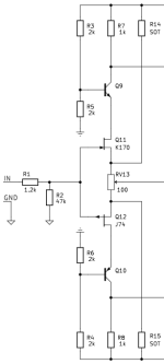

No, Patric, you are perfectly right!
As a matter of fact, a while ago, I used another approach, as seen in the attached figure. I have even made PCBs for this solution, but I have not tested it.
Here R14 and R15 will reduce the drain current, since the gate-source voltage is increased. I suspect CCSs instead of these resistors are a better solution...
IMHO, TP2 is a better location for bypass, because its voltage changes much less with signal.
The BJT cascode is responsible.
The advantage of your proposal above is that the resistor value can be larger (bit less than 2x).
But it swings about 2.5x compared to TP2.

as it s actually embedded in the output stage and used as direct driver for the power transistors.

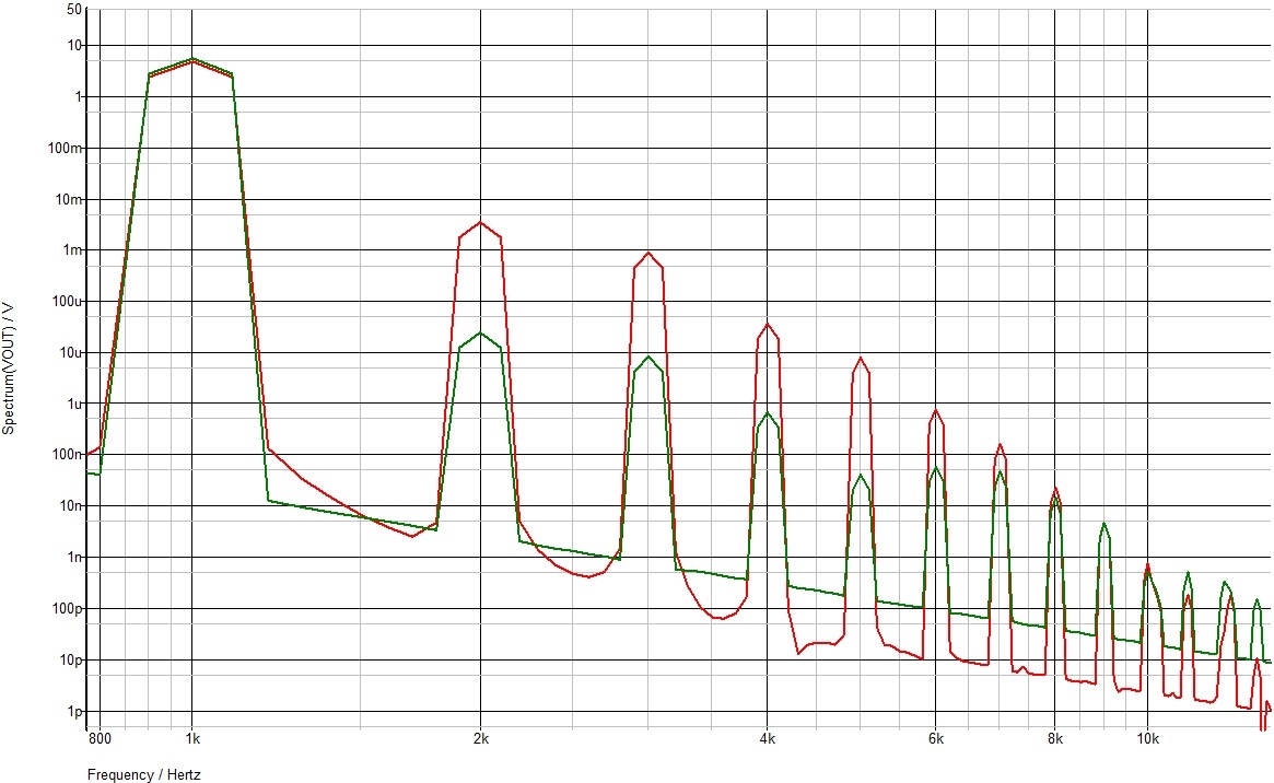

That s the typical THD of the original schematic at 2W in red and in green what could be done with a rework,
the latter case has a -100dB THD/1KHz and is within CD definition wich is about 96dB with a 16 bit DAC, rest is just
getting 0.1% instead of 0.15% and is of no interest, it s like reworking the Cx of a car without ever adressing
its engine lack of power.
Now since you re talking of Spice, could you provide some simulations of the linearity.?.
Because that s all good to say that it s better but without even simulated numbers that s a moot point
and is borderline dishonnesty.
