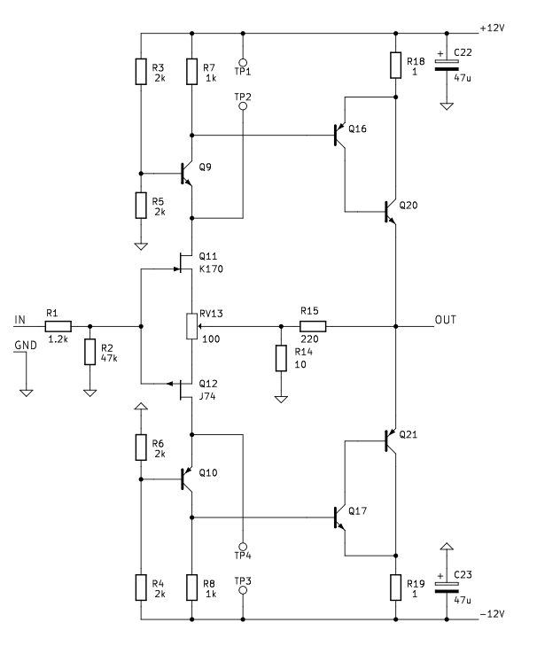

For beginners a schematic with the new components that went along with the description would have been nice. Not everybody has your level of expertise.The schematics is the original Hiraga as in the first picture of the pdf.
All the details of the other versions are fully described in the article.
Anyone can easily follow and build their own.
You have a wide selection of PCBs on the internet to choose from.
And there are also offers for GR grade JFETs as well as ALL BJTs.
I have also described how to use BL grade JFETs.
You need nothing from us.
Patrick

Download the image of the original, and modify with photo editor.
Like everyone else.
https://andiha.no/audio/projects/AlaHiragafig/a.png
Patrick
But where is the CCS in the original diagram (https://andiha.no/audio/projects/AlaHiragafig/a.png)?
Have you published any diagram including the CCS? Your answer is not satisfactory; all that for that...

To imply that someone "should" provide you information and work for free is absolutely absurd, particularly after that person has shared a great deal. A great number of people can build this project without a kit and without paying any money. The fact that you cannot is only your personal problem.But where is the CCS in the original diagram (https://andiha.no/audio/projects/AlaHiragafig/a.png)?

Patrick has put out a great number of incredible designs for us to try. If you do not have the skills to build this particular project, a few options could be:
Learn
Build another project.
One CCS (or simpler: A resistor) is connected between TP1 and TP2, and the other between TP3 and TP4.
Exactly, It has been explained before. 🙂
In detail, in the pdf in post #1.
