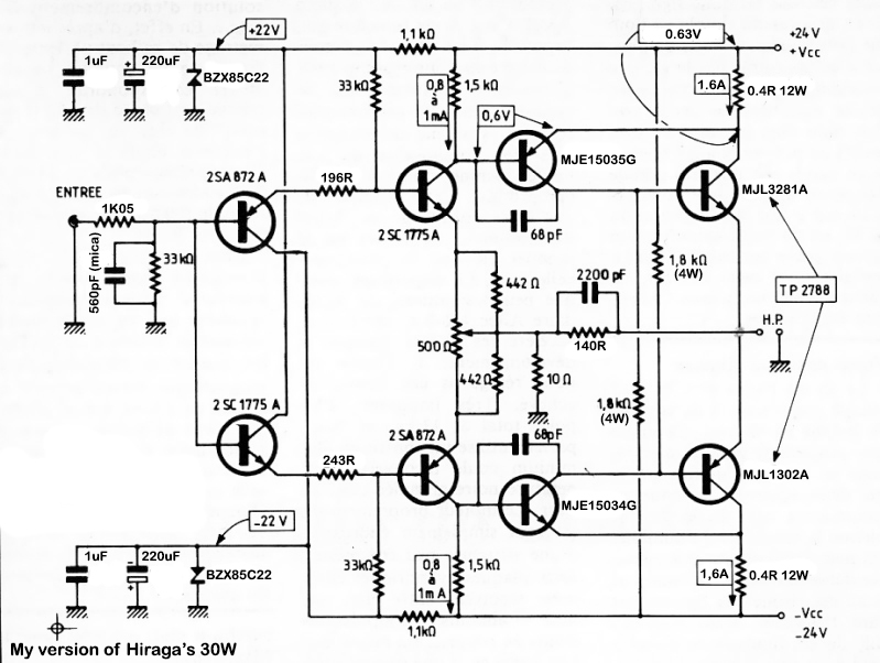

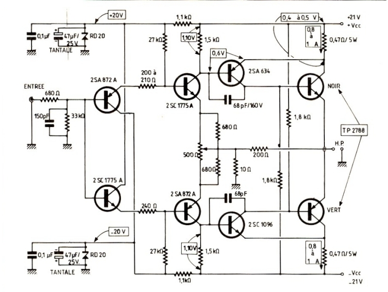

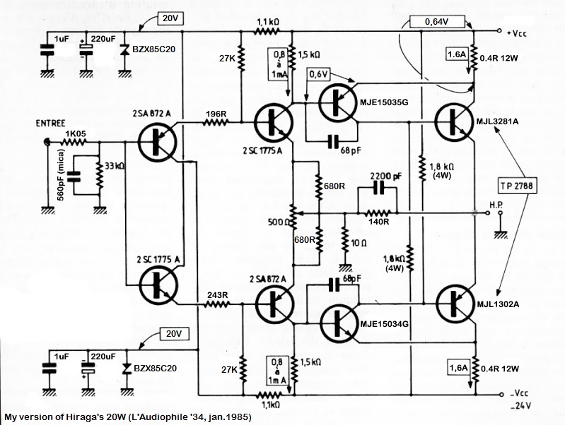

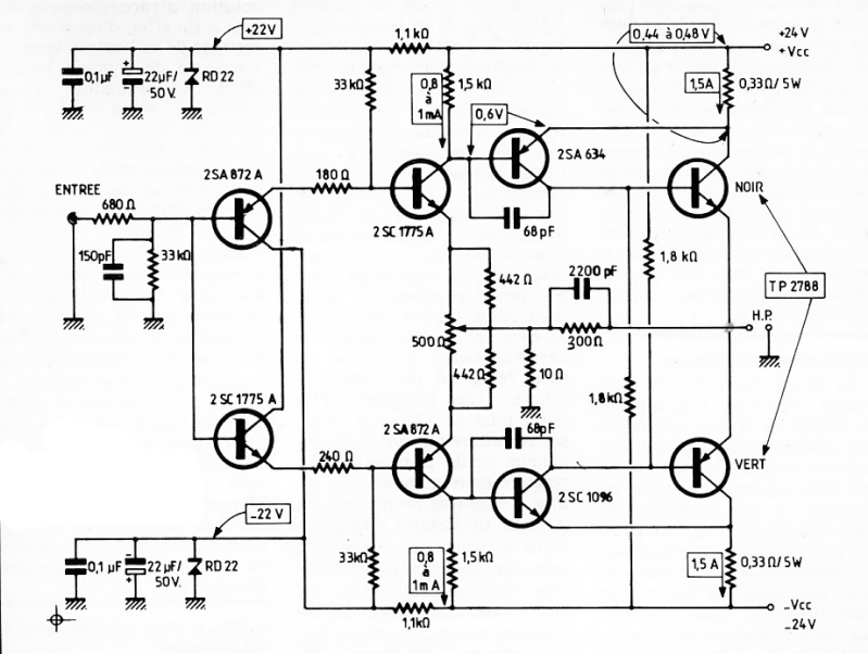

Hiraga's 20W or 30W need big power supply. Exist 2 version of 20W: 1979 and 1985. In version of 1979 in power supply used filter 0,36F (CRC 1:2, 60000 uF + 1 om (30W)+ 120000 uF per shoulder). In 1985 has been made new version of 20W and 30W with filter 1,456F (CRC 68000uF+0,22 om (25W)+2x0,33F per shoulder).
I builded Hiraga's 20W (1979) and 30W (1985) Amplifiers (the sound of 30W much better, than old 20W), now I building 20W (1985) (maybe will be better).
Now I building 20W version (1985), because very interesting: what's better 20W or 30W.🙂

Hi

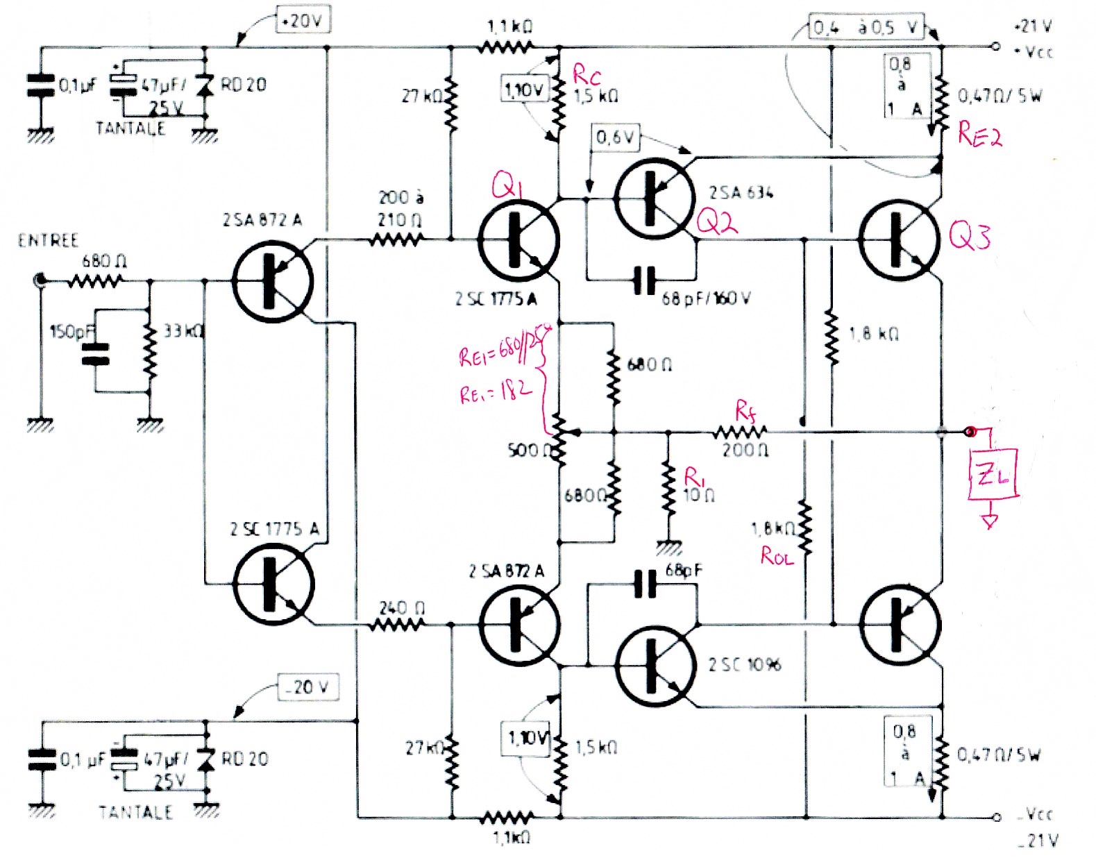

I am doing some analysis on my own. Here is my educated guess.....emphasize GUESS!!!
1) OPS is Q2 and Q3 forms the composite NPN emitter follower with local feedback gain. The gain is from Q2, I call this open loop gain which is ROL/RE2. The total stage gain is ZL/RE2. Where ZL is the speaker load that is frequency dependent and is not pure resistive.
2) VAS is Q1 with gain equals RC/RE1. In this case is 1.5K/(680//250)=1.5K/182 ( assuming the 500ohm trim pot is in the middle).
3) Since the IPS stage is only emitter follower that has unity gain. So the open loop gain of the whole amp is the gain of VAS X OPS.
The major difference of the OPS stage from the normal 3EF stage is the gain is load impedance dependent, not just gain of close to unity. For EF stage, gain is straight voltage gain, this mean if the speaker impedance goes higher with frequency, the output power goes lower as frequency goes up. In this design, when the impedance of the speaker goes up, the output voltage goes up as it's more like a constant current source. But it uses Q3 to lower the output impedance.
But there is a contradiction. There is a global feedback that set the gain of the whole amp, the gain is 1+Rf/R1. This is pure voltage gain. This negates the constant current characteristics of the composite OPS stage. The open loop gain is very low, so the characteristics of the OPS do show up. So it's neither here nor there!!!
Maybe that's the reason why the author claims the output power of this amp does not double when you half the speaker impedance. This is more like the tube amp circuit.
I am going to simulate this circuit when I have time as I am too busy trying to sent out the boards. Please let me know what do you think.

In my construction with +-22,5V (after CRC filter) maximum output voltage on 7,5 om+2,2uF (Epcos MKP) is 14,2V RMS with THD 1% 1 kHz. (As for me 1W RMS to 6 om in music very very loud). Bias=1,55A (0,62V across collector resistors). Bias stable after 20 min. DC out=+-10 mV. "The sound" not tested, because night.:cheers:🙂

The bias depends from driver transistors HFE too.😀😀😀😱:cheers:
I don't see any bias adjustment. The 500ohm trim pot is more of a balance adjustment between the bias current of the top and bottom half.
seems like the 2SA872A and the 2SC1775A need to be thermal coupled on the top half to stabalize the bias drift. Also the bottom two transistors has to be thermal coupled together so the Vbe drift is cancelled out.

20W version like me a little more, than 30W.
I don't have any problems with bias drift, it increases for 20-30 minutes and then stable (bias drifting +-25 mA).:cheers:

No, I am really busy trying to send my boards out tonight. I'll try to find time to do it this weekend.
But I am very intrigued with this design. It makes a lot of sense when he compare with the tube amps. Normal SS OPS are straight voltage amp with very low impedance. Efforts are made to make the output impedance as low as possible. So if the load impedance change with frequence, the power transfer to the load change with frequency also.
This design is kind of a control current source. It's the current that drive the load, so when the impedance of the load change, the voltage change along with it. So the characteristics are totally different from the conventional amp.
Granted it has GNFB, but the loop gain is low and you really don't get the full effect of the normal closed loop feedback benefit as much.
