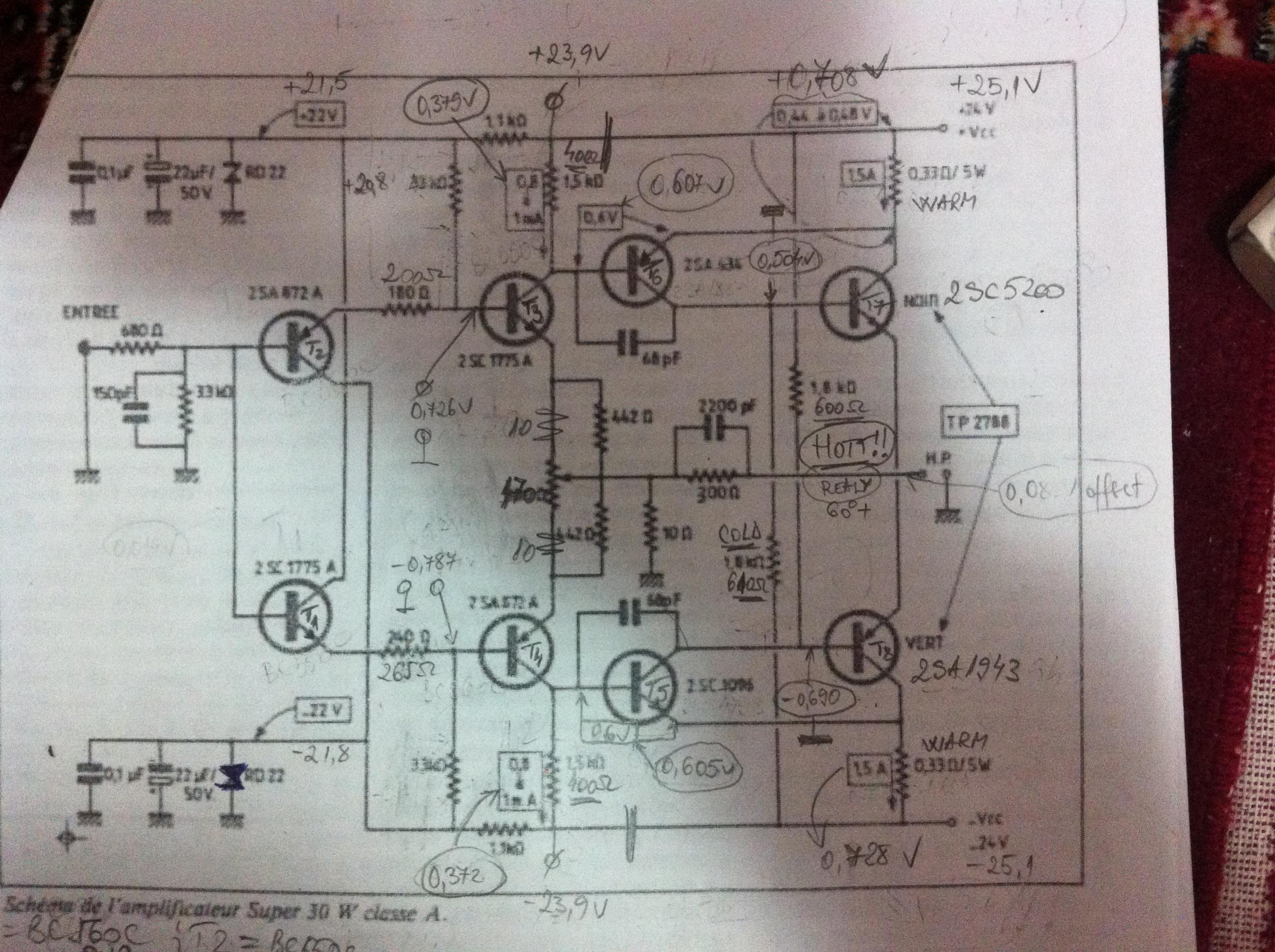

I raised the 0.33 ohm resistors to 0.5 and the result is aprox the same 1.01V across them =>2.02A bias current from 0.734V across the 0.33Ohm (2.22A).
Looks good but i increased the 0.33 ohm for this. I'm at aprox the same value as the 20w Super class A wich had 0.47 ohm resistors.. 🙁
Daniel, Gaborbella, Hugh, 6L6 look what i did now 🙂. Look at the picture bellow with the results.
I cannot decrease the bias with other method than by lowering the 1k8 (and 1k5) resitors and injecting some more negative and positive currents into the output transistors bases ( i see that if you increase the two 1k8 resistors nothing dramatic happends on idle, but if you decrease them your bias goes down).
I have a problem with one of the two 1k8 (now 600 ohm value) resistors wich is really hot. Is this the consequence of the higher T8 base voltage of 0.690v? Sould i drecrease it more?
What do you say should i go lower with these two resistors values or lower the 1k5 resistors more to get a lower bias?
I know that i have aprox 0.9mA across the "1k5" resistors wich is really really good but what about 0.379v across them? Is this voltage sufficient to keep the transistors open or should i readjust them to a higher ohmic value and readjust the other 180/240 resistors again to have 0.8-1 mA at aprox 0.6v?

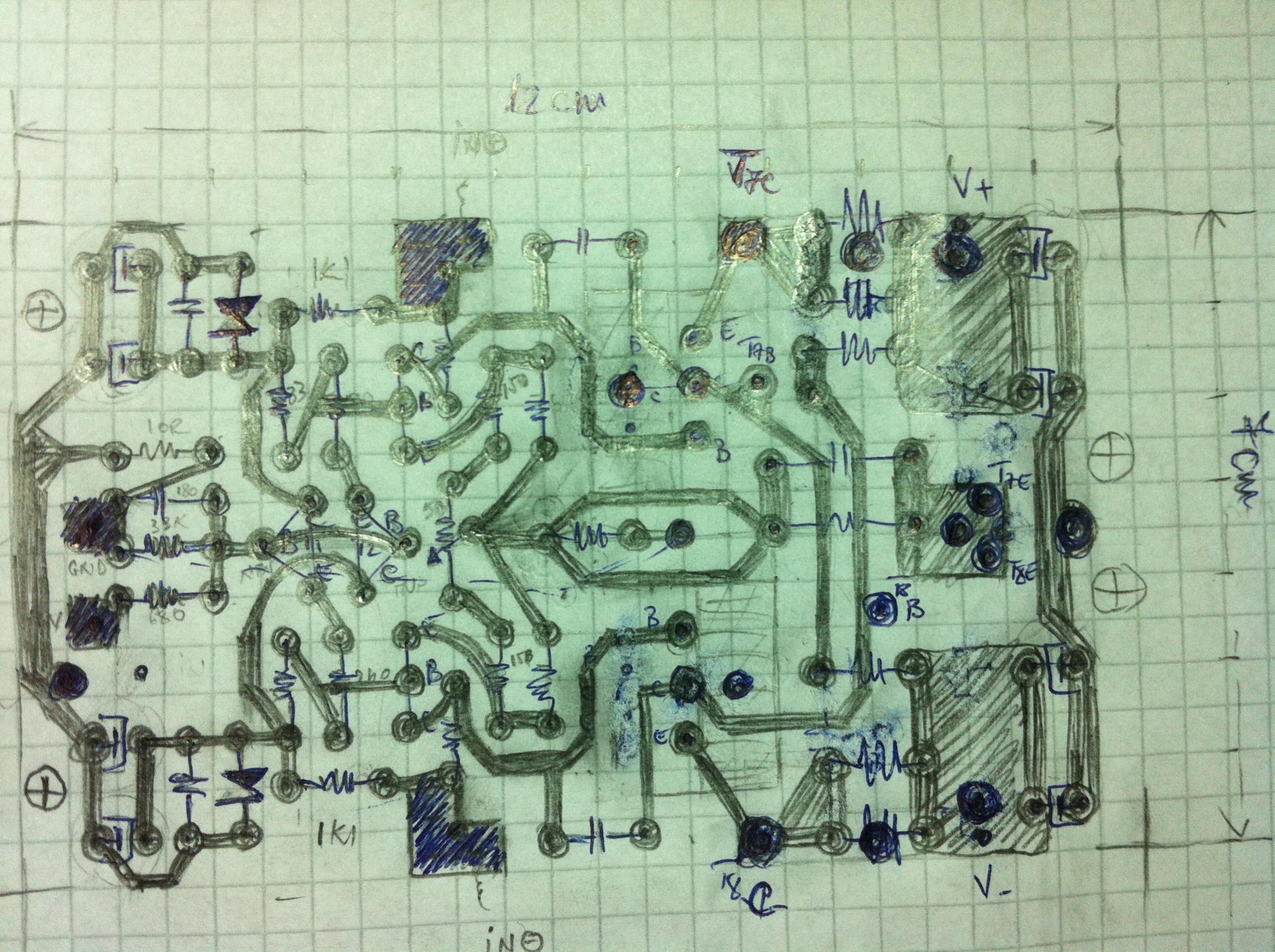

I want to werify the pcb, but i couldnt find any pcb error whatsoever (inversed transistors or wrong resistors). Can someone help me with a quick diagnose?
What do you say about the pcb? Does it has any error or ground loops?
This is the pcb that i use for the above schematic.
Please help!

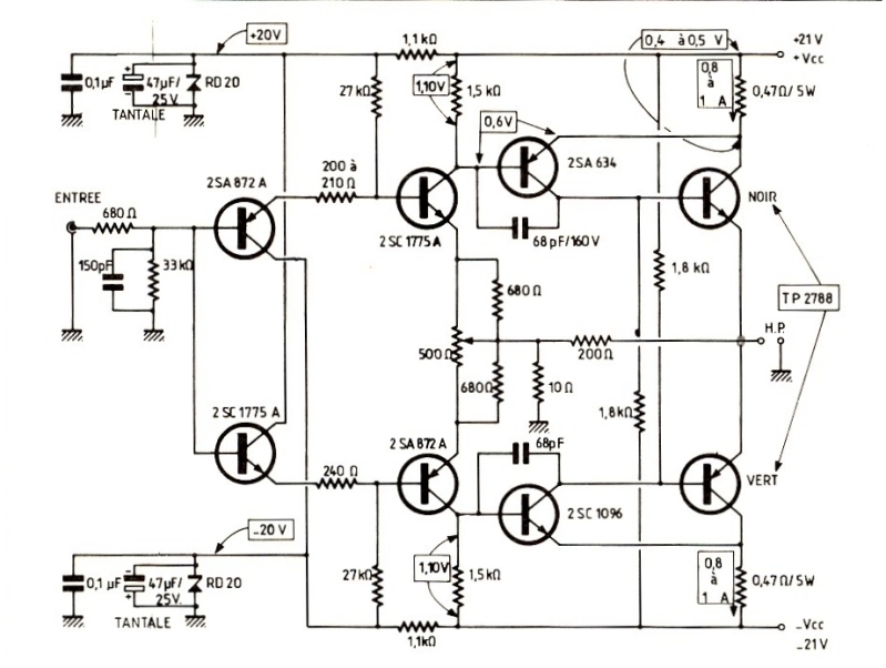

Hi Sergio
You can not get the right voltage everywhere plus the right bias with out using the same rail voltage (Power supply voltage)
My advise go back to the original circuit as close as possible!!
Replacing components here and there will effect the performance of the amplifier to.
Only increase the 442R resistors to 560R or so
Please replace the Zener diode with lower value Zener.
For example
You have now 22V replace it with 20V and check the total bias! If it need you can go done to 18V to.
The small transistors get 1-2V less that cause less problem than you try to mess with all components (resistor values) here and there
For example here on these circuit they got 25V rail V, you can see the Diode value how low compare yours.
You asked me before how to reduce the Zener diode, you have to chose the diode V.

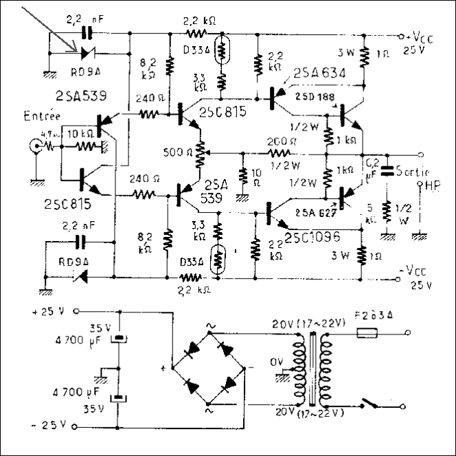

Hi guys. I want to build Jean Hiraga's Super Class A 20W Amp (L'Audiophile '34, Jan.1985), but I have some questions:
1) Is the sA 20W better than sA 30W?
2) Where is 2200 pF? It's not need in 20W version?
I have a small power supply 0,2F per channel, in future I'll make 0,75F per channel.
Transistors: 2SC1775E+2SA872E (in input), MJE15034G+MJE15035G or 2SC4793+2SA1837 (in drivers) and for output I have: MJL3281A+MJL1302AG, MJL21196G+MJL21195G, MJW21192+MJL21191G.
3) Maybe better to use 4 MHz transistors in output (if in schematic 2200 pF not exist)?

My problem WAS THE PCB. That's why i couldnt adjust the bias.
VERY IMPORTANT: dont design pcb by yourself if you dont know how the circuit works. It seems that this amp is the most sensitive amp that i have ever seen at this chapter............

Hello! How you resolved an issue with the raised current of output transistors?
Hi Mihai,
I'll describe it in steps (for the 30watter versions):
a) first measure the 1k5 and 33k resistors to be matched (THIS IS VERY IMPORTANT);
b) measure the 500r trimmer; the value should be fix 500r if not put resistors in series one for each end of the trimmer (not the wiper) to give this value; --this will help you ballance ellegantly the offset if the input is matched;
c) USE THE ORIGINAL PCB--this is the most important thing---i used a self made pcb and couldn't adjust the bias;
d)replace the 180/240 ohm resistors with 500R trimmers and set them at the values from the schematic respectivelly 180/240 ohm;
e) short the input and no output load and set the 500r trimmer at half;
f) set offset: it has to be between +0,045v ~ -0,005v;
g) measure the voltage across the 1k5 resistors, if it isn't equal on both sides adjust from the "180/240" resistors values to have the same voltage across the 1k5 on both sides.. The voltage should be between 1,06v and 1,5v.
In my 30watter i have 1,078v across both of them and it works like charm.
h) readjust the offset in the same limit after adjusting the voltage across the 1k5 resistors;
i) now measure the voltage across the 0,33ohm resistors; you should have between 0,495v or UP if you have decent cooling;
If the bias is not it the range specified above, then put a 100k double pot in place of the 33k resistors set to 33k for start up and after start up adjust accordingly.
If you have higher voltage psu than +-25v (specified in the schematic) or above 27v cc, increase the 1k8/2w bias resistors. I have a 27V cc psu and it was not needed to increase the 1k8 value... If you go higher you have to increase this value accordingly.
DO NOT decrease the 1k8 value to adjust the bias because even if it will decrease the bias abit you will just increase the local NFB of the "darlingnot" output arrangement wich is not good. ---i tried it, it worked,but didnt listened to this mod...i reverted back to the original value;
***Another solution for bias adjust (if the above advices didnt work) is to lower in STEPS the 1k5 resistor value to minimum 680ohm (dont go lower), measure the voltage across it so that it will be in the parameters specified above (between 0,5v and 0,68v across it) and then readjust the 33k resistors to lower the bias..-- tried this version with succes.
Increasing the 0,33r to 0,47r value of the power resistors will also decrease the bias...
