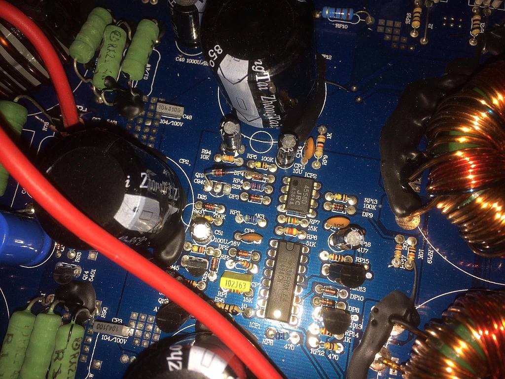

U9B is the same op amp we were doing the bridge 1-2 pins. NE5532. Pin 5 from the NE5532 goes through 2 resistors 100k and 1ohm, then directly to pin 18 of Hip4080.
Pin 6 of the same OP amp goes again through 2 resistors 100k and 1 ohm and directly into pin 12 of HIP4080

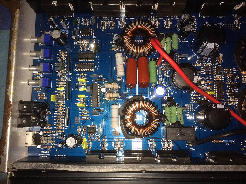

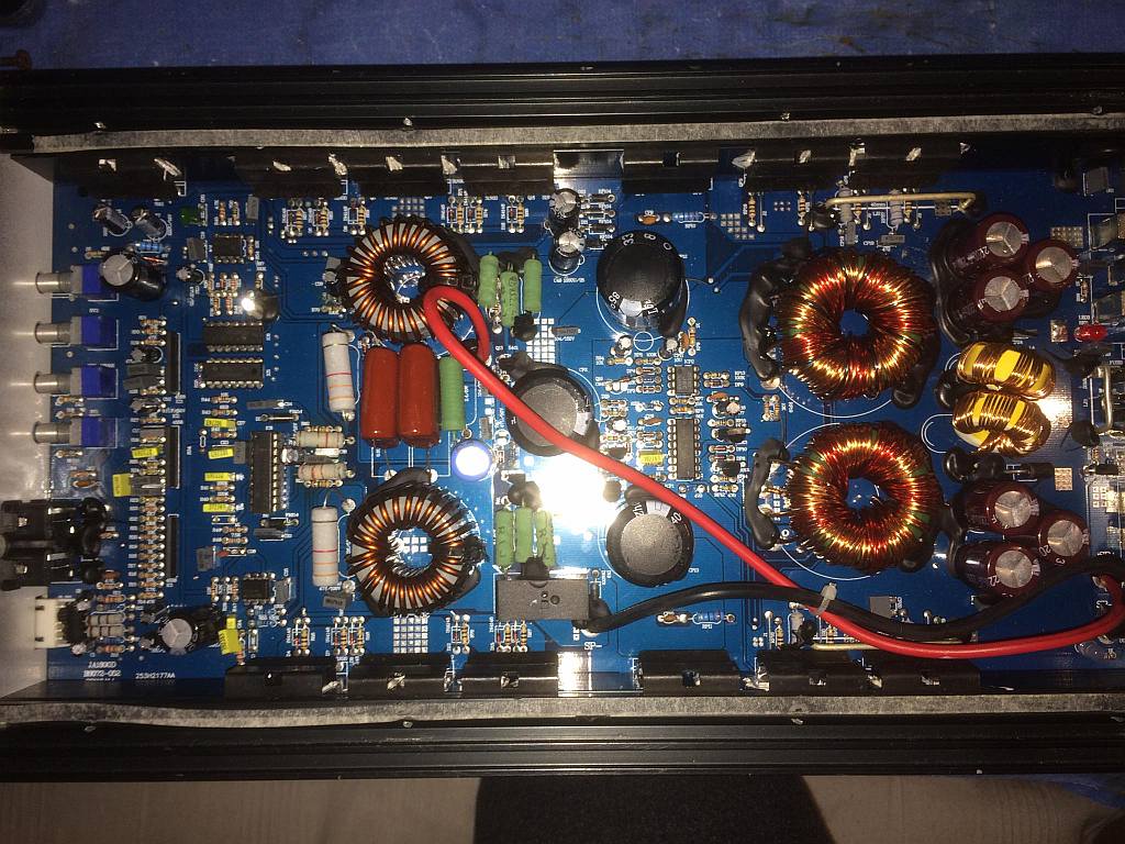

I will attach some pictures.

Okay. I've fixed the amp and then by my stupid mistake in the late evening I've slipped the probe and killed one of the banks in the output section.
This resulted in a dead HIP4080 too.
So I've ordered new mosfets and HIP4080, but still i'm not sure if this is all i've killed in my lame mistake.
