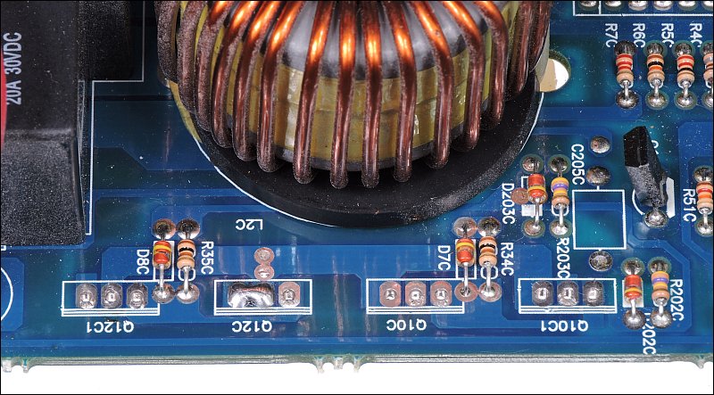

Terminals 1 and 2 of the IC that drives the input of the 4080.
The 4080 has to be in the circuit to get the drive waveforms.
To get the high-side, you need to bridge the drain and source of the low-side FETs (Q12C below).

HIP4080 in place.
I've bridged the drain and source of the low-side FETs.
Noticed something. Gate drive is at what it is supposed to be - sharp square waves at 8vrms.
When there is no signal applied to the RCA there is constant 12.57v DC at A high side, as it should be, but at B side it's sitting on the Low side, not at the high one.
In your guide Perry there is a note - Note About High-Side Drive Power Supplies: it is said that only the high sides needs this 12v above positive rail voltage.
Here are the pin voltages without any signal in the rca.

Shouldn't pin 11 and 20 - which are A+B High-side Outputs have both 12.15v and not pin 18 which is B Low-side Output ?
"All drives should be sitting on ground with the low-side G-S shorted." - the picture above shows DRAIN - SOURCE shorted, not Gate-Source. I'm confused...even in the guide it says "Below, pads 2 and 3 for Q12C are bridged with solder " so that's drain and source.
Do you have the equivalent of IC4C shorted? - no, do I need to ?
Pre-amp section is working fine, why do i have to drive the 4080 directly ?
Sorry. That should be d-s as shown in the photos.
Shorting the op-amp pins will close the feedback loop locally. Without the short, the op-amp output could be virtually anything. With the short, it should bring the voltage to the same as the non-inverting input which should be the same as pin 6 of the 4080.
At this point, you don't need to drive the 4080 directly. The triangle waveform on pin 6 of the 4080 and the straight DC on pin 7 should provide all of the drive you need.
Do you have the equivalent of IC4C shorted? - I've just did.
It is self-oscillating at 65khz with duty cycle of 40% for the low side and 60% for the high side. Don't know if that's okay.
But when i remove the short from IC4C and play 50hz sinewave to the rca - all gates have 50% duty cycle, low and high.
So i suppoose it's alright ?
