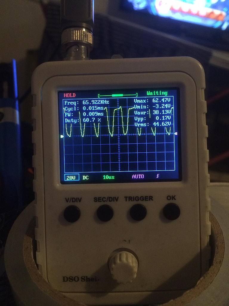

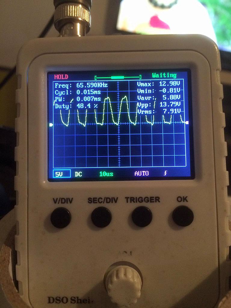

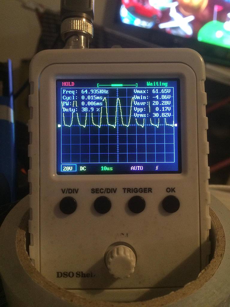

They are in order: 5-6-7
Yes I do. I've seen test of this scope, reads pretty accurate to about a few Mhz.
Amps works just fine if i just wait 15-20seconds after relay clicks.
I have 4 pcs of IRF3710Z...this weekend i'm going to pull all of the B31N20D and replace them with the IRF3710Z (one per bank).
If this won't help, i'll order new hip4080 and replace it with ne5532 together
There are some inconsistencies. Previously, the duty cycle was 48%+. Here, it's 38%.

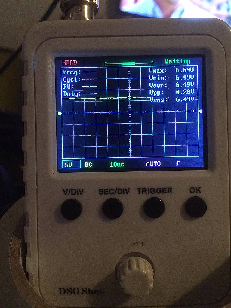

Using a multimeter and measuring the DC voltage from pin 4 of the op-amp to pin 6 and pin 7, when the voltage across the speaker terminals drops to (essentially) 0v, what is the voltage on those two pins?
I'm sorry to tell you but the scope isn't accurate, even at 65kHz. The waveform on pin 5 is going to be very nearly a perfectly shaped square wave. If the signal on the output FETs was as shown, the FETs would overheat and fail.
The difference in the waveforms from one bank to the other is due to an offset in voltage between the DC on pins 6 and 7.
DC offset goes as low as ~ 0.6v, does not drop to totally 0.
DMM for DC measurements, black probe (GND) on pin 4 of the OP amp red on pins 6 and 7.
NE5532:
pin 6 - 7v
pin 7 - 6.45v
HIP4080:
DMM black probe (GND) on pin 4 of the OP amp red on pins 6 and 7.
pin 6 - 5.9v
pin 7 - 6.05v
If I short pin 1 and 2 at the op amp ne5532 same measurements with (18v DC offset at the speaker terminals)
ne5532:
pin 6 - 7.2v
pin 7 - 6.9v
hip4080:
pin 6 - 5.9v
pin 7 - 6.45v
6/7 of the 5532 aren't important with pins 1/2 shorted.

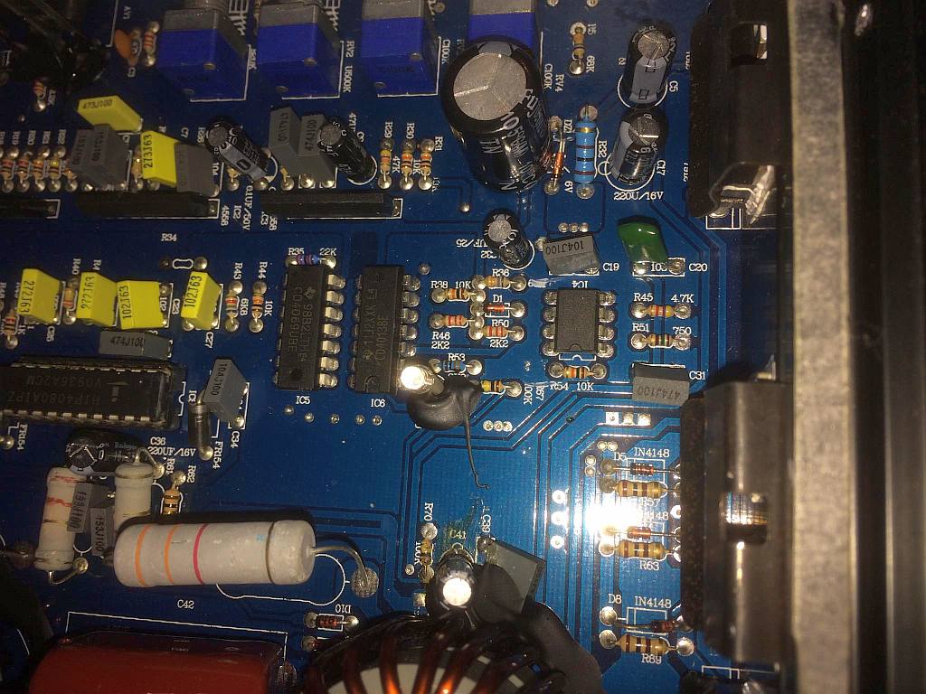

Pin 7 from 393 goes through two 2k resistors to pin 4 of CD4013BE which datasheet says it's reset 1.
Also pin 1 from 393 is in direct short with the same pin 4 of the CD4013BE
