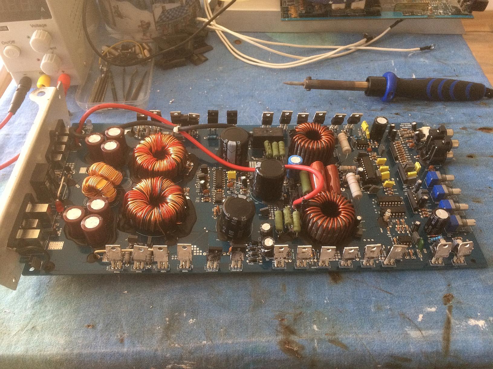

Hello everyone !
Long story in short - it's a cheap class D hip4080 amp using B31N20D for output mosfets. Rail voltage is almost 70v at 14.4v b+ input
Works fine with no load connected. Sinewave is good, no distortion.
Once load is being hooked up it goes into frenzy mode 😀 . I've tried with different dummy loads values and a subwoofer.
What have noticed is that if you turn on the amp and let it idle with no load connected for 10-15 seconds and connect a load afterwards it works just fine.
I've measured DC offset between the - and + speakers output. And here it is. Once the amp is being turned on there is the FULL rail voltage difference between the + and -, that 70v volts difference. Then It slowly sinks down to a ~ 0.7v after 15 seconds.
So if you connect a load after the first 15 seconds when the amp is being turned on and the DC offset has been stabilized - it works just fine.
If you turn on the amp with a load connected on - it draws a lot of current and there is ....well you know what happens when You have +70volts difference between + and - speaker terminals (i'm glad i'm using dummy load this time, not a subwoofer in the tests).
My question is - is it the HIP4080 or a leaky Mosfets. I don't see a muting transistor at the board (don't have schematics due to this being really cheap chinnese amp).
Both HIP4080 and the mosfets IRFB31N20D are not easy and cheap to find over here, so is there any test i can do to determine where the exact fault is ?
The amp has been carefully re-caped, resoldered and cleaned up.

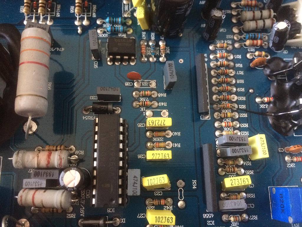

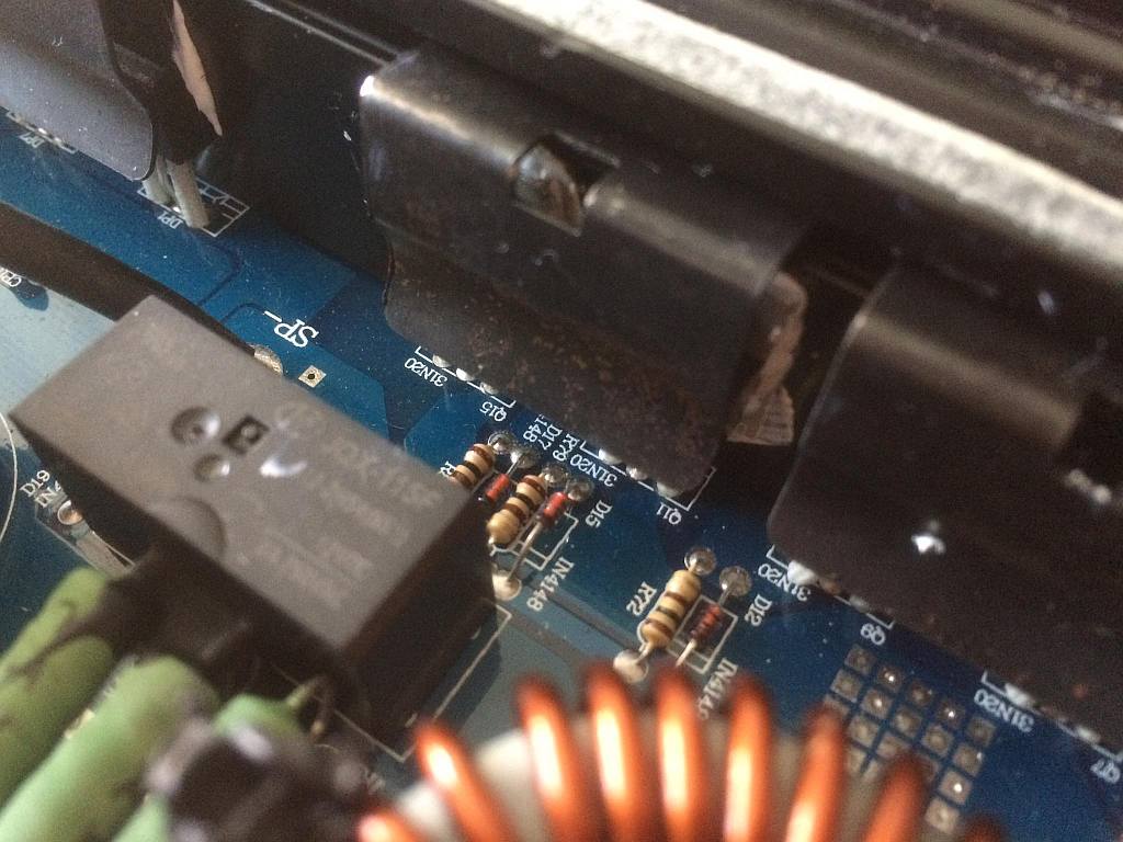

Are the 31N20s original? I've never seen a 4080 amp use them.
Do you get the same offset (lower level) across terminals 6 and 7 of the 4080 when the amp initially powers up?
That's why I posted this thread. This is the first amp with hip4080 using these type of mosfets. I've personally always been using irf3710z, but even the markings on the board says 31N20s. And yes, these are factory mounted. No previous repairs.

I've noticed a factory missing resistor hip4080 pin7 to ground (i think )

Is the large resistor near R59 within tolerance?
- Both reads ~ 2.2 ohms as they should be.
See if you can find the equivalent resistor (capacitor?) on the attached diagram.
-Could not find any, maybe this board is being used for other amps with additional features. But R18C in the diagram is 10k, mine is 1k. That's 10 times difference....

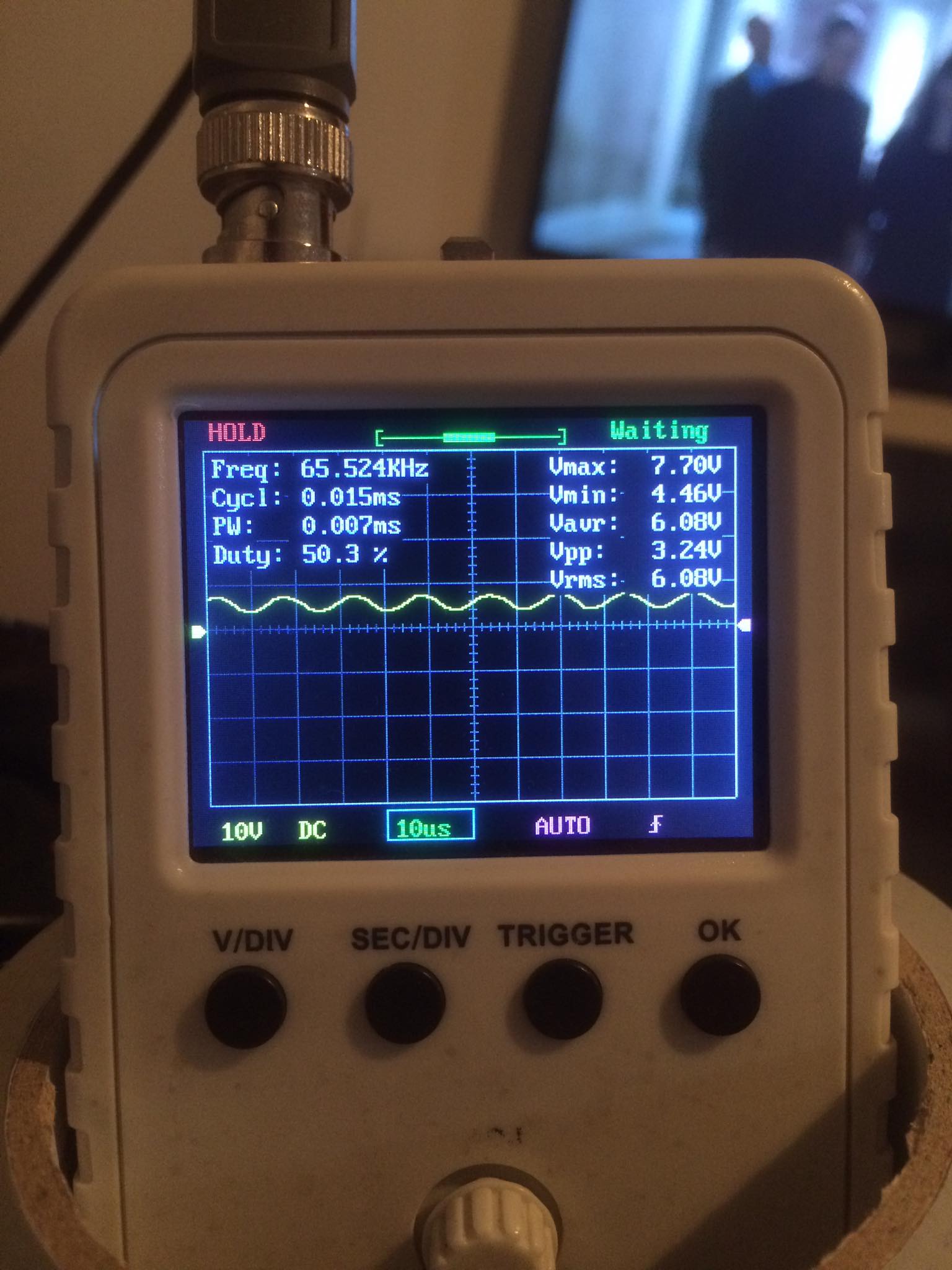

It is NE5532:
pin 1-6v 65khz switching
pin 2-6.5v
pin 3-6.5v
pin 4-0
pin 5-6.9v
pin 6-6.9v
pin 7-6.5v (something like a switching, unstable little waves 47~56khz)
pin 8-12v

What is 1/2 and 3 with 1 and 2 shorted?
Pin 1 should not have any significant switching on it. It should be audio (maybe not clean, but audio).

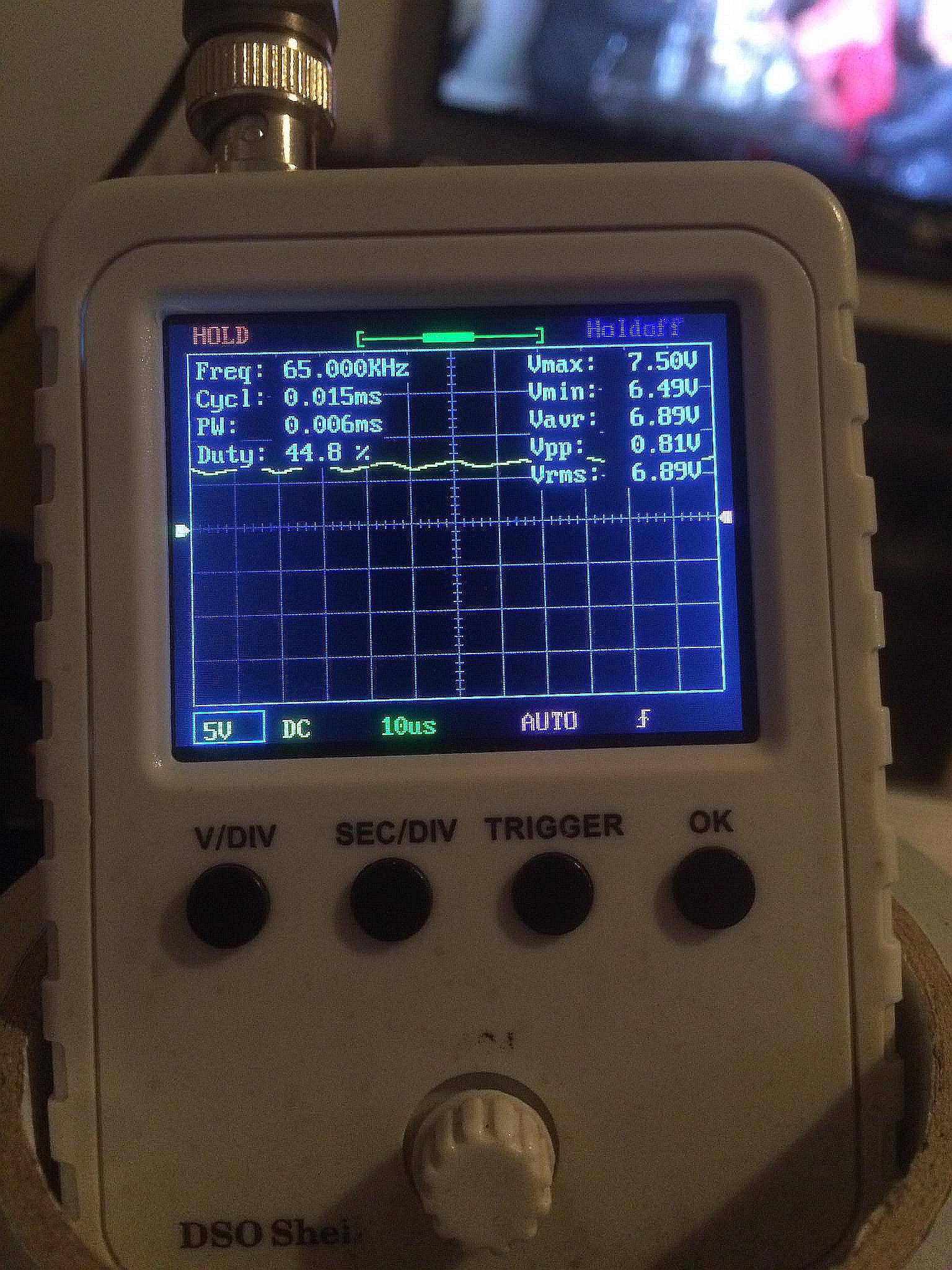

Are you saying that with the short and 6.5v on all 3 terminals that you have 18v on the output?
Yes, I checked three times. I've even tried with and without RCA signal. Same result. 18v straight DC between + and - speaker output.
NE5532 with pin 1 and 2 shorted, RCA unplugged.
pin 1-6.5v straight DC
pin 2-6.5v straight DC
pin 3-6.5v straight DC
pin 4-0
pin 5-7.1v noisy dc (really small small waves)
pin 6-7.1v noisy dc (really small small waves)
pin 7-6.9v (something at 65khz picture attached)
pin 8-12v

Pin 6 at HIP4080 does NOT change when I short pin 1 & 2 at the NE5532. Still have triangle wave.
But pin 7 at HIP4080 does change - it goes into straight DC.
Straight DC at the center of the triangle waveform should not be producing DC on the output. As the triangle crosses the DC, the output FETs should swing from 0v to rail).
