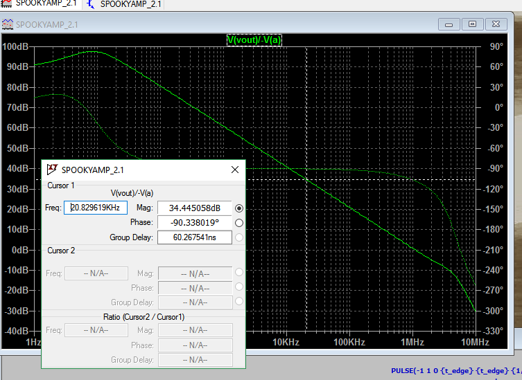

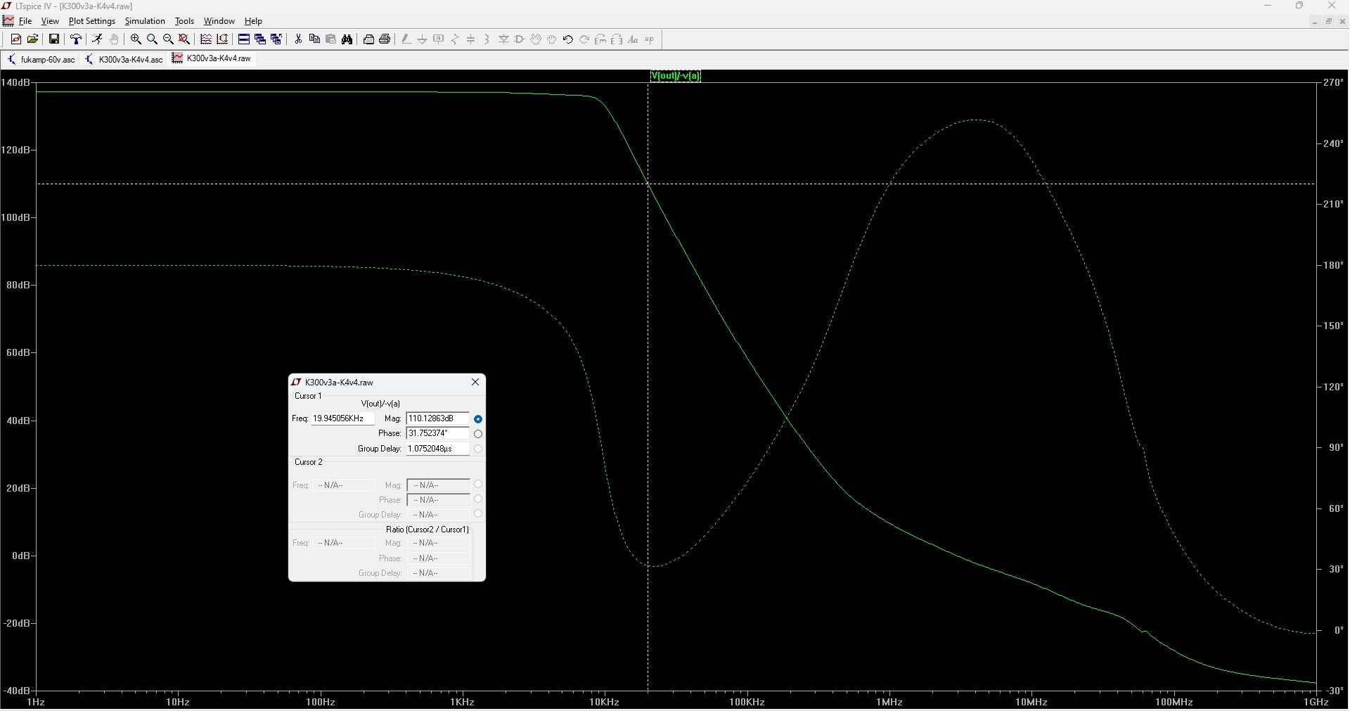

one hope is for the depth of negative feedback - at least 90 dB deep at a frequency of 20 kHz - I think this is a separate class of amplifiers as “ultra deep NFB”
Seen that. Wolverine @ 20K has 70db total , about 38 "extra" for correction. This is with TMC. Some 3 stage hitachi IPS's can muster (90 gain)
extra at 20Khz. IPS's such as these , you need "fancy" (lead /lag) compensation to keep phase margin.
TMC also trades margin for extra 20K gain.
Some designs (symmetrical - leach) are just more linear natively (below 2) , can still get <20PPM 20Khz with simple miller and only 30'ish NFB. Margin (90 deg.) stays
large out to many Mhz. I've omitted any comp. on these types and they still won't oscillate (or they just "rang" on a square wave). Still , a small miller
to define the unity point is good practice. The miller does not slow down even a CFA (much).

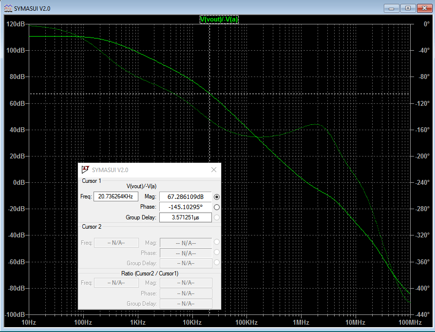

The input stage of a symmetrical Leach has a gain at a frequency of 1 kHz as much as -4 dB (nonsense), and the nonlinearity of this open loop stage is +/- 10 dB. the depth of the NFB at a frequency of 20 kHz is only 16 dB. and there is completely no neutralization of the internal resistance of the VAS multiplier.
