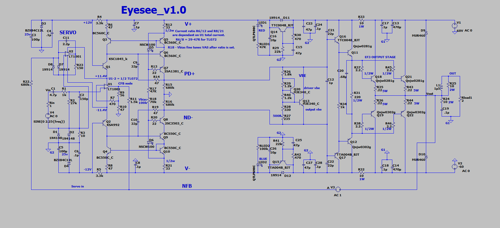

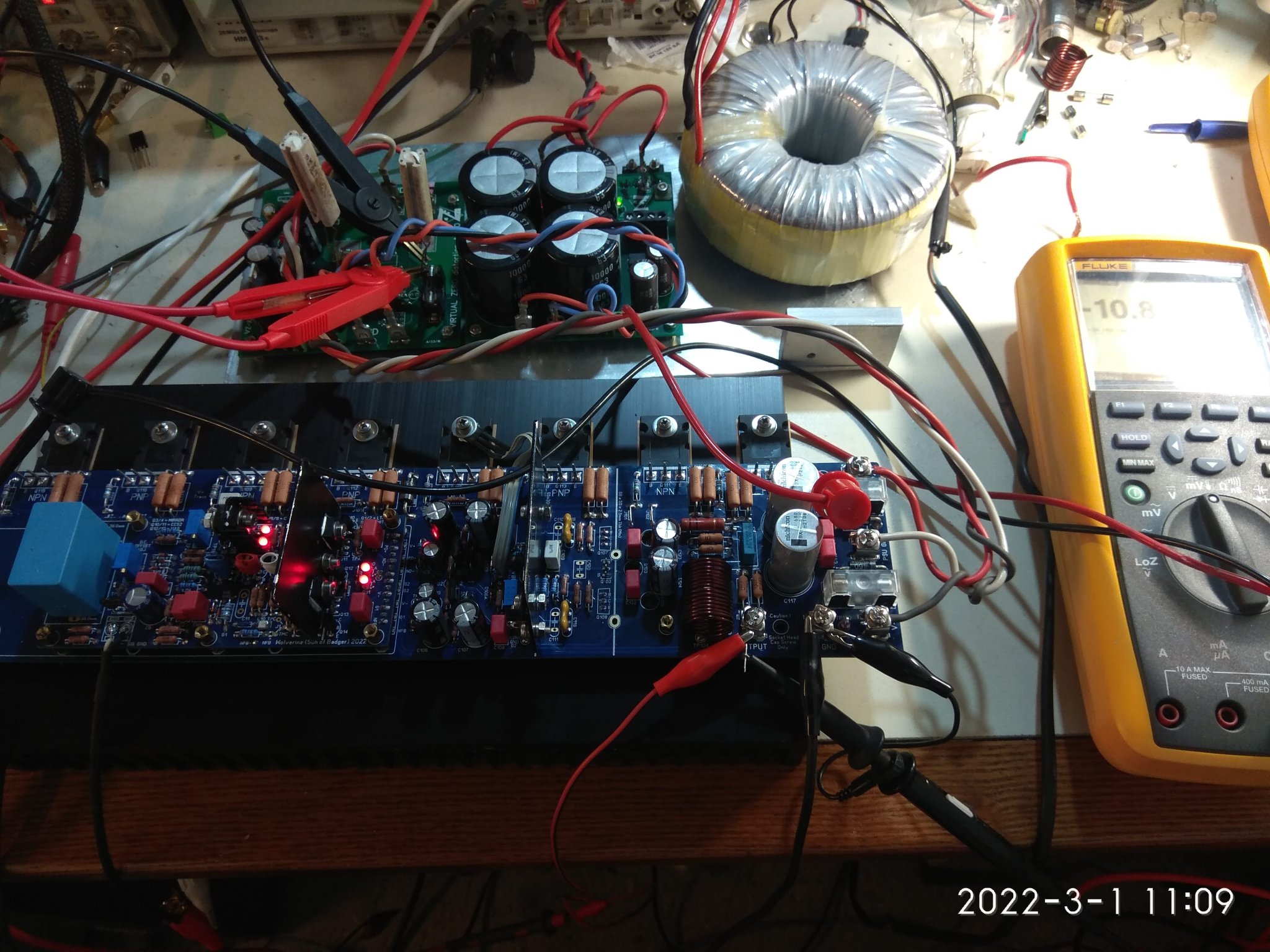

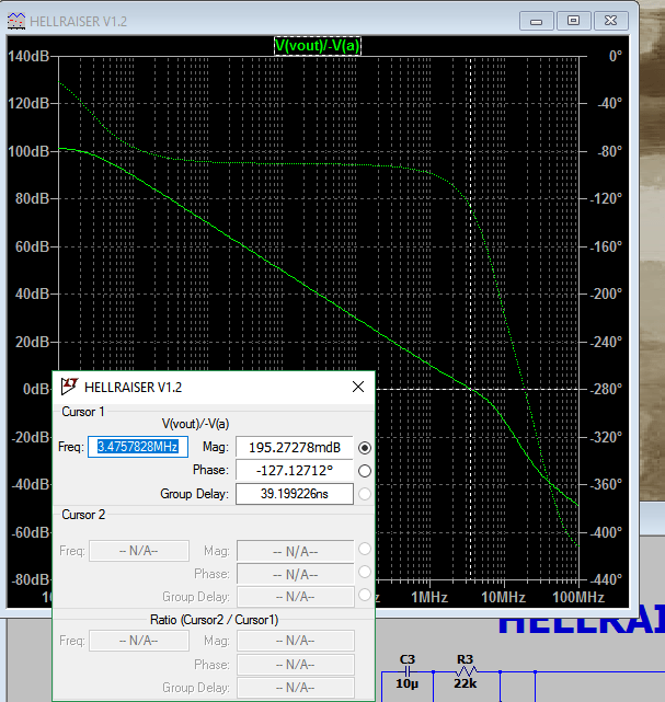

What is the gain of the open loop of the Q1 input stage at 20Hz, 1 kHz and 20 kHz?I built this design 17 years ago , when I was a "NOOB" !!

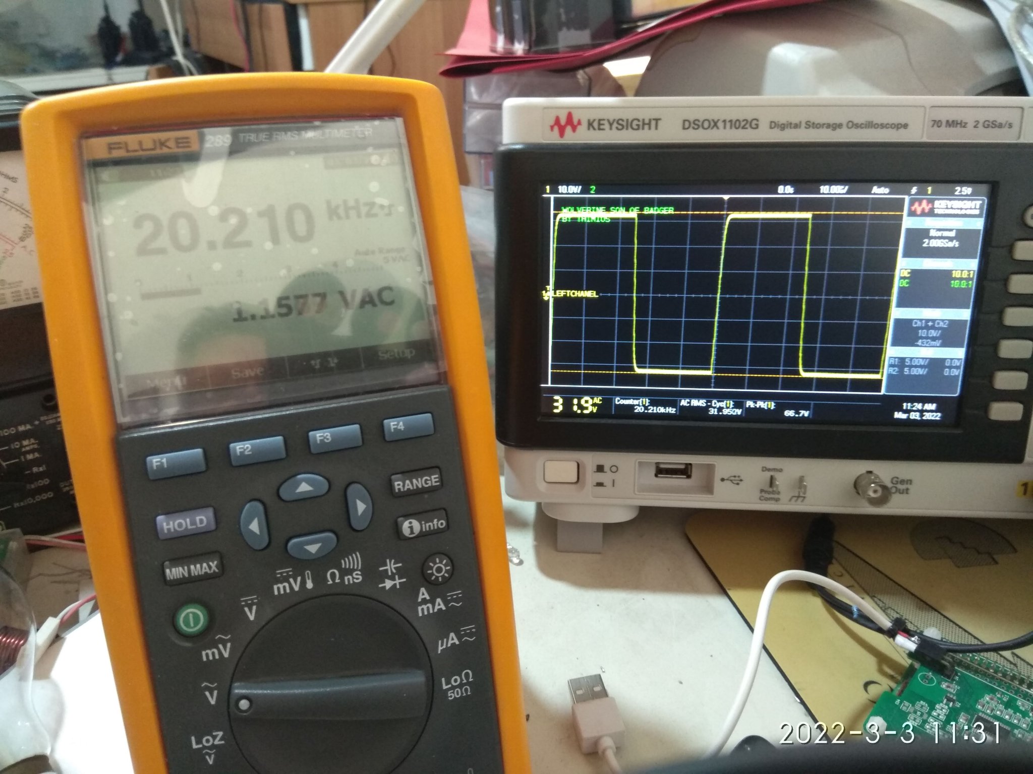

One picture instead of thousand words.
Wolverine,Son of Badger.

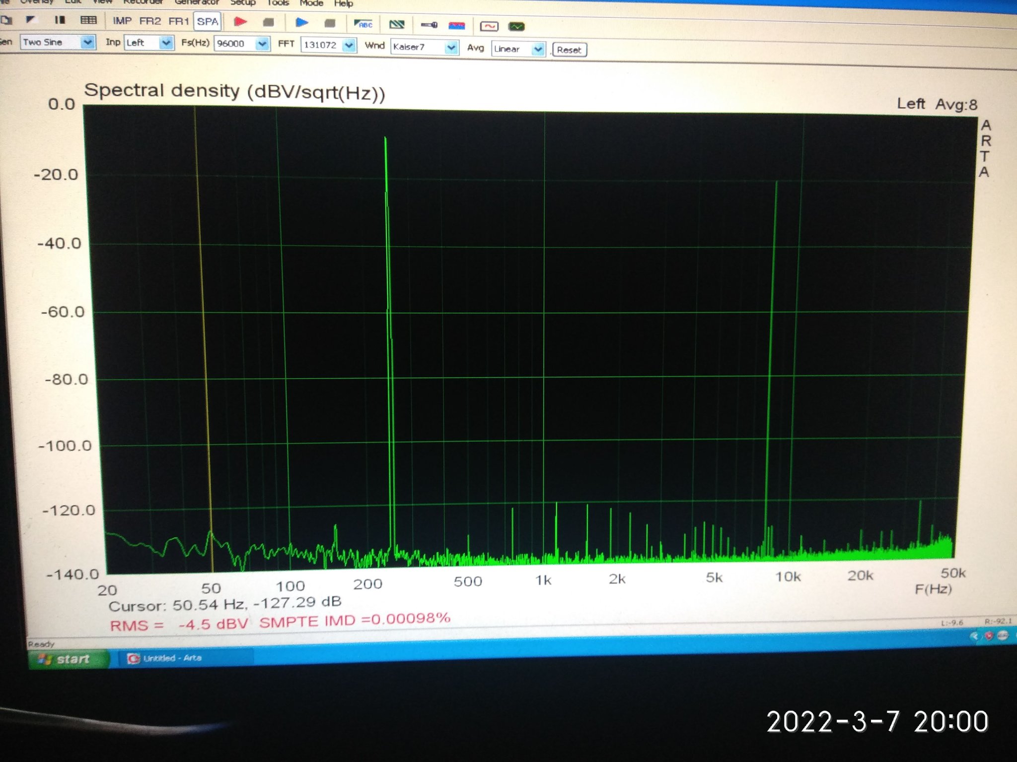

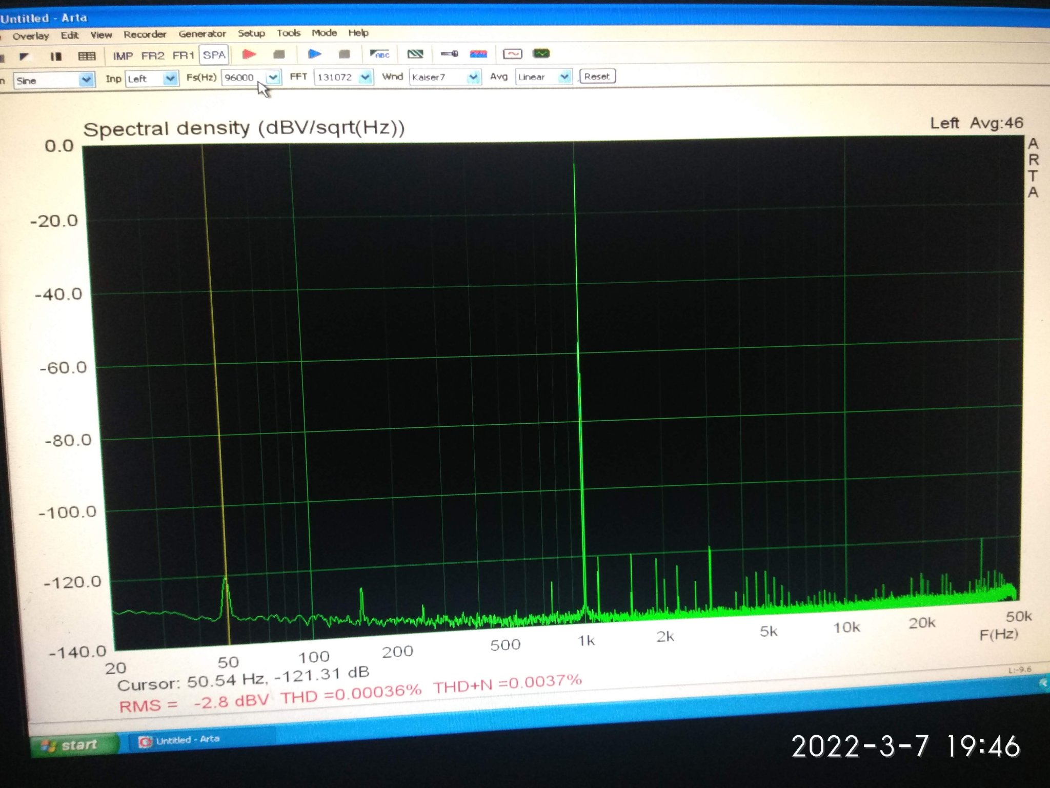

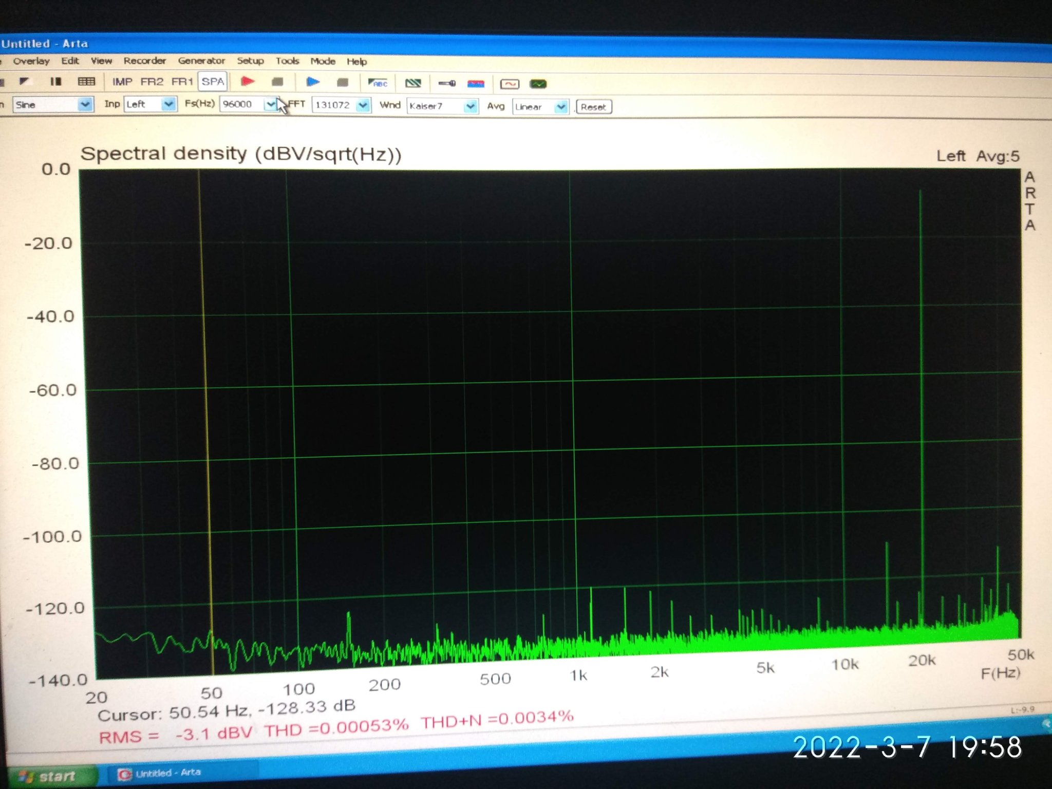

Please take into account that this number of distortion is MINE set-up lower level.
Amplifier's distortion is even lower.
Son of Badger's first schematic is by Ostriper,polishing and farther updated by a tim here in diyaudio.

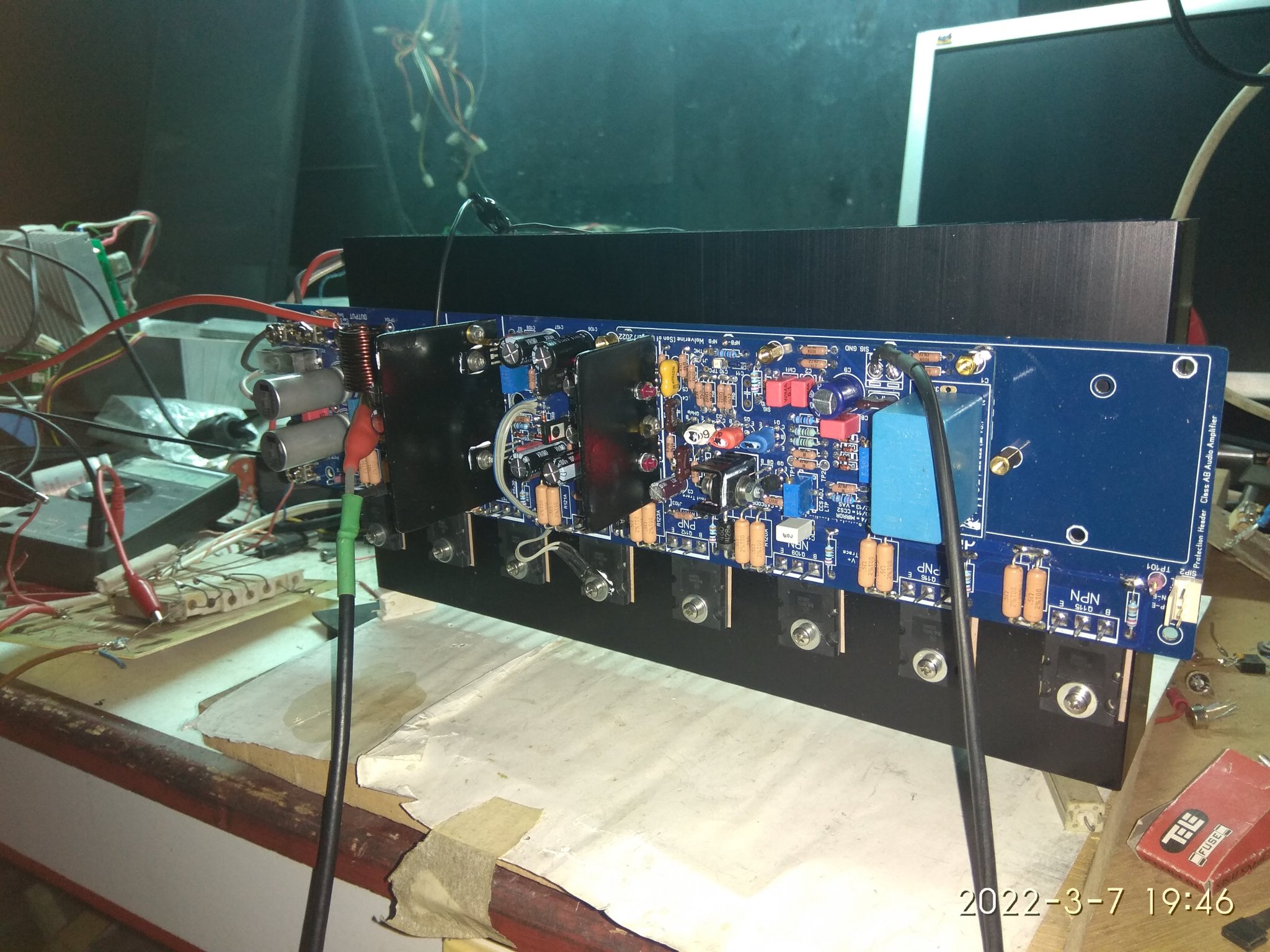

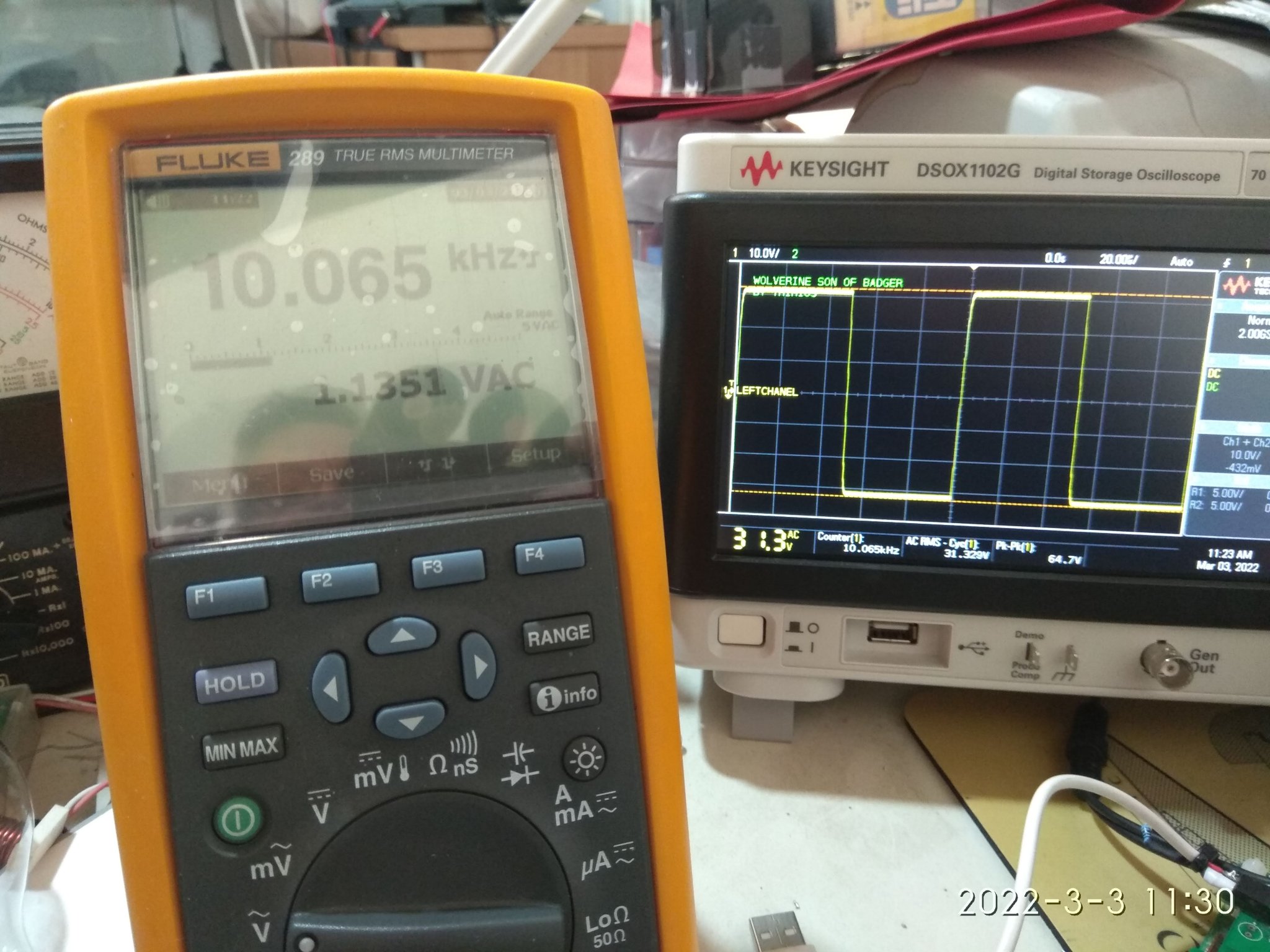

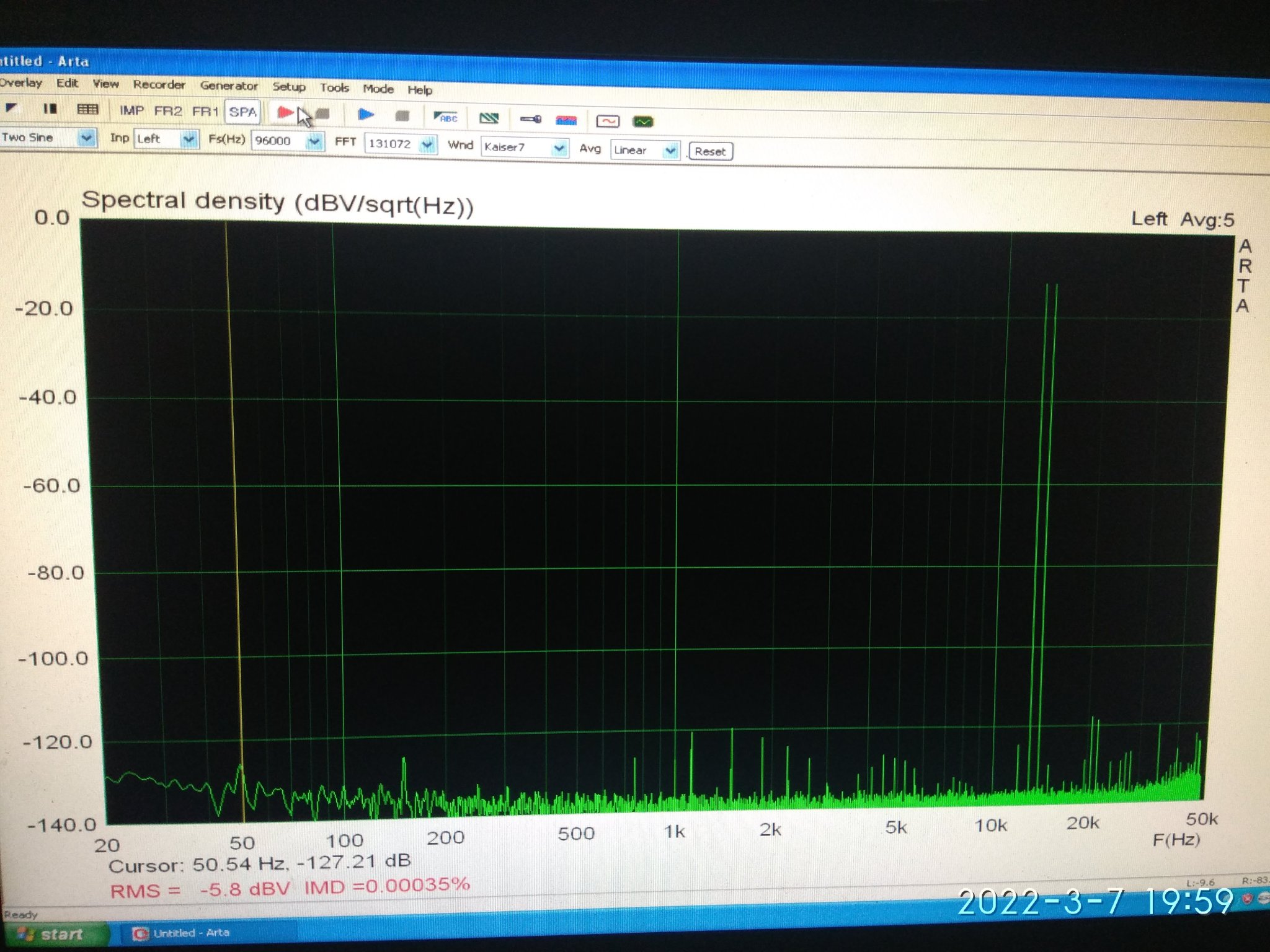

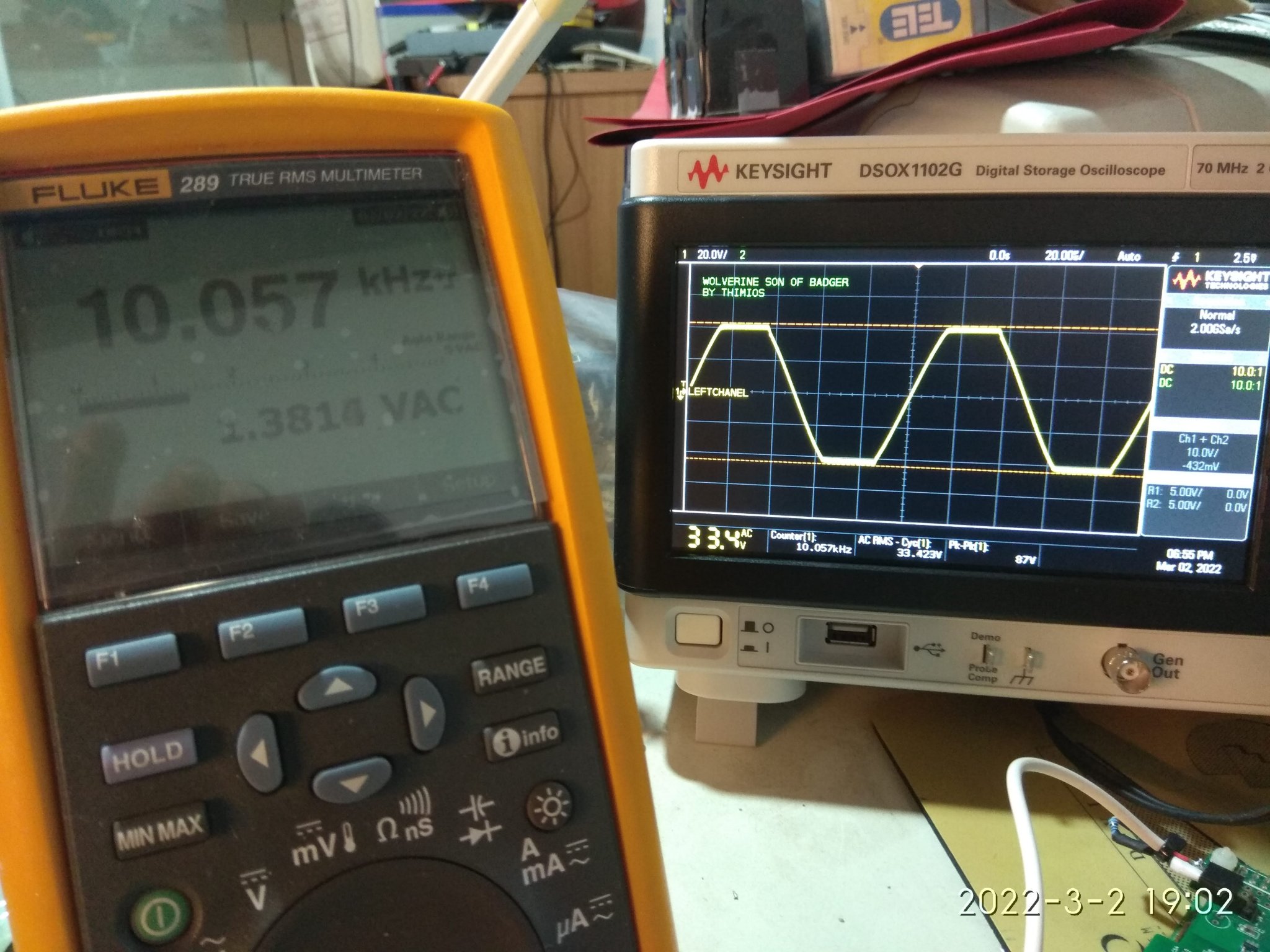

Yes , my Greek friend. Where the BS hits the road....
I see the IPS module needs a big heatsink - my new ones run so much cooler - NO heatsink.
Ohhh , that's the big output stage w/MJLxxxx's (EF3 -4) .... PPM @ 250W !

IMD is also quite low on this class of amplifiers.At one point at one frequency such distortion is not a problem.

I've chosen to concentrate on the symmetric designs (Hellraiser-CFA and Spookyamp-VFA).
Personally , I am going to build Hellraiser. I want to see what brute bandwidth (below) will get me.

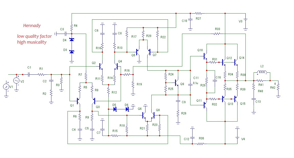

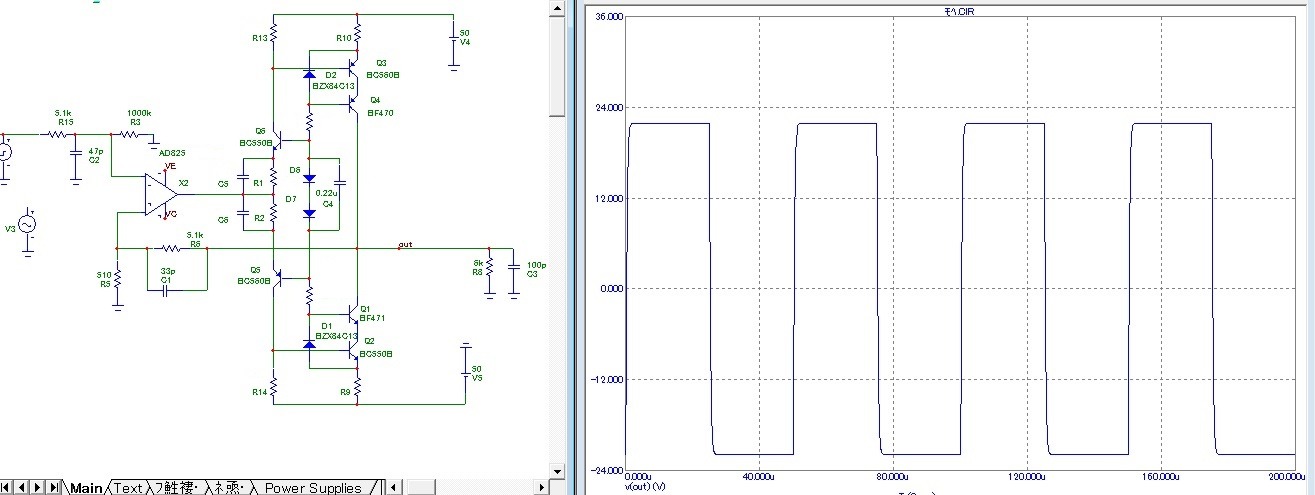

From memory I sketched out the topology of a music amplifier for the home. A low quality-factor is necessary for an amplifier to be musical. Sounds similar to a tube amp.musicality is
another.
*two-stage, 4 “broken cascodes” in symmetrical topology
*the initial current of 0.5A was enough for comfortable listening to music.
P.S. very low quality-factor of the JLH amplifier, maybe that’s why many radio amateurs love him.
Ha ha ha !! Sex with an op-amp. Performance of pictured amp would be fully dependent on op-amp spec. (below) ....sex with function generator+oscilloscope and rewinding of burnt out tweeters.
Builder in 2014 tried TL0xx , sucked. OPAxxxx - quite the nice 100K square wave , perfect clip , he said it sounded perfect.
Deep in the 1000 posts of the "Slewmaster thread" (2014).
Edit - "burnt out tweeters" typically happen with saturated "sticky" VAS - bad clipping behavior.
OS
It's the photo from internet. Name "Bolshevik" (I guess it was made by Stalin fans or something), "hogweed" for him will better. Ultra-linear crap has been created for sex with function generator+oscilloscope and rewinding of burnt out tweeters.
This is a later version, and, in my opinion, more complex. The order of the filters was changed just for stability. In general, the basis was taken on a composite that has proven itself quite well in audio circles. Moreover, outsourcing has not been canceled.
P.S. I finished with composites in 2019 due to relocation and the solution to simpler modeling, what they are finishing next is their creativity...

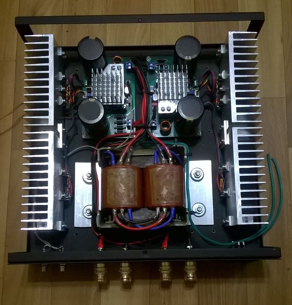

my version looked like this
Thank you, I tried to immediately integrate the developments into the building for test listening, where they were usually bought out.Very nicely build sir 🙂
