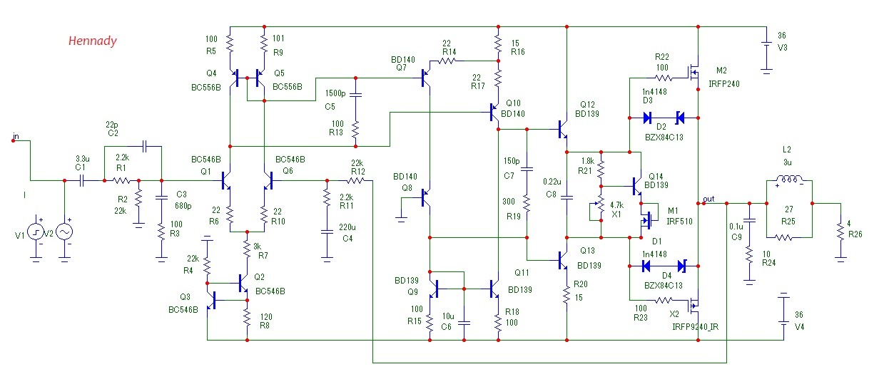

I looked at the diagram you posted in the first post. Here is my vision of a similar topology (see attachment),
peculiarities:
*linear openloop gain 95dB+/-1.5dB
*output power 100 watts into 4 ohm load
*distortion less than 0.002% in the frequency range 1kHz - 20kHz
*not frequency compensation circuits in the feedback circuit, i.e. only progressive compensation.
you can type the diagram yourself in your application and see the characteristics.

Interesting sir you explained it in details. Many thanks sir for the knowledge you share with us.
Also thanks for posting the schematic.

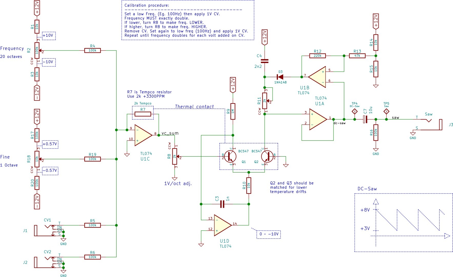

It relates more to sources. I create some of my sources "RAW" (below). Quite the opposite as amps - to make an oscillator.
I'm going to buffer the saw and create a voltage controlled pulse at 10V p-p. Really get a perfect 1V/oct with that tempco resistor. More fun.
It's cool measuring the harmonic content of some of these complex waveforms.
OS

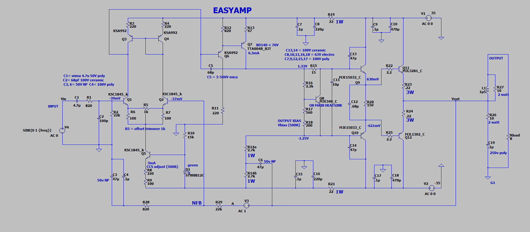

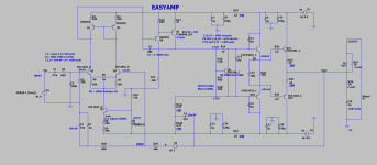

Is there an example of (lets say classic) Class AB amplifier schematic not requiring anything to be added/modified or removed. But adequately be called close to hifi ?
Thanks and regards.
Yeah , DIY store "Badger" or any similar "LIN" (1972).
Close to hi-fi ? Actually better than most OEM's if built carefully ....
I'm just using it for a sub , but I have heard so many of these - transparent and simple...
Can't get any more "classic" than that. DIYA store "Badger" is a part or two away from below amp.
Nearly impossible to screw up design that has lower THD (below 3) than a typical OEM 150$ receiver.
It won't be any better than the filter (below 4) with TL084 op-amp that feeds it. I feed a pair of these with my Xonar DX sound card -
EVERY brush/ cymbal - "holographic image". The amp just "disappears" (as it should).
PS - I built this design 17 years ago , when I was a "NOOB" !!

I can't see extreme low distortion,0.002% is an easy target.
I have so many amplifiers far lower than this.
On the other hand, I don't believe that the only goal is very low distortion. After all, high fidelity is one thing and musicality is
another. I think that in pursuit of absolute high fidelity we sacrifice musicality.
I would glad to test your suggestion in the future if a pcb is available.

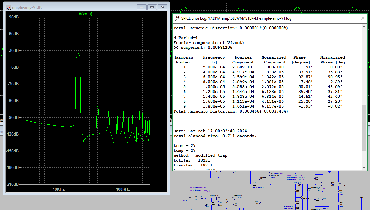

But I don’t see the dependence of distortion on frequency))) for such a simple design
May be.
At one point at one frequency such distortion is not a problem.
