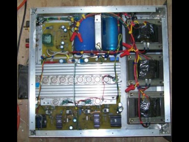

Solid state is far simpler - just control VAS saturation and design the whole circuit to determine which stage overloads first. I don't understand why some designs use boosted rails for the IPS ..the last thing you want is for the actual output devices to saturate first. All my amps - the VAS will clip >3V short of the rails , the OPS never saturates. I lose a whole 5V on my Hawksfords !!
You make a very good point, in the case of a BJT ops, but for a lateral fet ops, it might be sonically benificial to have the ops saturate before the front end does.
Try it out and hear it for yourself, get back to me 🙂
If I am really bored, not much chance of that these days, I could boost the AFE on my DH-200C that @anatech has in his possesion, he can do it too if he so desires. It would be good to compare the clipping behavour of the design with and with-out boosted rails. Might be an idea in a new PS design.
I assume the older japanese designs used regulated V front ends as a solution to PSRR, vs using more parts for current sources etc. They needed regulated supplies for the discrete low level ckts anyways, so start high and work your way to lower voltages.
I recreated the amp pcb (AWH-048) for the old Pioneer SX-1250, (electrically equiv) it uses regulated +/-65V, a resistor for the tail I, instead of a CCS. They used two 470uF/80V ecaps which is more expensive than the parts for the CCS. The model down, SX-1050 uses a CCS for the IPS tail cuurent, only used 220uF/63V ecaps, so different designers use different circuits to achieve the same specs, as long as they are in budget etc....

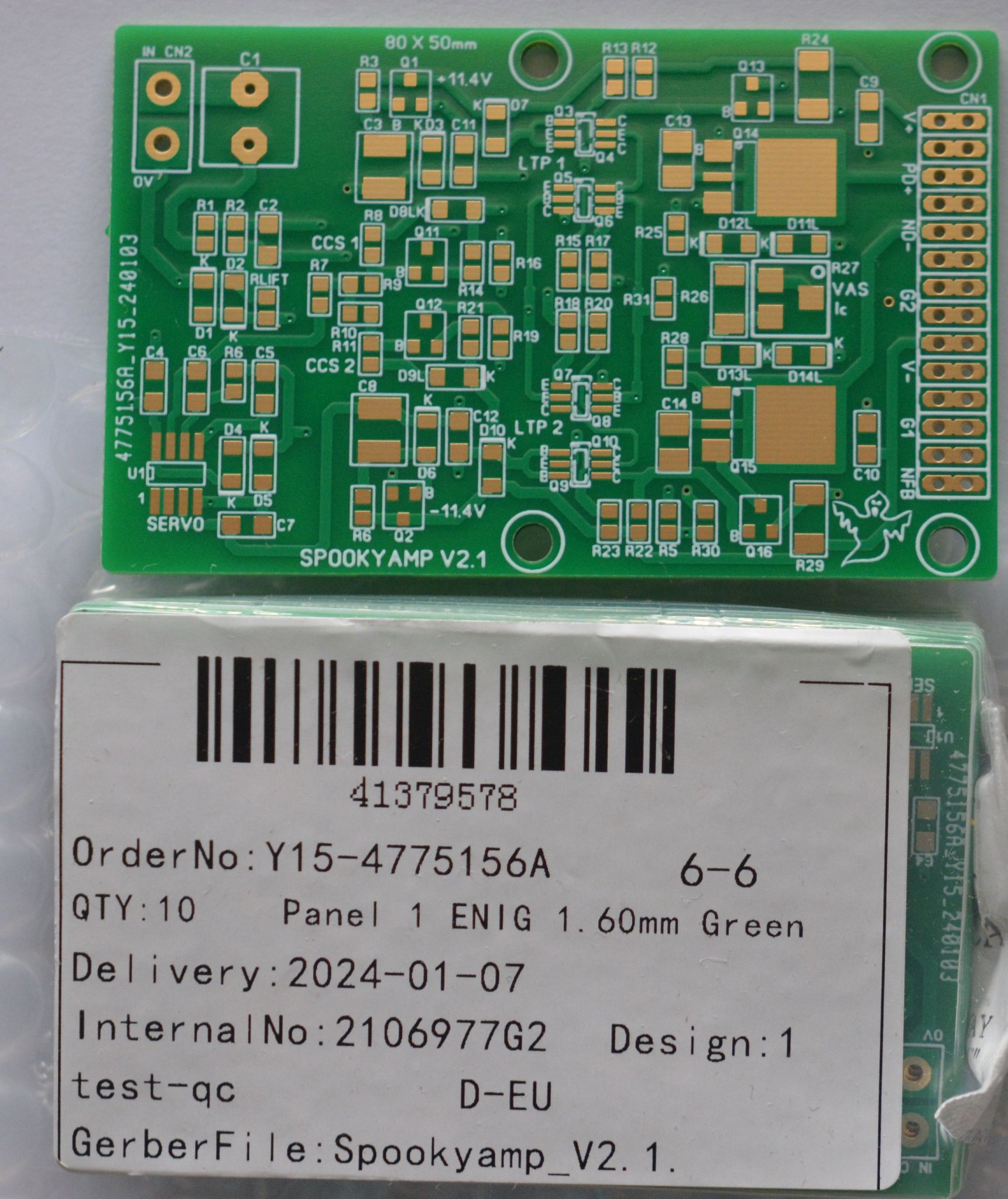

SMD can reduce the price considerably. Infidel input stage costs @15$ , Output stage is 20-30$ . 30$ could be bigger MJL BJT's for 120W+ power.
That is true, but I have seen too many designs on this board that do not have good tracking between the complementary halves. They "work" only if the components are perfectly matched.
Those ON dual 5551/5401 SMD and Toshiba LTP SMD duals are spot on , (below - infidel) IPS was <1mV offset before trimming ! My "Leach" (spook) uses these same
SMD duals plus it self - adjusts the CCS's. "Spook" just has one adjustment for VAS LED current. 2X LED thermally offsets the Hawksford and the LED CCS's
thermally cancel. Just uses 17mA per rail (IPS) , runs so cool - just a HV op-amp made with SMD.

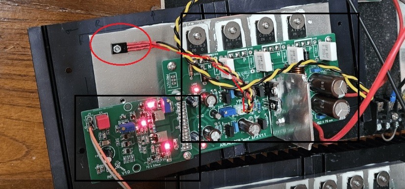

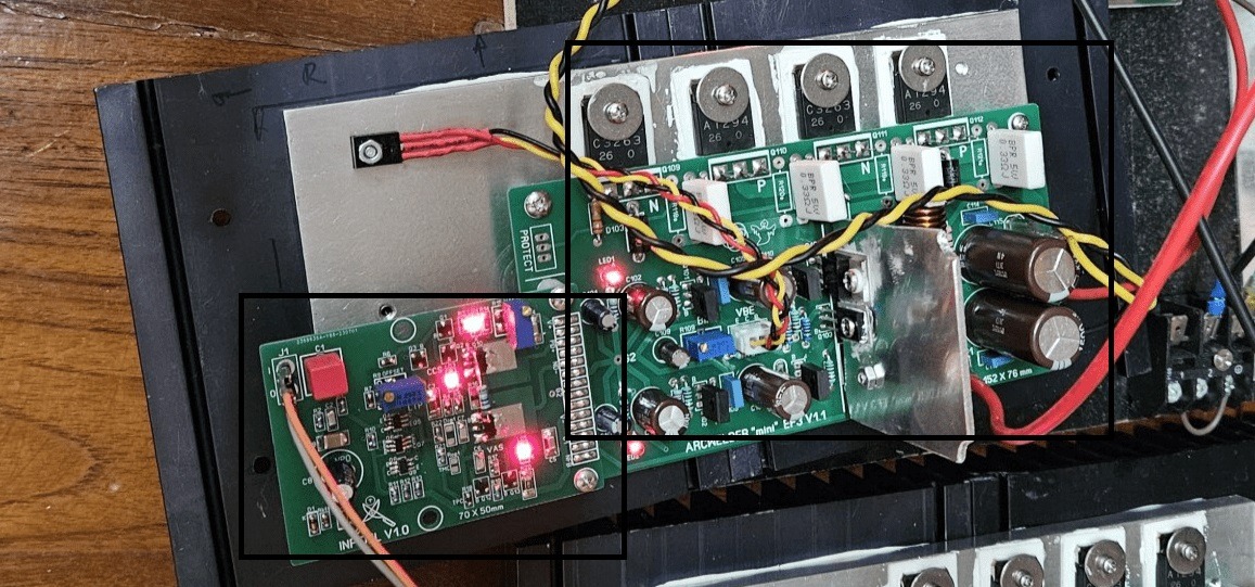

As long as the circuit has this sensor (attachment) operating in analog mode in the voltage amplification circuit, there will always be thermal modulation and the amplifier will not be high-end level
What do you mean by that ? This is just the "mini wolverine OPS"- #2 on the planet ... read the wolverine thread. #1 is the halcro.
That is the OPS Vbe - BTW - not connected to the VAS ! , yes ... there is always short term Tc modulation on a typical Vbe (in a typical BJT junction).
. Even a NJL thermaltrak has some (but less). I'm scared NJL could become obsolete . Maybe you could give us a better example of a "high end" Vbe ?
You have simple, classic diagrams, but please look at the attachment.

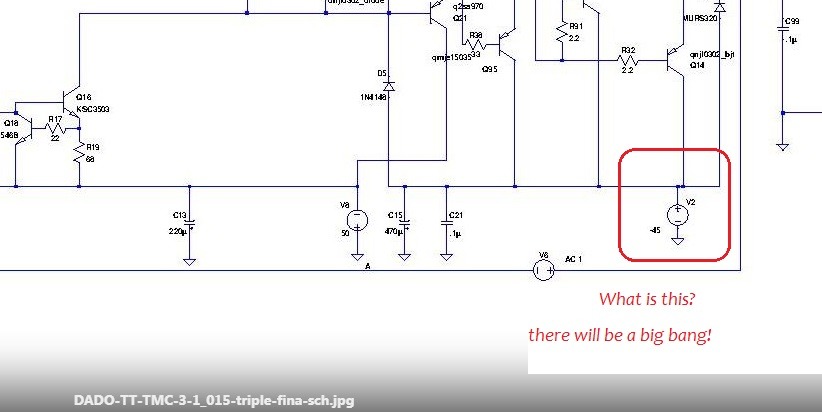

On LT , if you hook to a voltage source (+) and specify a (-) value , it will be negative. No error there.
He did not do that on voltage source (V8) and hooked (+ @ 50V) to earth. That one would be -50V.
You can do it either way. hooking to the (+) allows parasitic properties to be added to the source.
Edit - I suppose you could consider the Vbe as a VAS component , since it is fed from the VAS ?
