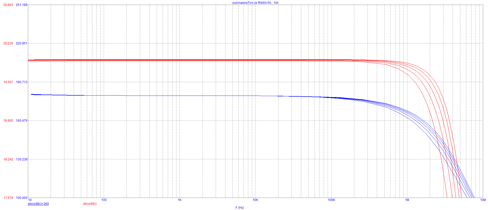

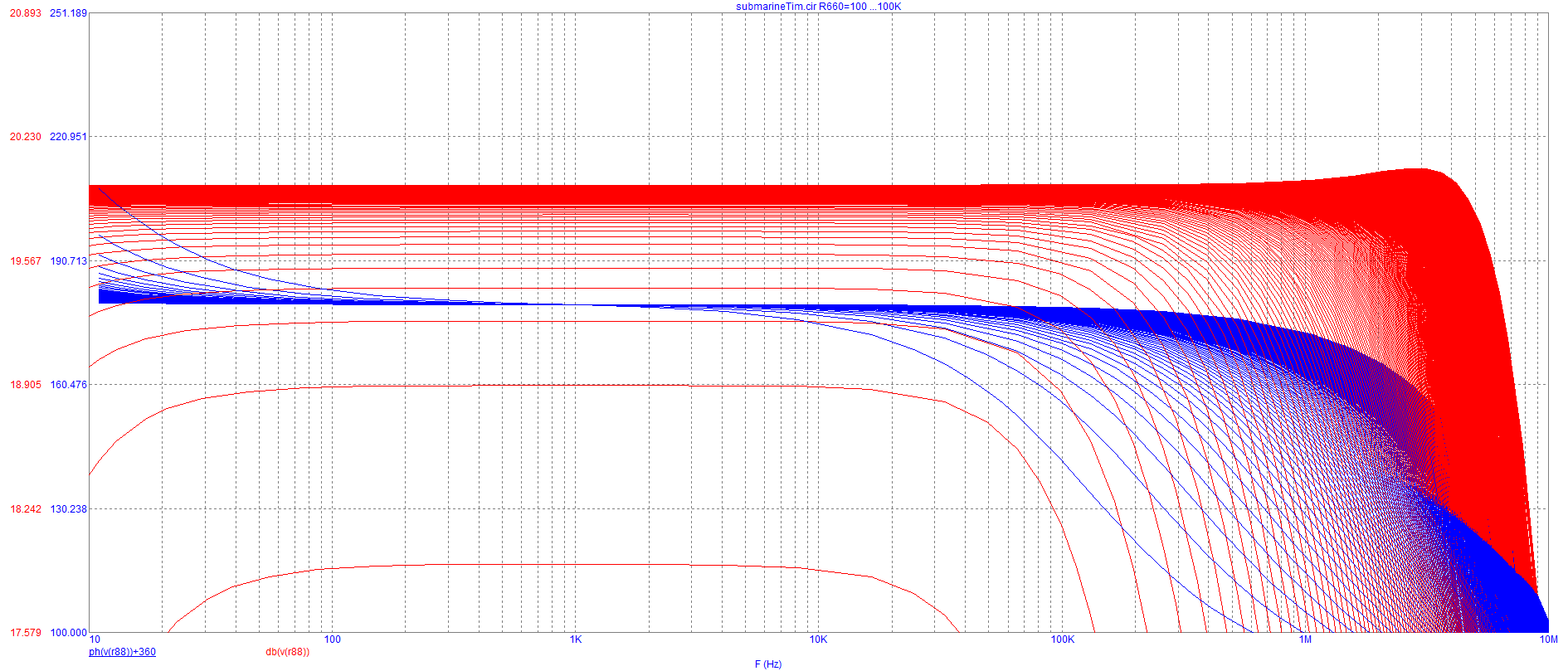

I did AC analysis with the magic unicorn by the way and used the slider to see the impact of it.
The question of the meaning of the 5k1 should now be clear even to the most nagging questioner; this placeholder and reminder stands (among other things) for the final clarification of the question of stability. Without considering the Bode plot, one is unfortunately blind in this eye - or without the time domain.
5k1 -> transformed or morphed into [100Ohm+j(1/ Omega * 10nF)] - clear from the beginning.
for better illustration purpose only
with
without

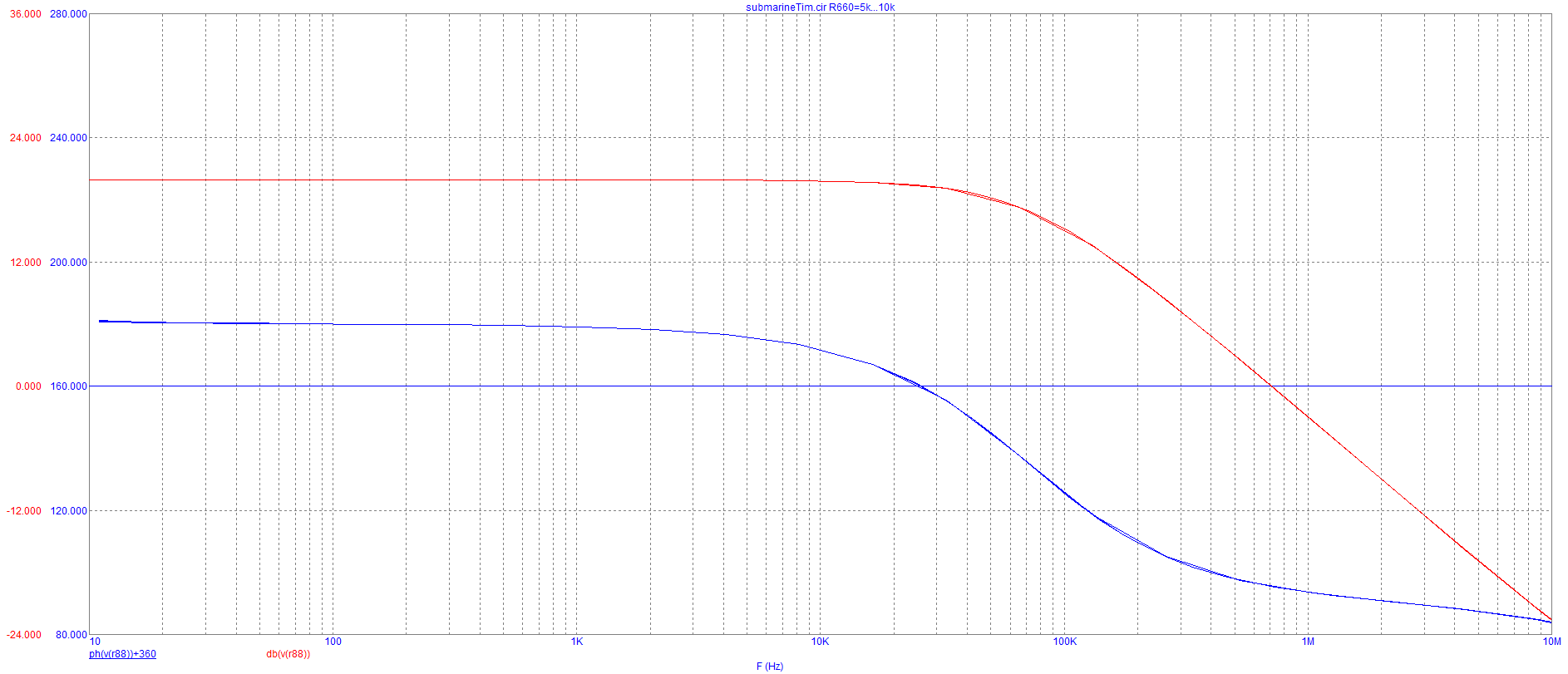

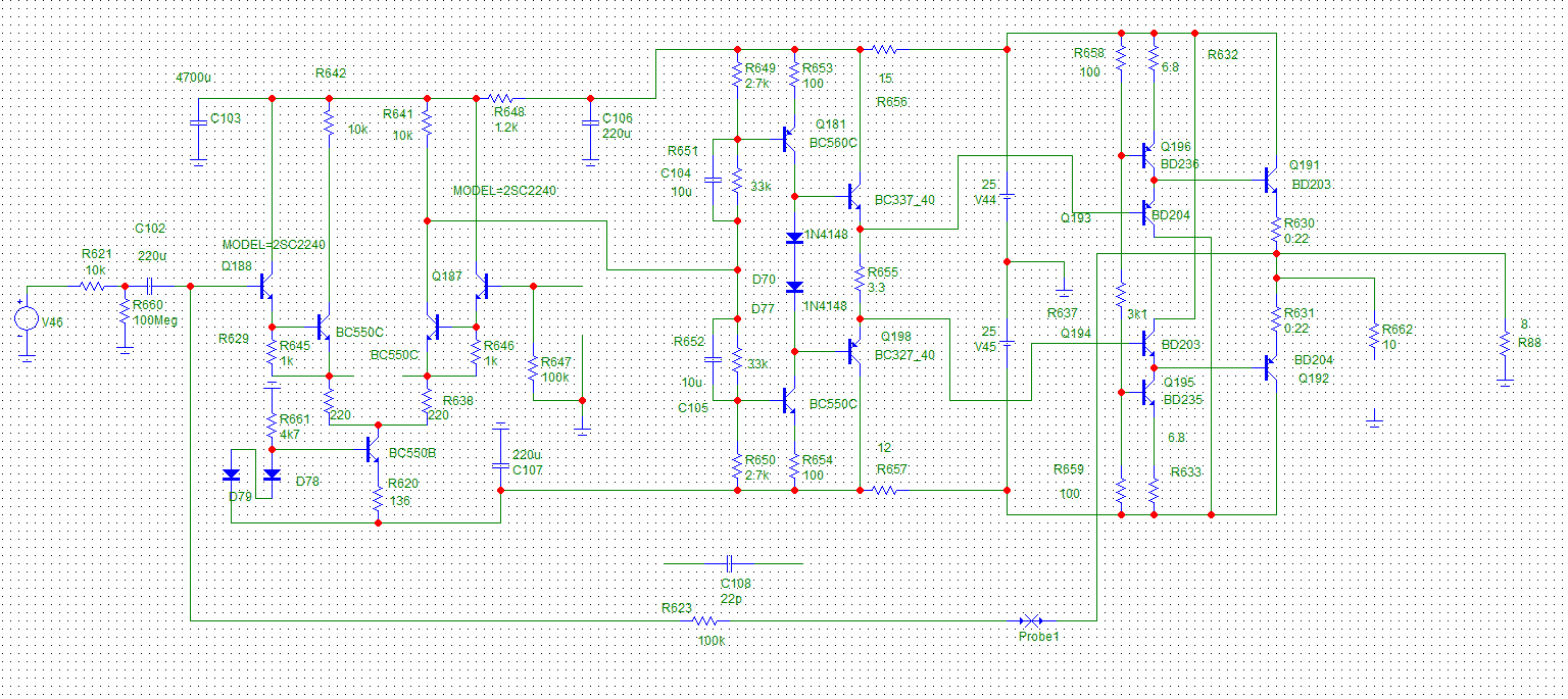

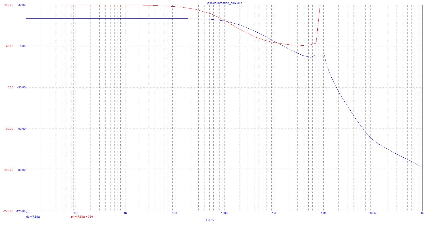

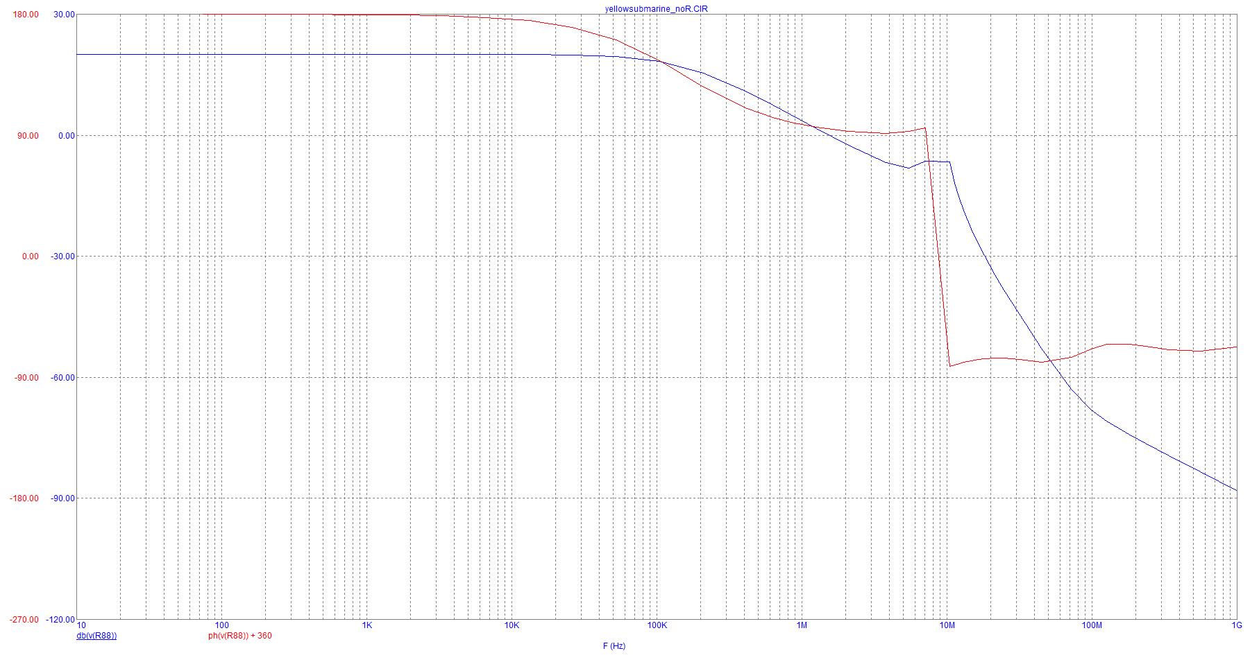

Appendix C
Schematic with original configuration of ips.

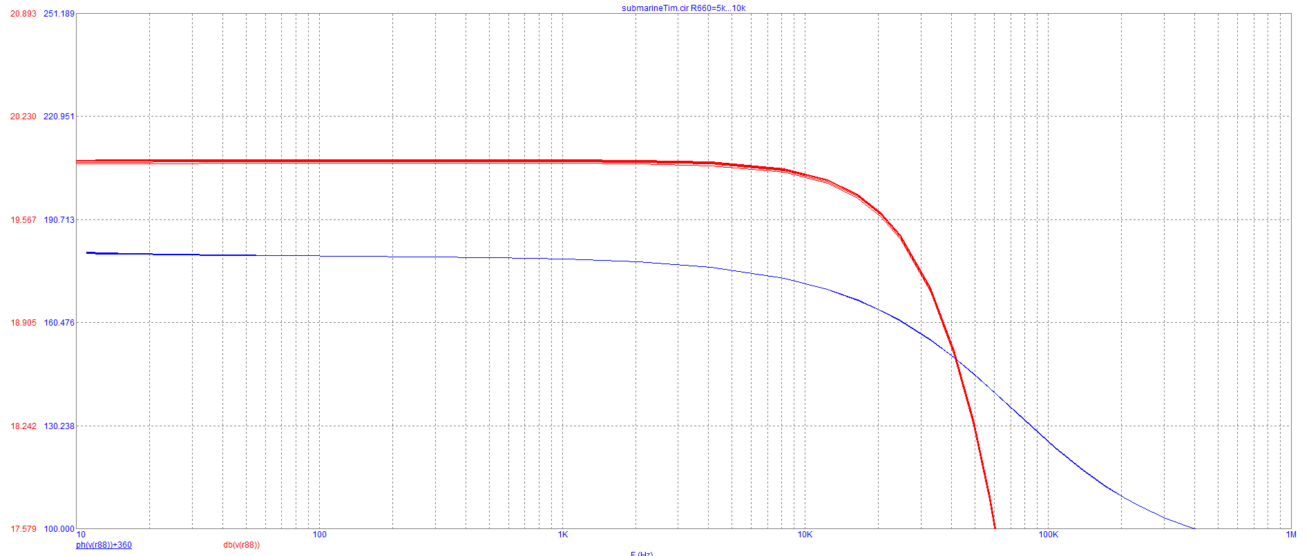

The phase flips down exactly at 5.4k
First picture >5.4k, second picture <5.4k
And here for the extremely low value of 50 ohms to clearly show the bandwith limitations and the impact on gain.
None of this is a problem for the last unicorn, let's take a closer look at the first original working diagram ..!
At first glance, it is noticeable that the simulation results of MC12 differ significantly from those of my old Spice - could this be due to the models used?
Anyway, above we see the 5k1 representative with a real infinite number of ohms.
In fact, you are absolutely right, as we can see it - from 100kOhm to 100Ohm.
And now let's look at the case where the said fiend moves within the limits of 10kOhm to 5kOhm:
Oh dear,
from this perspective, the interjection seems to be nothing more than nitpicking (to put it kindly!).

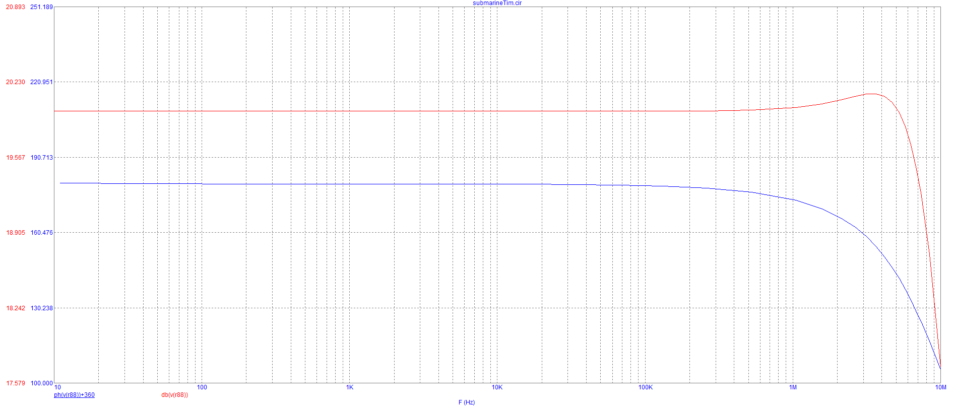

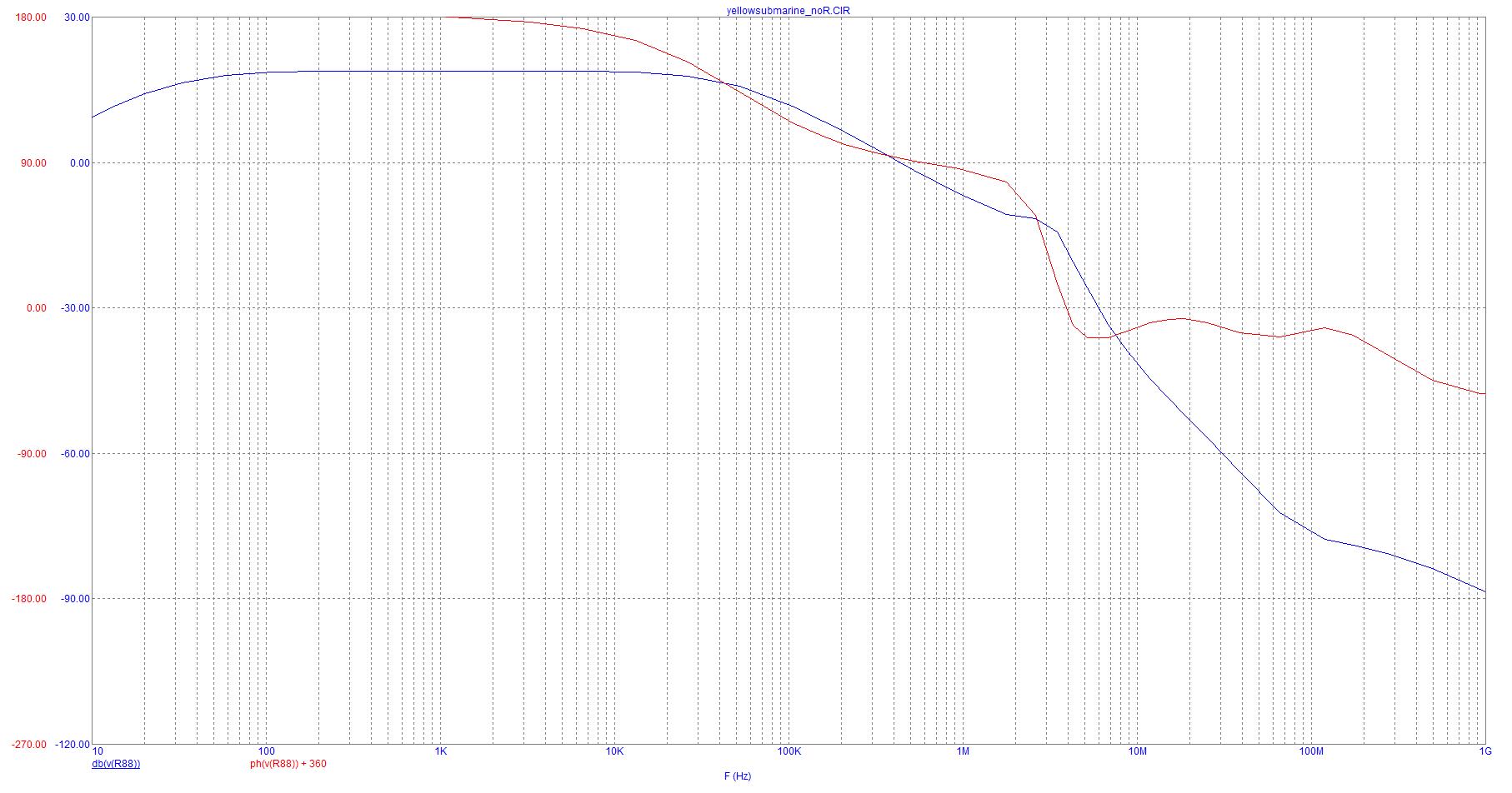

Now let's connect a small ceramic 22pF capacitor in parallel to the 100kOhm feedback resistor and thus limit the band! I'm already very excited and looking forward to MC12's result. The tension is deadly 😱.
Checkmate!
Oh dear,
Checkmate!
Overview with Ck=22pF.

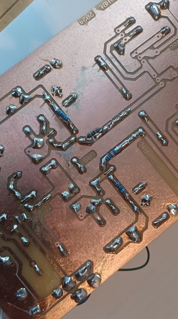

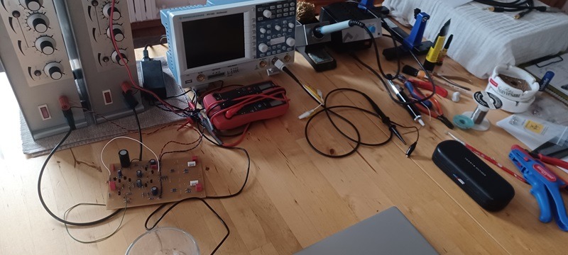

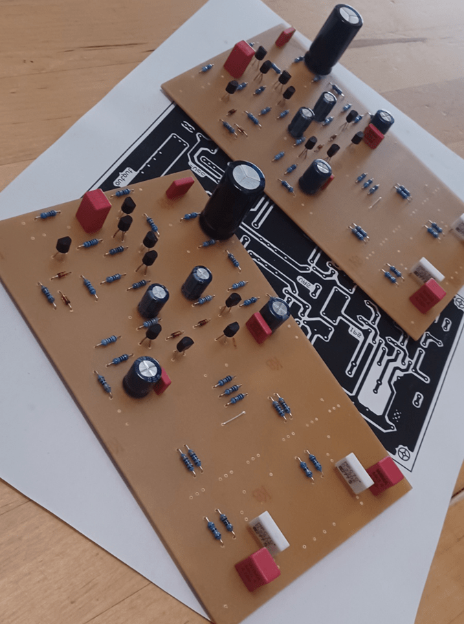

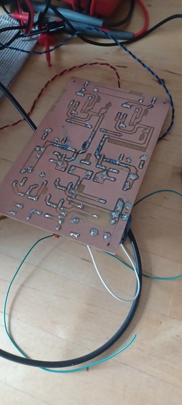

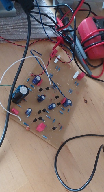

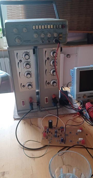

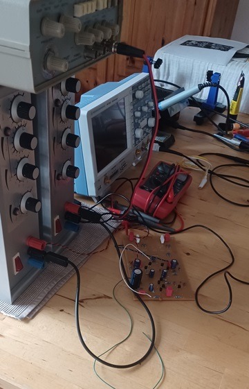

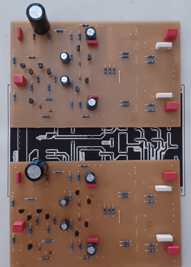

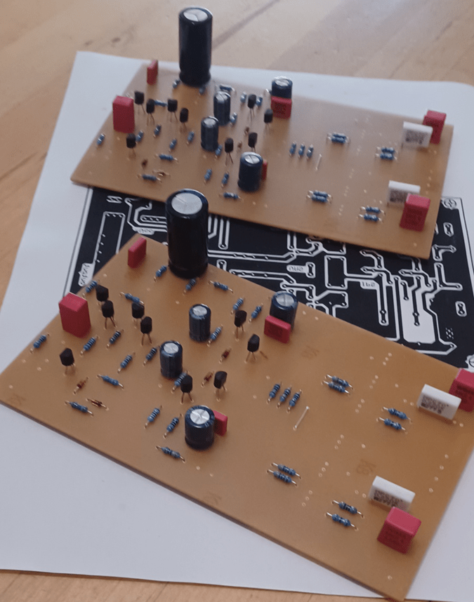

A little foretaste - quick pictures of the test panel /pcb
The drill was blunt, as you can easily see, but the snot is installed - components . Soldering will be done tomorrow and then the test will start slowly.
Experimental archiological greetings from the excavation site,
HBt.
(let's see which BJT burns out first?, I have a suspicion!)
HBt.

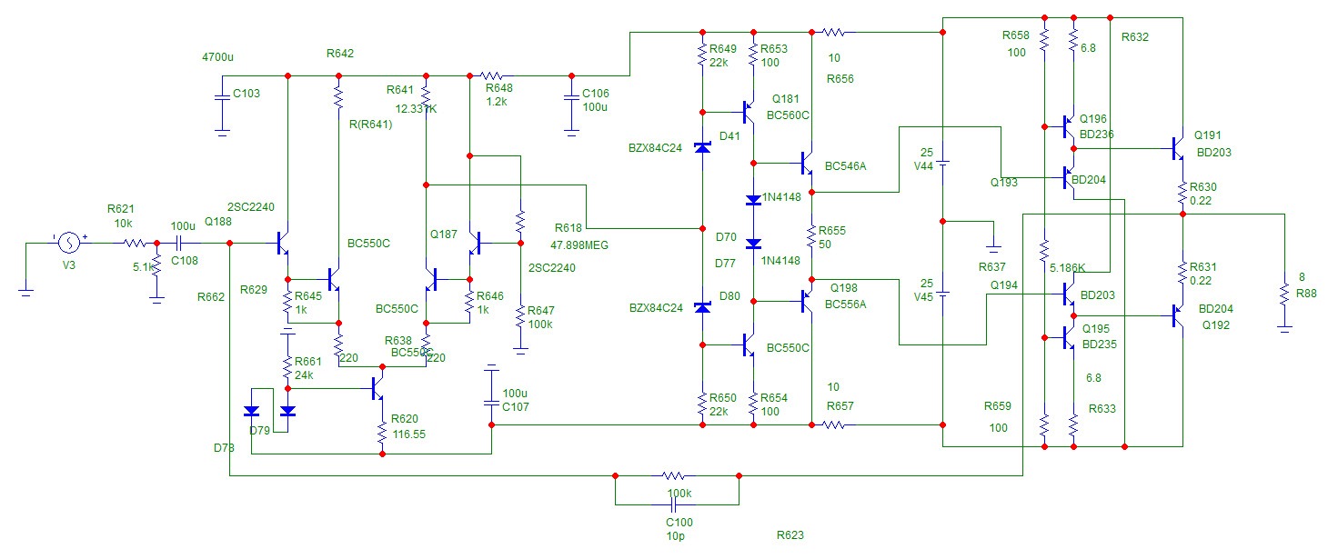

hbtaudio - I had thought this was just a simulator exercise, but now I am impressed that you are building the amplifier.
In addition to the ripple sensitivity, I see two more problems:
* The bias current depends on the Is of six transistors and two diodes. Some means of adjustment will be needed.
* Removal of the shunt capacitors means that the amplifier is entirely dependent on transistor junction capacitances to bring down the loop gain. Capacitors may still be needed.
Be careful and good luck!
Ed
Ed
Zener diodes for static shifting of the base potential of the (inner) IPS are not necessary. The real experiment will bring the truth to light, I am quite sure of that.
regards,
HBt.

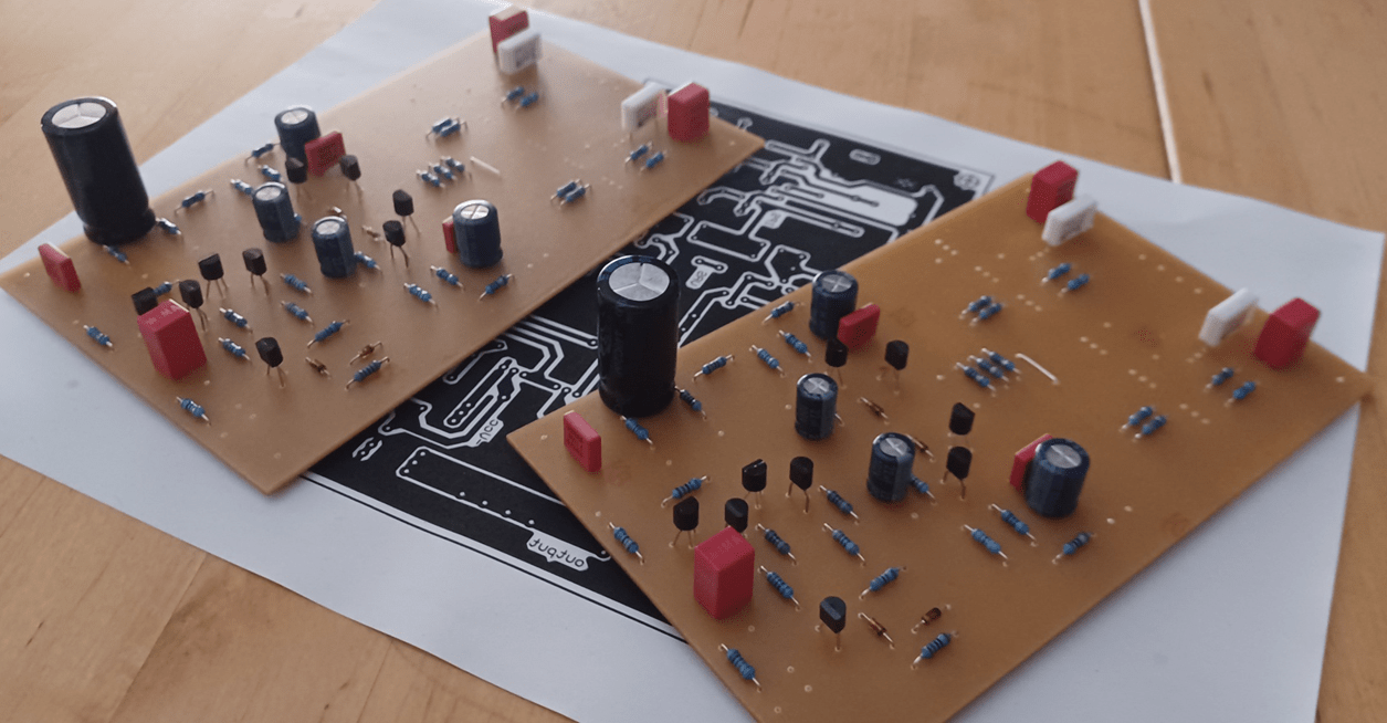

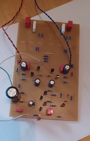

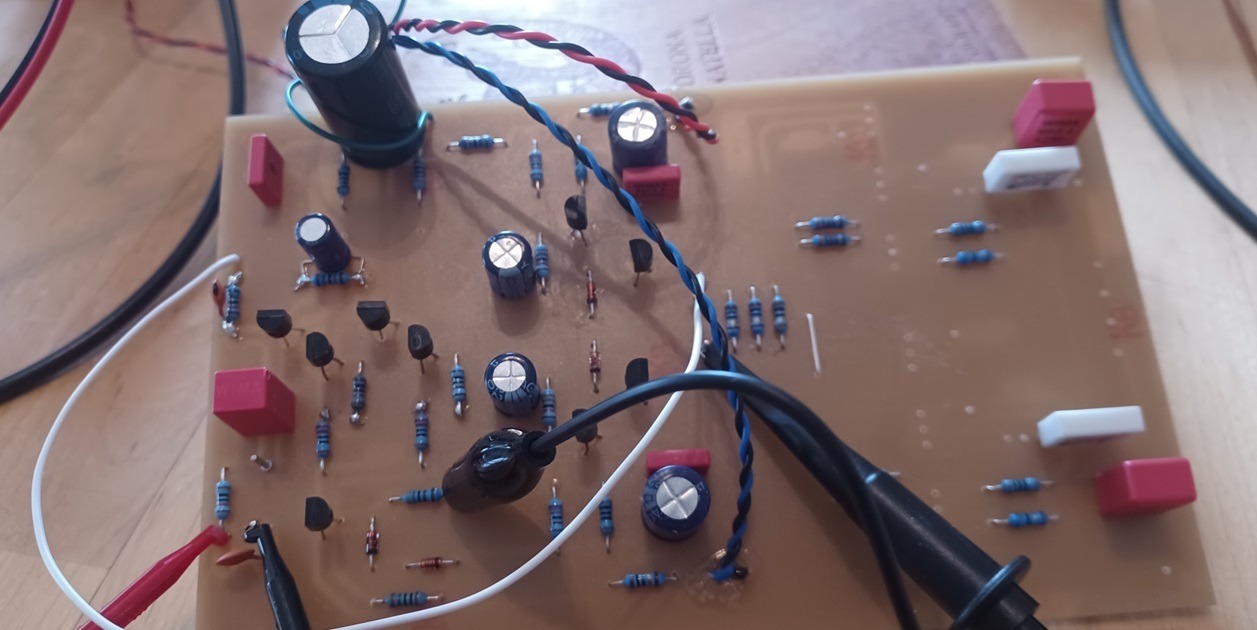

Unfortunately, I had what felt like 1001 short circuits on the etched circuit board, which certainly cost me 4 hours of my nerves.
But to cut a long story short:
it works!
At the beginning the BC327 /337-40 of course blew, just as we all expected ... but BC546 /556B don't behave any better, you can also realize a thermal control loop, they also blow away.
Additional 10 ohm emitter resistors (E_337 -> 10, 3.3, 10 -> E_327) and a 100 ohm collector resistor each - provide a remedy. Modified in this way, the BC3x7-40 now work perfectly. The quiescent current is 11.1mAdc and remains absolutely stable.
The circuit, only the IP-VA stage (with negative feedback - loop), without the actual output stage, overdrives clean /clipping symmetrically at +/- 22.5Vp.
I removed all compensations during the course of the day, the complete stage does not oscillate. Nevertheless, it is not a good idea without compensation, as a 20kHz square wave clearly shows - and here the next step is already waiting.
Z-diodes in the dessert or pudding are unnecessary, I have now tried it in practice / or proven it, as you like.
I'll continue tomorrow.
HBt.

Photo album
A few chaotic pictures from the completely improvised laboratory, at 70% humidity and 28°C to 35°C air temperature in the heart of northern Germany.

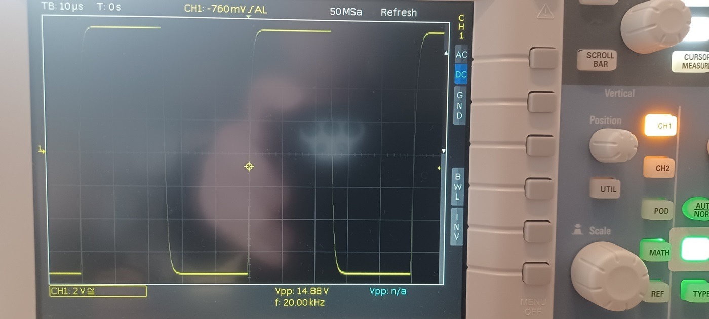

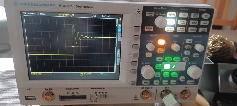

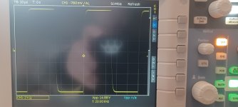

For all those who believe that the simulator will bring them salvation without any practical or theoretical knowledge, let me make it very clear once again:
this is not the case!
1. open inputs are predestined for the most impossible oscillations, especially in inverting circuits (this is one of the reasons why the 5k1 substitute was on my notepad)
2. the layout, the cable routing and the final wiring are often responsible for the most peculiar behaviors
3. and so on.
Conclusion No.1 IPVA stage:
Stable and reliable, no more oscillation tendency, fh = f-3 is currently >200kHz, 20kHz square wave without overshoot, triangle without fault, sine wave? (THD still missing) ..!
Statically (and in steady state) everything is now paletti, dynamically quite promising ... The power amp follows: and, if necessary, an offset correction (or did the tripple B gang think I had forgotten this or that?).
HBt.
