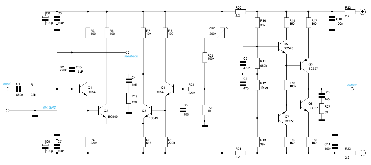

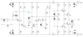

high performance 25W PowerAmp
MC12 confirmed
"submarine Tim" 's noise; <140nV/sqrt(Hz), 20µV(bw=20kHz) --> SNR exemplary 20*log_10(10V/20µV) --> 114dB !
SNR_1V ---> 94dB
SNR_0,1V ---> 74dB
The rescue submersible is not a world champion, but it is perfectly suitable as a working basis and, on top of that, better than the old hi-fi standard.

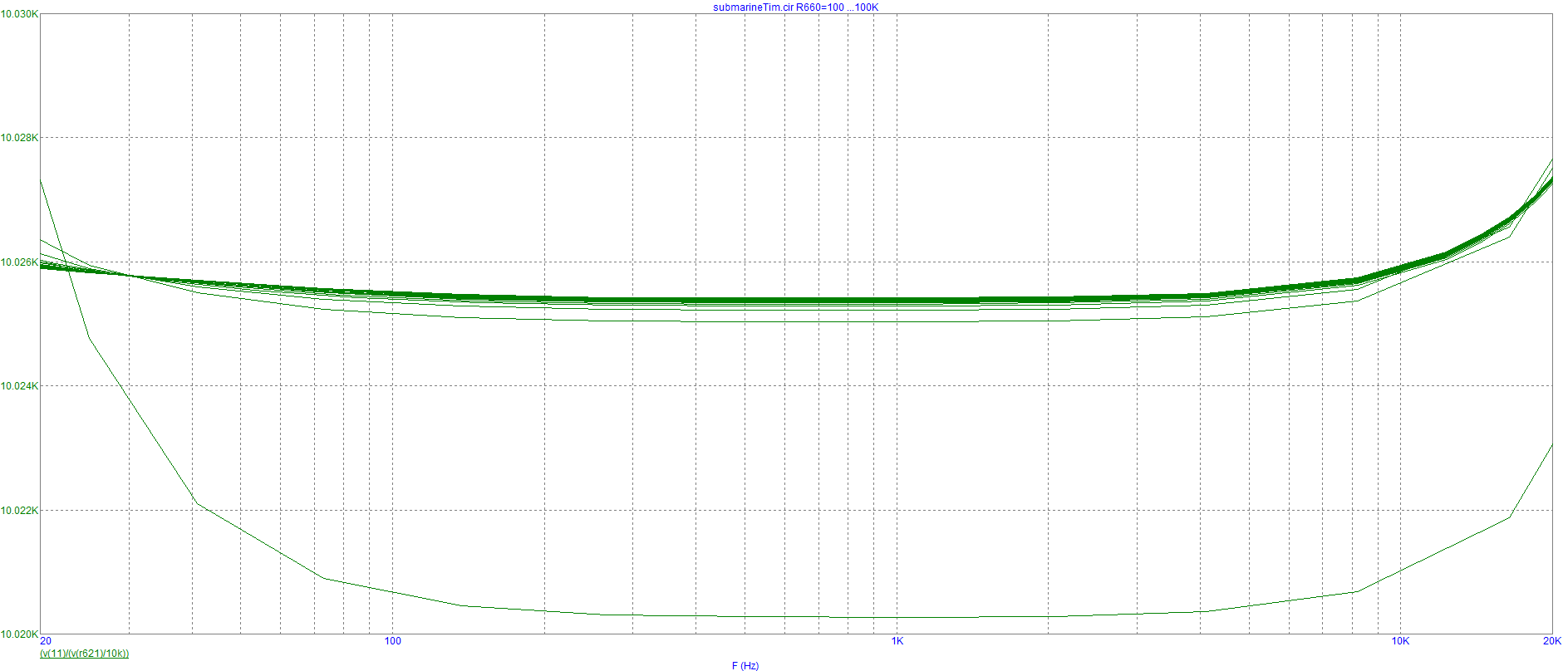

The ac-input resistance is practically constant!
The criticized 5k1 resistor, in the range from 100Ohm to 100kOhm, serves as the running variable. The simulation not only confirms the theory, but also the "virtual zero point"!

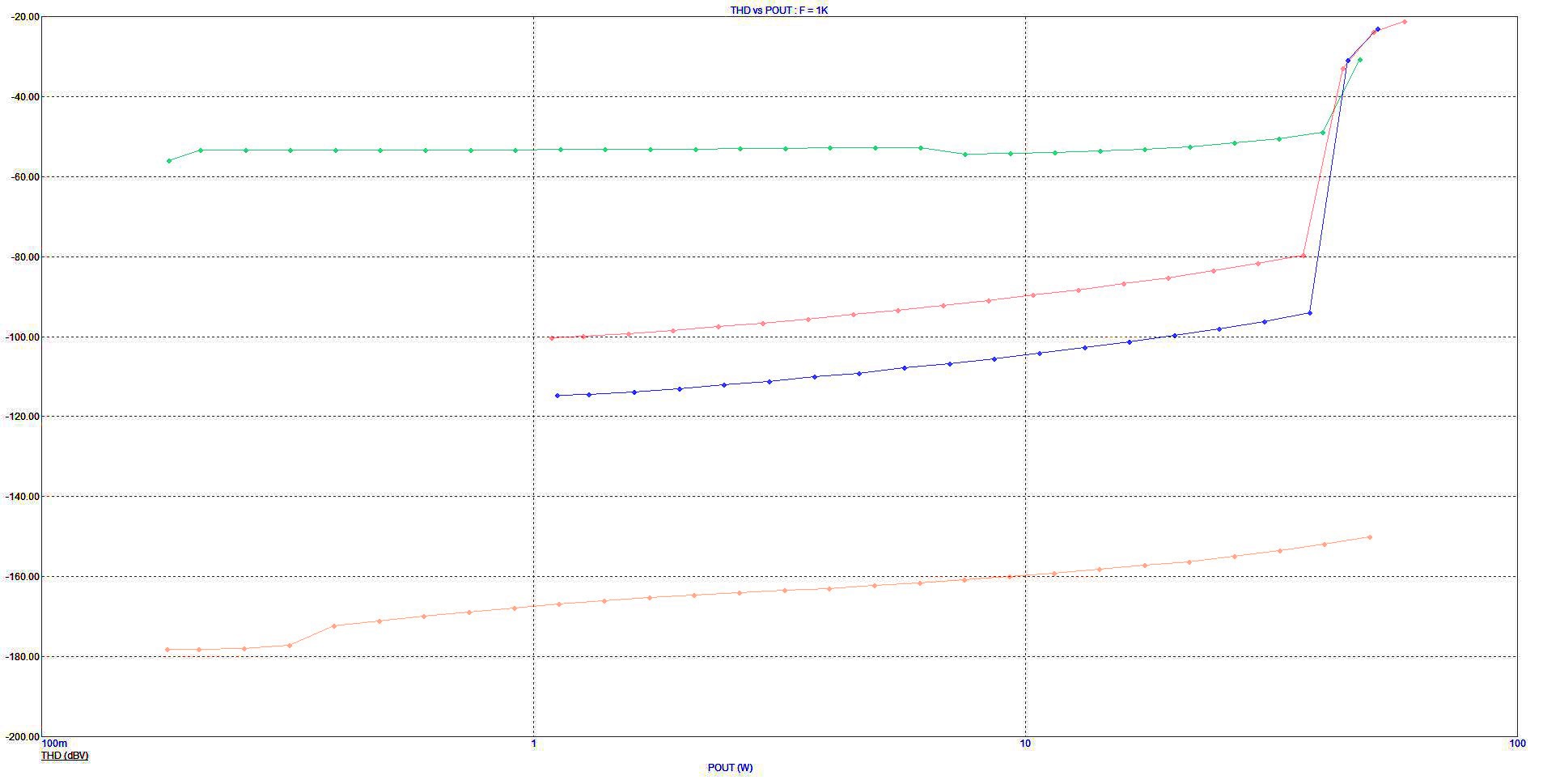

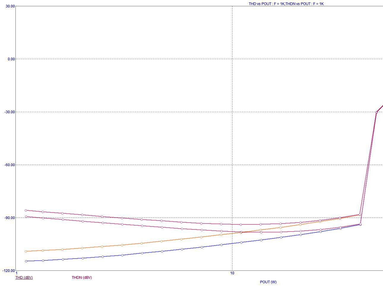

Now come the facts:
The orange trace is THD with 5,1k resistor and the blue trace is THD without 5,1k resistor.
In the schematic is 5k but I simulated with 5.1k, its irrelevant.

Removing the 5,1k, fixing the bias network, adding a mirror, adding a pre-vas buffer, removing the pre-diff buffer brings a THD improvement of 60 dB.
In words: Sixty.

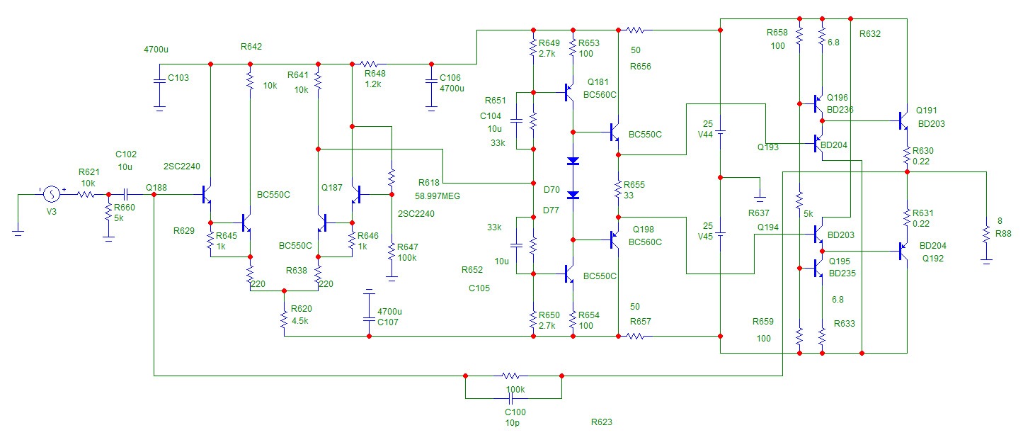

The reference of the data I presented is the schematic from my posting #378.

If you have a stomach ache with
R647, set this to the value 0 Ohm
R600, set this to the value infinite
R623, set this to the value 10 Ohm
and with
R621, set this to the value 1 Ohm
or simply throw everything in the garbage can.
In words: Sixty.
THD_1k Rload = 8Ohm:
So the approx -100dB posted (in #406, my circuit thought!) now becomes -160dB -> 1% / 10 /10 /10 /10 /10 /10 -> 1*10^-6% -> 0.000001%.
Nice 🤣.

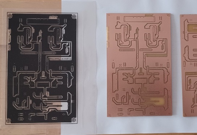

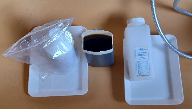

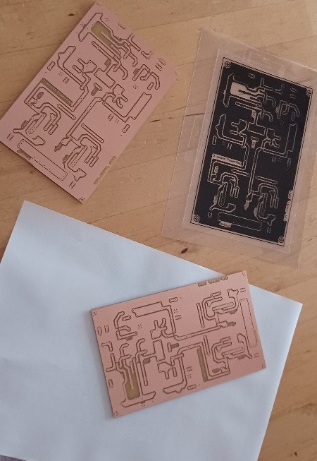

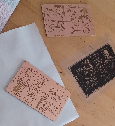

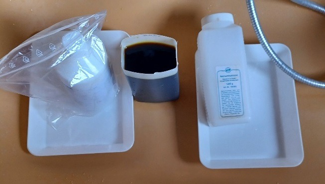

In the meantime, I have successfully etched two circuit boards in true style. However, I will certainly never do that again, some of my material is 25 years old. The fact that the photo-coated base material was still functional is a miracle in itself. And improvising a chemistry lab in the bathroom takes time, exposing, developing, etching ... Getting everything back in order, oh dear; but I can't even get to my ancient etching machine in the cellar, what isn't there all around?! Well, it worked. I'll drill tomorrow. My God, I etched the last circuit board 15 years ago just for fun.
HBt.
The diagram in #404 expresses the following:
The signal source (far left) sees a quasi-constant load (the input resistance of the amplifier) of |10kOhms| (over practically the entire audio frequency range) -completely independent of the value of the demonized 5k1. In the idealized, simplified view, this 5k1 can also simply be thought as not really existing. If the signal source were to take note of this boy, then we would have to note 10k+5k1 = 15k1 on the input side.
Anyone who is thinking of a voltage divider here, is getting wrong. It is the resulting currents that flow to the node that play the music here, no voltage.
Practically nothing flows through the 5k1 terminal /resistor,
practically nothing flows into the base electrode,
so the current through the 10k input resistor must determine everything else.
This current now also flows through the 100k negative feedback resistor with a 180° phase relationship. The sum in the node will hopefully be zero. There is a virtual zero point!
Of course, things do not look quite so ideal in reality, in practice. Wasn't there something about thermal noise?
What is it about #404?
The only point is' that it is completely unnecessary to open a big barrel because of this diabolical resistance and to legitimize the terror that has been organized on this basis.
Hopefully the THD(+N)-terrorism of the Tripple B Gang has now come to an end.
HBt.

'wahab' has detected instability, inadequate frequency compensation. I have subsequently determined that the topology is fundamentally difficult with regard to the stability criterion.
No more and no less.

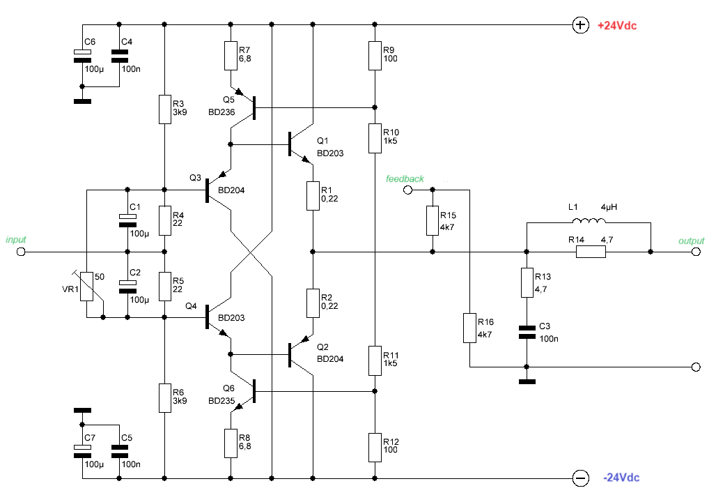

is the best end the one to build?
I assume you are asking if I am building the actual power amplifier. Yes, I am. The so-called Diamond buffer, BB insists (also azubinski did, first) that the voltage follower is a diamond and is named after its creator, Mr. Diamond. That's what it's all about, the practical test of this configuration, actually completely independent of the IP-VA stage. And if I like this configuration, a KRILL (from Steve Dunlap) will eventually follow. All for just one reason: curiosity and because I have never heard or built such a configuration before.
The prefix (the superlative) "the best" should already indicate that there are technically more sensible solutions, in the sense of more economical or more stable - and that I have /had already recognized the weak points, so a wink with the eye.
After drilling the circuit boards, I am now curious about the behavior of this power amp circuit, as a follower (i.e. an appendage of the IP-VA stage) or as a member within the global feedback loop.
In addition, I have two more and further attempts in mind, for which I need some exotic circuit -> that's another reason why the clumsy attempt at terrorism really annoyed me.
Are you interested in this configuration? Search for the "Krill" 😉.

Schematic from post #406:
the superfluous and detrimental 5,1k resistor, value changed to:
10 ohms: green
1k: red
100k: blue
That resistor also affects gain and bandwith.
Why? Because it doesn´t belong there. That´s why.
Schematic from post #397: orange

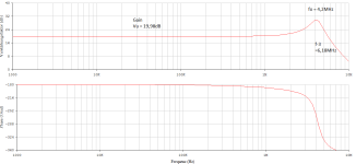

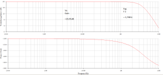

Which trump card have I still not played - and why do I drink tea with milk and sugar?

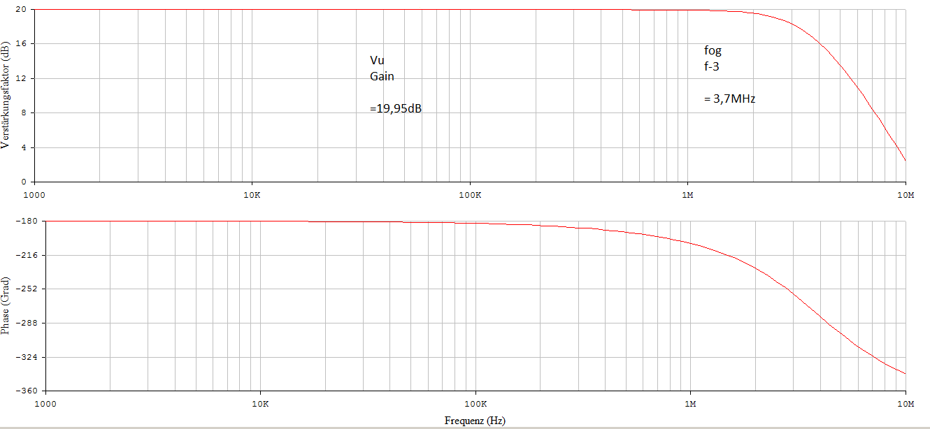

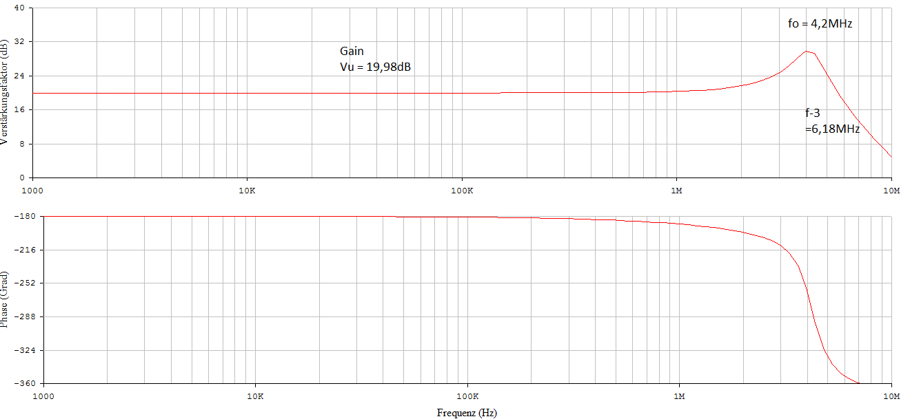

Let's take the so-called frequency response (amplitude and phase, the angle) as a means of describing the complex transfer function of this quadripole and look at the graphical representation of the same.
Happy to read you again,
HBt.
(reference is "submarine Tim", without Ck 10pF keramisch)
