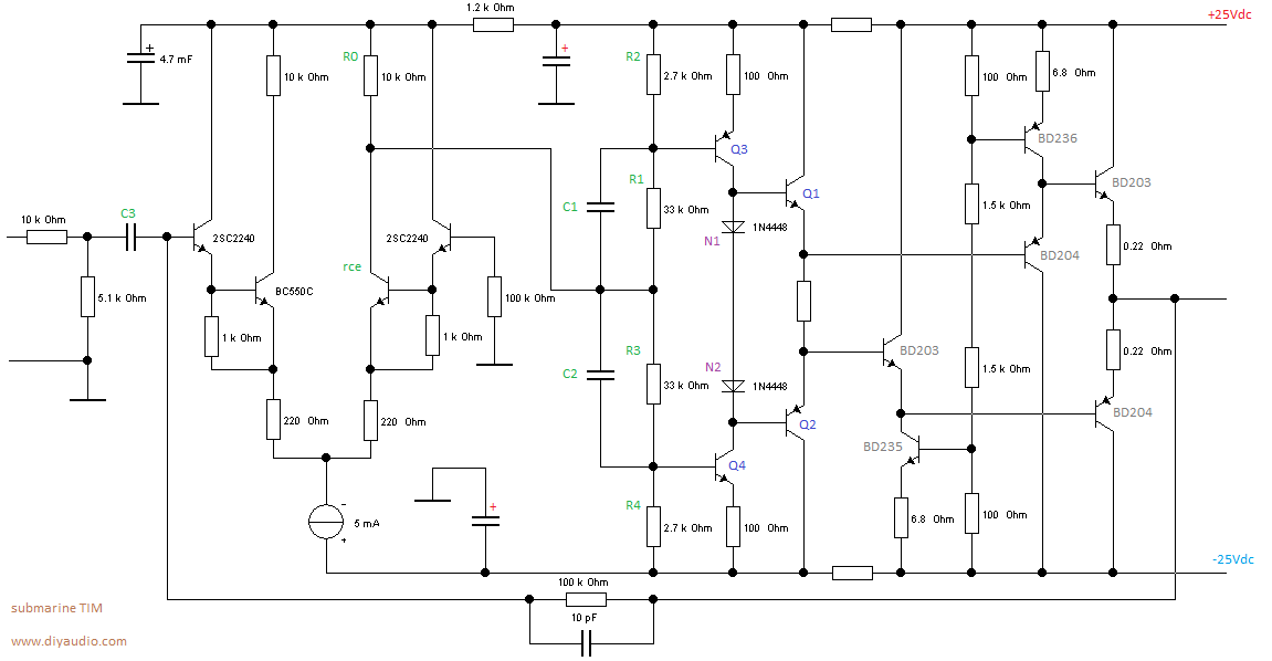

please cross-check schematic...

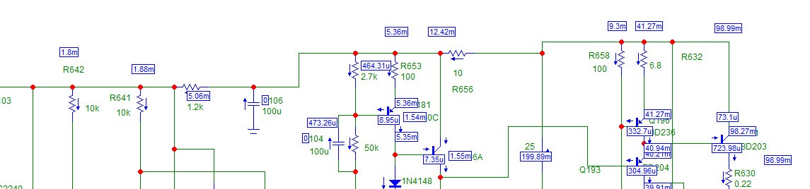

Idle currents
Q1,Q2,Q3,Q4 plus N1,N2 should (finally) all be immersed together in a small aluminum body (to be made), add some thermally conductive paste.
Under no circumstances should the quiescent current through Q1 & Q2 be greater than 10mAdc ... the common RE= (10Ohm/3) is far too small to have a stabilizing effect ... This is one of the imponderables of this stage. It may be necessary to replace N1 and N2 with other types or, or, or ...
The power supply to the output stage is unregulated and separate from the pre-stage (in reality!).
The 5mAdc sink is already rudimentarily implemented on the circuit board.
Dear Bernhard,
I think it's great that you decided to feed MicroCap12 with the circuit after all - brilliant.
Thank you

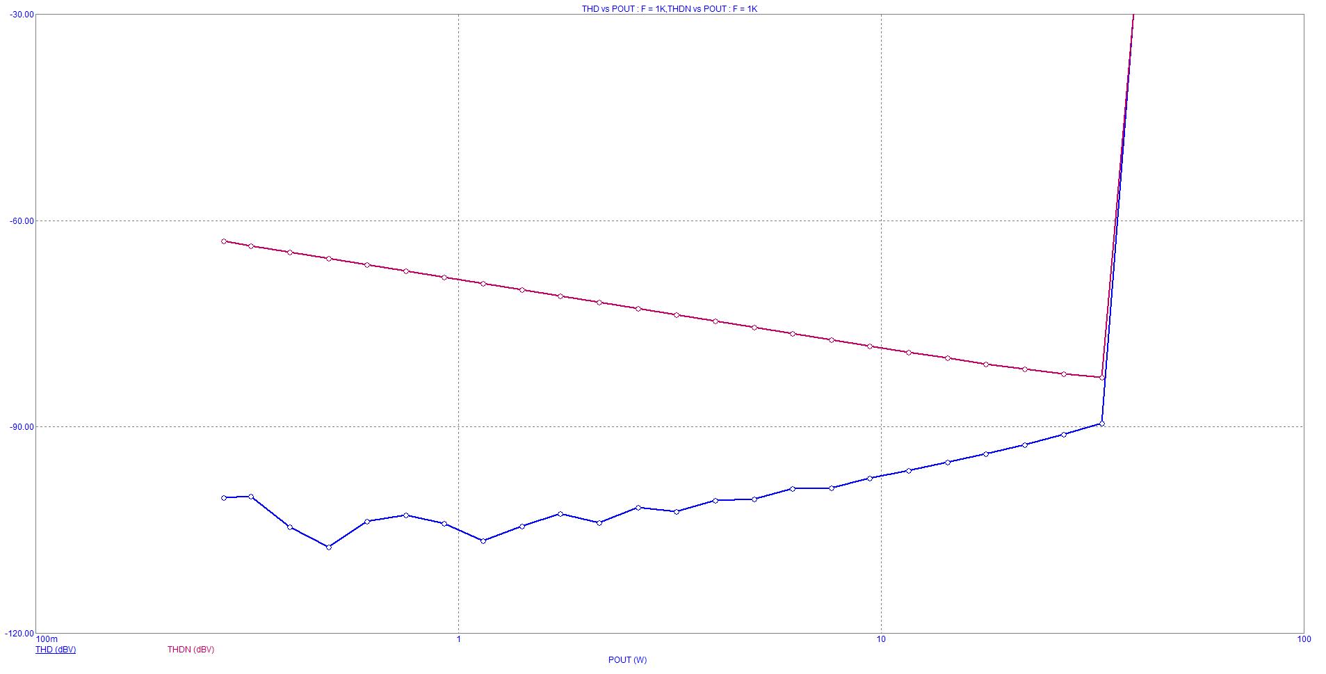

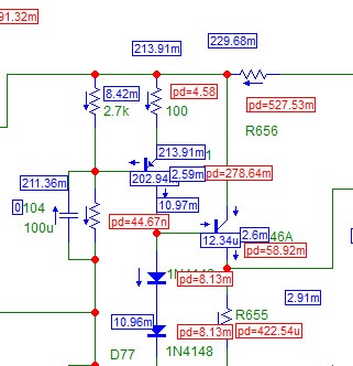

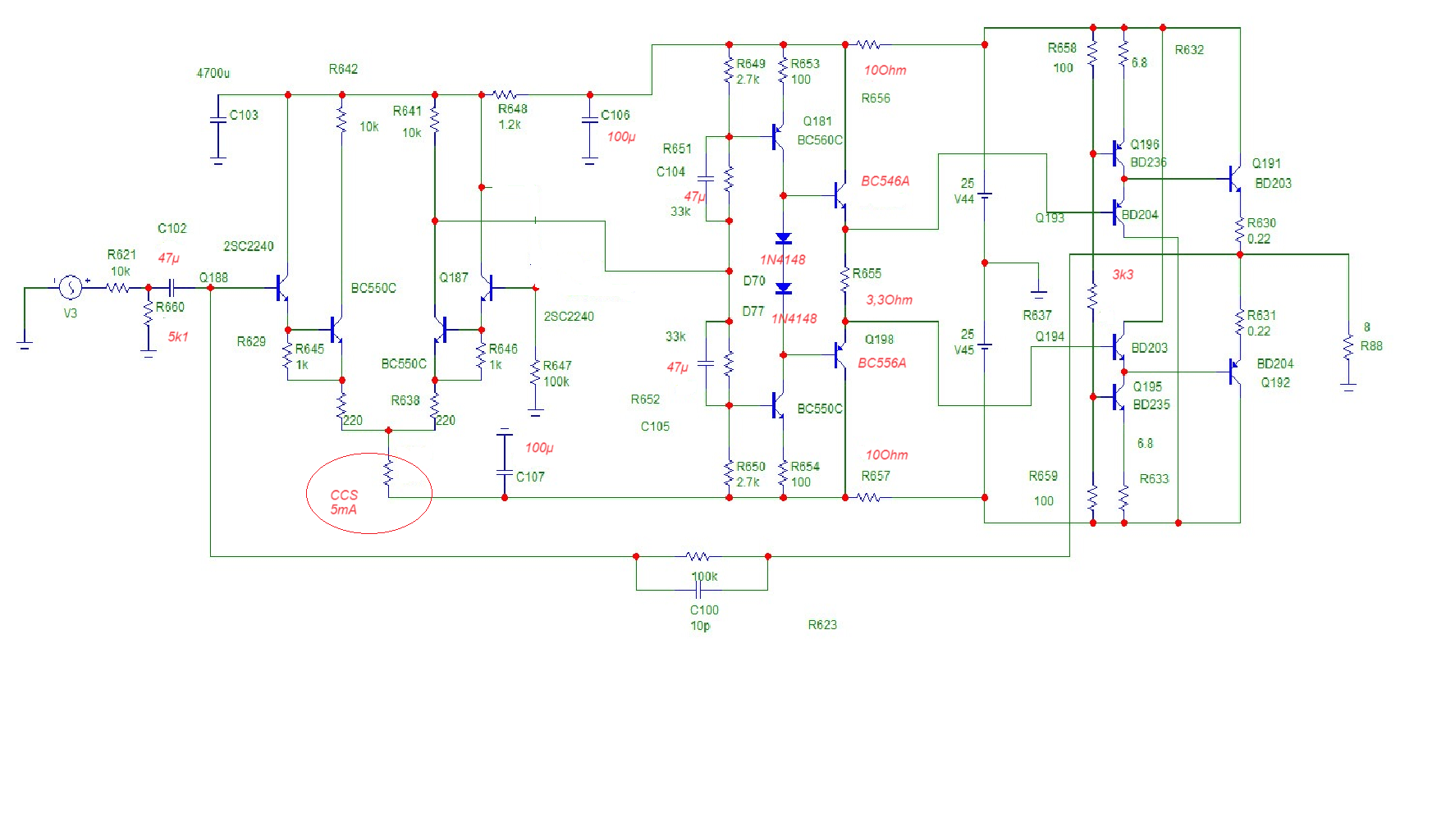

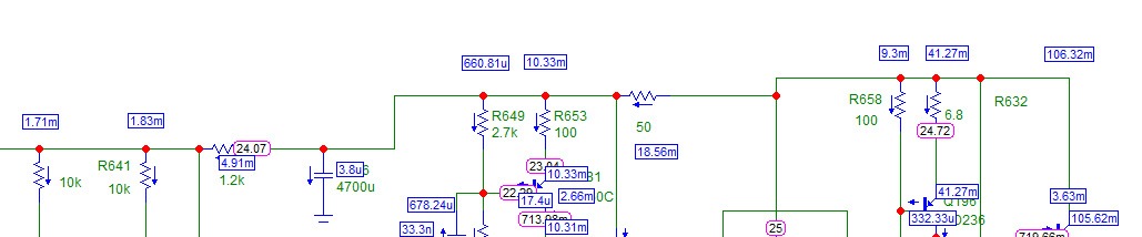

So the 5mA now should be a ccs?
I removed it in my schematic and the resistor was as good as the ccs.
Also I simulated your schematic already. 4mA, 5mA, 6mA - doesn´t matter.
And, the ccs doesn´t help either.
Same with 3.3k and 3.3 ohms.
Different idle currents still show the same result.

For me personally, a little PowerAmp has to follow the KISS or economy principle.
I hope many readers will feel encouraged to think through the circuit and size it successfully. Practical results from my side will not be available for a few weeks.
Anyone who would like to ask questions now is encouraged to do so.
Now that a model for MC12 is available, @Bernhard can already put the design proposal through its paces in the computer and sound the alarm if something could go seriously wrong.

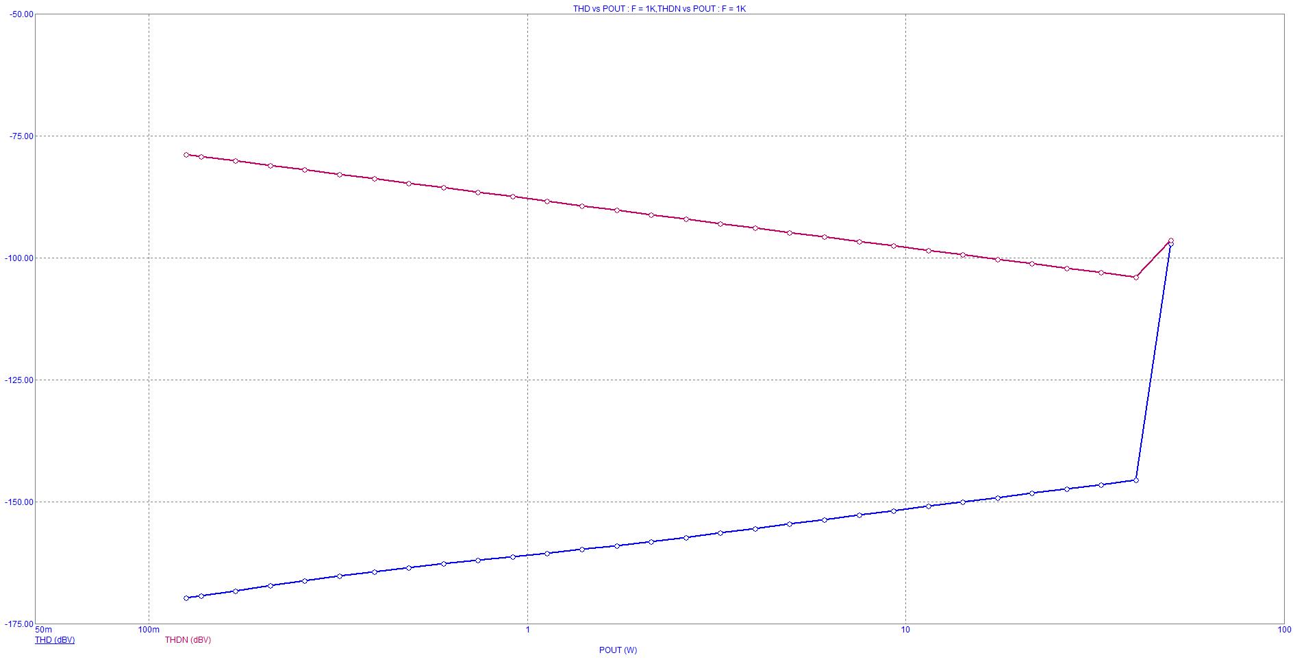

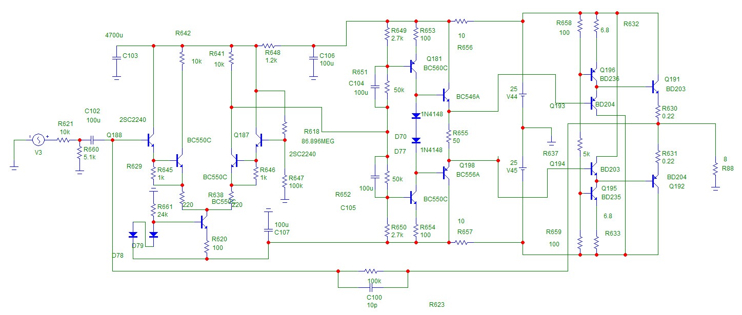

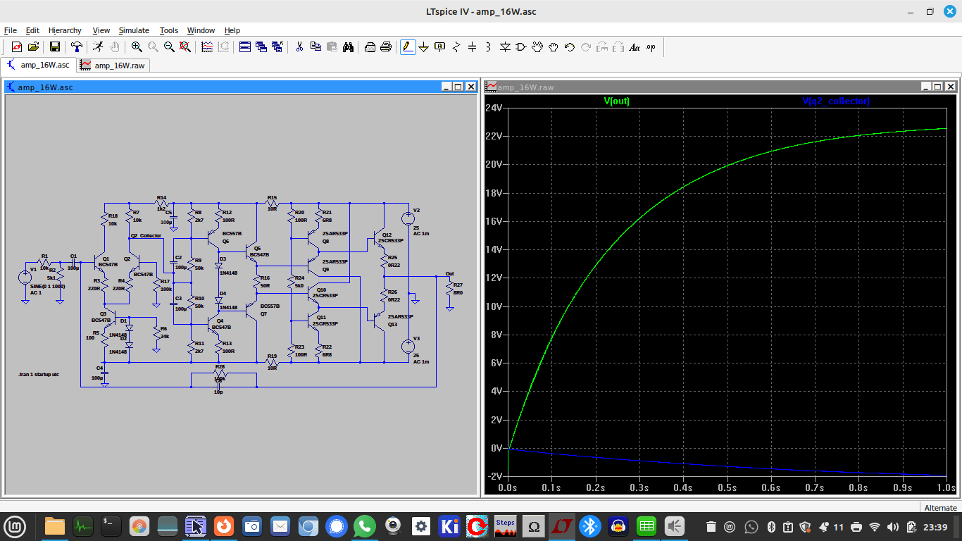

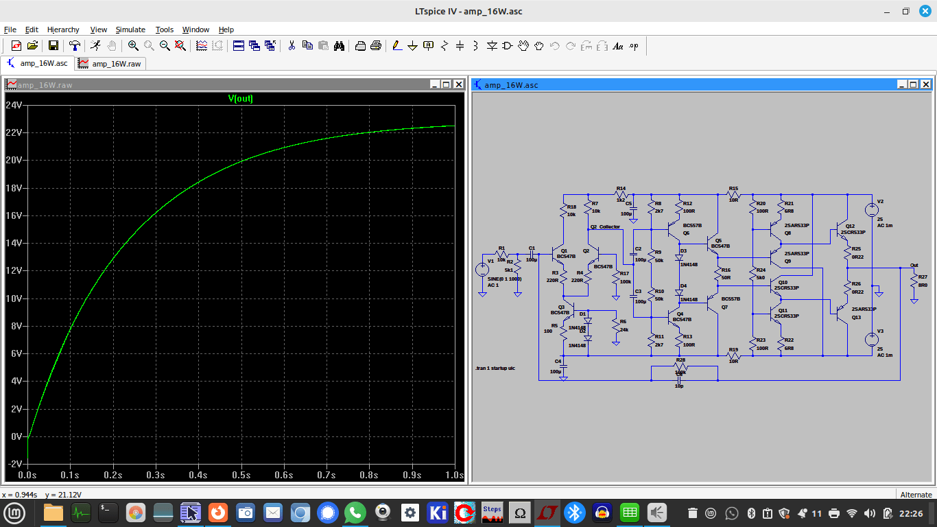

This is by far not the only problem. a spice simulation confirmed my initial bad feeling: This circuit will not work at all.
The culprit is the coupling from Q2.collector to the VAS - prohibiting a stable DC operating point.
