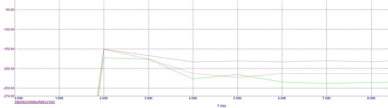

Ok, virtual ground - inverting affects 2nd harmonic only, by 20dB. 3rd remains exactly the same.
If that circuit was downgraded - no mirror, no cascodes, the impact on the higher THD would be neglible imho.
So what we have here? Second down to -184 from -164, all else equal.
One could say that the normal version has a nicer falling harmonic spectrum
Green trace = inverting classA, red trace = normal classA
5th harmonic and up depend on hf compensation, nothing to see here.

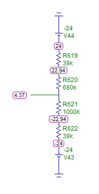

The present circuit from #250 is symmetrical, the operating point of each stage is 0 Vdc.
The input is 0V, the bases are not. Also the emitters of the inner diff transistors are on -1,4V, so that is very shallow water...
The original schematic had unequal resistors in that divider, so the vas input was at about 4V.
The base of the diff input transistor is on 0V and has nearly no ac voltage swing.

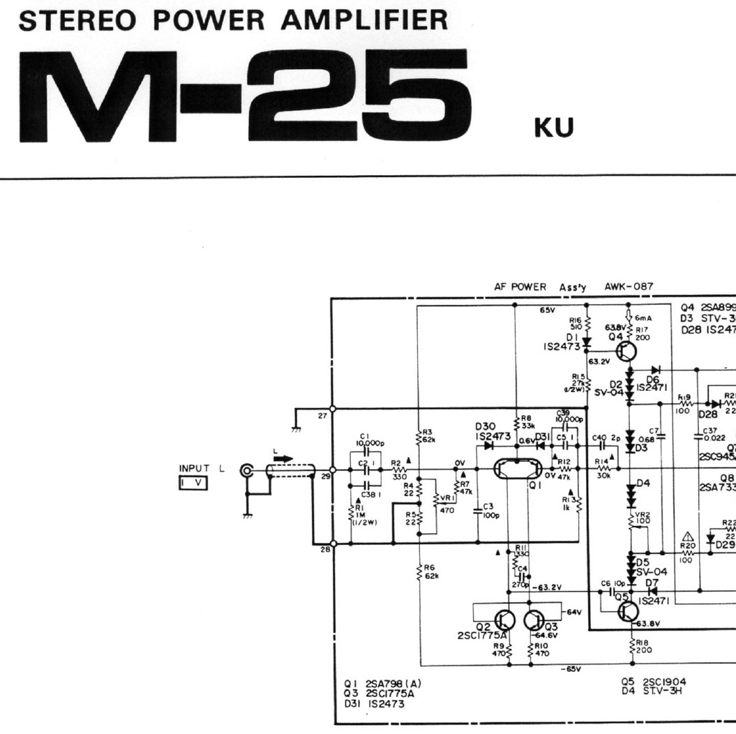

My good old M-25
Why did they use two high quality film caps on the input + a smaller one, if caps don´t matter? Why not just a 10 µF bipolar lytic?
