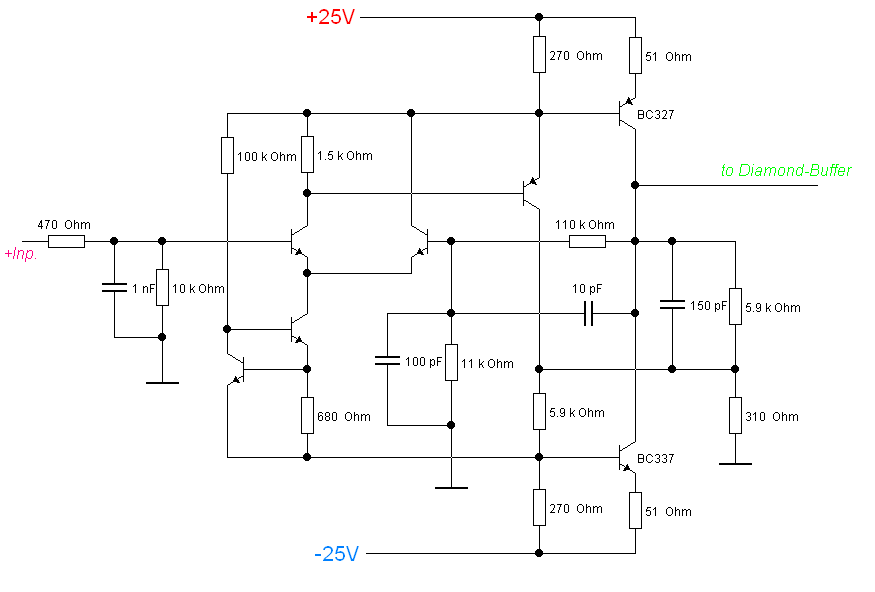

Since I'm not satisfied with Dr. Frankenstein's IPS-VAS either, I'm continuing to tinker with it.
This is followed by a quasi half diamond, with quite remarkable distortion of less than 0.004% (K2 only).
Balanced between the rails up to 44Vpp output voltage with Rload=10kOhm.
The circuit does not oscillate in the simulator, but as expected, the desired frequency response compensation is not possible. Nevertheless, this strange VAS works.
I used the evil C types as BJTs.

If I allow myself five more transistors, making a total of twelve (including the obligatory BC337 & BC327 of the original), then tomorrow or the day after tomorrow Tim will make a leap in his evolution that is quite something: the full diamond VAS! The internal single-ended operational amplifier becomes a balanced push-pull amplifier.

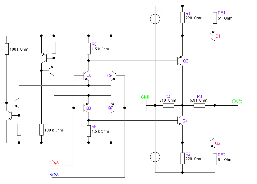

@wahab,
you asked for a fully symmetrical IP-VA stage, well - here it is.
Of course, we have to pay special attention to the power dissipation of Q1 & Q2 and the core must not get too warm, we know all that.
From your and Bernard's suggestions so far, which shapes all correspond in a broad sense to the Diamond sticker, I derive the designation Super-Diamond for the schematic in the file attachment. This basic circuit is therefore a Super-Diamond or nothing more than a discrete op-amp. With a very well known trick!

You /we could always realize the IP-VA stage with an operational amplifier (of your /our choice) or even couple the complete power amplifier to an IC, as the famous German “IGEL” from SAC (Axel Schäfer & Walter Fuchs) did, for example.
Because small hybrid modules can be so incredibly helpful, I like discrete OP-Amp. Design !
One rather important aspect should never be lost sight of: the morphed version can be controlled rail to rail. This is dangerous and the 25Wrms at static 8Ohms required here also represent the safe end of the swing.
At the latest when the output exceeds 30Wrms, some form of protective circuit (active or passive) must intervene.
If this point is ignored, it will lead to oscillations and other unpleasant things.

The product of the loop gain and THD is a mediocre 2%. The open loop amplifier could have been more linear.This is fundamentally the case and applies to every amplifier design, absolutely every design!

Even if I don't want to take up the cudgels for the Stellema design, we can go into detail and discuss the snot.
I do my research by hand (handwritten without a computer):
OLG approx. 78dB
CLG approx. 26dB
This largely agrees with the text specification, my +4dB difference is quickly justified, among other things because I rounded and in the parts list it is not specified which classification / selection the BJTs follow, so I took an average from all possible cases.
Based on a benevolent THD_20k with 0.01%, I even estimate 4% for the OLG case.
If we were now to implement the inner amplifier more linearly (which, among other things, would only be possible by means of local negative feedback, no matter in what form it would be hidden), then we could easily achieve 1% or even a little less, but at the same time also significantly reduce the OLG (Ao).
We reduce the self-made disturbance X and the factor by which it will now occur proportionally in the output signal, or subtracted.
At the end of the day, the final result (black box) is almost the same, as a number. The interference spectrum, or the Fourier decomposition, certainly looks different.

@EdGr
Yes, the original circuit is very curious and it gets its quite considerable THD values from the global negative feedback, one might think - alone.
It is clear that the IP is both the differential point and the actual voltage amplifier - at the latest since Douglas S. insisted on this, we have internalized that a clear separation and tripartite division is the most rational approach. The attached second part is an afterburner and not really the VAS.
IP 52dB + VA 26dB -> 78dB
This is not good, but, in the end, we always have to look at the negative feedback case. And take the entire construct apart in terms of measurement technology. How the Black Box works internally should not affect us in the first instance, we don't have to care.
