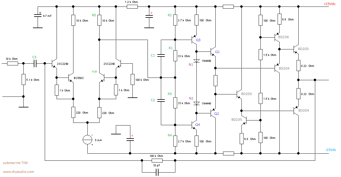

Placeholder C1 = C2 may also be 47µF / 63Vdc, in parallel with a small foil type - as you wish.
The entire ensemble (marked in green, without C3) dynamically represents the working resistance of the BJT - locally and globally (feedbacked) within the loops. At 47µ the measured inner -3dB point is well below 1Hz (isolated observation in the open loop case without negative feedback, regardless of type)
The capacitors C1, C2 and C3 do not pose the slightest of problems in this circuit topology!

V_CE of the IP is constant, approx 1.45Vdc, modulated with a maximum of +/- 27mVac_peak. And that already represents the case where it is overdriven to the limit. The delta on the characteristic curve branch IC(VCE) is sufficiently minimal, to be able to do without any form of cascode (including current mirror) with a clear conscience. An overkill IP is completely excessive overzealousness in this, even the morphed topology (the concept). The selected BJT types of the original will also not suffer a CE breakthrough, that is impossible!

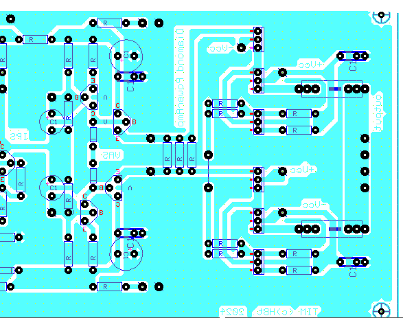

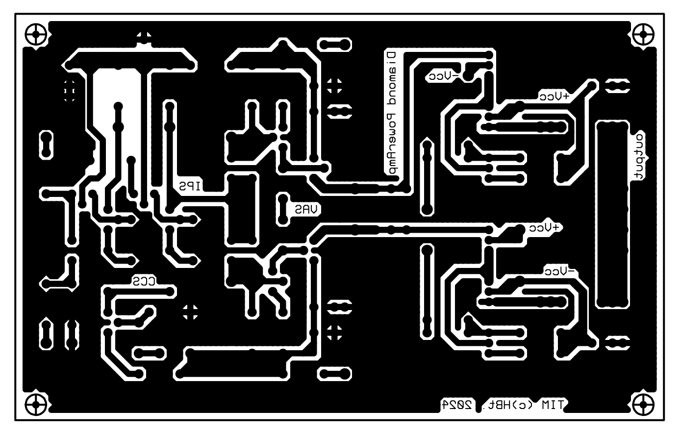

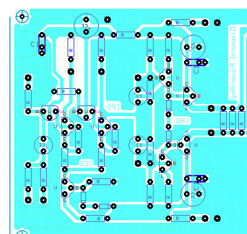

My first PCB, CAD/CAM project since the Corona breakdown. I was already afraid I wouldn't be able to do it at all ... And to create the right ambience for the 1980s design, I used an old DOS program: BoardMaker _1 (2 had a dongle), do any of you still know it? The Tim.zip file contains all the necessary files to make something reasonable / modern out of it: Gerber, Excellon, PS, PDF, LMD (for LPKF's circuit board plotter - milling) ..!
Please ask if anything does not seem to be self-explanatory. The PCB follows the schematic, it is directly readable - it becomes clear automatically on closer inspection.
Have fun with it,
HBt.
Have fun with it,
HBt.

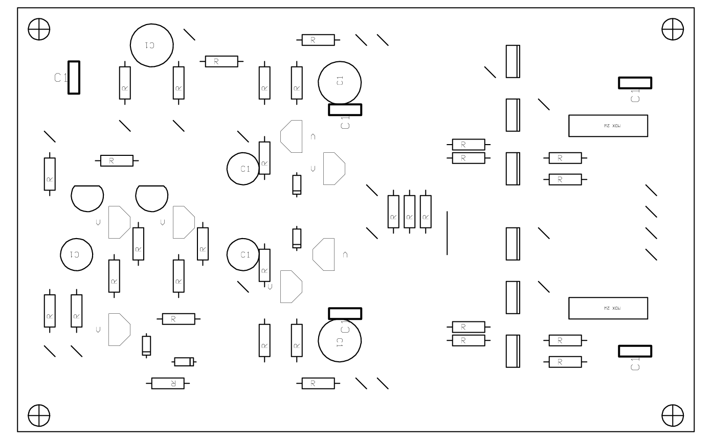

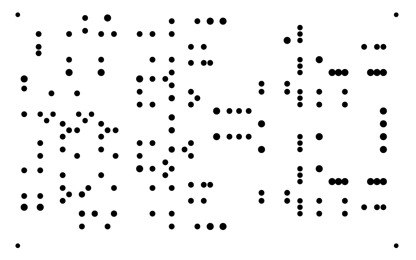

Somehow the drills are /appear to be missing, the islands have no holes 😱.
Anyway, the CircuitCam file Tim.cam and Tim.lmd as well as the drill file are just as complete as the Gerbers - just ancient formats.
I still have to create an assembly plan.
that is the normal way the copper layer looks like.
Drilling is a later production step.

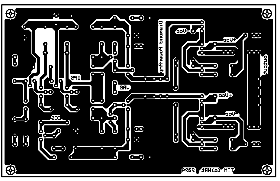

The board dimensions are 100mm by 160mm; here is a film for exposure, for all those who would like to etch their board, drilling is done with 0.8mm as standard. The grid size is 2.54mm.
If you have any questions or if something doesn't seem self-explanatory, please let me know.

Pioneer use this VAS topology in a car amplifier that has switchable+-25-30V rails, although they use a classic EF2 OS
and an opamp instread of the differential.
That being said the low DC gain remain here as well as the dubbious ability of the IPS to DC drive correctly the VAS,
this could be remedied by puting a 1.2-1.3x voltage attenuator on the differential s buffers emitters such that the differential
emitters voltage are at about -5V.

The Gerber format (BM1,2 uses) is very old, namely RS-274D; does anyone have an uncomplicated way of converting this into a suitable format, e.g. RS-274X, using also the drill file? Or a current full version of CircuitCAM (the TIM.cam file is loadable and complete), with which you can export all common formats?

I have many things to do including a long to do- and to try-list for my amplifier.
So I´m not thinking as deep into that topology as you.
As you know, my proposed schematic is noninverting.
I realized that both bases are at 0V permanently but did not think about the consequences.
The ips has static voltages at all times, so no cascode is needed, right.
The original schematic is an already well thought through concept, that is clear. Somebody put many effort in there. That it still has flaws, that should raise an eyebrow.
So I removed the cascode and the ccs in the inverting version of my schematic and distortion remains as low as before. So far, so good.
One point in the concept of that original schematic is that the value of the load resistor is very high, so a mirror is not really necessary, however:
I removed the mirror, changed resistors to 10k, K3 is now -150dB with mirror it was -174. So the mirror is still better.
The question for me would be: Could that topologie provoke any problems like unsatisfied stability that lead to a dead end ?
If I have time, I could sim that final schematic, but its not sure that I have all models.
Did you simulate that schematic with the 10pF? Is it stable?
Anyway, your build will reveal the truth.

In the computer, the topology with its dimensioning is extremely broadband and stable. Yes, I have simulated with and without Ck=10pf. In our case, Ck actually only determines the upper cut-off frequency f-3 or fh (fog in German).Did you simulate that schematic with the 10pF? Is it stable?
This applies to any test setup or experiment - and that's why I would like to point out that a proposal is only reliable when it has passed several test runs (has been practically rinsed), in the truest sense of the word "diagnostic".Anyway, your build will reveal the truth.
I also have a whole series of objections, or rather "concerns".
The experiment will either confirm them (and lead to practical solutions on the object) or not. However, it is not necessarily helpful to express all the concerns that one often justifiably has right at the start of a journey.
I have a checklist in the back of my mind and I work through it. If all my points on the list get a tick, then I confirm the function and release / let the fire /go.
It's not time yet.
However, this should not stop anyone from conducting their own experiments, quite the opposite - but you have to know that every experiment can go wrong.
Q1 to Q4, i.e. the actual VAS (in the submarine Tim thought), work at their power loss limits ..!
Just to raise one major concern. However, we can claim the Class A mode for advertising purposes, but we will not put the small BD203/4 power amplifier through this torture (which would also be complete nonsense in view of the Diamond configuration).

At the moment, I'm more concerned that BM1 has not been able to generate an RS-274X. Unfortunately, I don't own TSIN's BoardMaker 3. Boardmaker 1,2,3 has a huge advantage over all other programs: you are not disturbed by anything in the actual design process and can devote yourself entirely to your creative work. This is identical to the old DOS or Win16 AutoCad, where the actual program does not interfere with the process.
So, how do I put the aperture list together with the NC data to create an RS-274X (or modern) file? Writing a program that implements this case as a command is more complex than starting a new layout with Eagle (but what about the licenses, are you allowed to make the complete files publicly available? I don't think so! So KiCAd after all - and I lack any motivation for that.
So I etch, but my printer is on strike and I only have limited access to a protomat (they are gathering dust now; everyone just sends their ideas overseas, costs apparently no longer play a role, regardless of whether the layout or the circuit actually works or is effective - just as a side note) at the moment. My construction will therefore also be delayed, but not forever.
