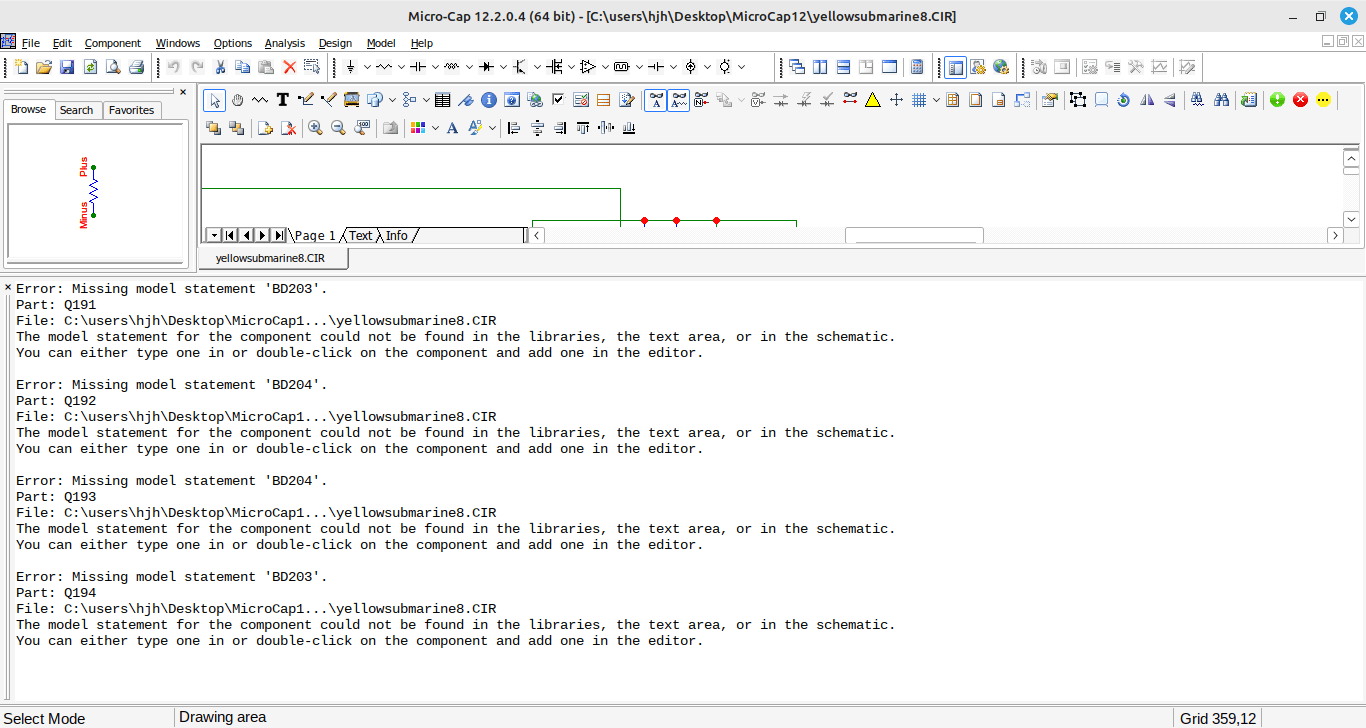

Please install Micro-Cap 12 full version, if you haven't already.
If you can't find MC12 for download I can help you, just let me know. This excellent simulator is now FREE!

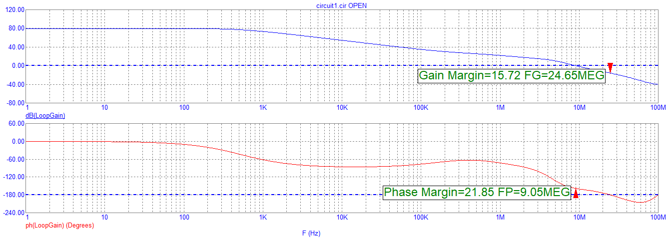

Then download the CIR below and run Transient, Dynamic DC, AC, or Stability (from the Analysis menu). You can run these four types of analysis without bumping into any issues with the CIR file I'm attaching (latest schematic from Bernhard).

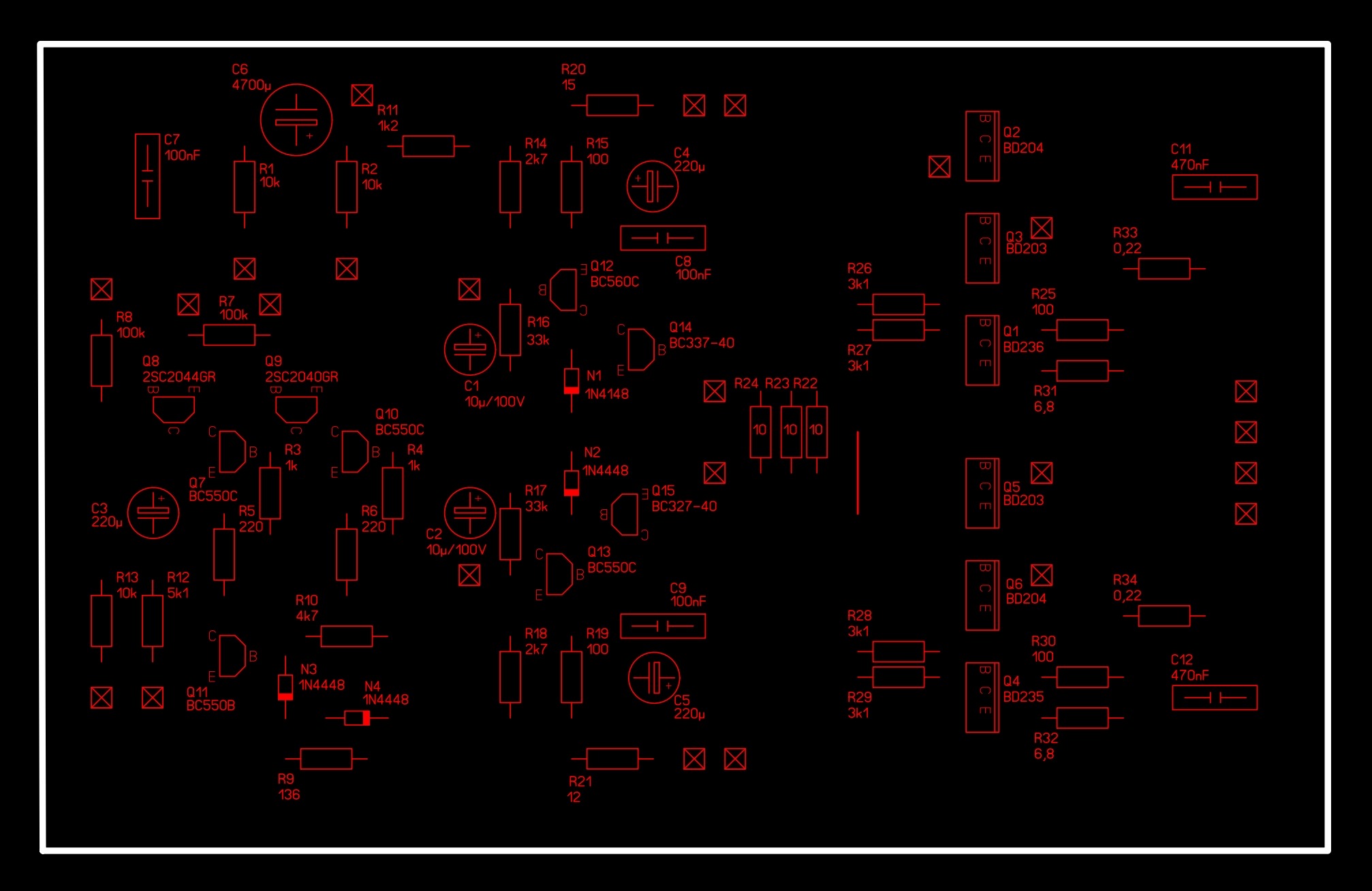

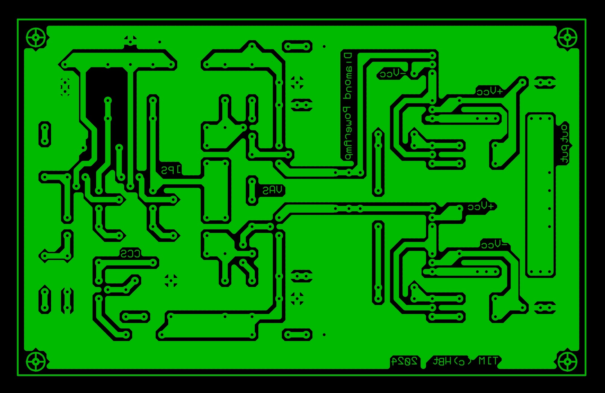

PCB:
*.gbr, *.drl, *.lay
for fun and free use!
  • pcbTim_1st_final.zip

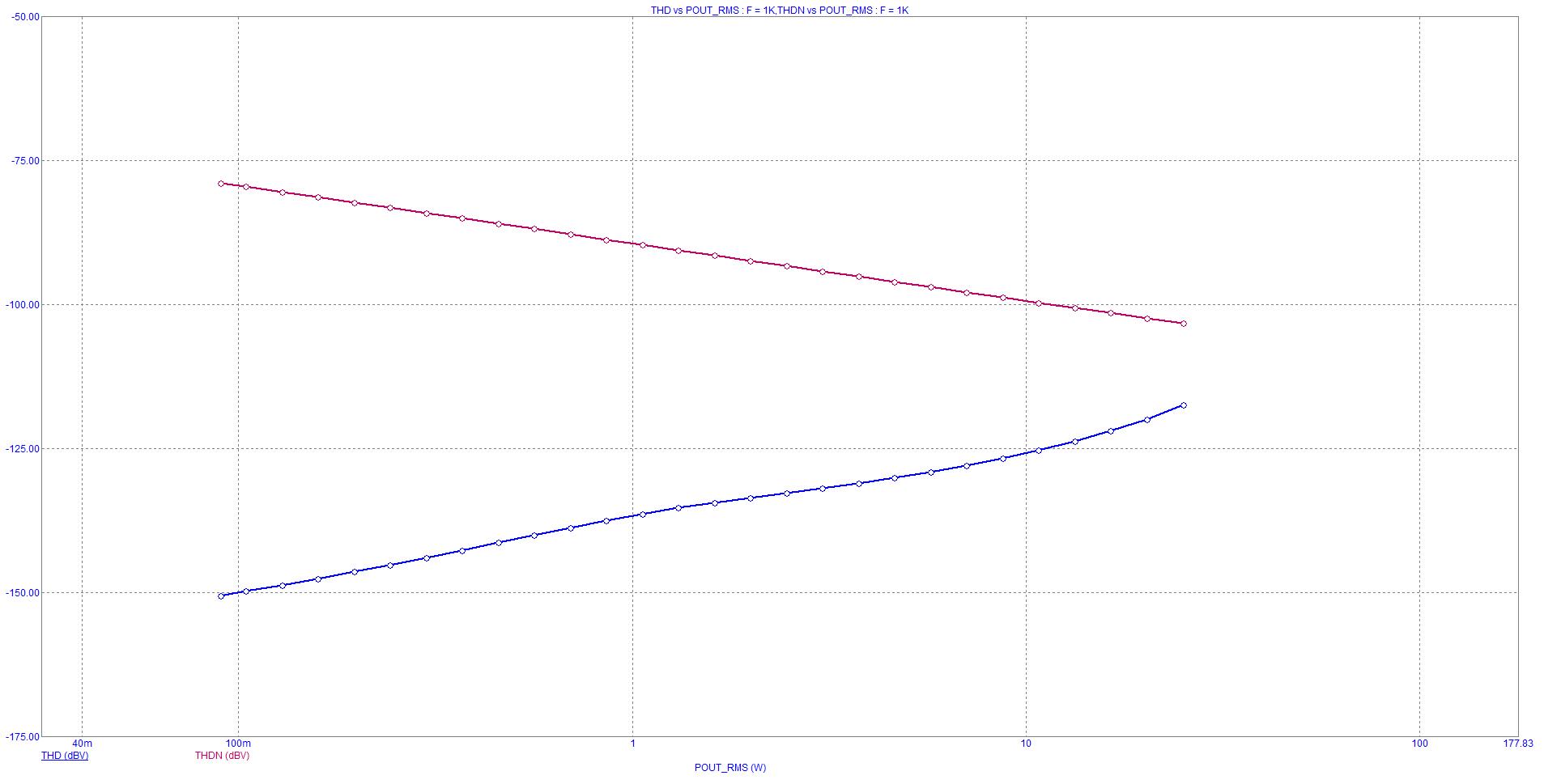

In my schematic, the criticized zdiode vas has about 10dB better THD than the AC coupled VAS from hbt´s latest schematic.

Thank you for the link.
This is the wayback machine, their website seems to be out of reach.
Why should I go for such a sw?
The developers closed doors, they retired I presume. Good for us, they made MC12 free.
I think Micro-Cap is still one of the best simulators out there. One thing missing is level 4 mosfet models, but I don't need them at this time.
Anyway, you can open that CIR I attached and just run Transient, AC, Dynamic DC, Stability, it will work.
-10dB means:
changed from 0.003% to an incredible 0.001% at any /witch? point in the THD(a function of ...).
Responsible for this astonishing improvement of this metric is not the type of coupling (we distinguish between dc-coupling, ac-coupling, coupling by means of a base BJT circuit and diode or Z-diode coupling), but the higher gain factor of your throw in the open loop is the cause. Not the Z!
